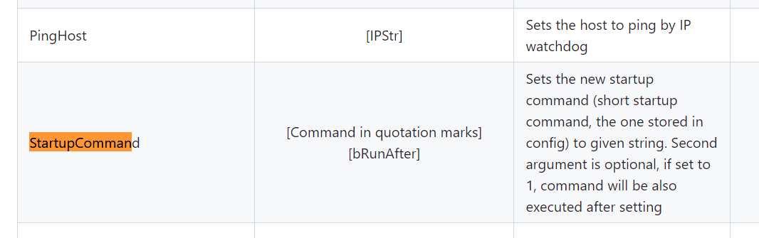

    Is there a way to configure the startup command in OpenBK7231T_App using MQTT? I've tried a number of things (`cfg_startup` `startup_command`), but all give "topic not handled".
    I've searched for ages and can't find anything either way. It's not listed https://github.com/openshwprojects/OpenBK7231T_App/blob/main/docs/commands-extended.md (unless it does not include the word "startup").
    I have a couple of dozen devices, and want to update all of them, and doing it via MQTT will be a lot easier than finding the IP address of them all and then posting the config that way.
    Thanks!

    Very good idea. I've added that command for you.
    Configuring Startup Command in OpenBK7231T_App with MQTT: Handling 'Topic Not Handled' Issue
    Can you check if it works for you?
    Here's a self test for that:
    https://github.com/openshwprojects/OpenBK7231...4ab6afbfe/src/selftest/selftest_cmd_startup.c

    That works great! I have just updated 5 devices and reconfigured the startup command on all of them using the "Group Topic". So just one MQTT command to do all the updates, and one to configure their color at startup.
    Thanks for your quick response.
