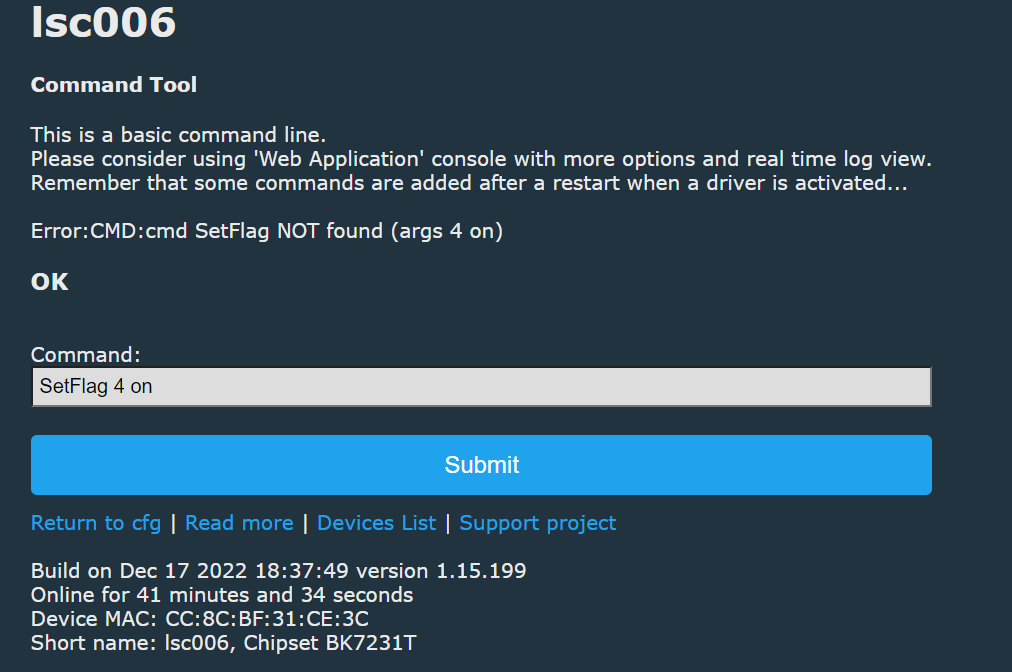

    I don't think the SetFlag(s) is accepted, or I am not using the correct syntax...
    Looking for provisioning OpenBeken devices via URL or any other automated procedure
    http://10.4.15.99/cm?cmnd=backlog+SetFlag%204
    http://10.4.15.99/cm?cmnd=backlog+SetFlag%204%201
    http://10.4.15.99/cm?cmnd=backlog+SetFlag%204%20On
    Don't work, using the execute command, doesn't either.
    Error:CMD:cmd SetFlag NOT found (args 4 on)
    Cheers
    Niels
  • #19 20340121
    Posts: 14611
    Help: 654
    Rate: 12623
    SetFlag was added to repo just this minute. It will also need few minutes for automatic build for all platforms and release.

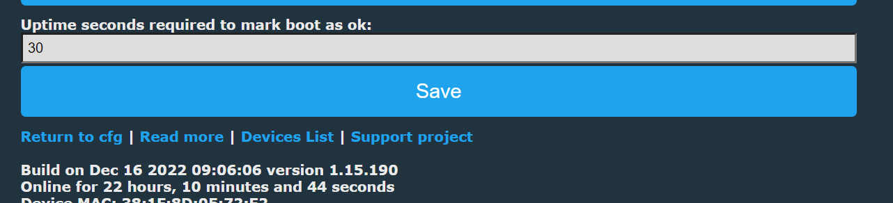

    are you sure with that 1 second? It's a very low time, how would reset that device in the case of issue? You can set it to 1, but it would be safer with something like 3 seconds setting, etc
    For minimum 'Uptime seconds required to mark boot as ok:' time can this be added to the one line command?
    Any recommended site I can use to generate the command url with spaces?

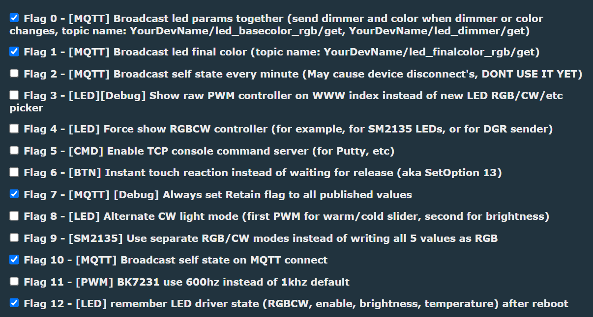

    Anything more?
    Added SetFlag [bitIndex] [bOn]
    Is there example if I need to enable several flags in general option?

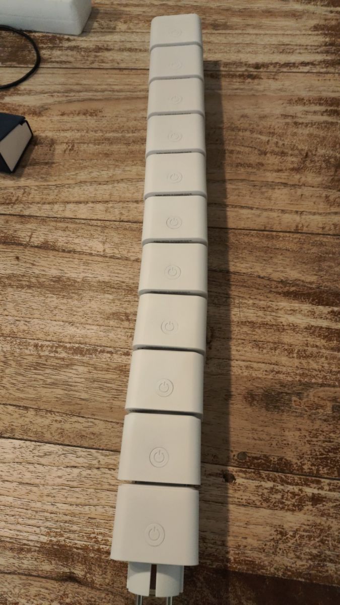

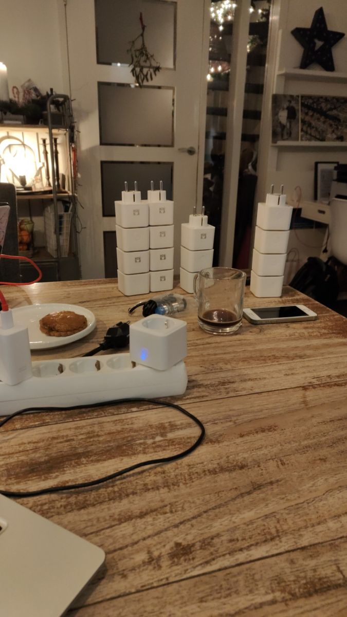

    Hi @p.kaczmarek2,
    Just want to share we did 20 LCS smart plugs this evening and are pretty satisfied with the speed we can achieve now we can provision the smart plugs while in AP mode.
    Takes about 3 minutes a plug now. Me doing the hack-flash, my friend injecting the URL with the provisioning information.
    It would be helpful that after the reset provision to MQTT Home assistant can be run. Maybe a reset (x) that indicates a "fresh" MQTT auto discovery.

    Very happy with the results; 20 units are now controlling the ceiling lights in our office.
    Today we acquired another 21 from various ACTION shops.
    Niels
