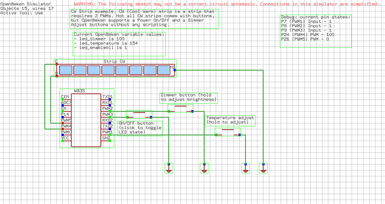

    2. OpenBeken, as you may probably know, supports BK7231T, BK7231N, BL602, W800/W801, W600/W601, XR809, T34 and... and Windows
    Yes, you read right - you can run OpenBeken on Windows, along with IoT device simulator/schematic draw tool and full MQTT support:
    [Tutorial] Provisioning using HomeAssistant
    What this mean for end user, you may ask? Well, it means that soon you will be able to test all MQTT stuff, all scripting, automation, etc, without even having an IoT device! Just Home Assistant Virtual Machine + OBK simulator will suffice.
    OBK simulator will be released soon, no binary is yet available.
    Being able to run OBK on Windows also speeds up development process a lot.

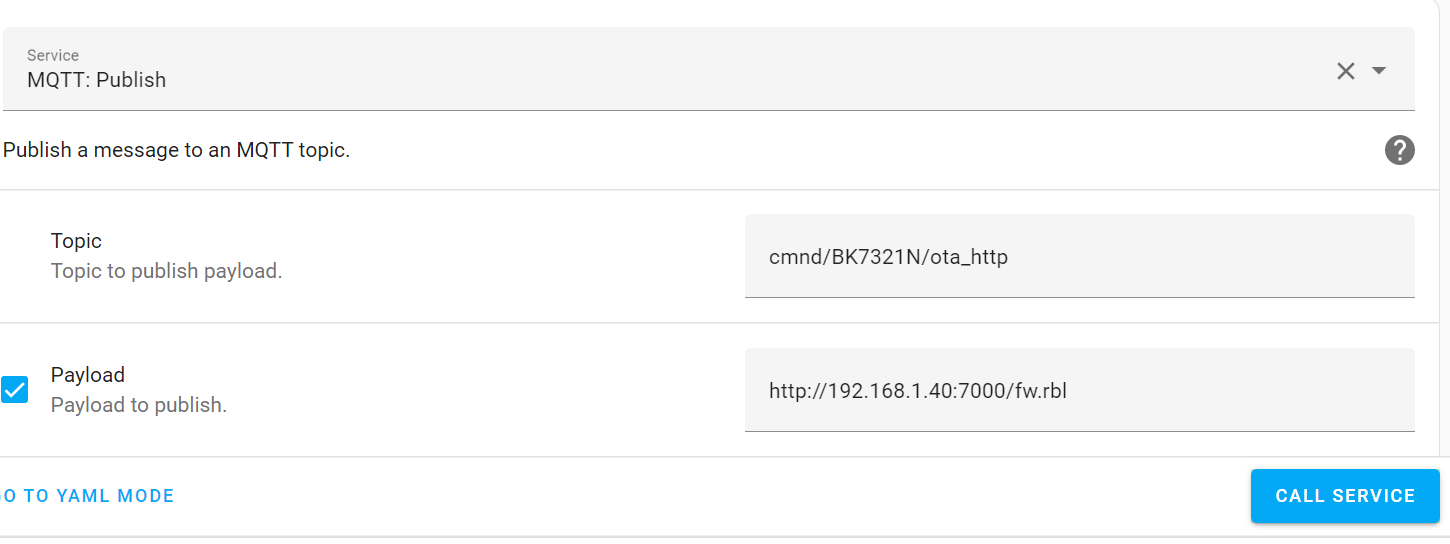

    Hi, thanks for sharing this method
    Followed the instructions but it's not triggering the ota firmware download on my devices
    Using script and just testing with developer tools
    Maybe I'm missing something?

    Your mqtt url is connecting to port 7000.
    Your tcpdump shows port 7200.
    Can you confirm the ports you are using?
    Niels
  • #10 20383607
    ferbulous
    Posts: 419
    Help: 8
    Rate: 56
    @nielspiersma it's 7200 now
    and i've the changed the mqtt publish to use 7200
    http://192.168.1.40:7200/OpenBK7231N_1.15.318.rbl
    http://192.168.1.40:7200/fw.rbl
    do i need to leave the original firmware as or just rename it?
    not working just yet with both filenames tested (if it's related)
    alias: Openbeken firmware update N
    sequence:
      - service: mqtt.publish
        data:
          topic: cmnd/BK7321N/ota_http
          payload: http://192.168.1.40:7200/fw.rbl
    mode: single
    icon: mdi:briefcase-download

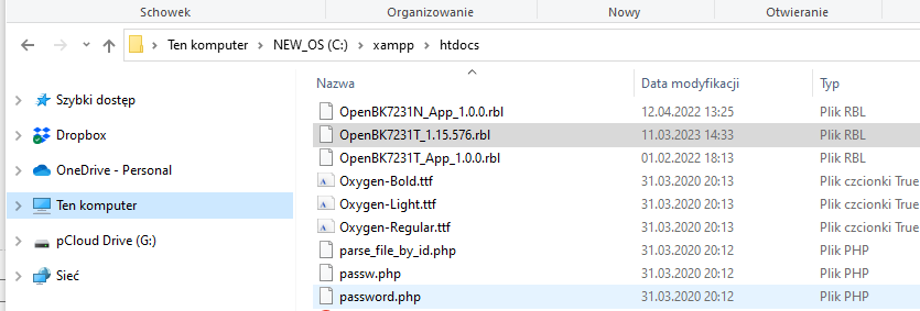

    I am also having difficulty getting the OTA update to trigger via MQTT. I have tried several variations of the strings and rebooted the module between each change to the MQTT configuration of the module. I was able to get the update to work using the module web app so it seems the URL / web server are working to correctly.
    Here is my YAML in HA
    alias: OpenBeken Firmware Update
    sequence:
    data:
    topic: cmnd/BK7321T/ota_http
    payload: http://192.168.4.200/OpenBK7231T_1.15.573.rbl
    mode: single
    icon: mdi:cellphone-arrow-down

    OK I am testing...
    Device:
    HTTP server:
    File on htdocs:
    Used command:
    ota_http http://192.168.0.118/OpenBK7231T_1.15.576.rbl
    Before sending from HA:
    In Web App Log, I can see device began OTA:
    [Tutorial] Provisioning using HomeAssistant [Tutorial] Provisioning using HomeAssistant
    Device is back with latest version!

  • #21 20481273
    chri5k
    Posts: 22
    Interesting...
    When I try the update from an HA script it does not work. When I try it from an MQTT button as you suggest it works. Same thing with the POWER TOGGLE command. What is really odd is according to the MQTT browser it is two different topics. On screen the two topics look identical. Seems like something in the way HA scripting publishes MQTT topics creates a topic OBK can not read. Also it causes the MQTT browser to see it as a different topic. The top BK7231T topic in the picture is from the script and the one below it is from the button.
    Oh well, I can do OBK updates from a button just as easily as a script.
  • #22 20481278
    Posts: 14699
    Help: 656
    Rate: 12743
    Maybe text encoding issue? Can you check your strings with some kind of UTF inspector?
    Can you try to retype all topics by hand (with your keyboard)?
  • #23 20481485
    chri5k
    Posts: 22
    I am an idiot. It was a typo in the command topic. I must have looked at that line 100 times. I typed 7321 in the HA script instead of 7231! Sorry for confusion.
  • #24 20481491
    Posts: 14699
    Help: 656
    Rate: 12743
    Oh no, now I see it as well. Well, at least we've tested the OTA functionality well.
