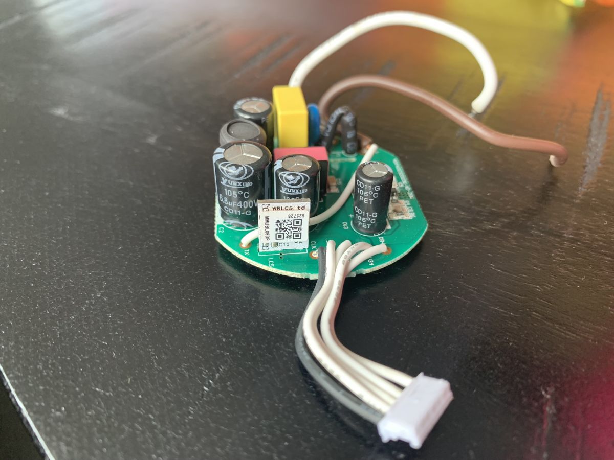

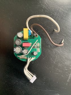

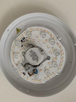

    I've successfully flashed my "LSC RGB Ceiling Lamp" using Tuya Cloudcutter and connected it to Home Assistant. This ceiling lamp looks quite similar to another device I did a teardown for: LSC Smart Ceiling Light. It is using the same LED PCB, it uses the same module, but internally is using another MCU module.
    I bought this ceiling light a few years ago in the Netherlands at the shop "Action".
    LSC RGB Ceiling Lamp Flashing and Connection to Home Assistant (Tuya Cloudcutter, BK7231T)
    Tuya app given info
    Product name in Tuya app: "LSC RGB Ceiling Lamp"
    The module version in Tuya app: "v1.1.6"
    Additional info
    Mac-address lookup result: "Tuya Smart Inc."

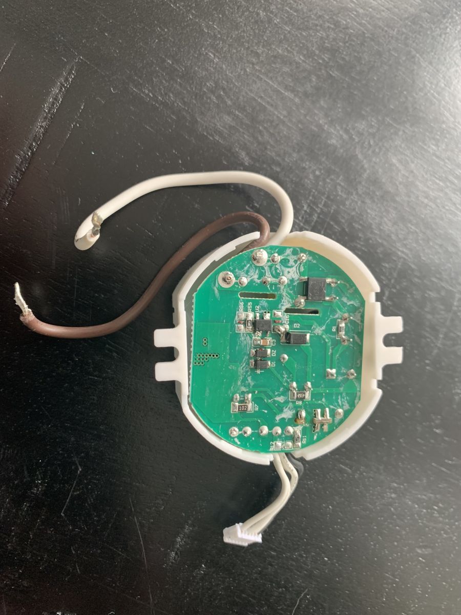

    Product marking LED driver: "LED Driver, CL20W WiFi-RGB"
    Tuya module in LED driver: "WBLC5" Datasheet
    The Tuya module drives the SM2135 LED driver via pins 24 and 26.
    Tuya cloudcutter
    "Select the firmware version and name: 1.1.6 - BK7231T / oem_bk7231s_light_ty"
    "Select the brand of your device: LSC"
    "3004919 970706 GU10 RGBCT Bulb v1.1.6"
    "Selected Device Slug: lsc-3004919-970706-gu10-rgbct-bulb-v1.1.6"
    "Selected Profile: oem-bk7231s-light-ty-1.1.6-sdk-2.0.0-30.06"
    Led driver
    The lamp uses a "sm2125" led-driver with data-pin=P24 and clock-pin=P26. I'm unable to read the small print, but this is the only i2c driver which I found to be working.
    Channel mapping: 0=green, 1=blue, 2=red, 3=cold-white, 4=warm-white
