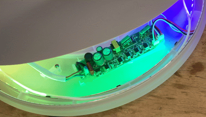

  • LSC Smart Ceiling Lamp model 3206306 with a WS2812 RGB LED ring gets flashed with OpenBK firmware.
  • A USB-to-UART converter and a short script set SM16703P, run SM16703P_Init 16, and enable PixelAnim so the WS2812/SM16703 LEDs work with the PWM CW strip.
  • The script uses P16, the BK7231 hardware SPI output, for the WS2812 connection.
  • The lamp runs cloudfree and pairs with Home Assistant, and the same approach also works for RGB-only lamps and WS2812 strips.
  • Home Assistant animations integration is still WIP.

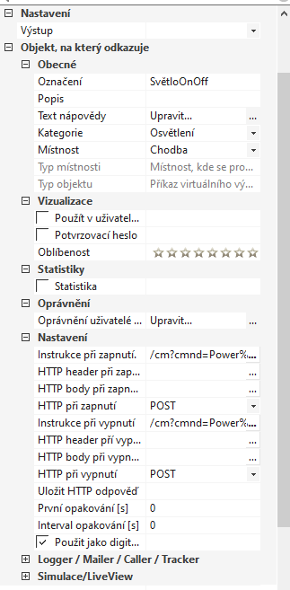

Loxone HTTP request 200 OK, but light could stay off User said same style worked on Tasmota lights

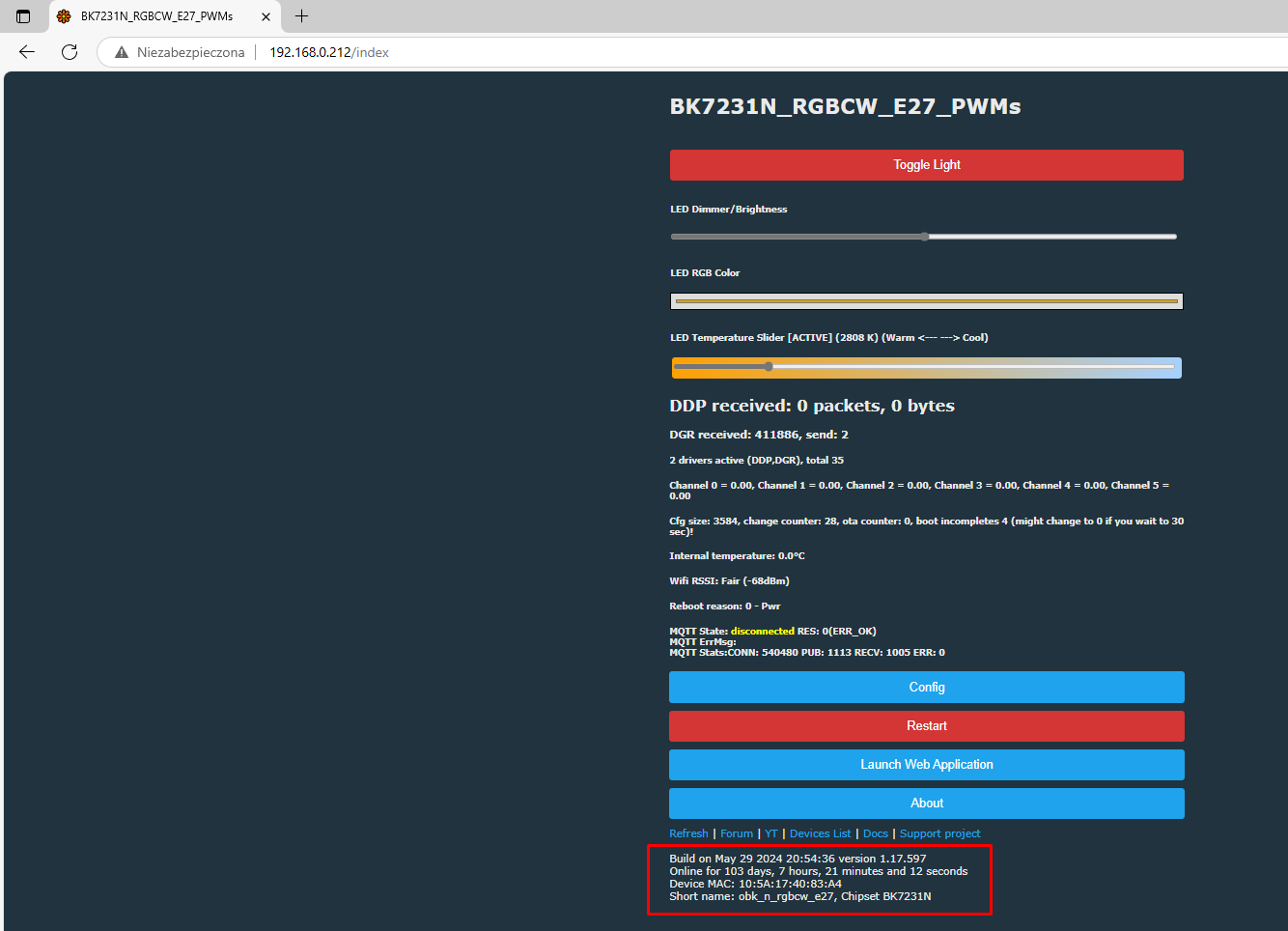

  • Restore-state behavior can be changed with flags. After adjusting them, one user confirmed power-loss recovery started working for on/off and remembered state. [#21450897]

  • One interoperability failure is repeatable: Loxone requests returned HTTP 200 OK yet did not switch the lamp, while the same command worked from Firefox and later worked after adding browser-like headers. [#21559410]

Why doesn’t my OpenBK-flashed lamp restore its previous on/off state, RGB color, and white color after a power loss, and which flags control that behavior?
It usually fails because the restore-state flags are not enabled. In this thread, changing the relevant flags fixed power-loss recovery for a user who wanted Tasmota-like behavior for on/off and remembered light state. The developer directly asked whether that option was enabled in flags, and the user replied that manipulating flags made it work. [#21450934]

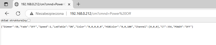

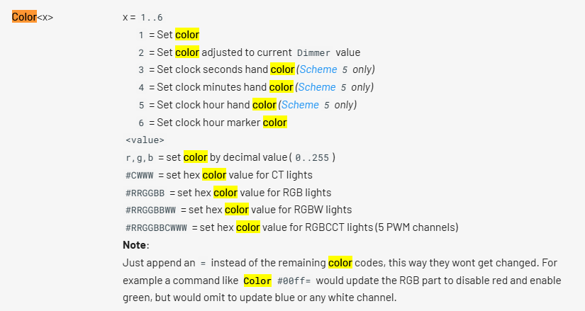

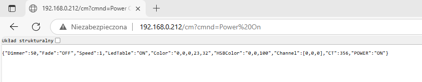

How does Tasmota interpret the HTTP color command for RGBCW lights compared with OpenBK, especially for values like 255,255,255,255,0 and 0,0,0,255,0?
In this thread, Tasmota treated both 255,255,255,255,0 and 0,0,0,255,0 as the same Cool White output. OpenBK did not initially mirror that behavior, which is why the developer questioned whether OpenBK should ignore RGB values when CW is present and said he could adjust it to match Tasmota better. That difference matters if you reuse older Loxone or Tasmota HTTP presets unchanged. [#21485696]

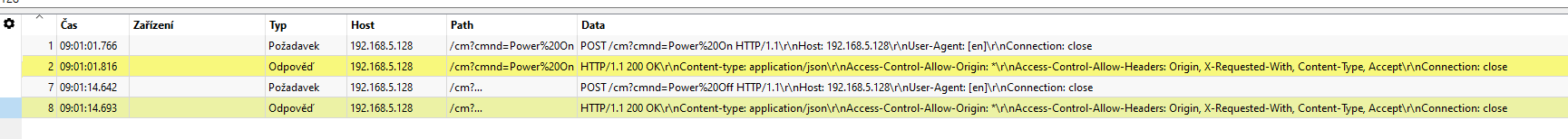

Why do HTTP on/off commands from Loxone return 200 OK in OpenBK but fail to switch the light, while the same URL works from Firefox?
The thread points to an HTTP-request compatibility mismatch, not a basic power command error. One user reported that OpenBK returned 200 OK to Loxone but left the lamp dark, while the same URL switched the light correctly from Firefox. The later breakthrough was that copying browser-generated headers made the request work, which strongly suggests OpenBK accepted the connection but handled the minimal Loxone request differently. [#21559410]
How can I capture and compare the full HTTP request headers from Loxone and Firefox to troubleshoot OpenBK compatibility issues?
Capture the working browser request first, then compare it line by line with Loxone. 1. Open Firefox DevTools with F12. 2. Send the working cm?cmnd=Power%20On request and copy the full headers. 3. Post both the working and failing headers in a code block for comparison. The developer explicitly asked for the full headers and request to reproduce the issue. [#21559846]
Why would adding browser-like HTTP headers make OpenBK commands work from Loxone, and which headers are most likely required?
It worked because OpenBK appeared to accept Firefox-style requests more reliably than Loxone’s minimal request format. The user reported that once they inserted headers generated by Firefox, the lamp started responding correctly. The thread does not identify the exact required header, so the safest conclusion is that one or more standard browser headers or request-line details changed OpenBK’s request handling. [#21559410]
