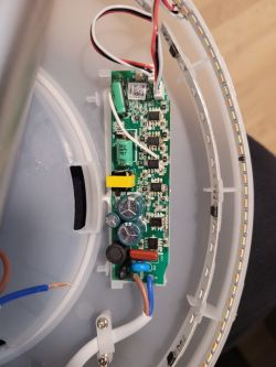

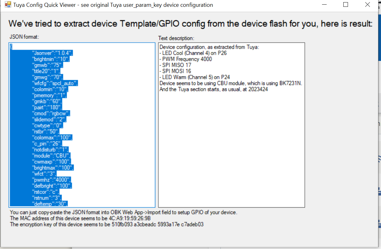

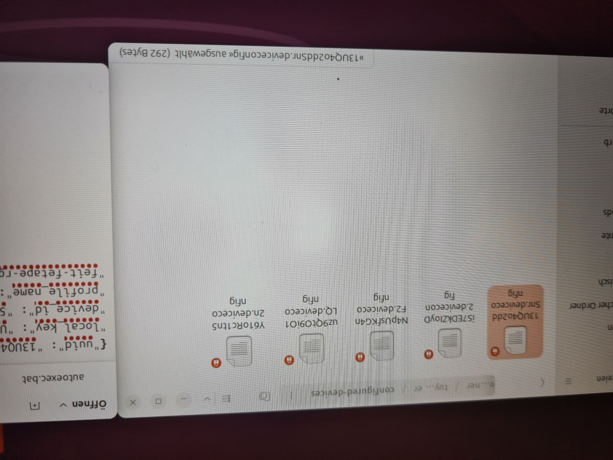

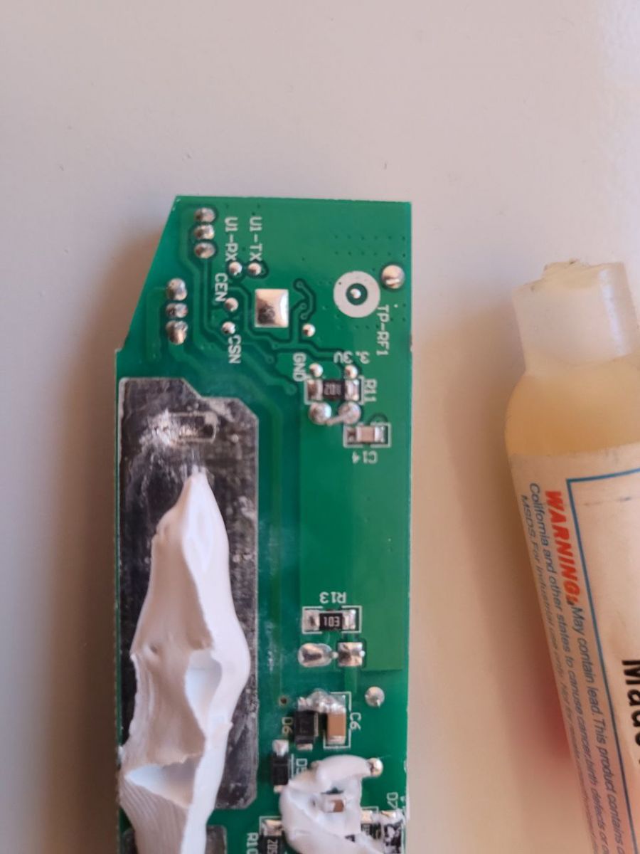

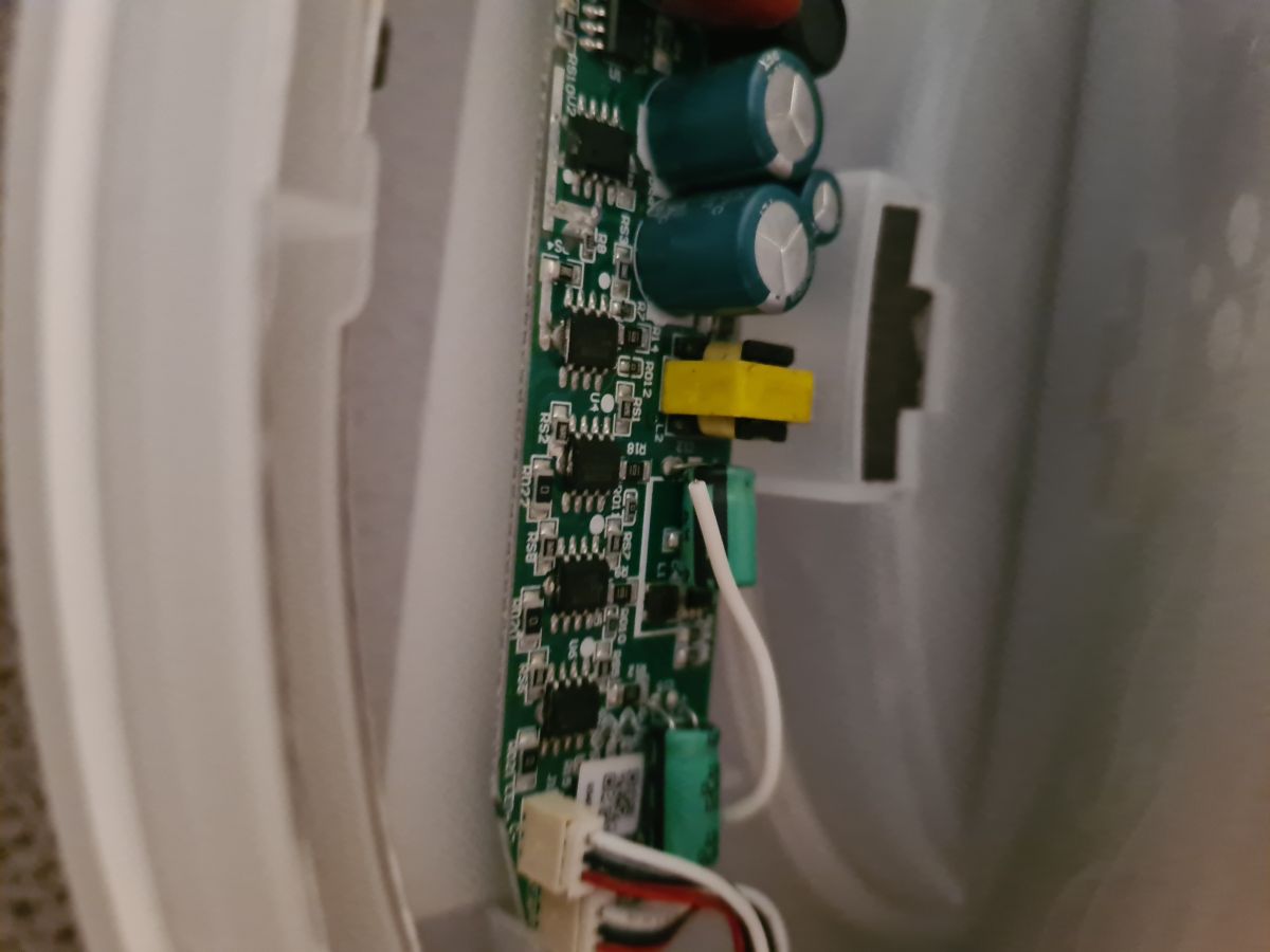

    Hello!
    I'm presenting a new model of ceiling lights from Action. It has two sets of lights: the normal and an RGB one that is lighting up the ceiling. It can be found below: https://www.action.com/de-at/p/3206306/lsc-smart-connect-smarte-deckenlampe/.
    It has the chip soldered directly to the main PCB, but there are PCB traces that can be used for flashing. The lamp can be opened by prying up the side margin.
    Screenshot of Tuya device configuration with JSON data Close-up of the main circuit board of an electronic ceiling lamp. PCB with labels for RX and TX pins. Interior view of a ceiling lamp with a PCB and wiring.
    JSON Config:
    It also requires an autoexec.bat file as instructed here:
    https://www.elektroda.com/rtvforum/find.php?q=SM16703P

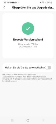

    #4 21367252
    kontaktgruppeninterv
    Level 4  
    Posts: 8
    Hello, did I understand correctly that I have to serial flash it (solder pins to uart adapter?)
    I just can't manage to flash it with cloudcutter ota, I messed something up it doesn't write the firmware ota. I am so confused please help :(>>21361729
    I just can't manage to flash it with cloudcutter ota, I messed something up it doesn't write the firmware ota. I am so confused please help me :(
    I used the recently added profile on github which is linked by the previous person.

  • #6 21367732
    Level 4  
    Posts: 8

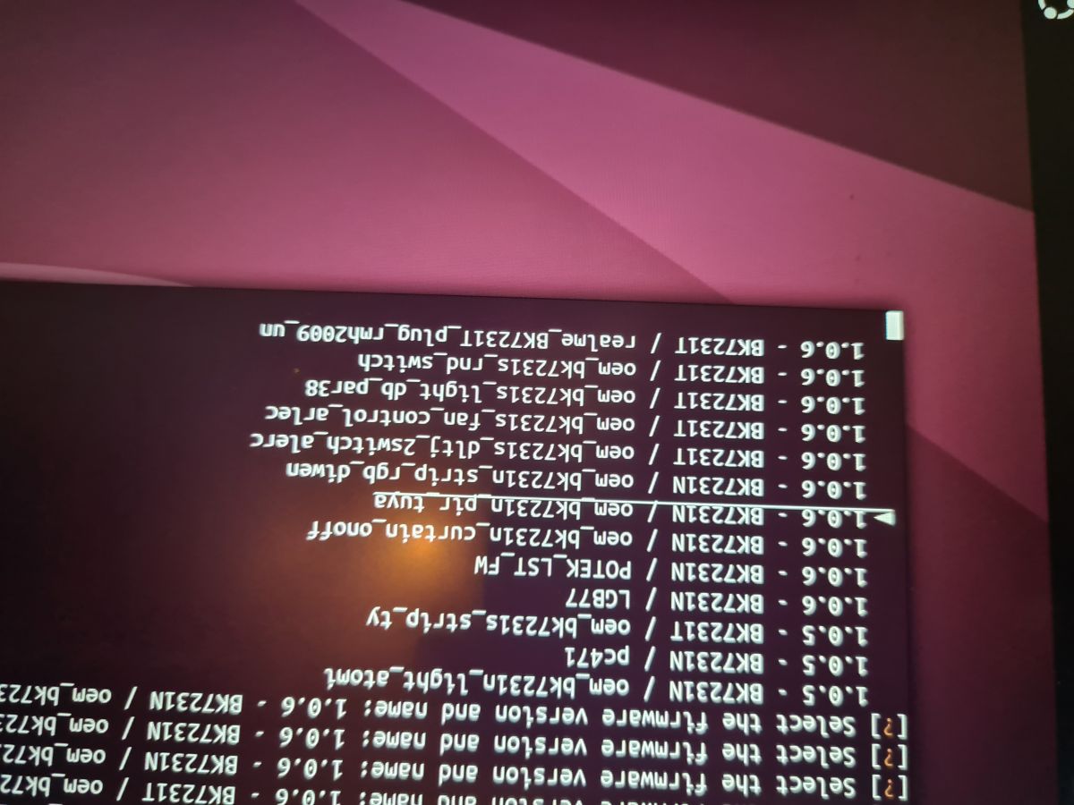

    >>21367258 sorry I don't want to be annoying but I am genuinely lost. It says Version 1.0.6 and there are many devices in cloudcutter which I can't identify. Now I don't know what to choose
    Or I have a feeling that I am misunderstanding something completely.
    Terminal screen displaying upside-down text.
  • #7 21367789
    Posts: 5234
    Help: 449
    Rate: 918
    I don't think it matters too much as long as the firmware version matches your device. If you're flashing to OpenBeken Cloudcutter won't configure the device anyway, so you'll need to set it up still after conversion.
    I'd go for oem-bk7231n-strip-rgb-diwen-1.0.6-sdk-2.3.1-40.00

    #8 21367879
    Level 4  
    Posts: 8
    >>21367789
    Hello thank you very much for your fast response!

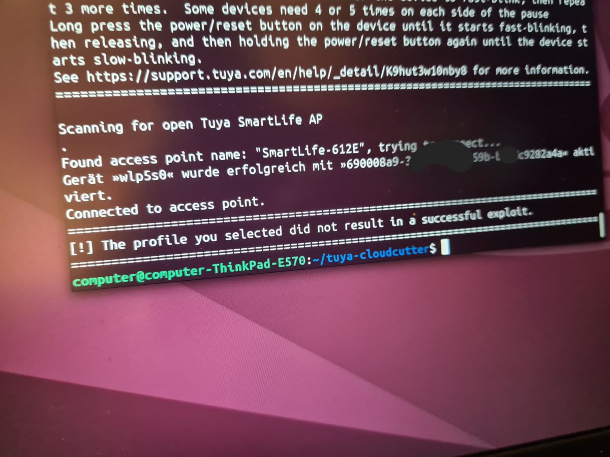

    Now I chose that but it said the profile you selected did not result in a successful exploit.
    What am I doing wrong? Could it be that I used smartlife app with a Dummy AP? I made Hotspot on my PC so I don't have to type in wifi credentials in smartlife app / lsc app.
    Also I added autoexec.bat in custom firmware directory and the BK7231N.rbl firmware (next to the stuff that was already inside) for ota Flash.
    Otherwise I am lost. Any ideas?

    and the firmware of your device is definitely v1.0.6?
  • Flash likely failed despite config export success
    #10 21367943
    Level 4  
    Posts: 8
    >>21367926

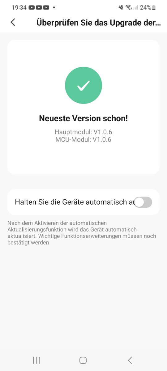

    Yes, but I just saw above the failed Config thing that it was a success and that it exported something to a folder configured devices (I closed already unfortunately)
    Edit: still controlable with lsc smart home app. So flash not successfully I assume :( I don't get what I am doing wrong. The device was also recently added in github or so and it just doesn't work to Flash. I really try to avoid soldering
    Screenshot of an app showing the device is already updated to the latest version. Device update screen showing the latest version of the software installed. Computer screen menu with files in the configured devices directory.

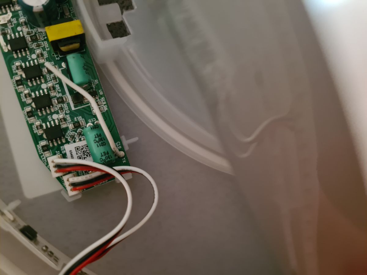

  • Serial flashing chosen over solderless method
    #12 21368152
    Level 4  
    Posts: 8
    >>21368053
    Thank you very much for your help. I decided to flash it serial with soldering.
    Now I have a last question please, is that cable supposed to be inside that lamp hanging around? In OP pic it looks like it's soldered to that chip. Cable comes outside from a tx solder point. If I really correctly it is fine like that as the pin is only used for writing stuff which is not intended for customer. In other words, just ignore right? Interior of an electronic lamp with visible circuit board and soldered wires. Close-up of internal wiring and circuit board in a hanging lamp.

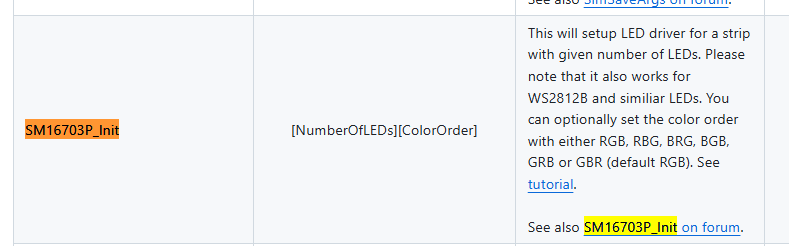

    kontaktgruppeninterv wrote:
    Also, I noticed something strange. When I set color to Red then it is green. I did the autoexec.bat, added Set pwmfrequency 4000 command in autoexec after the led driver init line. I think I have set good flags but messed it up again because I tried to reapply the config pins etc.I uploaded a video from the lamp so you can see
    try different colour orders. add RGB, BRG etc to the init line
    eg
    Added after 58 [seconds]:
    https://github.com/openshwprojects/OpenBK7231T_App/blob/main/docs/commands-extended.md
    Screenshot of documentation about LED settings showing function SM16703P_Init with options like RGB, RBG, etc.

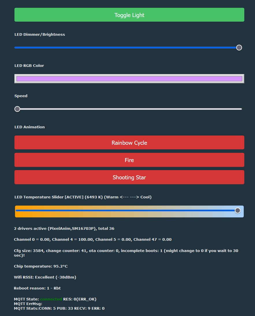

  • Backup dump and PixelAnim driver configuration
    #16 21369901
    Posts: 14793
    Rate: 12940
    My piece backup:
    https://github.com/openshwprojects/FlashDumps/commit/e77fed2497610af66b64df040b3f2cd4b6ac8025
    This device features:
    - CW LEDs (two PWMs)
    - SM16703 LEDs (P16)
    It works great when configured with PixelAnim driver:
    https://www.elektroda.com/rtvforum/topic4057187.html
    There will be a video tutorial about that on Elektroda channel:

  • OTA update and flag reset fixed the lamp
    #17 21374211
    Level 4  
    Posts: 8
    >>21369287
    This did the trick for me ota to new release and setting flags again carefully. thanks a lot for your help!
    The only thing strange is that sometimes it makes weird sounds like a short click sound. like if you put 2 wires together and it makes that short spark sound from time to time. when using it first time it happens sometimes but it got less and less. kinda weird lamp lol. but it is okay for its money, it was for 12€ on promotion. i will check solder points again. temperature is about 80 degrees celsius while operating.
    Added after 17 [minutes]:
    95degrees celsius now.. is that normal? honestly i think its way too hot, but i am not sure. what are your lamps reporting? mine is running maybe an hour or two maximum
    Software interface with LED light control options.
