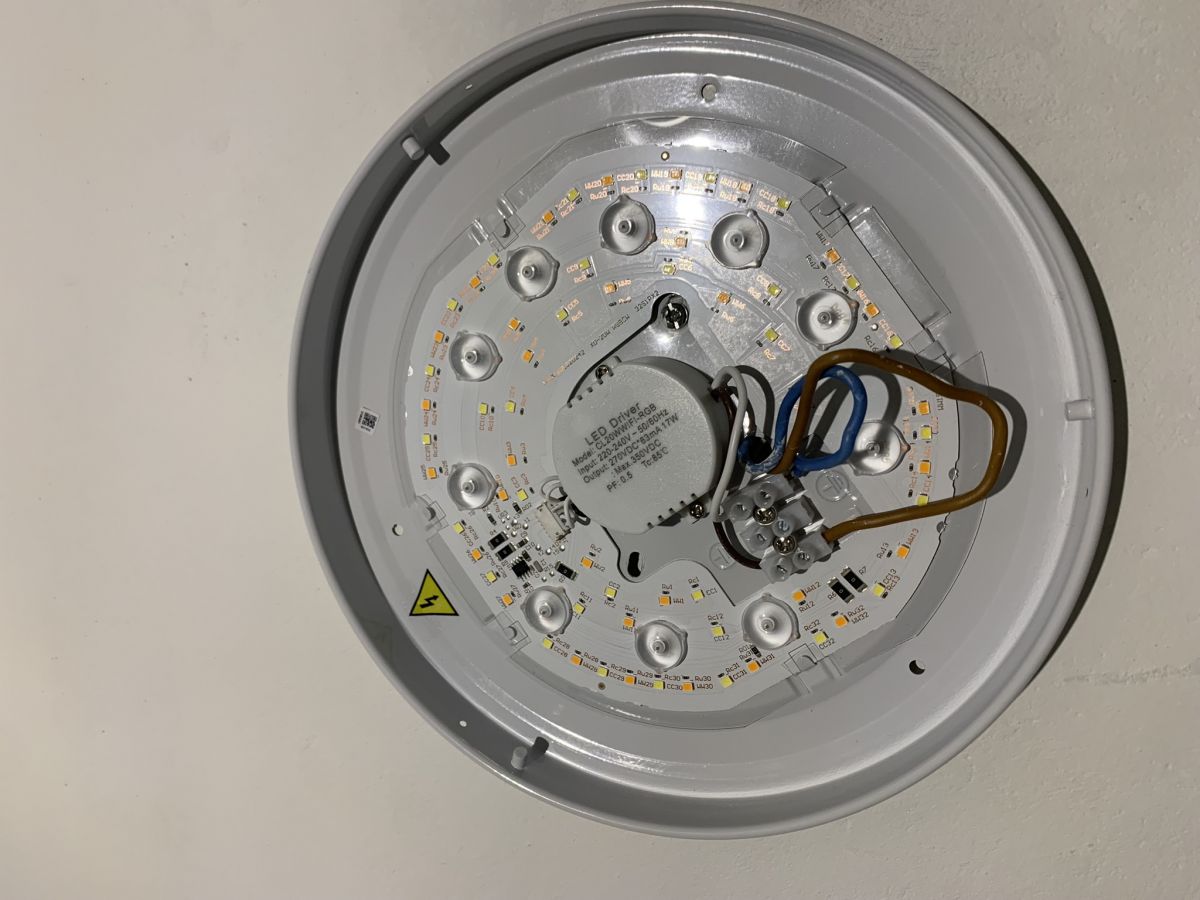

    I've successfully flashed my LSC Smart Ceiling Light using Tuya Cloudcutter and connected it to Home Assistant.
    I bought this ceiling light a few years ago in the Netherlands at the shop "Action".

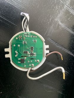

    Product marking LED driver: "LED Driver, CL20W WiFi-RGB"
    Tuya module in LED driver: "CBLC5" Datasheet
    The Tuya module drives the SM2135 LED driver via pins 24 and 26.

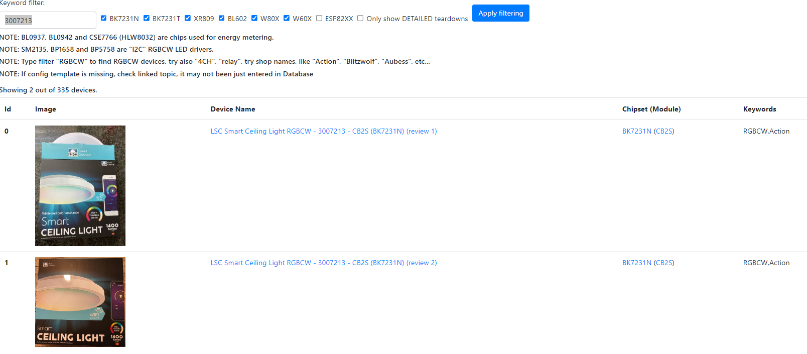

    Thank you, that's a very nice teardown. It's good to see another LSC device.
    Interestingly enough, it seems to be different from 3007213 that we have on our list:
    LSC Smart Ceiling Light (CBLC5, BK7231N, v1.2.16, SM2135) Flashing & Connecting to Home Assistant
    The LEDs PCB seems different. Still, it is good to know that the Cloudcutter profile is still working for that one.

    I've just submitted another tear-down of another ceiling light. I bought them both at Action a few years apart. The LED PCBs are similar, but different MCU modules were used.
