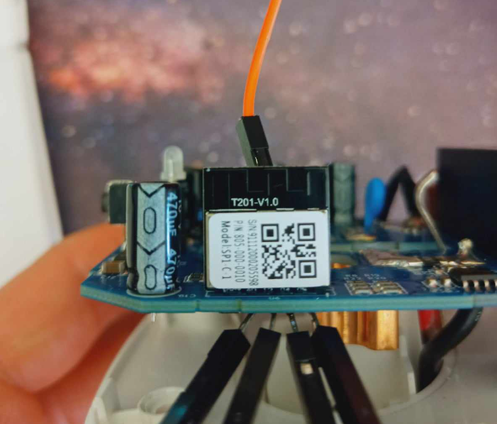

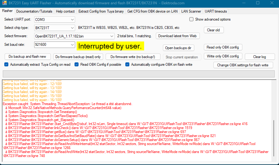

    Hello, I tried to flash my SHP-2 Smart socket but I don't know how to power on/off when it's written:
    Getting bus... (now, please do reboot by CEN or by power off/on)
    Getting bus failed, will try again - 0/100!
    Getting bus failed, will try again - 1/100!
    Getting bus failed, will try again - 2/100!
    Getting bus failed, will try again - 3/100!
    Getting bus failed, will try again - 4/100!
    Getting bus failed, will try again - 5/100!
    Getting bus failed, will try again - 6/100!
    Getting bus failed, will try again - 7/100!
    Getting bus failed, will try again - 8/100!
    Getting bus failed, will try again - 9/100!
    Reminder: you should do a device reboot now (do power off/on of the device, but don't disconnect UART or do a CEN short to ground for 0.25sec)
    If I try to on/off, it stops the process because the COM3 where my device is, is disconnected OpenBeken for Blitzwolf SHP-2 Smart Socket? T201-V1.0 WiFi module, ESP8266 or BK7231

    Hello @quaduor , to the best of my knowledge, the Blitzwolf series is still using ESP8266 modules. I have reviewed quite a lot of Blitzwolf products in the past.
    Can you post some high quality photos of your device?

    I saw that it's an ESP8285 and I don't know what firmware for open BK will work.

    For ESP8266, we recommend using Tasmota firmware with esptool.py. OpenBeken does not support the ESP platform currently. We are currently supporting BK7231T, BK7231N, BL602, XR809, W600, and W800 platforms, but not ESP.
    Please try to flash it with Tasmota and let me know if it works.
