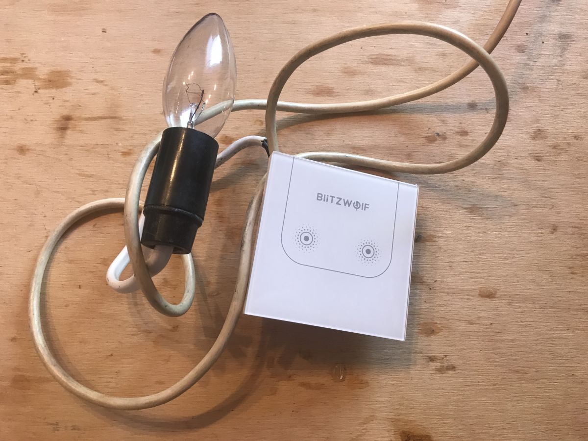

    Running the BW-SS3 switch .
    I ran the switch loose to be able to comfortably check how it works and take measurements.
    I made the connections according to the diagram:
    Test and interior of the BW-SS3, a WiFi light switch from Blitzwolf .
    My connections (I only used one bulb):
    Test and interior of the BW-SS3, a WiFi light switch from Blitzwolf Test and interior of the BW-SS3, a WiFi light switch from Blitzwolf .
    The switch was already functional without pairing it with a Blitzwolf phone/account via WiFi:

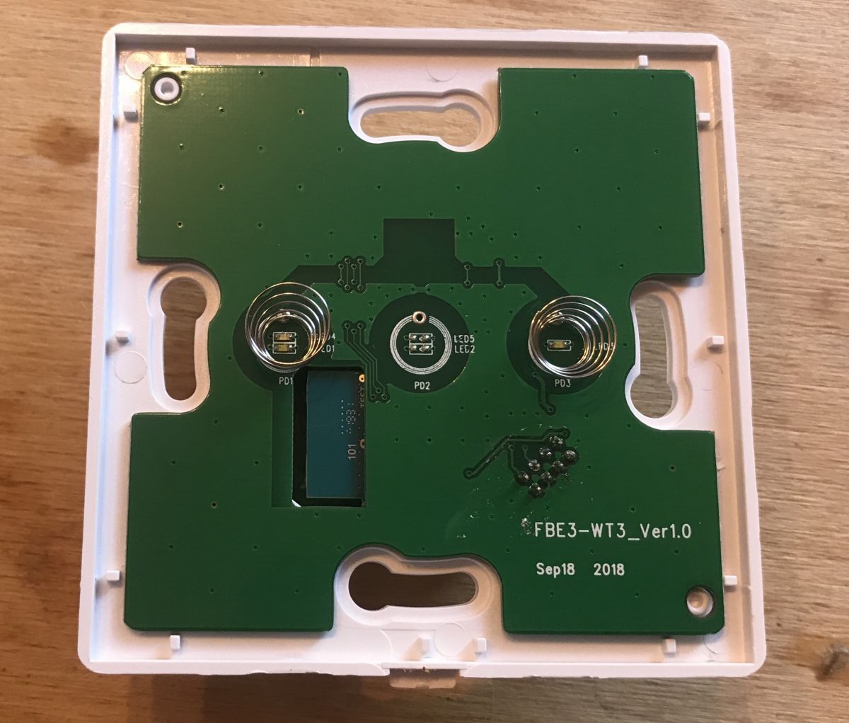

    It is then immediately apparent that the manufacturer uses one type of board for all three types of switch (they just don't solder all the components and contacts):
    Above you can also see the four holes used to mount the switch in the box.
    The board is signed FBE3-WT3-Ver1.0 Sep18 2018.
    The board on the top is not attached to the rest of the socket in any way - it just holds onto the eight-pin 2.54mm connector (2 rows of 4 pins each):

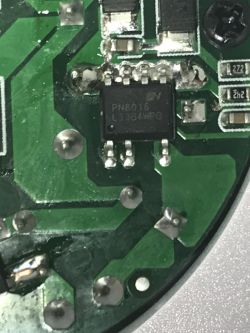

    Just behind is the PN8016 manufactured by Chipown:
    This is the so-called "Non-isolated Off-line PWM converters Width Modulator (PWM)", a converter circuit without galvanic isolation.
    PN8016 application diagram:
    It is this circuit that converts the 230V mains voltage into a 3.3V supply for the WiFi module and relays.
    I couldn't find the PN8016 datasheet note in .pdf format, the only link to it was dead, and I got the screenshots above from sales listings for this circuit from the web.
