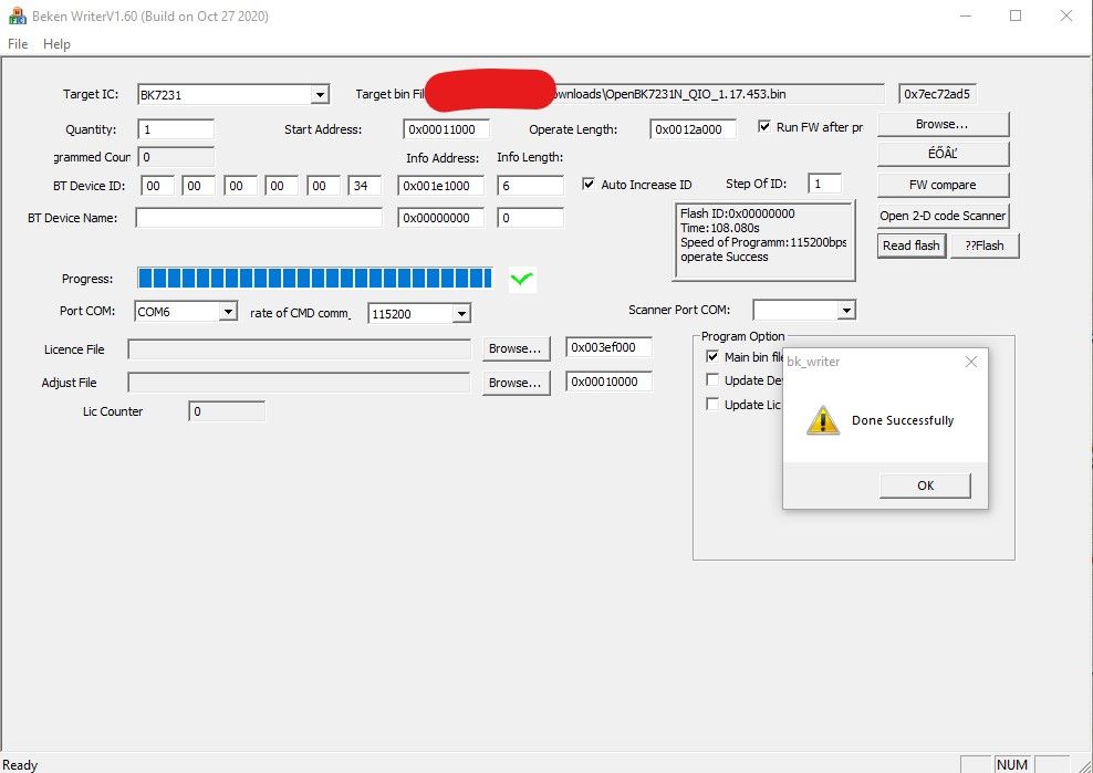

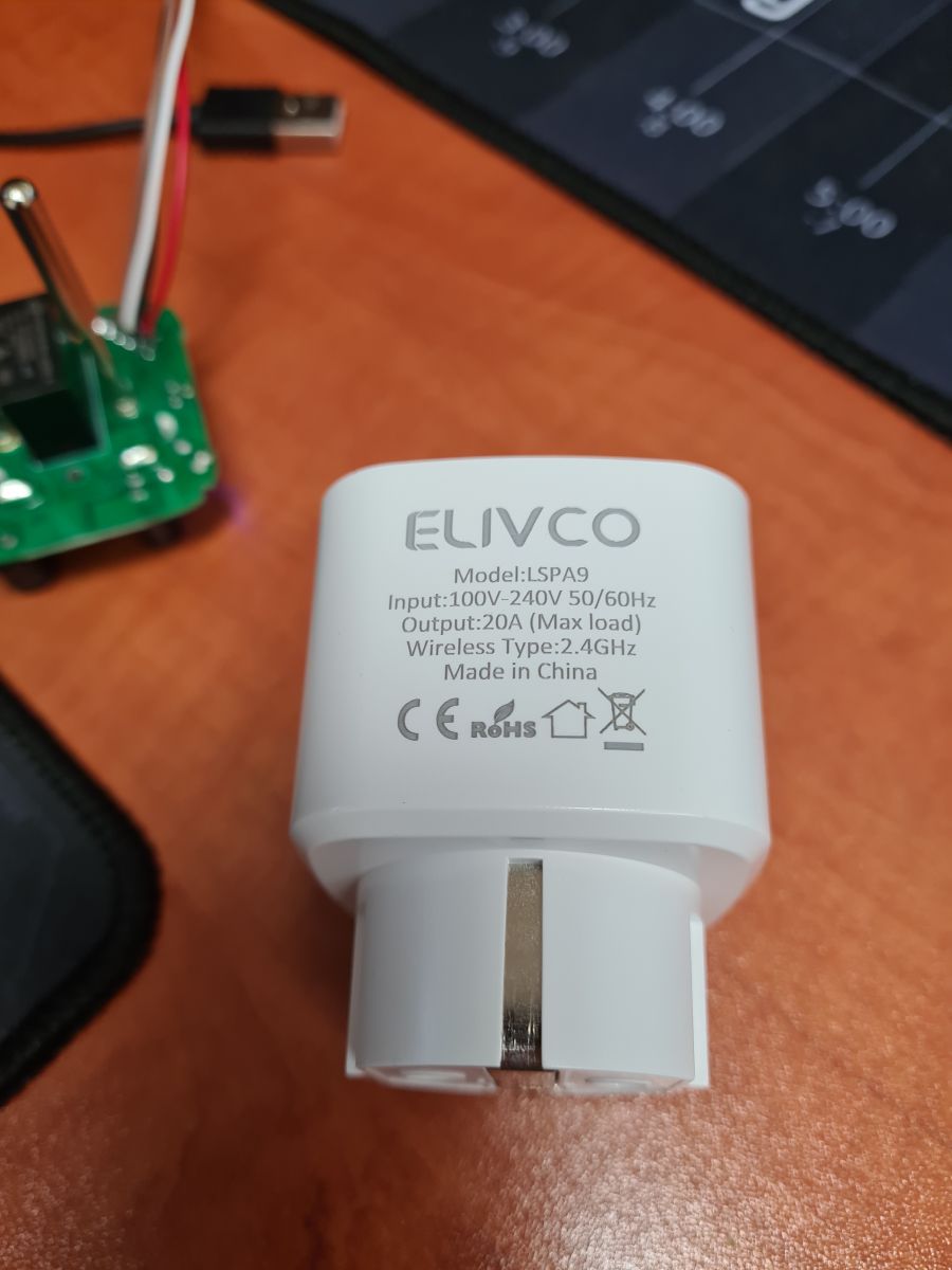

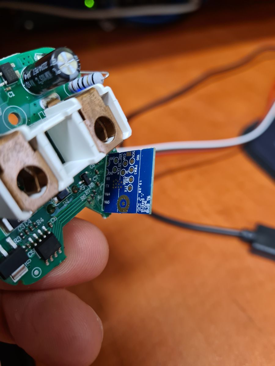

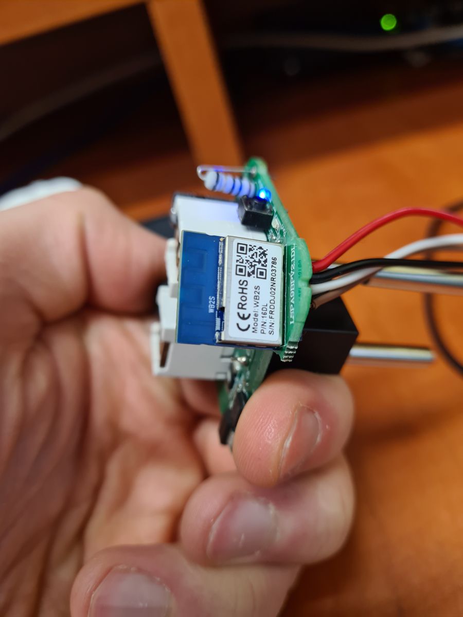

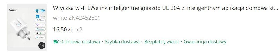

    Hello, I have just received two WB2S sockets with BL0937, in which I am trying to install OpenBeneka, but without success.
    Screenshot showing an offer for the EWelink UE 20A smart Wi-Fi plug.
    https://pl.aliexpress.com/item/1005005979222799.html

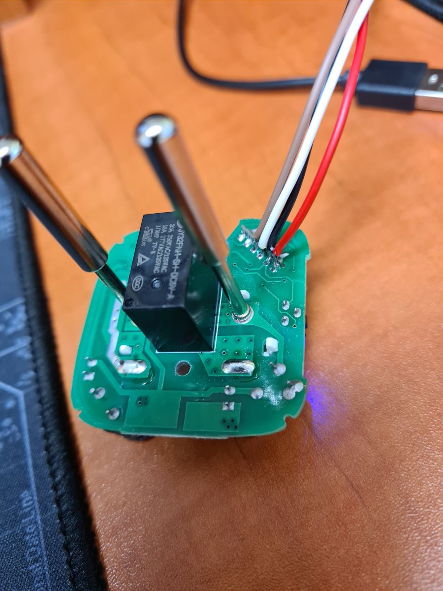

    Image of a circuit board with attached wires. Close-up view of an ELIVCO smart socket with technical specifications. The image shows a circuit board with electronic components, held in a hand. Close-up of an electronic module held in hand.

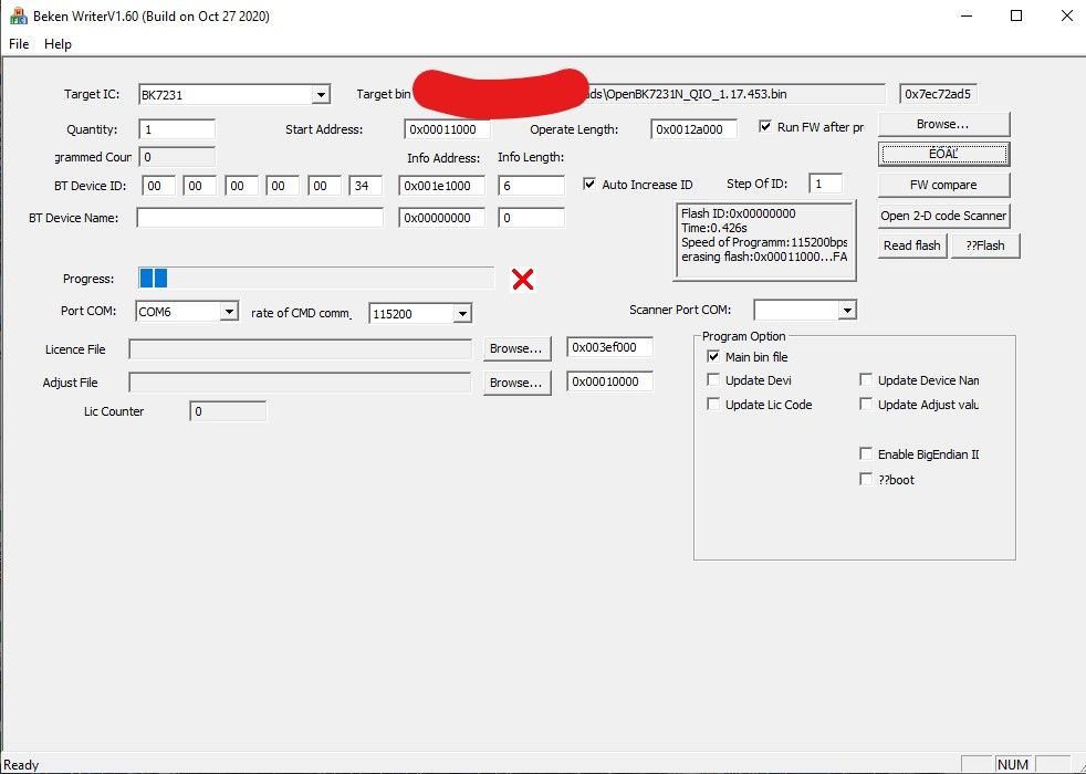

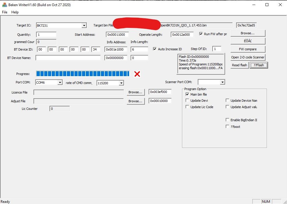

    When reading flash, everything goes fine, although it takes over 100 seconds. When trying to upload the current version of OpenBK7231N_QIO_1.17.453.bin it is already FAILED.
    Screenshot of Beken Writer V1.60 software used for firmware flashing. Screenshot of Beken Writer software for programming the BK7231 microcontroller. Screenshot of Beken Writer software during OpenBK7231N flashing attempt.
    What could be wrong?

    Using bkWriter 1.60 is not recommended. The new flasher does better, also being able to detect Tuya configuration automatically:
    In addition, from the post, it seems that you are uploading the N version on the T platform (WB2S is BK7231T). This will not work.
    Use the correct flasher for the BK version you have (you have WB2S, so BK7231T), if it still won't move then solder WB2S and program off-chip.
    In this video we show you how to solder the chip:

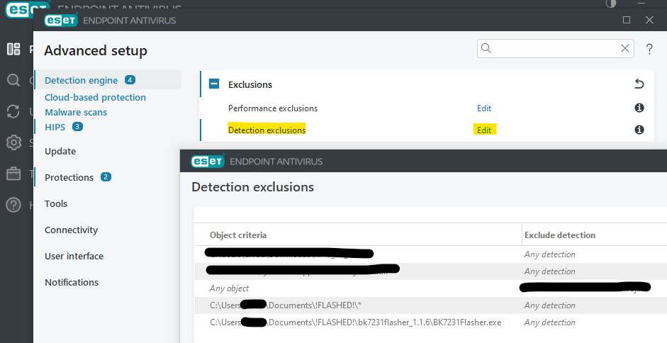

    Of course it works :) it's a pity that on startup, Eset Live Grid threw it out as a suspicious file when I tried to run it, because I was trying it on, but after that action I let it go :) no less, let loose outside the network on a separate laptop, it did the job.

    >>20951233
    Screenshot shows advanced settings in Eset Endpoint Antivirus with the detection exclusions tab open.
    I had to add exclusions to Eset

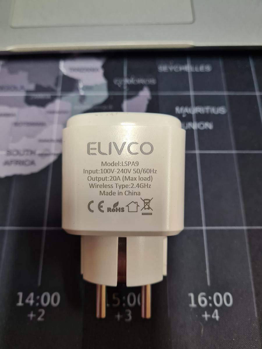

    Looking at the GPIO Finder, I see that driving the relay itself will turn off the red diode, so it would have to be cut off from the GPIO as the relay and driven separately, as you suggested.
    Added after 2 [hours] 8 [minutes]:
    View of an ELIVCO LSPA9 smart plug lying on a world map.
    Below is the template, without a photo because the sockets were left at work, I will complete it tomorrow :) There is already one in the template database, but it is from CB2S and the pinout is different than mine. If there`s anything else missing, let me know and I`ll fix it
