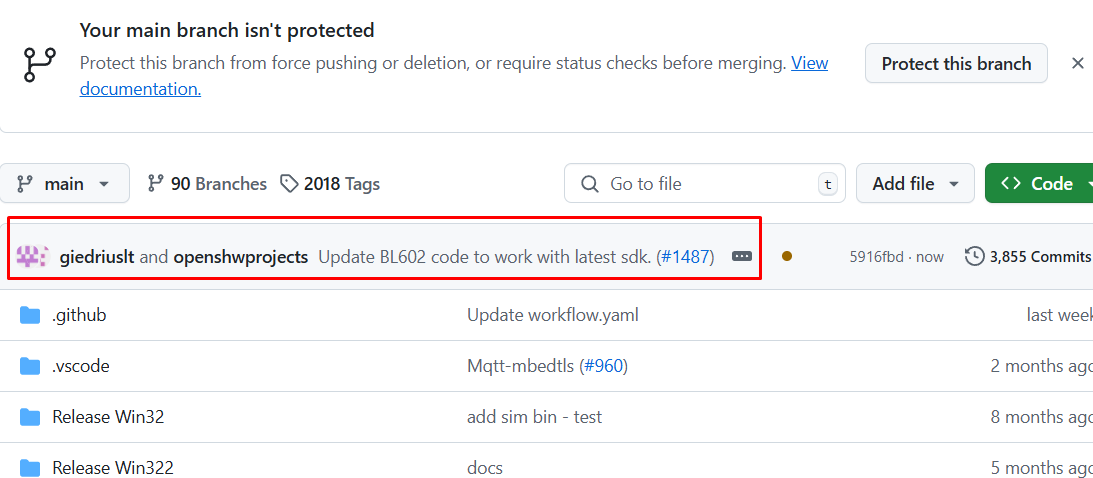

    Hello everyone.
    I have SM-028_V1.3. OpenBL602. Flashed OpenBeken release 1.18.94. Set up Ping watchdog with an interval of 20 seconds.
    My router reboots every night. This is necessary because my Internet disappears every night when the provider reboots its equipment. And the Internet does not work until you reboot the router. After flashing SM-028_V1.3, my WiFi connection disappears every night. After rebooting the router at night SM-028_V1.3, it does not connect to WiFi until you unplug it and plug it back in again. Then it connects quickly and without problems. Sorry if I wrote in the wrong topic.
  • #8 21537100
    Posts: 14725
    Rate: 12809
    We've updated BL602 SDK today, please try the new version.
    View of a GitHub repository section showing a warning about the main branch not being protected, with a file and folder list below.

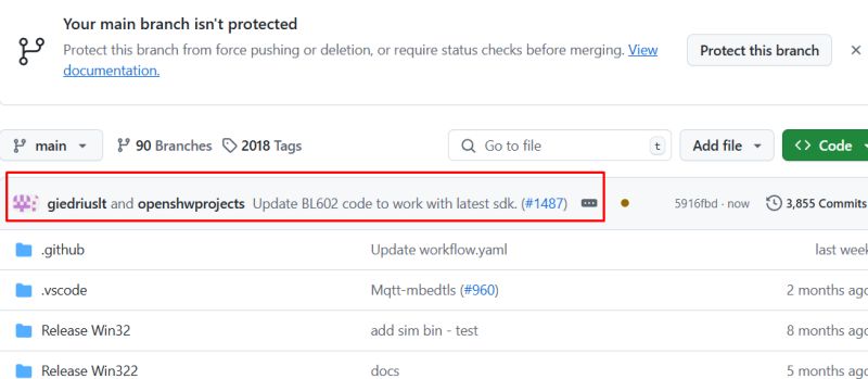

  • #9 21537530
    Zorlak
    Good morning. Yesterday I installed OpenBeken release 1.18.96. Everything is working fine this morning. I’ll wonder how it will turn out.
