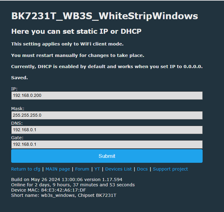

    ok let me check this. My settings:
    BK7231T network configuration interface with IP and DHCP settings.

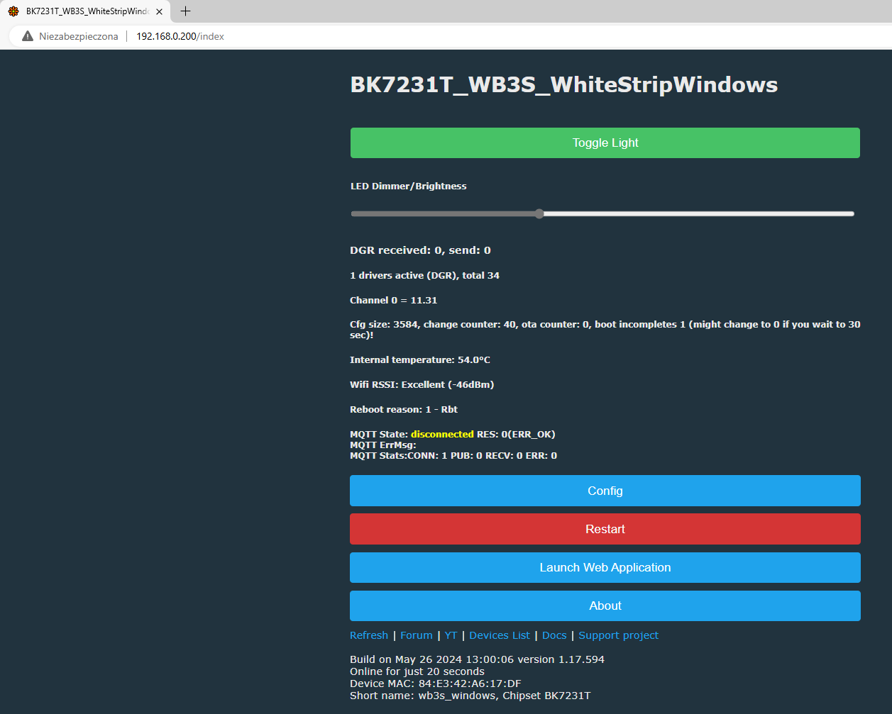

    after reboot:
    BK7231T driver interface with configuration options
    Well, it clearly works on my side...
