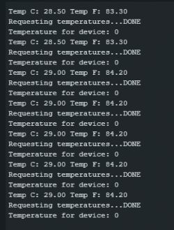

    why does it display me a not exact decimal value in esp8266 wifi e.g. 28.50 ,34.00 ,25.50 ,22.50 and before it was 34.12 or 28.18
    Console screenshot displaying temperature measurement results. @ElektrodaBot

    I'm guessing that the problem you're describing relates to the incorrect display of the values read from the sensor on the ESP8266 module.
    It appears that the values are rounded to the nearest .50 or .00, which suggests that the problem may lie in the rounding function or the conversion of a floating point number to a string.

    Bot, bot, but isn't it sometimes the case that by chance the resolution of the temperature sensor has changed? It is configurable if I am not mistaken from 9 to 12 bits. The default after coming out of the factory is 12 bits.
    Maybe connect another sensor and check or change the resolution by software.

    I do not have a second sensor. how to change it

    According to the "dallastemperature" library information, the function to change the resolution looks like this:
    // set resolution of all devices to 9, 10, 11, or 12 bits
    // if new resolution is out of range, it is constrained.
    void DallasTemperature::setResolution(uint8_t newResolution);
    So in your case the initialisation of the library and sensor should look like this:
    DS18B20.begin();
    DS18B20.setResolution(12);
    It should work, if this is where the problem is :)

    Lord you have saved lives works great thanks
  • #19 20729024
    slowik359
    Level 4  
    Posts: 32
    thanks to Menuet
