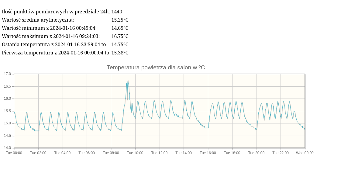

    This is what the temperature check looked like in January at my house:
    Wi-Fi thermometer with ESP8266 and DS18B20 - an alternative programming approach .
    The sensor performed brilliantly.
