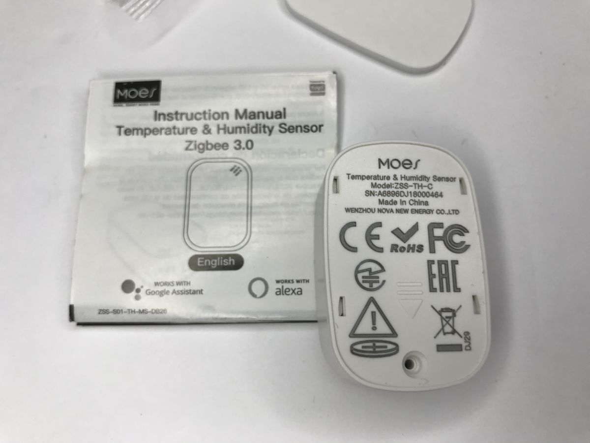

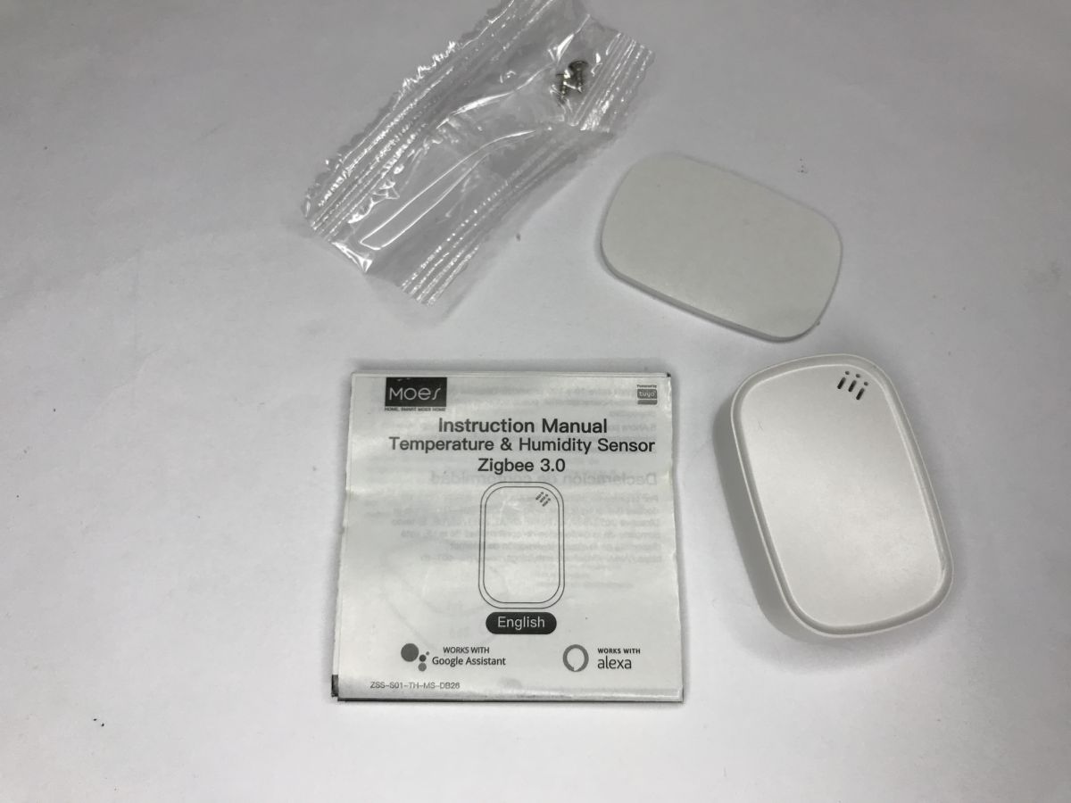

  • Zigbee temperature and humidity sensor kit: manual, sensor, adhesive pad, small bag of screws

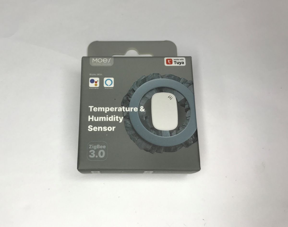

    Which temperature and humidity sensor for the Home Assistant? The sensor shown here features tiny dimensions of 40x13x26 mm and is powered by a single CR2032 battery. It normally works with the Tuya/Smart Life gateway, but Zigbee2MQTT also supports it. Here I will briefly test it, show its pairing and explore its internals.
    Box of the Moes ZigBee 3.0 temperature and humidity sensor with “works with Tuya” label on a white background Side view of a gray box with a “WARNING” label about coin/button battery ingestion hazard Zigbee temperature and humidity sensor kit: sensor, manual, adhesive pad, and screws. Instruction sheet and back of a MOES Zigbee 3.0 temperature and humidity sensor on a white surface

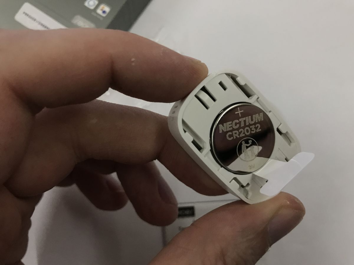

    The kit comes with the sensor, a thin strip of double-sided tape and tiny mounting screws. There's also a battery - suitably protected with an insulating strip so that the sensor doesn't discharge it in transit.

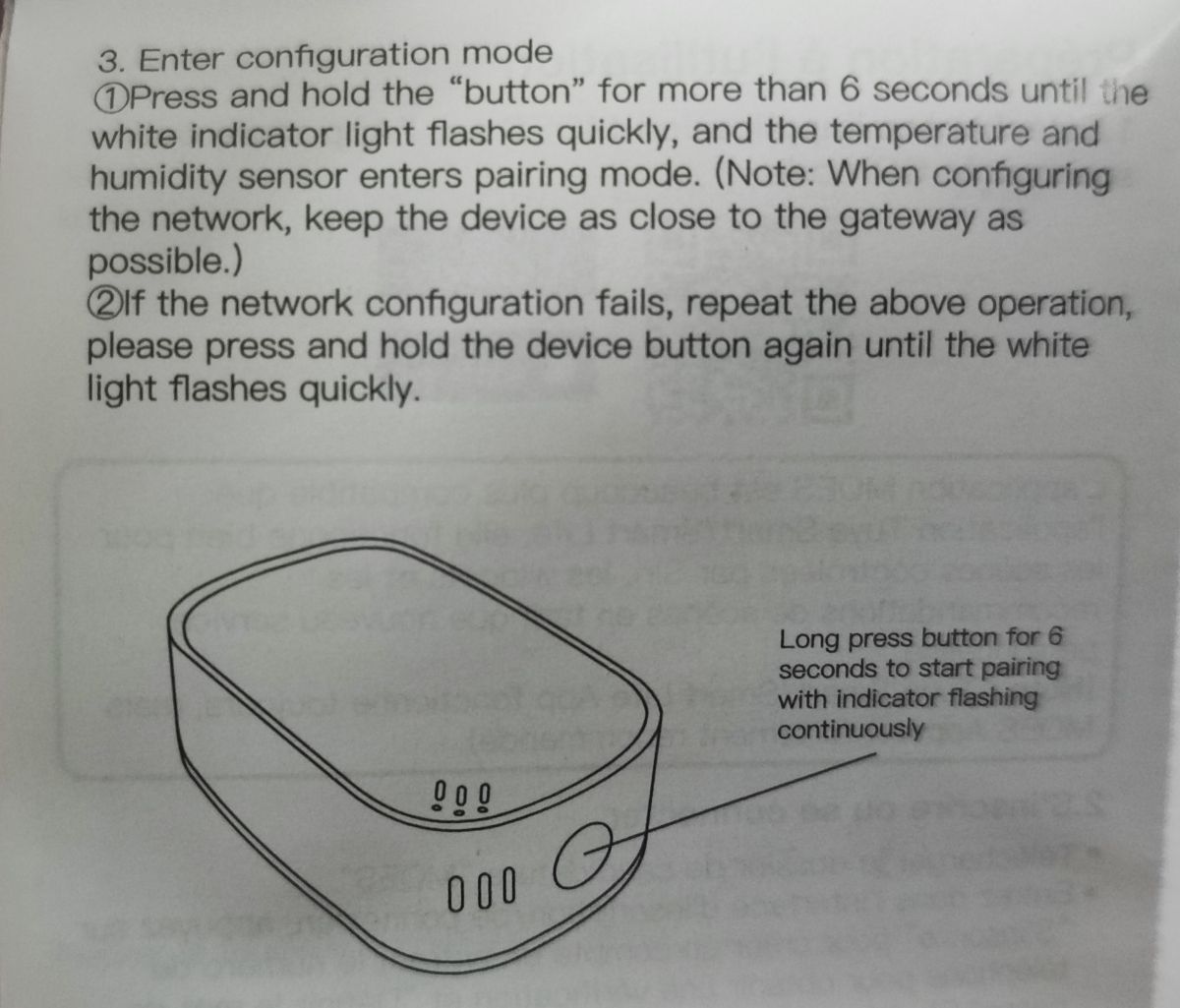

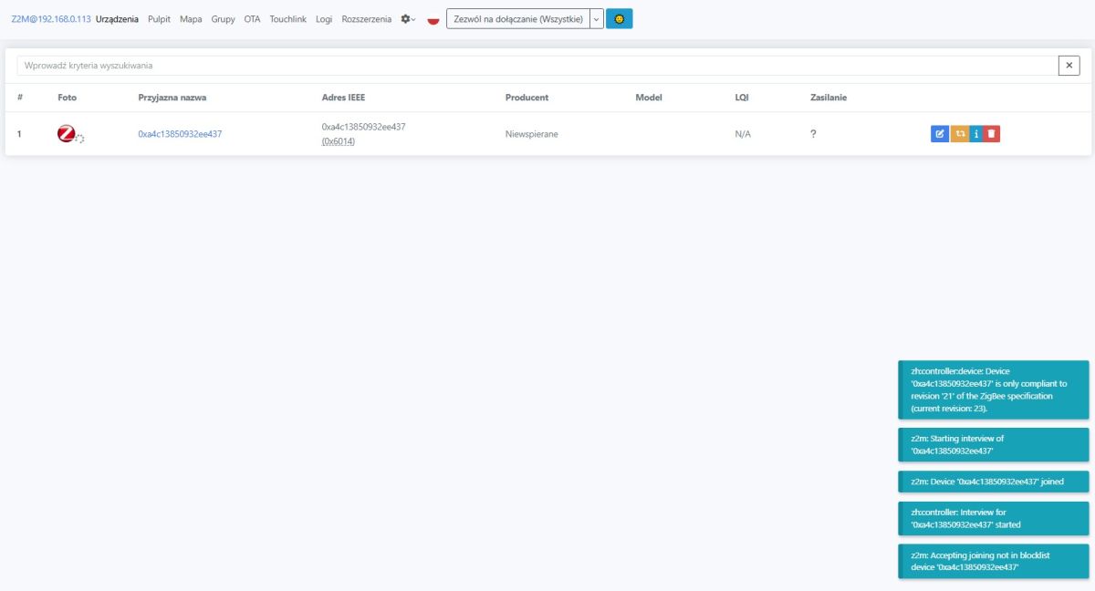

    It's time to test pairing it with Home Assistant. Home Assistant already has a USB-connected CC2531 transceiver and the Zigbee2MQTT plugin configured. We put the device into pairing mode:
    Manual excerpt with device diagram and note: long-press button 6 seconds to start pairing

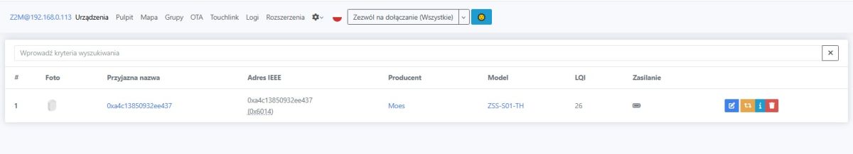

    We make sure that we allow new devices to be attached in HA. After a while, the gadget will be recognised:
    Zigbee2MQTT device list in Home Assistant showing a newly joined device
    Zigbee2MQTT screenshot showing the devices list with a Moes ZSS-S01-TH sensor entry

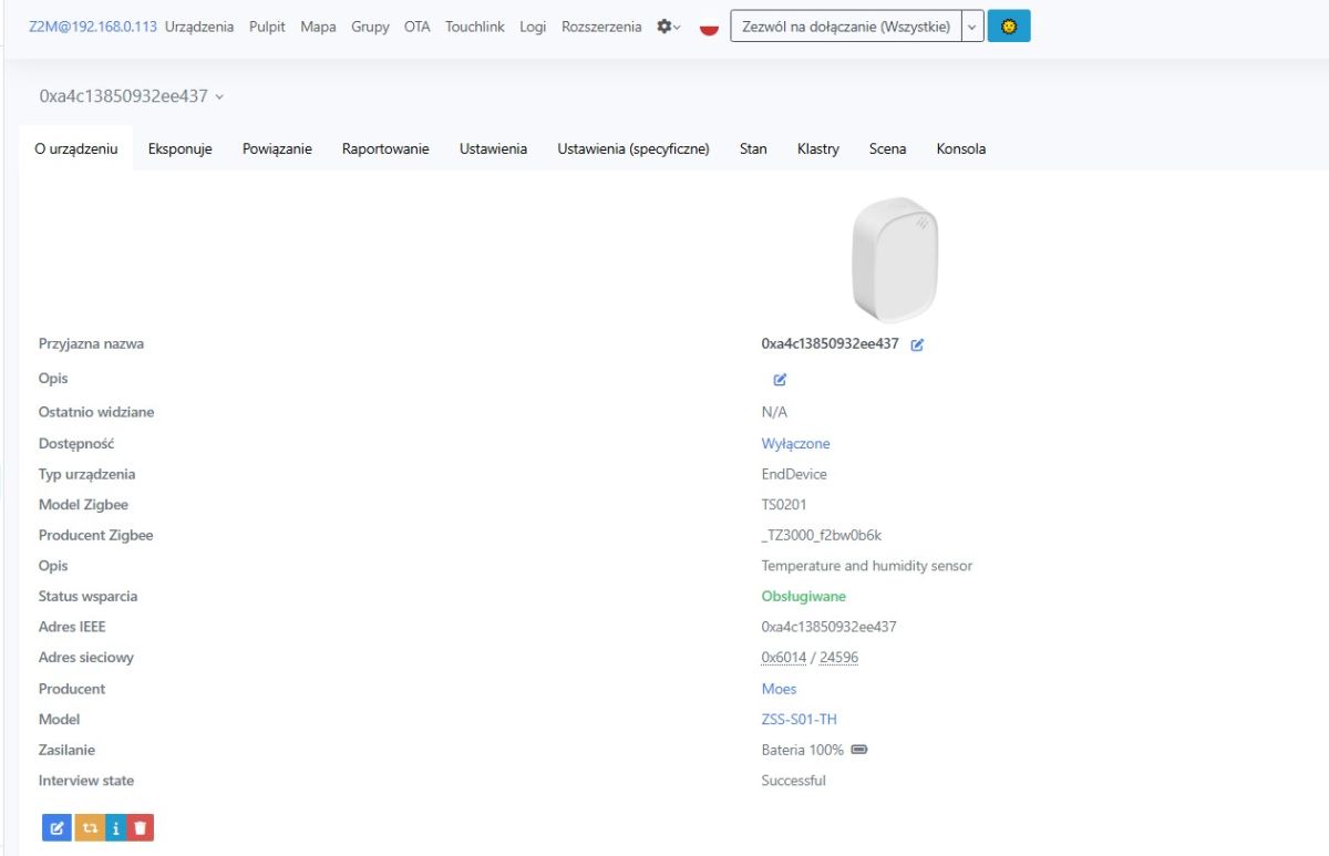

    Home Assistant sees the sensor as ZSS-S01-TH, basic type TS0201.
    Zigbee2MQTT screen showing Zigbee TS0201 sensor details, manufacturer Moes, model ZSS-S01-TH

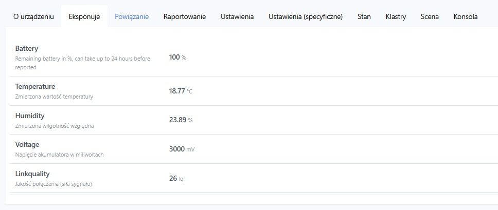

    The device is battery powered, so it is not a Zigbee router.

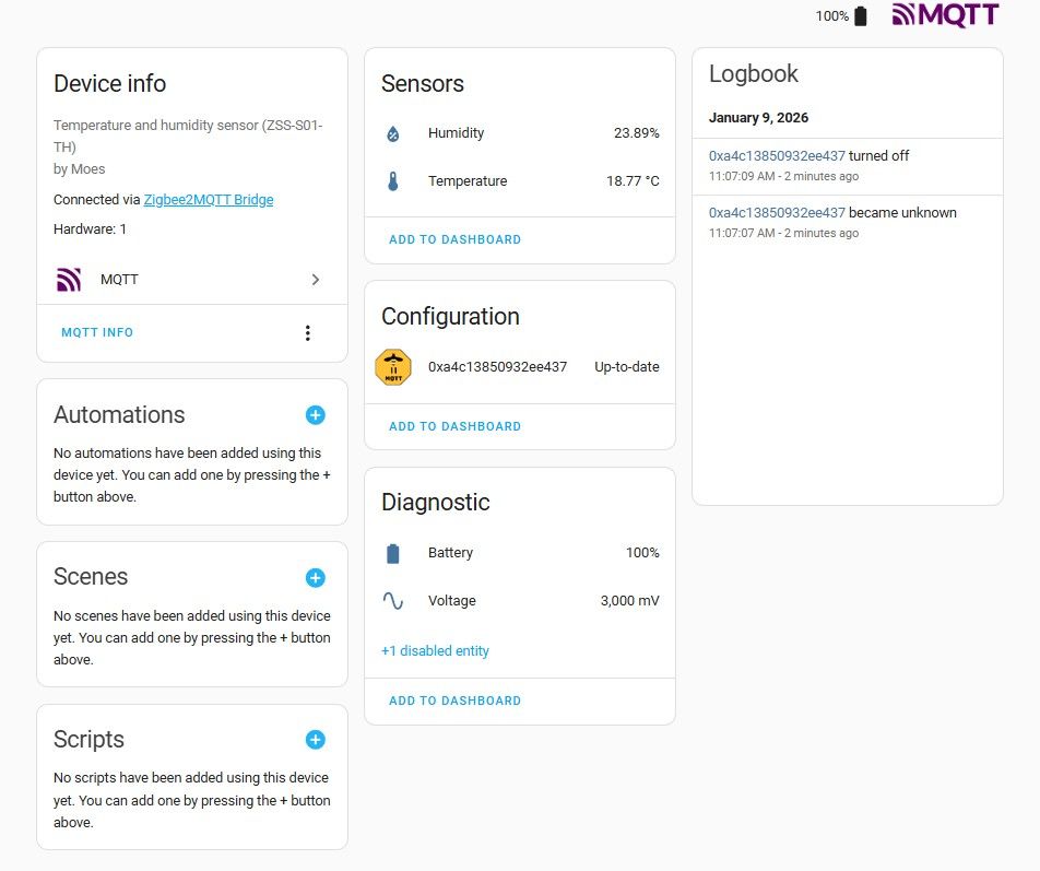

    Battery level (percentage and voltage), temperature, humidity and connection quality are available in the data.
    Home Assistant dashboard screenshot showing sensor data: battery 100%, 18.77°C, humidity 23.89%

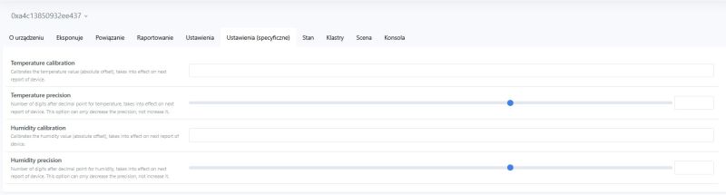

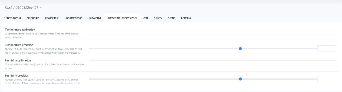

    There is a calibration in the specific settings - measurements can be adjusted.
    Home Assistant screenshot: temperature and humidity calibration settings with sliders

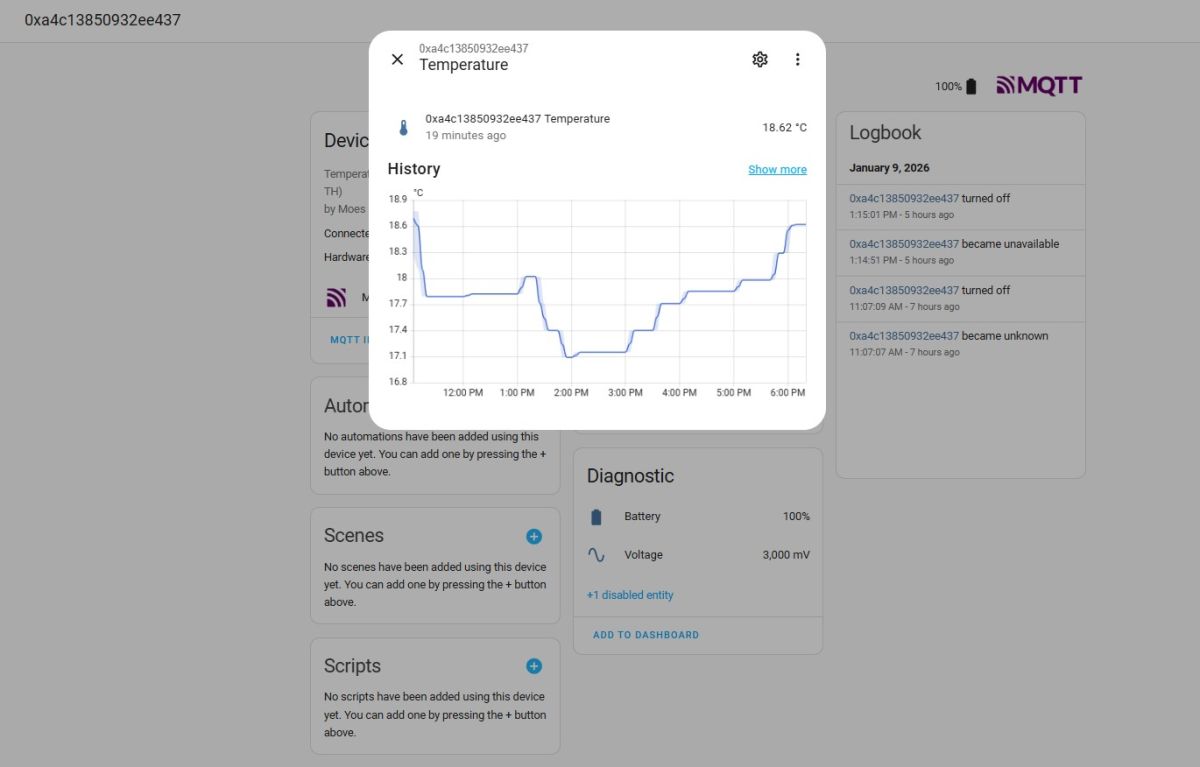

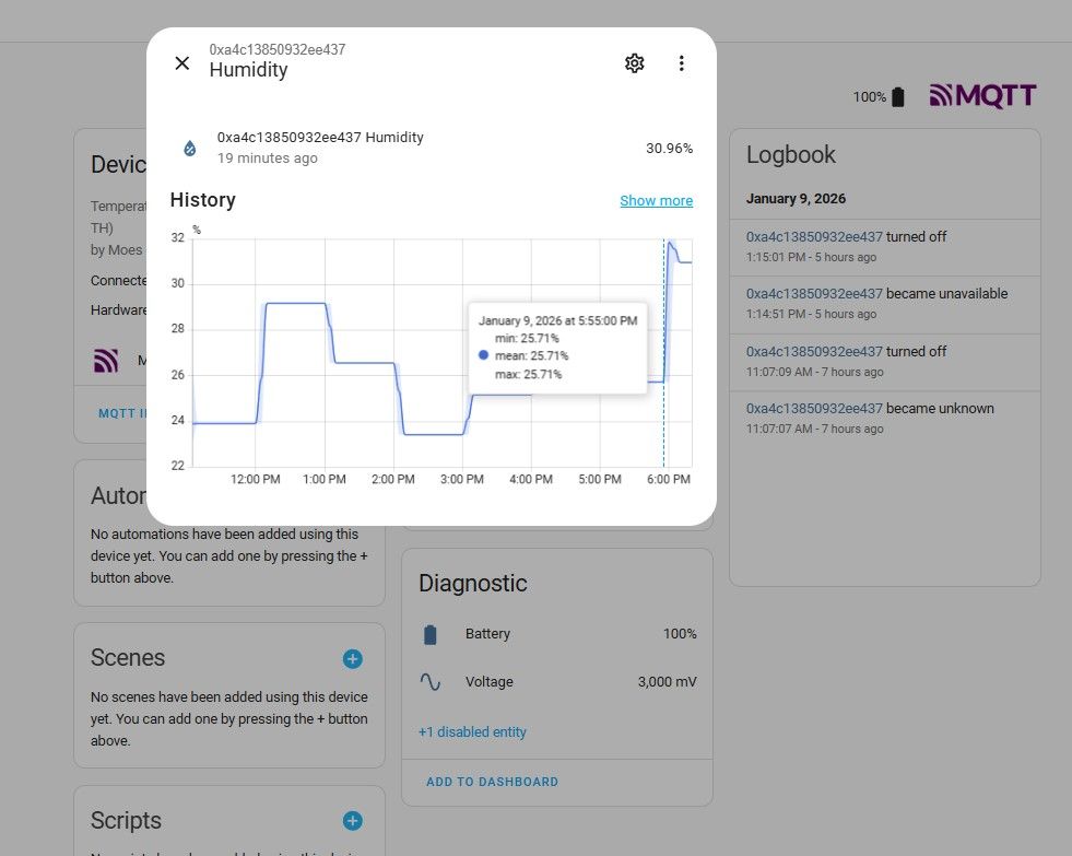

    Example charts:
    “Temperature” popup with history graph and logbook in the Home Assistant interface Home Assistant “Humidity” screen with humidity history chart and MQTT logbook entries
    Screenshot of an app showing a temperature history graph and an MQTT event logbook Screenshot of a humidity history chart with a line rising to about 31%
    Undoubtedly, the graphs show that the device saves battery, but this is more of a plus....

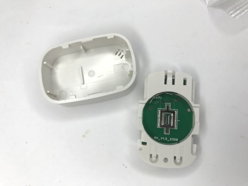

    All that remains is to look inside - out of sheer curiosity.
    Opened white sensor with cover and green circular PCB featuring a central metal element

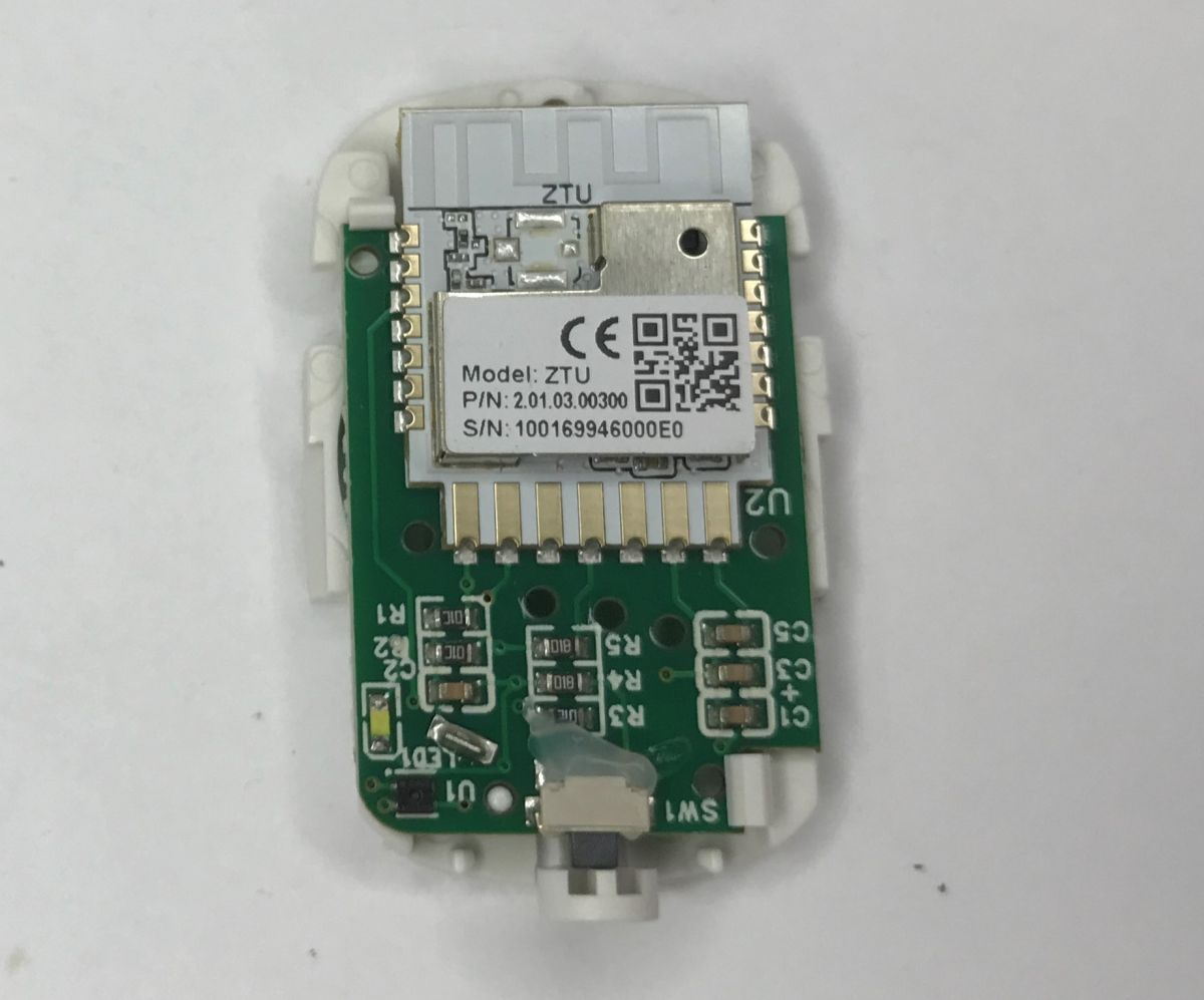

    The battery pack directly powers the ZTU module from Tuya.
    Inside a Zigbee sensor: PCB with ZTU radio module, QR code label, and SMD components
    The ZTU is a 32-bit Zigbee radio module from Tuya, it is based on the TLSR8258F1KAT32 chip, has 1 MB Flash memory and 64 KB RAM.

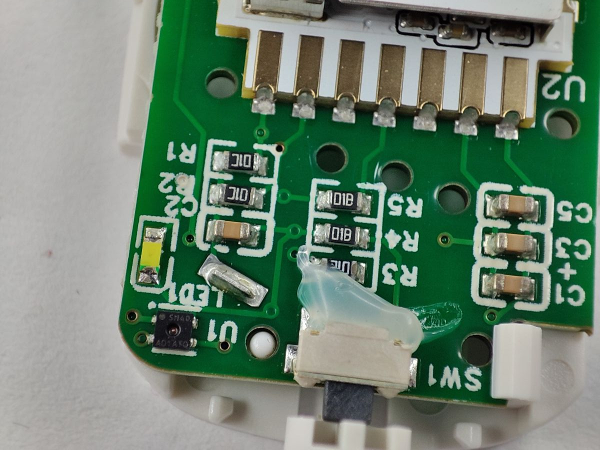

    Close-up of a device PCB with SMD components, an LED, and a SW1 switch
    The device uses a sensor signed as the SH40. This is probably the familiar SHT40 offering communication via I2C.

    SHT40 - I have dealt with one. It is not very accurate and the linearity, especially of the temperature, I will leave uncommented. I removed the SHT40 and BME280 and put in the old DS18B20.

    I wonder how long it will last on this battery, because from what I have noticed this ZTU module is extremely unsuccessful. It has very poor range and is quite power hungry. I don't know, it's possible it's a fw issue as it's also a Telink after all. And other devices on the same chip work much better.

    But the SHT41/45 as well as the older 31/35, are very repeatable results in measuring humidity. For a range of 20%-75%.
    I have the SHT41 and 45 now, the SHT35 I had before was the same. Anyway SHT35/45 are often used industrially. Davis Instruments in stations e.g. Davis Vantage - professional weather stations use SHT supposedly, I once found a thread on the net about replacing an older generation SHT with a newer one and there was a discussion about calibration. So there is a good chance that the info is true.
    The misunderstandings may perhaps come from the source where the sensors come from?, since on Ali you can buy the sensor with pcb for 50% of the price of the sensor itself?
