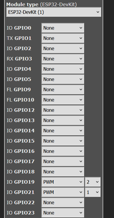

    Hello, I would like to make two channels on an ESP32 board with tasmot preloaded to control LED strips on 12V, via transistors of course. For the two outputs from which I want to control the strips, I have made the settings as in the picture. But they work as if I were controlling coloured LEDs - when I dim one channel, the brightness on the other channel increases, for example. How do I configure the outputs so that this works properly?
    And by the way, is it possible to have something like a fill limit? So that there is, for example, 50% fill on one of the channels.
    • ESP32 configuration with Tasmota to control two 12V LED strips 001.png (24.87 KB) You must be logged in to download this attachment.

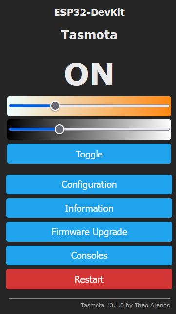

    LED control sch. needs to be shown
  • #3 20733327
    opaaa
    Level 4  
    Posts: 282
    Rate: 32
    Board Language: polish
    Sorry wrong snapshot.
    • ESP32 configuration with Tasmota to control two 12V LED strips 001.png (35.49 KB) You must be logged in to download this attachment.

    It was, of course, sufficient to type in the Tasmot console:
    SetOption68 1
    and each PWM channel can be controlled independently.
