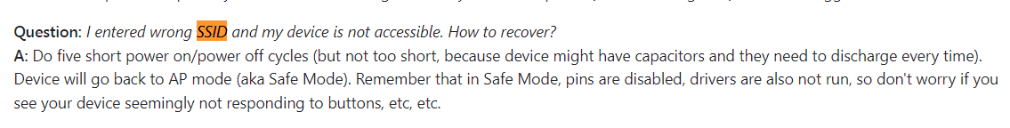

    I have successfully updated the firmware to a Tuya light bulb with BK7231T chip using Tuya Cloudcutter.
    After a successful bootup, I configured the Wi-Fi and MQTT to the light bulb.
    The bulb was working fine, but after 10-15 minutes, it got stuck and rebooted automatically. It happened 3-4 times, and then the bulb is not turning on,
    not connecting to the Wi-Fi, or even not broadcasting any AP.
    Is there any way to reset the bulb by running a power cycle 3-4 times as the original one?
  • #2 20736863
    Posts: 14797
    Rate: 12954
    Hello, you can check OBK FAQ:
    https://github.com/openshwprojects/OpenBK7231T_App/blob/main/docs/faq.md
    Screenshot of a FAQ section regarding an issue with incorrect SSID.
    Please try it out and let me know if it works. Your issue seems very uncommon and requires futher investigation.
