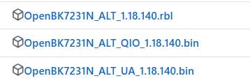

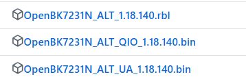

    WPA3-only is not supported by the general OpenBK7231 release but is by the newer-SDK "_ALT" releases
