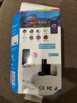

    Teardown Photos
    Package:
    Using another review's image for the first image since my packaging was quite trashed on delivery.
    [BK7231N] CoRui TUYA WiFi Smart LED Light Bulb 9W E27 RGBCW
    [BK7231N] CoRui TUYA WiFi Smart LED Light Bulb 9W E27 RGBCW [BK7231N] CoRui TUYA WiFi Smart LED Light Bulb 9W E27 RGBCW [BK7231N] CoRui TUYA WiFi Smart LED Light Bulb 9W E27 RGBCW [BK7231N] CoRui TUYA WiFi Smart LED Light Bulb 9W E27 RGBCW

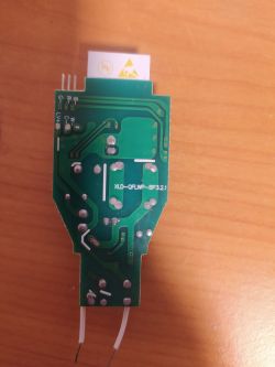

    #7 20378413

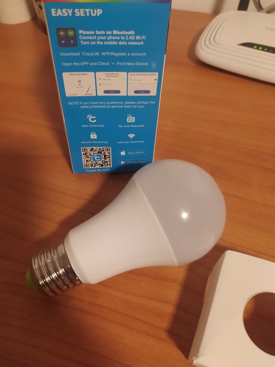

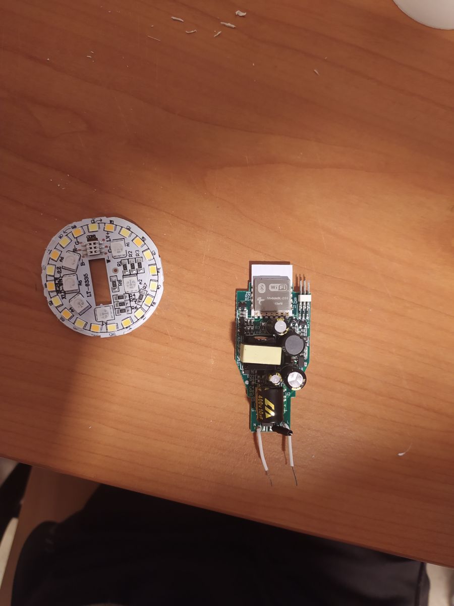

    ionoleinic
    Posts: 48

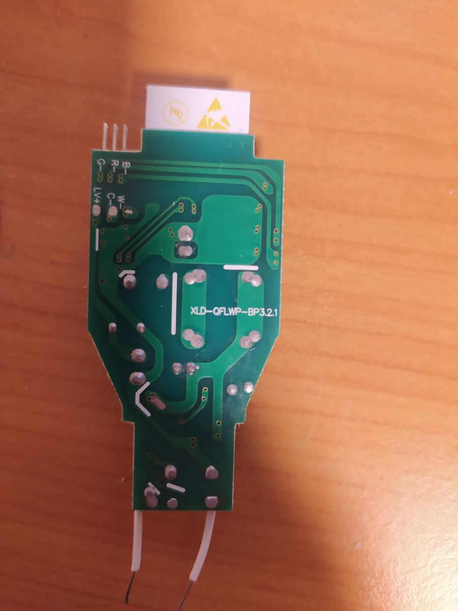

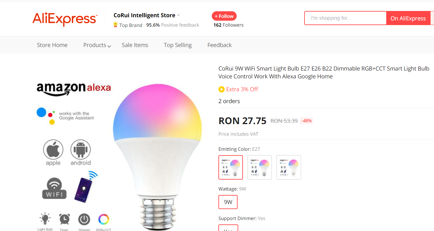

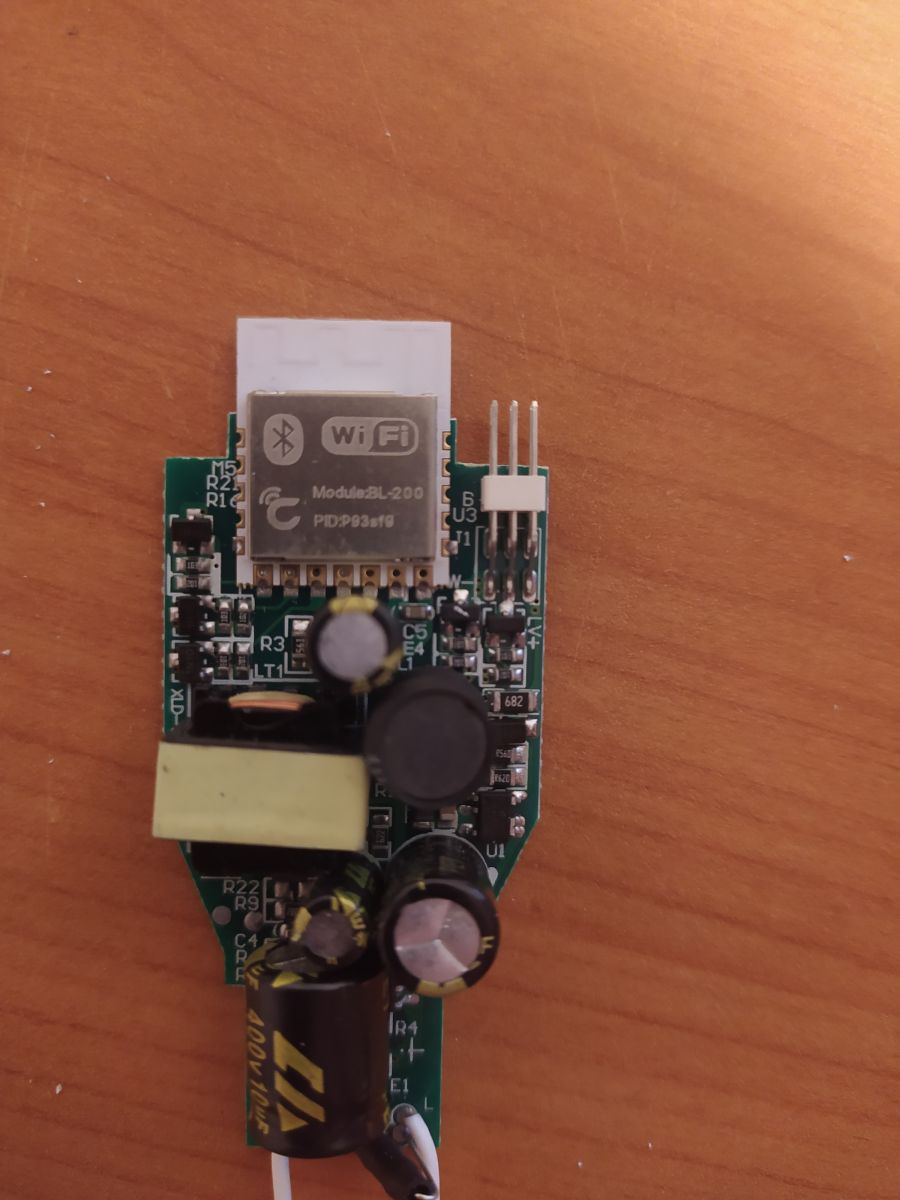

    Hola bola, i bought on AliExpress a CoRui smart bulb the same with this,BUT it seems to be from another manufacter, and tuya/smartlife app don't recognise this bulb.I could paire it only with CozyLife App. [BK7231N] CoRui TUYA WiFi Smart LED Light Bulb 9W E27 RGBCW [BK7231N] CoRui TUYA WiFi Smart LED Light Bulb 9W E27 RGBCW
    I wanted to flash it through tuyacloudcutter but it didn't see it too.I opened it and i saw this module, BL-200, with CozyLife icon on it.Can it be flashed with OpenBeken?
  • #8 20378459
    Posts: 14743
    Rate: 12839
    @ionoleinic can you provide information where this device was bought?
    Yes, this is BL602 and it's supported, but it's a very basic support, only PWM + LED drivers are implemented, because there is very few BL602 devices.
    Can you give me names of ICs on the board, is this bulb using raw PWMs or an "I2C" LED driver?

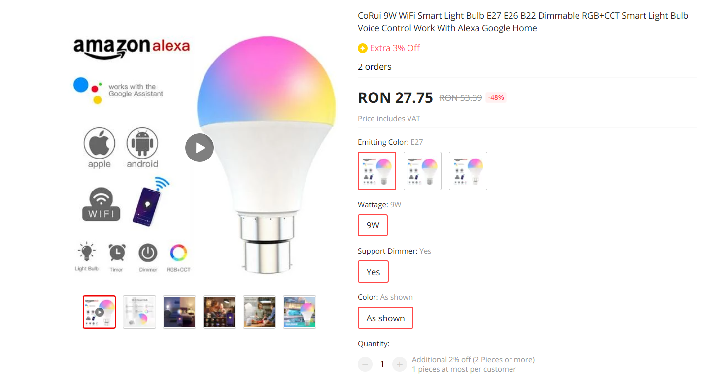

    Please modify your post to include screenshots from the Aliexpress offer. Aliexpress links expire after some time and then becomes inaccessible.
    BP2525 is a power supply chip. It's not a LED driver.
    I am unable to find any information on YT5202A.

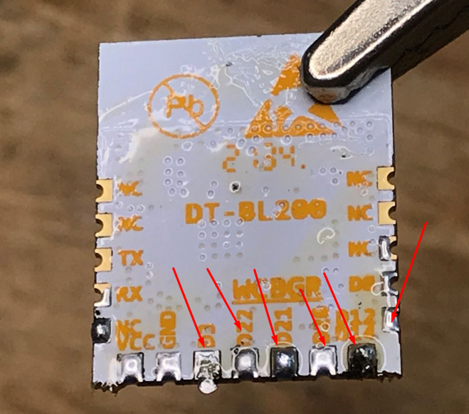

    Here's the information you requested - I had that bulb in the past, it seems.
    Please look at the last photo, the pins should be described here.

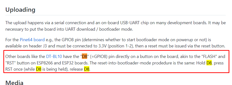

    Sorry, I didn't flash it yet. I must remember where I have put that bulb. I have so much disassembled devices for the sake of OBK that's it's easy to get lost. BL602 is not very popular, but here is a dedicated topic:
    https://www.elektroda.com/rtvforum/topic3889041.html
    If I remember correctly, the D8 is a boot pin.
    For flashing, you should use BLDevCube from OpenBL602:
    https://github.com/openshwprojects/OpenBL602
    IMPORTANT WARNING: Buffalo labs also made a newer version of BL602 and BLDevCube which are not compatible with older version! Please use the version I specified. The one from our repo.

    I used search function in this forum and I've found the post I made some time ago. If you use search function on Elektroda, you can find useful IoT information.
    ionoleinic wrote:
    And what pins i should set as PWMs? How can i find them?
    Hmm considering the photos of the module, there are not many options, I think you could just get away with guessing the pins. You can see pin names on the board, there are 7 options, oh wait, 6 options, because D8 is a boot pin so it's most likely not a PWM... and you are looking for... wait, 5 pins? So it seems we've almost got them all.

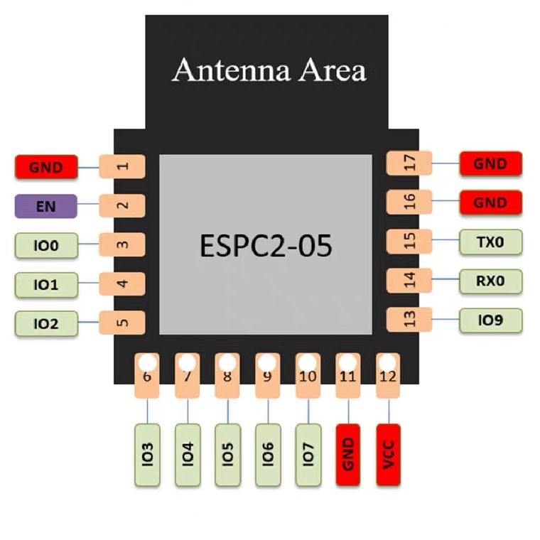

    @ionoleinic thanks for the update, I’m gonna have to edit my main post again.

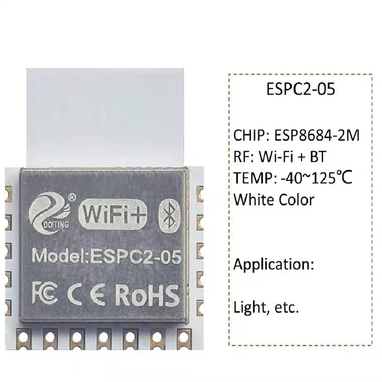

    After some checking, the one that i had seems to be the same bulb sold by Aubess
    Fyi, if you still have problems with the chip you can do a swap with espc2-05. Has the same pinout

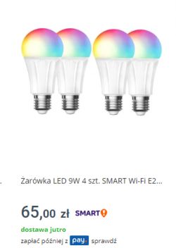

  • ESP module costs more than a whole bulb
    #18 20379021

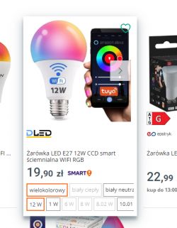

    Posts: 14743
    Rate: 12839

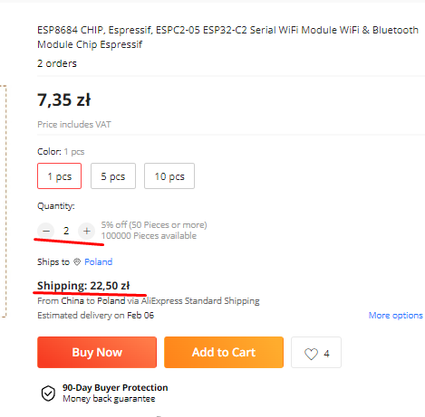

    How much is that espc2-05 module? My quick search yields 28,64zł special offer (base price 90 zł) which is not a good deal, considering that we can buy smart bulbs in Poland for about 20zł.
    NOTE: 1zl = 0.23$ at the time of writing.
    NOTE 2: one of many cheap bulbs in Poland - 20 zł, so basically 5$.
    So if the module price is 28zł and this bulb is 20 zł (if you buy two, you get free shipping with allegro smart) then an ESP module is more expensive than whole bulb (with BK, I guess)!

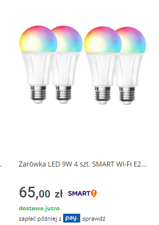

    EDIT: there are even better deals. 4 pieces for 65 zł, 9W, E27, so one for 16 zł, for about... 4$

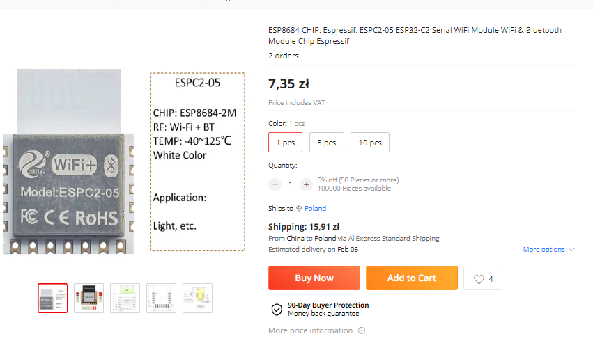

    You have linked to the auction where module is very cheap, but seller earns with shipping.
    7.46zł+15.91zł = 23.37zł
    It is indeed better than what I found ( 28,64zł ) but still more expensive than buying another whole bulb.
    So basically...swapping chips is not a good deal. At least in my country.
    I also see that shipping cost increases with each piece (but still, it is more ecominal to buy more pieces together):

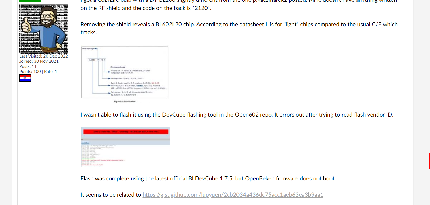

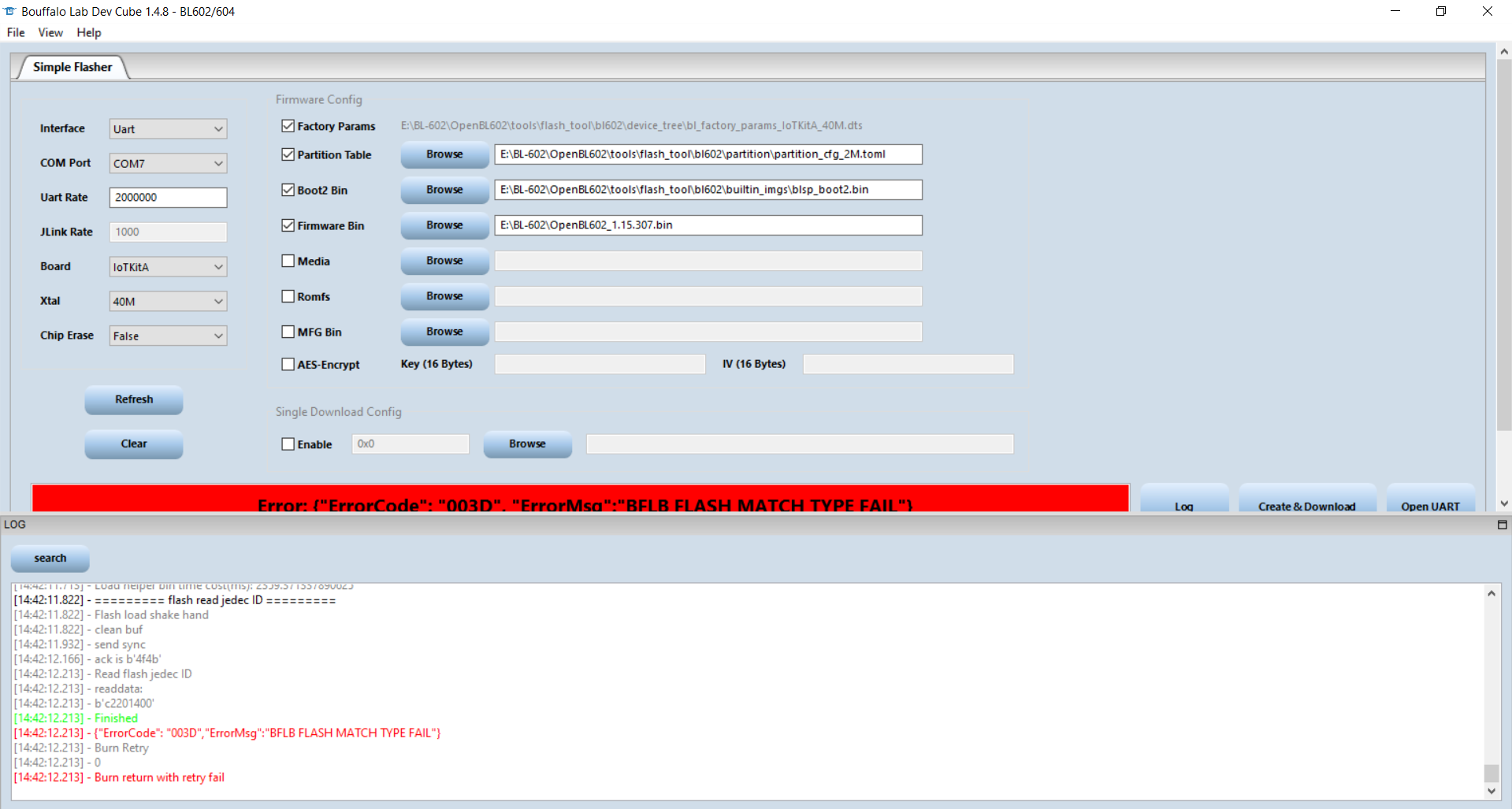

    HI, i tried flash bl-200 chip with OpenBl602 firmware.In Bouffalo dev cube i have this error.
    Can somebody help me?
    I saw that blakadder had the same prolem...
  • #23 20381960
    Posts: 14743
    Rate: 12839
    @ionoleinic if this is what you get all the time, you got most likely a newer version of BL602 which requires a whole updated SDK for that to work and is not compatible with current one...

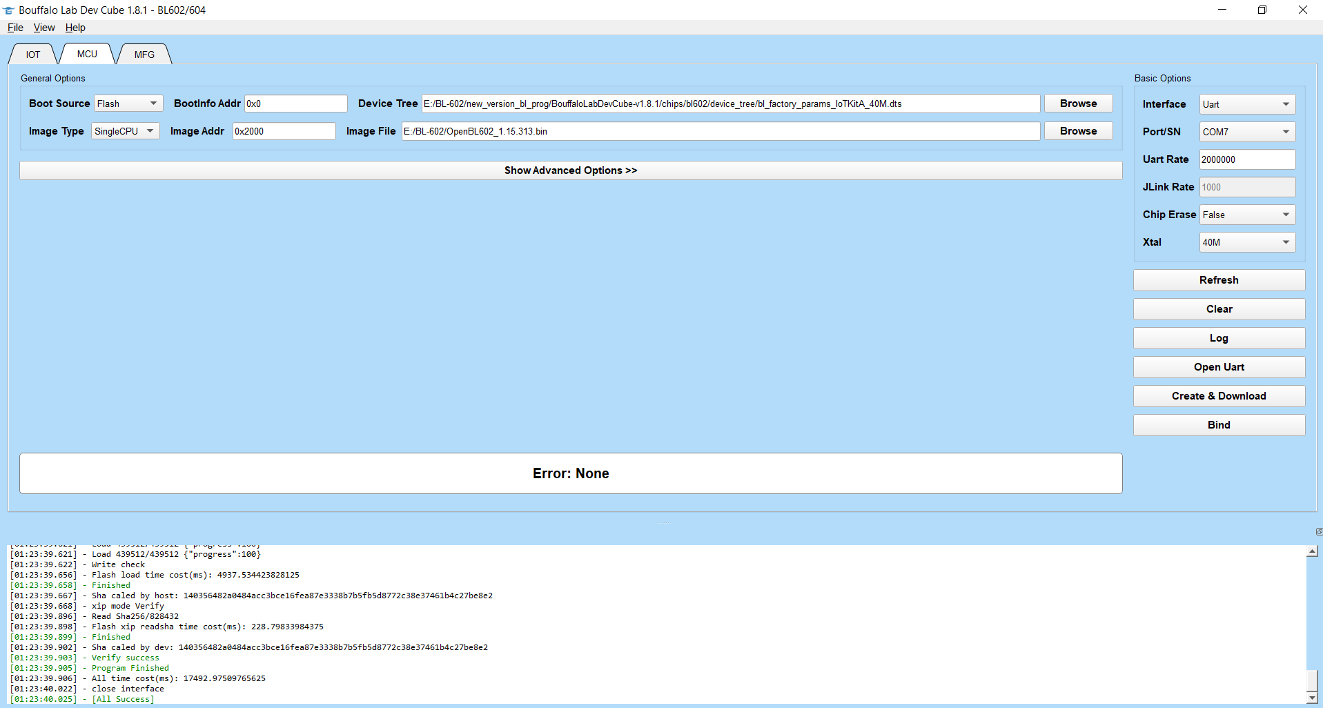

    #25 20384256
    ionoleinic
    Posts: 48

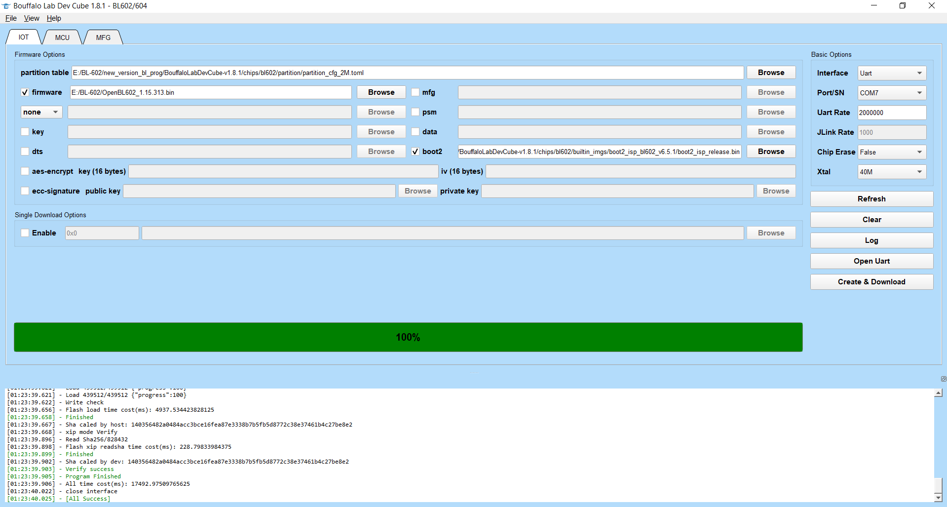

    @ionoleinic can you try settings shown by this user? Maybe he figured out something more than us.
    https://www.elektroda.pl/rtvforum/topic3927070.html#20382984
    Tried.Unsuccessfully.
    It seems that is flashing, but AP OpenBekenxxxxx doesn't appear...
    I tried different configurations, changing partition, img, bla bla bla.... without result.
  • #26 20384299
    Posts: 14743
    Rate: 12839
    @ionoleinic but do you know that in order for AP to appear you must disconnect the boot pin and do a reboot (by RESET or by power off/on cycle)?

Is swapping the module for an ESP32-C2 practical?
Not really. ESPC2-05 costs 23–28 zł shipped, more than a whole new bulb at 16–20 zł in Poland [Elektroda, 20379025]

Are there cheaper local alternatives?
Yes—four-pack 9 W RGB bulbs for 65 zł (≈ 4 USD each) on Allegro [Elektroda, 20379021]
