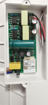

    Posts: 10
    Hi everyone. I'm pretty much a noob about this stuff although I flashed a few devices with Tasmota. However, now I have a ceiling light with a CBU module and it doesn't seem anyone has been flashing it already and would like to make sure it will still work if I go that route with OpenBeken. So I would need some help here. I am really tired of Tuya limitations and troubles with it. Almost every day it changes IP although I have DHCP static IP set in the router (could be a router problem). I use it with LocalTuya. I have to take power off and back on for it to get back set IP.

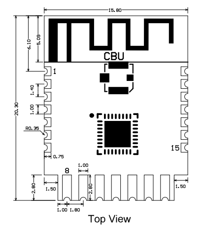

    CBU module datasheet I found on Tuya:
    https://developer.tuya.com/en/docs/iot/cbu-module-datasheet?id=Ka07pykl5dk4u
    It is supposed to have a BK7231N chip.
    I ordered the lamp from AliExpress:
    https://a.aliexpress.com/_mOnNYEi
    Tuya WiFi Ceiling Lamp KZB2436-36W: Flashing with OpenBeken, Tips, and Troubleshooting
    Tuya WiFi Ceiling Lamp KZB2436-36W: Flashing with OpenBeken, Tips, and Troubleshooting Tuya WiFi Ceiling Lamp KZB2436-36W: Flashing with OpenBeken, Tips, and Troubleshooting
    If there is any additional info I can provide, let me know.
    After all, I really like the design and performance of the light when there are no problems and would be really happy if I can flash it.
  • CBU flashing via hid_download_py and UART commands

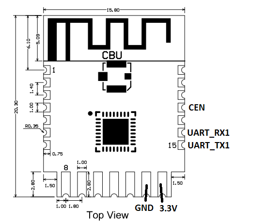

    I think that CBU should be very easily flashable with hid_download_py:
    https://github.com/OpenBekenIOT/hid_download_py
    First do firmware read (full 2MB), and then flash Obk:
    python uartprogram myfirmwarebackup.bin -d com10 -r -s 0x0 -l 0x200000
    python uartprogram W:/GIT/OpenBK7231N/apps/OpenBK7231N_App/output/1.0.0/OpenBK7231N_QIO_1.15.206.bin --unprotect -d com15 -w --startaddr 0x0
    NOTE: replace OpenBK7231N_QIO_1.15.206.bin with latest one...
    ALSO don't compile yourself, releases are here: https://github.com/openshwprojects/OpenBK7231T_App/releases
    For flashing, you need to connect 3.3V, GND, TX, RX and maybe CEN.
    Pin numberSymbolI/O typeFunction
    1P14I/OCommon GPIO, which can be reused as SPI_SCK (Correspond to Pin 11 of the IC)
    2P16I/OCommon GPIO, which can be reused as SPI_MOSI (Correspond to Pin 12 of the IC)
    3P20I/OCommon GPIO (Correspond to Pin 20 of the IC)
    4P22I/OCommon GPIO (Correspond to Pin 18 of the IC)
    5ADCI/OADC, which corresponds to P23 on the internal IC (Correspond to Pin 17 of the IC)
    6RX2I/OUART_RX2, which corresponds to P1 on the internal IC. (Correspond to Pin 28 of the IC)
    7TX2I/OUART_TX2, which is used for outputting logs and corresponds to P0 of the internal IC (Correspond to Pin 29 of the IC)
    8P8I/OSupport hardware PWM (Correspond to Pin 24 of the IC)
    9P7I/OSupport hardware PWM (Correspond to Pin 23 of the IC)
    10P6I/OSupport hardware PWM (Correspond to Pin 22 of the IC)
    11P26I/OSupport hardware PWM (Correspond to Pin 15 of the IC)
    12P24I/OSupport hardware PWM (Correspond to Pin 16 of the IC)
    13GNDPPower supply reference ground
    143V3PPower supply 3V3
    15TX1I/OUART_TX1, which is used for transmitting user data and corresponds to Pin 27 of the IC. For the MCU solution, please refer to CBx Module.
    16RX1I/OUART_RX1, which is used for receiving user data and corresponds to Pin 26 of the IC. For the MCU solution, please refer to CBx Module.
    17P28I/OCommon GPIO (Correspond to Pin 10 of the IC)
    18CENI/OReset pin, low active (internally pulled high), compatible with other modules (Correspond to Pin 21 of the IC)
    19P9I/OCommon GPIO (Correspond to Pin 25 of the IC)
    20P17I/OCommon GPIO, which can be reused as SPI_MISO (Correspond to Pin 14 of the IC)
    21P15I/OCommon GPIO, which can be reused as SPI_CS (Correspond to Pin 13 of the IC)
    Test pointCSNI/OMode selection pin. If it is connected to the ground before being powered on, enter the firmware test mode. If it is not connected or connected to VCC before being powered on, enter the firmware application mode. Correspond to Pin 19 on the internal IC.

    CEN should be shorted to GND for 0.2 seconds (originally, it was done automatically by the Beken flashing tool). Then the "Getting bus" will "get bus" and start flashing.
    It is tricky to short CEN to GND for a correct amount of time - takes several tries to do that.

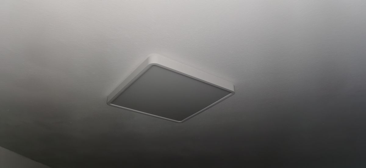

    Ok I managed to write it. Now let me try accessing it and all that :)
    Added after 56 [minutes]:
    Well it's working, managed to set it up.
    Before I did set it up the right way, I checked this:
    Flag 8 - [LED] Alternate CW light mode (first PWM for warm/cold slider, second for brightness)
    And it seemed that it was much brighter on warm-slider side = both channels had 100%. Is that safe for the lamp or will I burn something if I wanted to use that option sometimes to get the most brightness out of it?
    Oh and one more thing. How could I set static IP on device itself?
    After all, thank you so much for your time and your investment into developing such a nice tasmota alternative firmware. Very nice work :)
