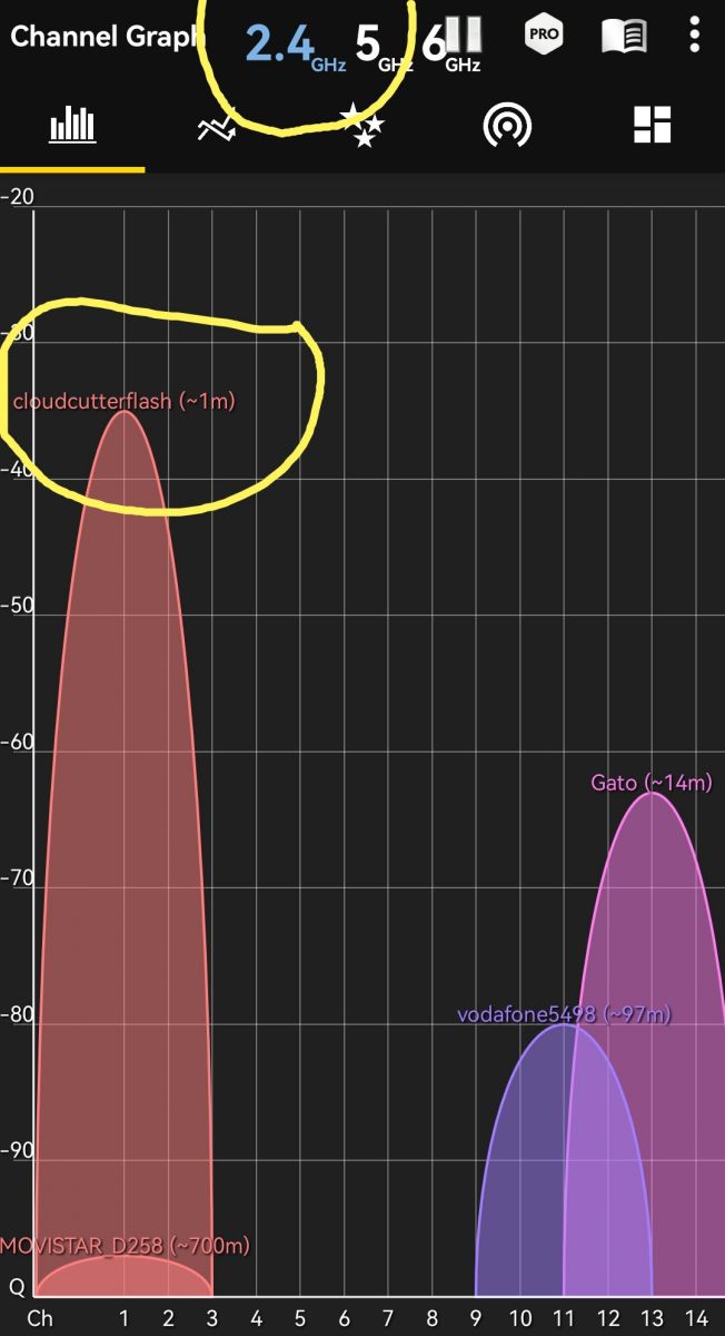

    You see the cloudcutter ap with a smartphone for example ?
    Be sure to configure your wifi card to 2,4ghz for the ap mode. If it's a 5g endpoint it will not work.
  • #12 20521885
    minchutu
    Posts: 18
    @dheenhasty it's confirmed: cloudcutterflash is a 2.4GHz network

    After that I got nothing else. I've tried:
    - wait for half an hour
    - EZ mode (quick blick)
    - AP mode (slow blink)
    - Use Tuya App trying to connect with the sensor
    I do not know what else to do.
    The fact that you get following line indicates that the device has been already declouded:
    Found access point name: "A-A1BC", trying to connect...
    Access point changes from SmartLife-A1BC to A-A1BC when the initial exploit is successful.
    Are you sure that your 'cloudclutterflash' accesspoint is active at the following point:
    Using interface wlp2s0 with hwaddr ec:55:f9:53:d1:aa and ssid "cloudcutterflash"
    wlp2s0: interface state UNINITIALIZED->ENABLED
    wlp2s0: AP-ENABLED
    Also I have a concern about not seeing the following types of messages at this point indicating that the DHCP server is running in your setup:
    Jun 5 15:25:58 dnsmasq[15]: started, version 2.80 cachesize 150
    Jun 5 15:25:58 dnsmasq[15]: compile time options: IPv6 GNU-getopt DBus i18n IDN DHCP DHCPv6 no-Lua TFTP conntrack ipset auth DNSSEC loop-detect inotify dumpfile
    Jun 5 15:25:58 dnsmasq-dhcp[15]: DHCP, IP range 10.42.42.10 -- 10.42.42.40, lease time 12h
    Jun 5 15:25:58 dnsmasq-dhcp[15]: DHCP, sockets bound exclusively to interface wlan0
    Jun 5 15:25:58 dnsmasq[15]: read /etc/hosts - 5 addresses
    The previous message about port 53 not being available also might have a dependency here.
    If the DHCP server is not running, the device would not be able to successfully connect and proceed.
    Your issue may be not in the device but the server side.
  • DHCP server likely not the cause of intermittent failure
    #24 20608524
    minchutu
    Posts: 18
    Thanks a lot @jkwin for your time and help.
    -The fact that you get following line indicates that the device has been already declouded:
    Code: text Expand Select all Copy to clipboard
    That's what happen the first time, but not the 5 time that came later
    - Are you sure that your 'cloudclutterflash' access point is active at the following point:
    wlp2s0: AP-ENABLED
    100% sure
    BK7231 flashing sensor via tuya-cloudcutter, not connecting to network
    -Also I have a concern about not seeing the following types of messages at this point indicating that the DHCP server is running in your setup:
    I'd never seen such messages: nor the 2 times the operation went wrong neither the 4 times it run ok. The DHCP works great at router level with no issues so far. I understand that this is the way it works, or there's something I've forgot or misunderstood? Do I have anything to do with the DHCP service for the operation to run properly?
    - Your issue may be not in the device but the server side.
    You might be right, but why sometimes works and sometimes don't? Can you suggest any kind of trial or test I can do to find the "mystery"?
    Saludos.

    9. Go to your cloudcutter window and watch the logs - within a few minutes the update process will resume and the firmware will be successfully deployed to the device
    Hope this helps someone out there and it will stop devices being opened (and maybe damaged in the process) and flashed via serial/USB

The discussion revolves around issues faced while flashing a BK7231 sensor using Tuya Cloudcutter. The user reports difficulties in connecting the sensor to their network after flashing, despite following the correct procedures. Various responses suggest checking the firmware version, ensuring the correct binary is used for the specific BK7231 model, and confirming that the cloudcutterflash access point is active. Some users recommend using a CH340 module for direct flashing if Cloudcutter fails. A successful workaround involves leaving the Cloudcutter at the AP-ENABLED step and manually adding the device through the Tuya app. The conversation highlights the importance of network settings, firmware compatibility, and troubleshooting steps for successful device integration.
TL;DR: 6 sensors were tested; “leave cloudcutter at AP-ENABLED” is the key workaround for BK7231N Tuya sensors stuck on cloudcutterflash. This FAQ helps OpenBK users fix cloudcutter flashing, DHCP, 2.4 GHz AP, RF partition, and CH340 serial fallback issues. [#20607470]
Why it matters: A stalled AP-ENABLED step can look like a dead sensor, but the thread shows recoverable software and setup causes.
Method Best use Thread result Main risk
tuya-cloudcutter No-open OTA flashing 4 of 6 sensors succeeded in one user’s batch Can stall at AP-ENABLED
CH340 serial flashing Recovery after cloudcutter failure Worked on the stubborn first sensor Requires opening the sensor
Tuya app assist Reconnecting to cloudcutterflash Reported as the closing workaround Must keep cloudcutter running
Key insight: If the device already changed from SmartLife-A1BC to A-A1BC, cloudcutter has likely declouded it. Do not stop at AP-ENABLED; force pairing to cloudcutterflash with password abcdabcd.
  • Cloudcutter asked users to wait 10–120 seconds for the device to connect to cloudcutterflash, though one user waited 30 minutes without progress. [#20517744]
  • The cloudcutterflash access point used password abcdabcd and must be reachable as a 2.4 GHz WiFi network, not a 5 GHz endpoint. [#20518736]
  • Required service checks included UDP 53, UDP 67, TCP 80, TCP 443, TCP 1883, and TCP 8886 before firmware upload. [#20517744]
  • A successful example uploaded OpenBK7231N_App_UG_1.11.33.bin and reported firmware progress at 26%, 56%, 86%, and 98%. [#20530807]
  • In one batch, the same setup flashed 4 of 6 Tuya firmware 1.1.17 BK7231N thermometers; 2 required another approach. [#20607470]
