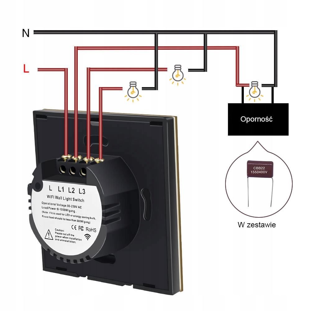

    I have a problem with a Tuya minitiger two button switch without neutral . Only the second switch works . The first when I press it the bulbs flash and it switches to the second . The capacitor plugged in correctly according to the diagram . All bulbs are led . Used capacitor from the kit.
    Uploaded soft supla from page : Link
    Below video how it looks like :

    Capacitors must be 2.

    After all, they gave one in the kit
    Added after 1 [hour] 49 [minutes]:
    >>20773217
    The second capacitor did not fix the problem , I also tried screwing in a regular non led bulb and the effect was the same
