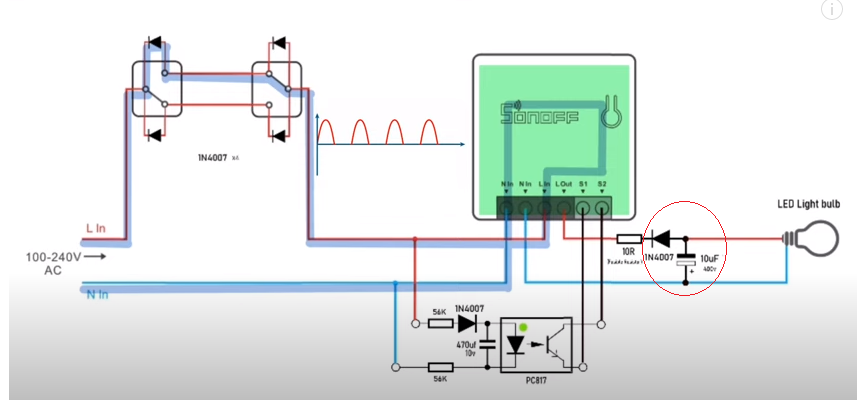

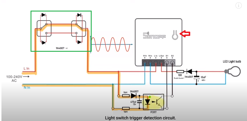

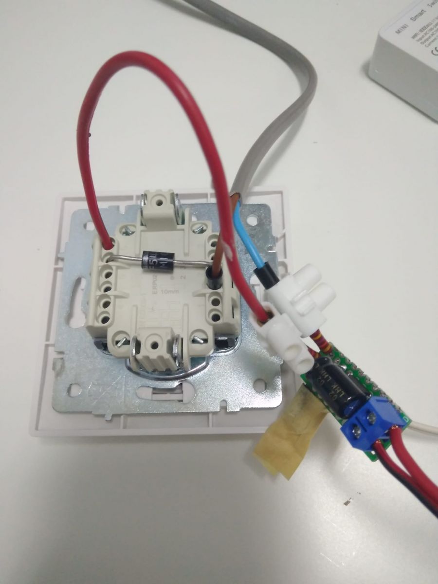

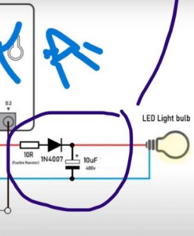

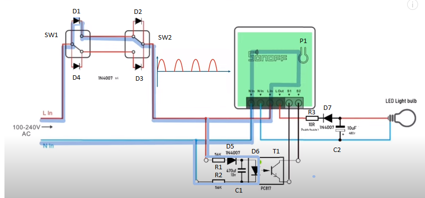

    Has anyone tried this no neutral hack that allows to install the tuya mini on the light fixture?
    I had the diodes polarity reversed to get it working with the tuya/aubess, but I still can't toggle the relay from the wall switch (S1 & S2)
    Modifying Tuya Mini for No-Neutral Installation: Experiences with Diode Polarity Reversal?
    Was wondering if anyone else got it working

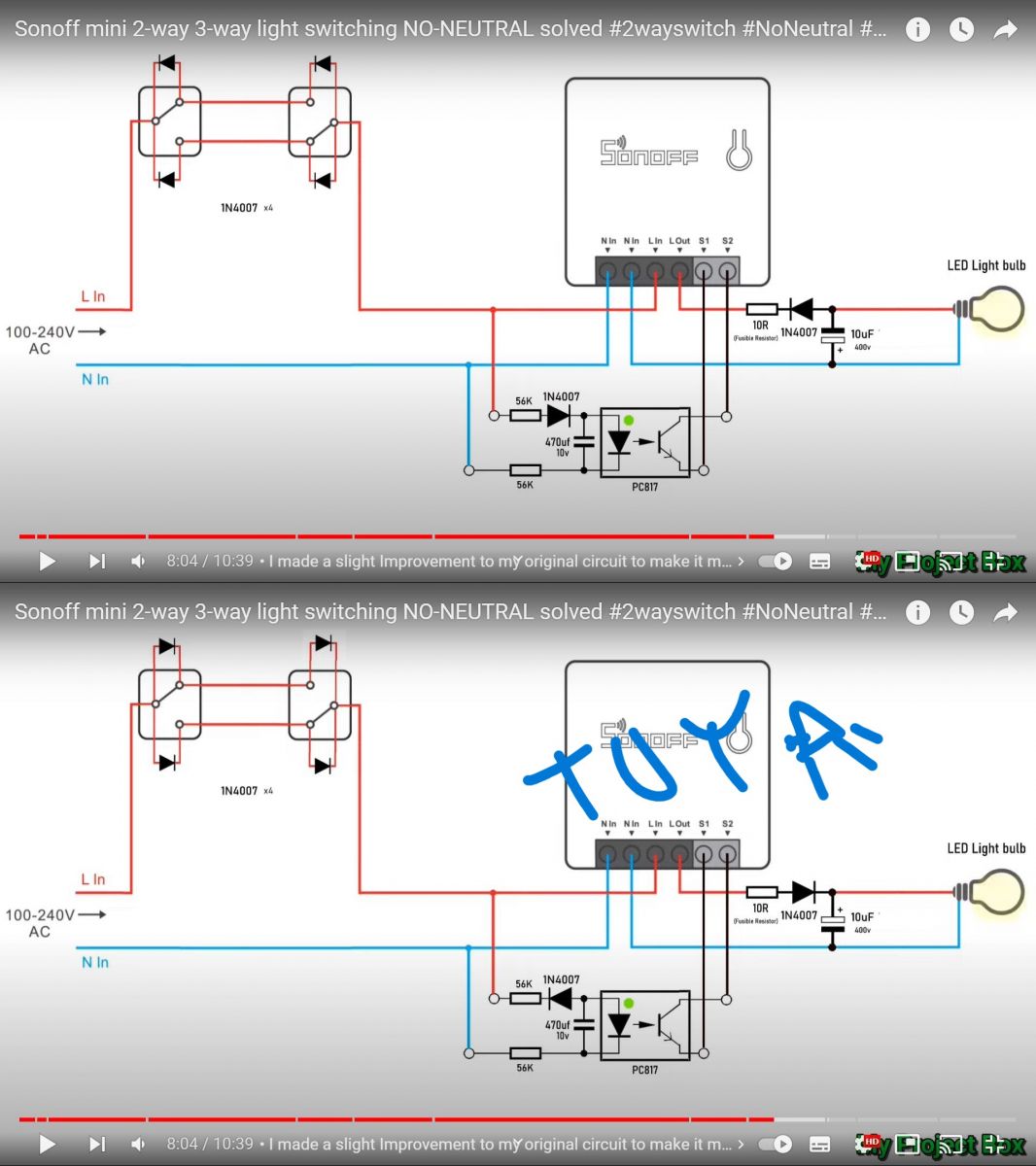

    Have you tried flipping the 1N4007 diode and the 10uF/400V electrolytic capacitor?
  • #3 20521680
    Posts: 14743
    Rate: 12839

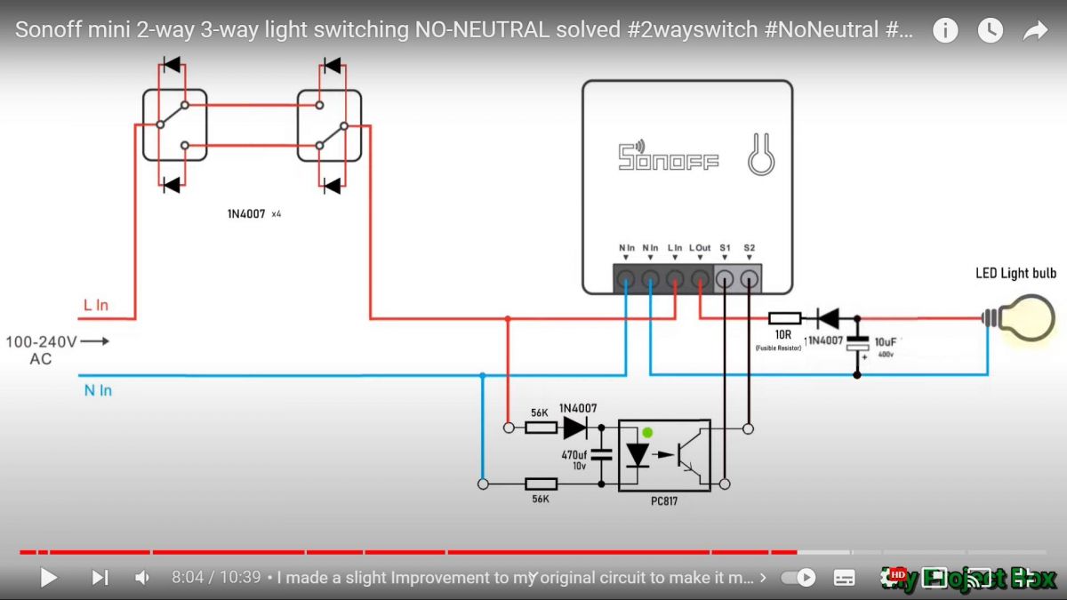

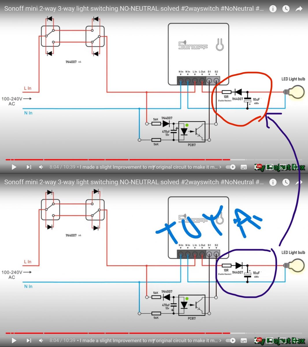

    The trick from video really could work but I am not sure if such a big interference into your electrical wiring is a good and safe idea.

    I think that in addition to the parts that I mentioned before, I would also invert the capacitor and diode that go to the optocoupler so that the internal diode conducts in the positive half cycle of the wave and closes contacts S1 and S2.
    Very good video, although I had not seen it when I answered before.

  • Fusible resistors recommended for added safety
    #5 20522181
    ferbulous
    Posts: 419
    Help: 8
    Rate: 56
    Greetings

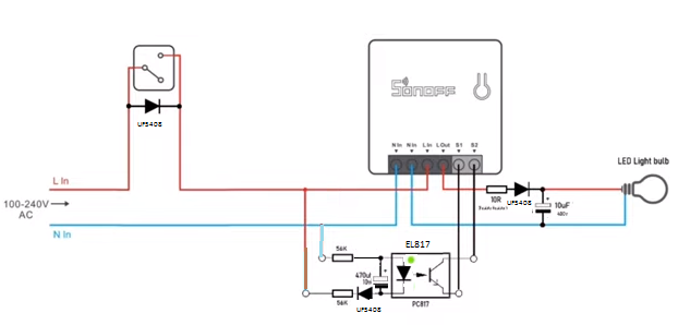

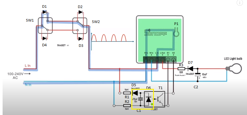

    Ah yes, I did flip those as well. If i’m doing it right on the bottom diagram
    Maybe there's more modification i need to add?
    Any more safety measures that could be added to the circuit?
    The uploader did emphasize on using fusible resistors for safety reason
  • Need to invert diode and capacitor polarity for half-wave operation
    #6 20522303
    spin55
    Posts: 209
    Help: 17
    Rate: 42
    In the image above it has a good diode, capacitor and optocoupler, but you would also need to invert the diode and capacitor of the bulb part so that everything works in the positive half-wave of the mains voltage. Actually it would be enough to exchange the inputs to the diode of the optocoupler and I think it would work with the original circuit and negative half wave. But I guess it's better to flip capacitors and diodes than cut leads if you already have the board done.
    The bottom image does not work because you would have to flip the diode and capacitor to work with a positive half wave and correctly bias the internal diode of the optocoupler.
    Greetings

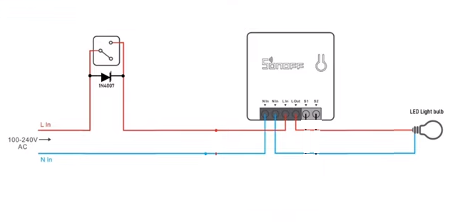

  • Reverse bulb-side diode and capacitor polarity
    #7 20522314
    ferbulous
    Posts: 419
    Help: 8
    Rate: 56
    Greetings
    Just to clarify, i would just need to change diode & capacitor poles to the bulbs back to the orignal arrangement with the sonoff?
  • #8 20522316
    spin55
    Posts: 209
    Help: 17
    Rate: 42
    That is.

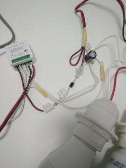

  • Wall switch only works when relay is on
    #9 20522319
    ferbulous
    Posts: 419
    Help: 8
    Rate: 56
    spin55 wrote:
    That is.
    Noted, will try that

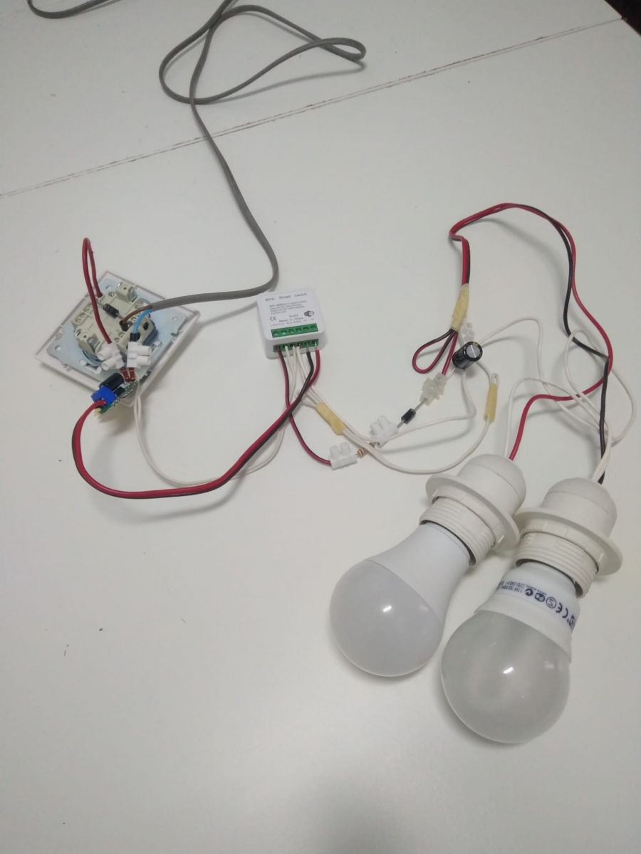

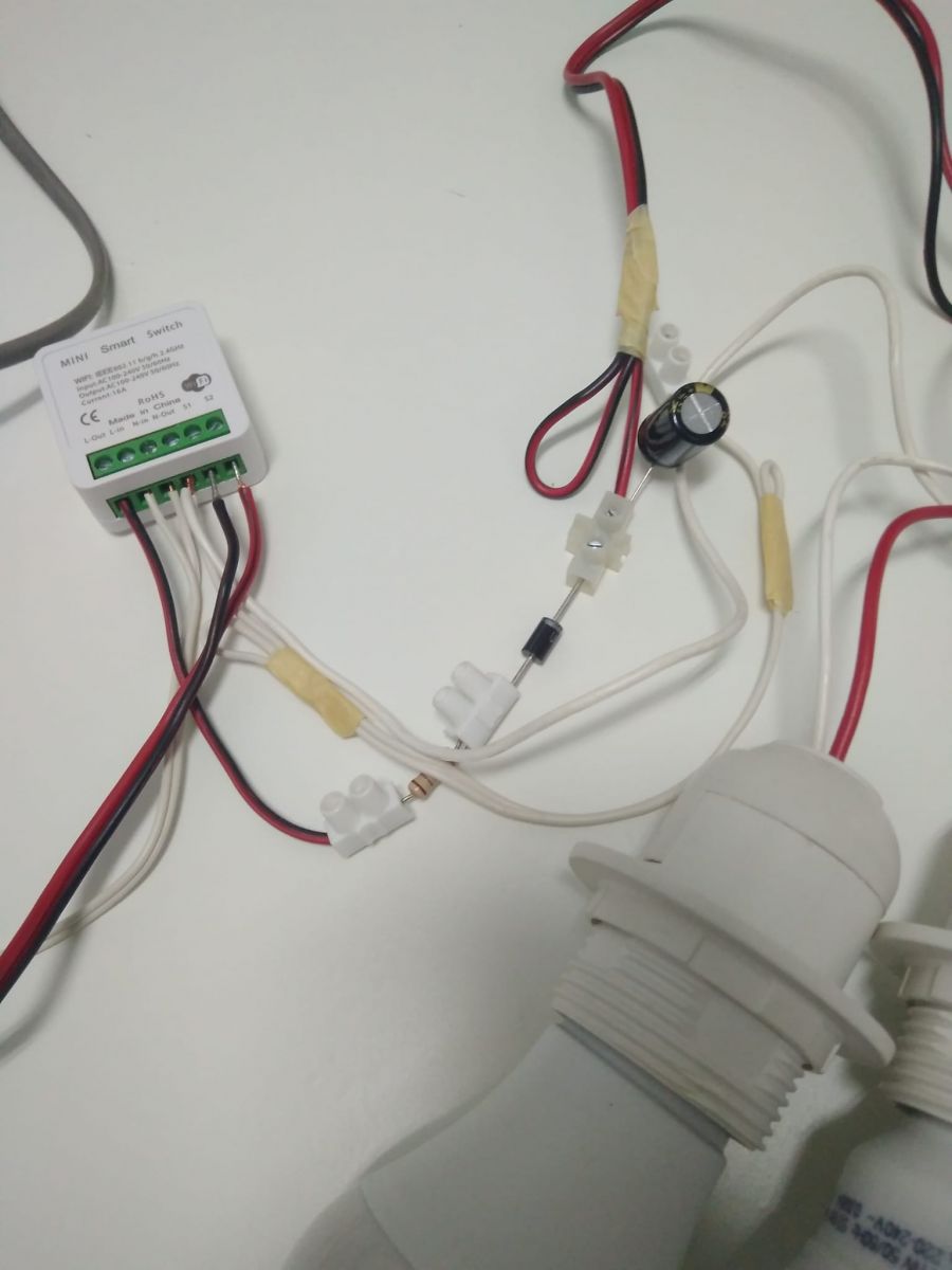

    On my 1st attempt using the sonoff arrangement. The tuya mini switch didn’t boot up at all which is why i reversed the poles
    Added after 7 [hours] 33 [minutes]:
    @spin55
    hi, some update
    With this arrangement, I can toggle from the wall switch but only if the relay is turned on. If relay is turned off, I can't trigger it from the switch

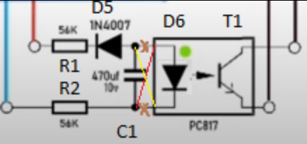

  • Check Sonoff online state and RC values first
    #10 20523207
    spin55
    Posts: 209
    Help: 17
    Rate: 42

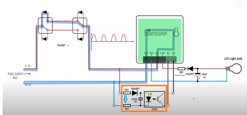

    First clarify that I have not experimented with this assembly. All I tell you is based on what I see on the electrical diagram.
    Checks to perform:
    1.- Sonoff stays online when you turn off a key?
    2.- If positive, if the relay does not hold until the next half wave, you will have to play with the values ​​of the RC network of the optocoupler. But first try to change the 56K resistor that goes to the cathode of the optocoupler diode for another 100K, or higher depending on the result.
    If that causes the LED not to activate, I would try inserting a resistor between the capacitor and the anode of the optocoupler.
    Added after 11 [minutes]:

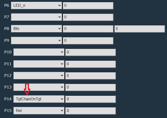

    How do you have S2 configured in Sonoff? It would have to be in Toggle mode for it to maintain the connection.
    First check that Sonoff is still online when you turn off a key before you start changing resistors.
  • Toggle mode and 100 kΩ resistor suggested for S2 hold-up

    3) yes, i have setup the pin as toggleonchannel

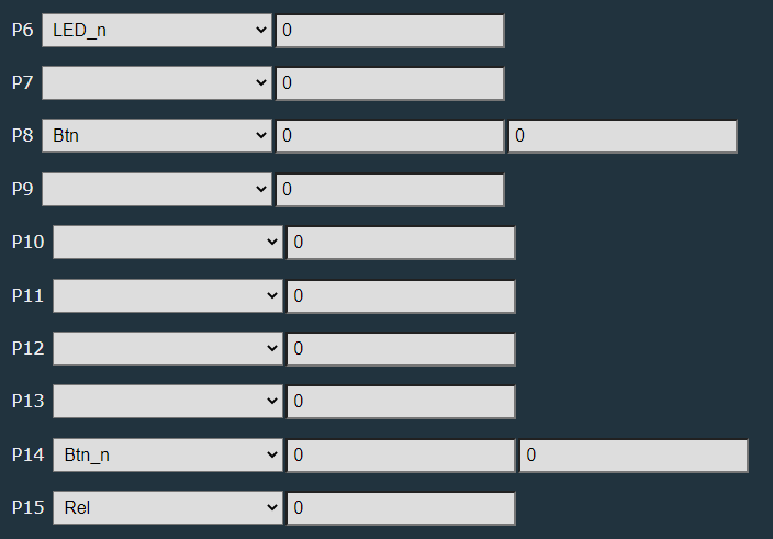

    What pin configuration do you have? Are S2 and mini push button on the same channel?
  • #15 20525635
    ferbulous
    Posts: 419
    Help: 8
    Rate: 56
    Yes, all on the same channel
    I’ve also changed the S2 (pin 14) to both toggleonchannel & btn_n with the same result
  • #16 20525679
    spin55
    Posts: 209
    Help: 17
    Rate: 42
    This is the configuration you have, right? Now I have to go out, I'll take the opportunity to buy a wall switch and I'll do some tests with my mini-switch. I'll inform you.

  • Wall switch toggles bulb but not relay
    #19 20526372
    ferbulous
    Posts: 419
    Help: 8
    Rate: 56
    @spin55
    For the tuya wifi mini
    Relay on (via openbk ui or small button)
    Wall switch toggle on led onlight bulb on
    Wall switch toggle off led onlight bulb off
    Relay off (via openbk ui or small button)
    Wall switch toggle onled off light bulb off
    Wall switch toggle off led off light bulb off
    Another scenario, if the light bulb was already off before the relay is toggled off.
    When the relay is turned on, light bulb stays off and i’ll need to toggle the wall switch again to turn light bulb on
    So toggling switch only toggles the light bulb but not the relay, and the relay has to be on to work.

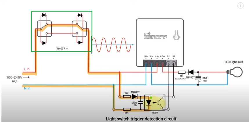

  • Diode reversal trades remote uptime for wall-switch control
    #20 20526471
    spin55
    Posts: 209
    Help: 17
    Rate: 42

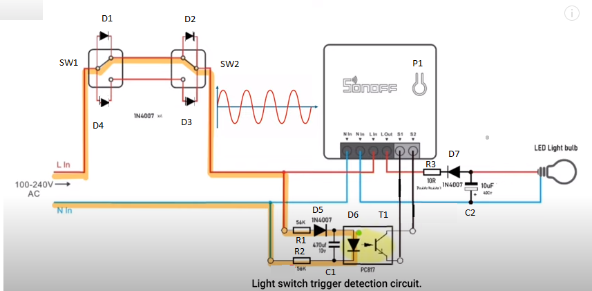

    Do what it shows in the video. When you open the relay with a push button and the bulb no longer turns on when you press the wall switch, short-circuit S1 and S2 and tell me what happens.
    By shorting S1 and S2 we will see if the relay is activated or not.
    Momentary short circuit, do not hold.
    Added after 25 [minutes]:
    If the relay is activated by short-circuiting momentarily, the RC value of the trigger must be decreased. Either by reducing the value of the 56K resistor or the 470uF capacitor, so that the optocoupler LED turns off during the negative half cycle of the wave.
    Added after 1 [hours] 15 [minutes]:

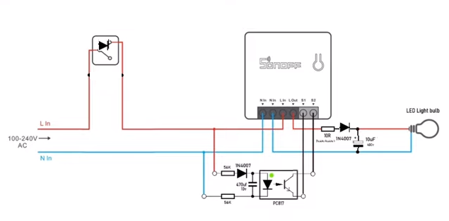

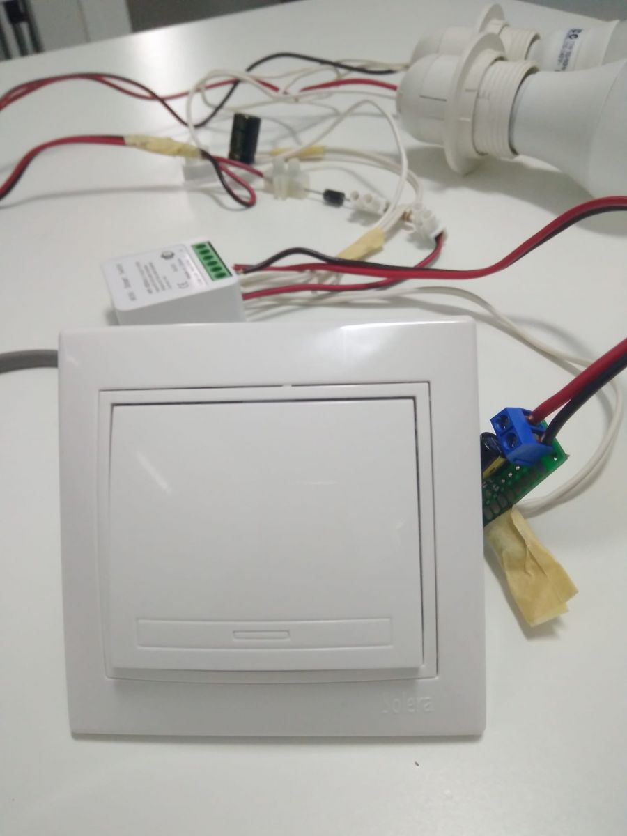

    This is the setup I've tried.
    With the diode in that position, Sonoff stays online both when I turn the wall switch ON and OFF.
    In the OFF position, the bulb blinks, but that is logical because it only works with half wave. It is corrected with capacitor and diode.
    But there is a big problem: You can't control the bulb with the wall switch, it only supports remote control via web.
    So you have to add the trigger circuit to be able to control the bulb via S1-S2. I haven't been able to do this test because I don't have an optocoupler.
    If I reverse the position of the diode, everything works like the classic series assembly where the power to Sonoff is provided through the wall switch in the ON position. So it can be controlled remotely, but when the switch turns OFF, Sonoff loses connection. In this way you have manual control of turning the bulb on and off, but remotely only if the wall switch is ON. That's how I've had it so far and it's fine for me.
    Greetings
  • Diode reversal restores classic series switching

    With the added octocoupler, this is what I'm getting now
    ferbulous wrote:
    Wall switch toggle onled off light bulb on

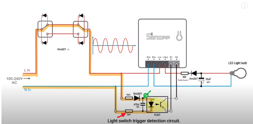

    To understand us better, we are going to take this diagram as a reference:
    Ok, how do I short S1 & S2?
    When you turn off the relay with P1 and can no longer turn on/off with SW1 or SW2, please take a piece of wire and touch both ends S1 and S2 at the same time and remove. Change the relay?
    We'll talk about that later. First you have to check if the relay changes with a short circuit of S1 and S2.
  • #23 20527785
    ferbulous
    Posts: 419
    Help: 8
    Rate: 56
    @spin55
    Would i need to remove the cables from the octocoupler to S1 & S2 before shorting it?
  • #24 20527813
    spin55
    Posts: 209
    Help: 17
    Rate: 42
    For this test do not remove them.
    Added after 8 [minutes]:
    If the relay does not switch, disconnect S1 and S2 from the optocoupler and repeat the operation.
  • #25 20529187
    spin55
    Posts: 209
    Help: 17
    Rate: 42
    With the current configuration this will not work because T1 is always ON and S1-S2 Close when SW1 is Open or Close.
    You have to turn D5, C1 and D6 to make T1 OFF and S1-S2 Open when SW1 is Open .
  • #26 20529201
    ferbulous
    Posts: 419
    Help: 8
    Rate: 56
    @spin55 I’m not home yet for now to test it
    For the 3rd pic, how do i reverse the D6 (diode) since it’s part of the octocoupler? T1 as well?
    Nevermind, I’ll just need to swap the L & N connection to the octocoupler
  • #27 20530029
    spin55
    Posts: 209
    Help: 17
    Rate: 42
    Added after 10 [hours] 26 [minutes]:
    Beware of this if C1 has polarity!.
    Working Tuya Mini wiring configuration confirmed
    #28 20531832
    spin55
    Posts: 209
    Help: 17
    Rate: 42
    And configure like this:
    Added after 6 [hours] 8 [minutes]:
    It works with this assembly:
    Added after 1 [hours] 9 [minutes]:
    Modifying Tuya Mini for No-Neutral Installation: Experiences with Diode Polarity Reversal? Modifying Tuya Mini for No-Neutral Installation: Experiences with Diode Polarity Reversal? Modifying Tuya Mini for No-Neutral Installation: Experiences with Diode Polarity Reversal? Modifying Tuya Mini for No-Neutral Installation: Experiences with Diode Polarity Reversal?
  • #29 20534324
    ferbulous
    Posts: 419
    Help: 8
    Rate: 56
    @spin55 thanks for the successful test & the working diagram!
    I think I’ll move to using cables this time instead of pcb and redo this again
