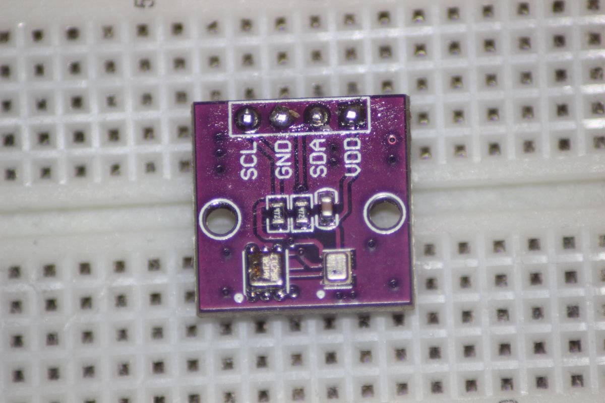

    I bought AHT20+BMP280 sensor module on I2C, connected to Wemos2mini, uploaded tasmot-sensors and BMP280 reads and AHT20 no longer, displays VEML6070.
    I do I2CScan = {"I2CScan": "Device(s) found at 0x38 0x77"}.
    Response correct.
    I2CDriver = {"I2CDriver":"7,8,9,10,11,12,13,14,15,17,18,20,24,29,31,36,41,42,44,46,48,69,76"}.
    I2CDriver12 0 = {"I2CDriver": "7,8,9,10,11,!12,13,14,15,17,18,20,24,29,31,36,41,42,44,46,48,69,76"}.
    I VEML6070 disappeared and still no AHT20.

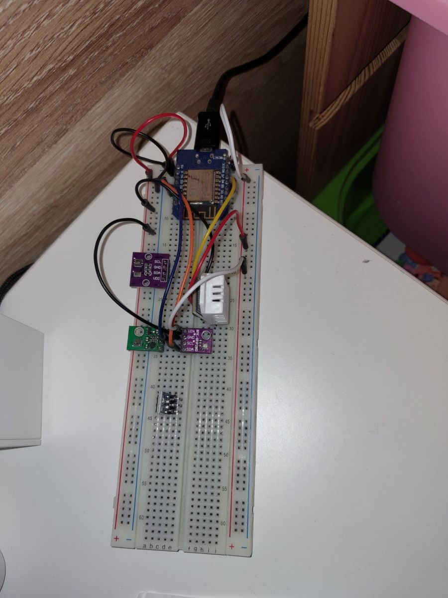

    The whole thing is powered from 3.3V connected on a pin,
    In this connection it works, when I switch to the other module it is only BME.
    When I upload the program via the arduino I get a reading in both cases.
    Breadboard with connected modules and wires. .

    khoam wrote:
    1. Using the Arduino program (from post one), are the sensors read correctly on all the modules in the above post?
    All are read by the program in Arduino.
    khoam wrote:
    2. On which modules after loading tasmot-sensors firmware the AHT20 cannot be read?
    On none. Only BMP reads correctly.
    khoam wrote:
    3. Has the tasmot-sensors firmware been compiled by you with the AHT20 option checked?
    I compiled with the option checked
    #ifdef USE_AHT2x
      #undef USE_AHT2x
    #endif
    #define USE_AHT2x
    I read BMPs from both, but only AHT20 single.

    Rate: 206
    Probably the best I can do.
    Electronic module with labels SCL, GND, SDA, VDD on a breadboard
    Added after 7 [hours] 26 [minutes]:
    I figured out what, I didn't figure out how.
    For AHT10/15 the initiation command is binary 1110'0001 hexadecimal E1
    For AHT20 binary 1011'1110 hexadecimal BE
    In the AHT20 library for Arduino there is a definition
    sfe_aht20_reg_initialize = 0xBE,
    And in Tasmota
    #ifdef USE_AHT2x
      #define AHTX_CMD     0xB1 // Cmd for AHT2x
      const char ahtTypes[] PROGMEM = "AHT2X|AHT2X";
    #else
      #define AHTX_CMD     0xE1 // Cmd for AHT1x
      const char ahtTypes[] PROGMEM = "AHT1X|AHT1X";
    #endif
    Now I only have the problem how to compile Tasmota with the changed file from AHT20 support Tasmota-.13.2.0
    EDIT
    I managed to compile the distribution with the change and it WORKS!!!!
    I used PlatformIO .
