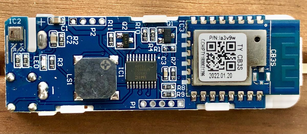

How do I configure OpenBeken for a battery-powered TH-002 TuyaMCU sensor with CB3S, UM8005, and AHT20, and map its datapoints correctly?
This device should be treated as a battery-powered TuyaMCU sensor, not as a normal always-on WiFi device: the MCU powers the WiFi module through transistor Q1 only when it needs to report data [#20468733] Put `startDriver TuyaMCU` and `startDriver tmSensor` into `autoexec.bat`, save it, then disconnect the module’s external 3.3 V supply and let the unit run from the battery so you can capture the real TuyaMCU packets when the MCU wakes it up [#20470261] [#20470293] The captured packets show the datapoints and types, for example dpID 1 = temperature_div10, dpID 2 = humidity, dpID 10/11 = temperature_div10, dpID 12/13 = humidity, dpID 14/15 = ReadOnly, dpID 17–20 = TextField, and dpID 21 = ReadOnly [#20470327] Then map them with `setChannelType` and `linkTuyaMCUOutputToChannel`, e.g. `setChannelType 1 humidity` + `linkTuyaMCUOutputToChannel 2 val 1`, and `setChannelType 2 temperature_div10` + `linkTuyaMCUOutputToChannel 1 val 2` [#20470496] If the channels briefly reset to zero/null before TuyaMCU reports again, try `SetStartValue [channel] -1` so OpenBeken remembers the last value instead of publishing zeros [#20475501]
  • OpenBeken setup for TH002 sensor and MCU mapping
    #1 20468693
    GeorgeQW
    Posts: 14

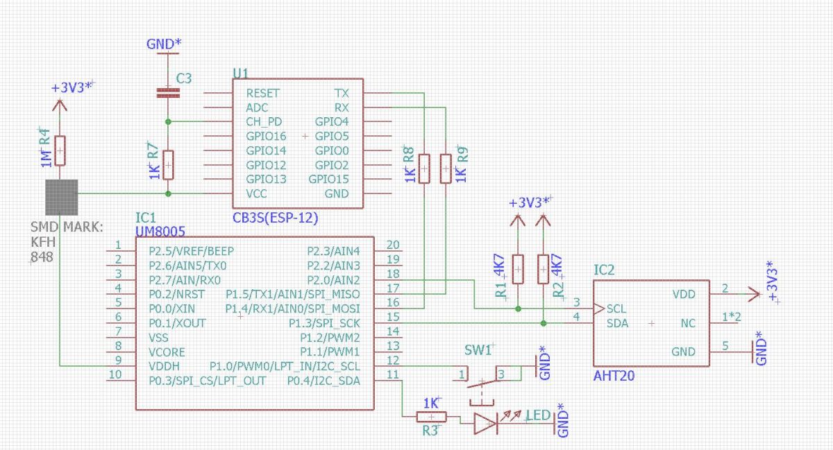

    Has anyone managed to separate the TH002 with the CB3S and the UM8005 and the AHT20 sensor?
    I partially painted it. I have uploaded SW OpenBeken, but I still don't know what to do with it...
    Thanks GW
    Translated by google

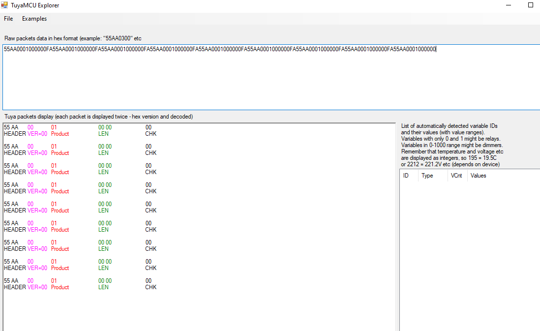

    Data Power On Start Pair TUYA BaudRate 9600 - CB3S RXD - TTL USB RXD:

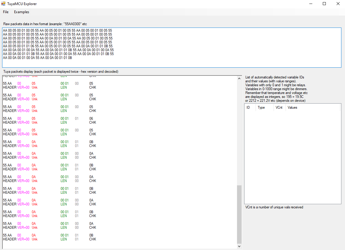

    Data Power On Start Pair TUYA CB3S TXD - TTL USB RXD:

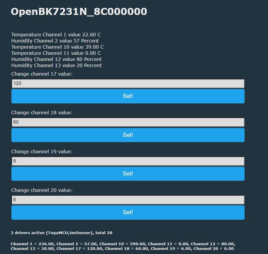

    autoexec.bat
    startDriver TuyaMCU
    setChannelType 0 ReadOnly
    linkTuyaMCUOutputToChannel 0 val 0
    setChannelType 1 temperature_div10
    linkTuyaMCUOutputToChannel 1 val 1
    setChannelType 2 Humidity
    linkTuyaMCUOutputToChannel 2 val 2
    setChannelType 10 temperature_div10
    linkTuyaMCUOutputToChannel 10 val 10
    setChannelType 11 temperature_div10
    linkTuyaMCUOutputToChannel 11 val 11
    setChannelType 12 Humidity
    linkTuyaMCUOutputToChannel 12 val 12
    setChannelType 13 Humidity
    linkTuyaMCUOutputToChannel 13 val 13
    setChannelType 14 ReadOnly
    linkTuyaMCUOutputToChannel 14 val 14
    setChannelType 15 ReadOnly
    linkTuyaMCUOutputToChannel 15 val 15
    setChannelType 17 TextField
    linkTuyaMCUOutputToChannel 17 val 17
    setChannelType 18 TextField
    linkTuyaMCUOutputToChannel 18 val 18
    setChannelType 19 TextField
    linkTuyaMCUOutputToChannel 19 val 19
    setChannelType 20 TextField
    linkTuyaMCUOutputToChannel 20 val 20
    setChannelType 21 ReadOnly
    linkTuyaMCUOutputToChannel 21 val 21

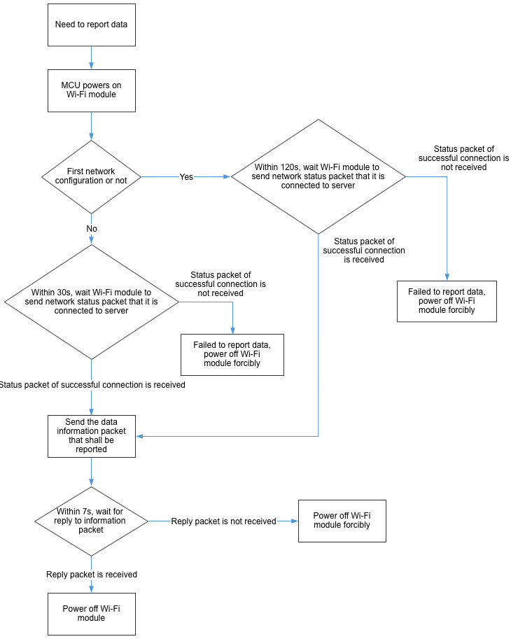

    TuyaMCU protocol likely powers Wi‑Fi via Q1
    #2 20468733
    Posts: 14754
    Rate: 12875
    I have moved your post to separate topic, because it has nothing to do with Qiachip Smart Switch, which is not even a battery-powered device.
    Regarding your question... I am not sure if your schematic is correct. I think that RXD/TXD connection seems strange.
    I'd suspect that your device is a TuyaMCU device, and it's using TuyaMCU protocol for battery-powered devices.
    So, you'd need to do something like here:
    https://www.elektroda.com/rtvforum/topic3914412.html
    I think that Q1 on your schematic is responsible for powering on and off the WiFi module. WiFI module is not powered by default. It is only powered when MCU decides that it's time to report data to server. Then MCU powers on WiFI module and reports measurements by TuyaMCU protocol.
    Read more here:
    https://developer.tuya.com/en/docs/iot/tuyacl...niversalserialaccessprotocol?id=K95afs9h4tjjh
    [CB3S/AHT20/UM8005] Separating TH002, OpenBeken Sensor Support, and Configuration
    See? MCU power on the WiFi module via mentioned transistor.
    You will need to check OpenBeken Web App Logs to see which dpID is used for that (or capture communication with USB to TTL converter), then adjust dpIDs in the config.
    Of course, the second option would be to desolder MCU and Q1 and convert your sensor to the deep sleep system, maybe that approach could work:
    https://www.elektroda.com/rtvforum/topic3945688.html
    but the one here is using SHT30 and not AHT20.. we would need to check how many changes to protocol are needed to support it.

    yes schematic error. I miscalculated in pins. Corrected.
    I added what the original paired T&H sensor sends after start.
    I don't know what the hex data means.
    Will there be a driver for AHT20? I'm sure I'm not the only one who feels that way. :-)

    #5 20470261
    Posts: 14754
    Rate: 12875
    Driver for AHT20 might be added soon, regarding the information, can you create autoexec with:
    startDriver TuyaMCU
    and then open Web App log, and then wake up device (by a pairing button? or just wait for MCU to wake it up?) and copy paste here the log of received TuyaMCU packets?

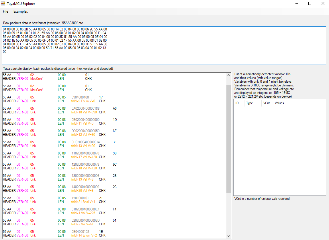

    Btw, I see you also posted some hex data, but in a format of image, and I can't copy from that to the analyzer...

  • External power keeps MCU asleep and blocks measurements
    #9 20470293
    Posts: 14754
    Rate: 12875
    This is not a correct approach to do this. You have to put the mentioned two commands in autoexec.bat, save that file, then you must disconnect your external power from the WiFI module (your 3.3V supply), and let the device run on the battery.
    Then, after some time, when the MCU decides that it's a time to report data to WiFi module, the MCU will wake up and send data to OBK via UART, and in this case data should contain measurements.
    There is no way around it, you can try pressing button so it maybe it will wake up and do measurements faster, but I don't know if it will work.
    This fragment of log:
    Info:TuyaMCU:Skipped data (part) 00 00 00 00 00 00 00 00 00 00 00 00 00 00 00 00 00 00 00 00 00 00 00 00 00 00 00 00 00 00 00 00 00 00 00 00 00 00 00 00 00 00 00 00 00 00 00 00 00 00 00 00 00 00 00 00 00 00 00 00 00 00 00 00 00 00 00 00 00 00 00 00 00 00 00 00 00 00 00 00 00 00 00 00 00
    strongly shows that you are powering WiFi module externally while the MCU is still asleep, and this is abnormal situation for that device, that will not give you correct data.

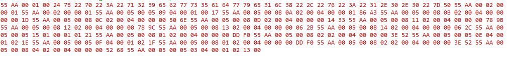

    So I finally managed to capture something in HEX; it's in the attached files.
    • _GoPair_TUYA.txt (1010 Bytes) You must be logged in to download this attachment.
    • CB3S_PowerOn_NoTUYA_Paired.txt (142 Bytes) You must be logged in to download this attachment.

    #12 20470327
    Posts: 14754
    Rate: 12875
    Only the last file contains some dpIDs.
    [CB3S/AHT20/UM8005] Separating TH002, OpenBeken Sensor Support, and Configuration [CB3S/AHT20/UM8005] Separating TH002, OpenBeken Sensor Support, and Configuration
    55 AA	00	05		00 05	0904000100	17
    HEADER	VER=00	Unk		LEN	fnId=9 Enum V=0	CHK
    55 AA	00	05		00 08	0A02000400000186	A3
    HEADER	VER=00	Unk		LEN	fnId=10 Val V=390	CHK
    55 AA	00	05		00 08	0B02000400000000	1D
    HEADER	VER=00	Unk		LEN	fnId=11 Val V=0	CHK
    55 AA	00	05		00 08	0C02000400000050	6E
    HEADER	VER=00	Unk		LEN	fnId=12 Val V=80	CHK
    55 AA	00	05		00 08	0D02000400000014	33
    HEADER	VER=00	Unk		LEN	fnId=13 Val V=20	CHK
    55 AA	00	05		00 08	1102000400000078	9B
    HEADER	VER=00	Unk		LEN	fnId=17 Val V=120	CHK
    55 AA	00	05		00 08	1202000400000078	9C
    HEADER	VER=00	Unk		LEN	fnId=18 Val V=120	CHK
    55 AA	00	05		00 08	1302000400000006	2B
    HEADER	VER=00	Unk		LEN	fnId=19 Val V=6	CHK
    55 AA	00	05		00 08	1402000400000006	2C
    HEADER	VER=00	Unk		LEN	fnId=20 Val V=6	CHK
    55 AA	00	05		00 05	1501000101	21
    HEADER	VER=00	Unk		LEN	fnId=21 Bool V=1	CHK
    55 AA	00	05		00 08	01020004000000E1	F4
    HEADER	VER=00	Unk		LEN	fnId=1 Val V=225	CHK
    55 AA	00	05		00 08	020200040000003D	51
    HEADER	VER=00	Unk		LEN	fnId=2 Val V=61	CHK
    55 AA	00	05		00 05	0E04000102	1E
    HEADER	VER=00	Unk		LEN	fnId=14 Enum V=2	CHK
    55 AA	00	05		00 05	0F04000102	1F
    HEADER	VER=00	Unk		LEN	fnId=15 Enum V=2	CHK
    55 AA	00	05		00 08	040200040000005B	71
    HEADER	VER=00	Unk		LEN	fnId=4 Val V=91	CHK
    55 AA	00	05		00 05	0304000102	13
    HEADER	VER=00	Unk		LEN	fnId=3 Enum V=2	CHK
    It seems they match the IDs you posted, right? So we can easily figure out they meaning.
    Well, so the job is almost done. We have verified that the data is sent and we know the IDs and the var types. Now you can use linkTuyaMCUOutputToChannel to map them. Do you know how?

    #17 20470854
    GeorgeQW
    Posts: 14
    Yes, everything is correct, I check it using the TUYA app, including "apply multiplier". I put the settings in the first post and it's all together.
    Yes, it already passes data:
    obk8C000000
    connected = online
    sockets = 2
    rssi = -81
    uptime = 18
    host = obk8C000000
    build = Build on Mar 3 2023 16:11:58 version 1.15.522
    mac = c8:47:8c:00:00:00
    freeheap = 73072
    ip =
    1
    get = 0
    2
    get = 0
    10
    get = 39.000000
    11
    get = 0
    12
    get = 80
    13
    get = 20
    14
    get = 2
    15
    get = 0
    17
    get = 120
    18
    get = 60
    19
    get = 6
    20
    get = 6
    21
    get = 0

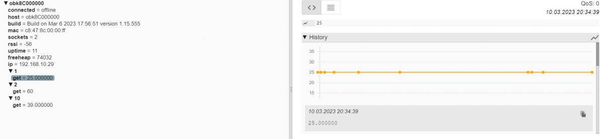

    It appears for a while and then it starts deleting. Surely there must be a data-forced sequence right?
    Something else needs to be set somewhere...
    I have check:
    Flag 7 - [MQTT] [Debug] Always set Retain flag to all published values
    Flag 10 - [MQTT] Broadcast self state on MQTT connect
    Flag 19 - [MQTT] Always publish channels used by TuyaMCU
    Flag 21 - [MQTT] Retain power channels (Relay channels, etc)
    Flag 30 - [MQTT] Enable Tasmota TELE etc publishes (for ioBroker etc)
    Flag 33 - [MQTT] Apply channel type multiplier on (if any) on channel value before publishing it
    Flag 27 - [HASS] Invoke HomeAssistant discovery on change to ip address, configuration
    Flag 37 - [WiFi] Quick connect to WiFi on reboot (TODO: check if it works for you and report on github)
  • TH-002 ID resets after second MQTT send

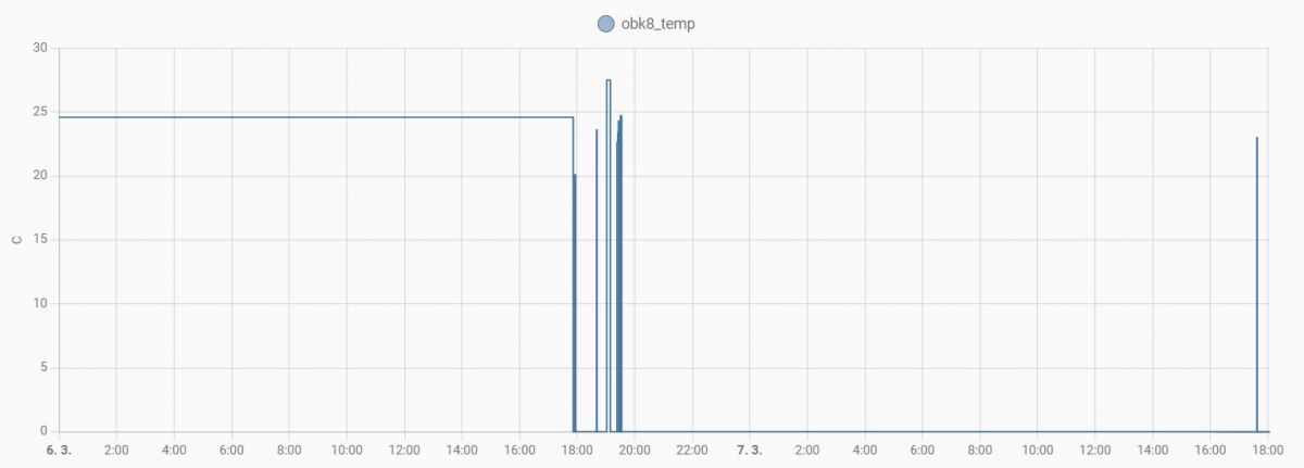

  • Battery-powered sensor stops reporting after reset
    #20 20474650
    GeorgeQW
    Posts: 14
    After connecting the batteries, the data will be delivered to the correct ID according to how I have it set up.
    ID1 (Temp)
    ID2 (Humidity)
    After a few minutes (approx. 5) it resets (ID1 null, ID2 null, etc...) them and then doesn't supply any more data until the battery is disconnected and reconnected. It supplies data, then resets it and doesn't respond anymore.
    >>20474618
    WebApp log
    It's possible that I have it set up wrong :-)
    • WebApp.txt (38.79 KB) You must be logged in to download this attachment.
  • Set channels to remember last values on reboot
    #21 20475501
    Posts: 14754
    Rate: 12875
    Regarding zero spikes - let's try something. Let's make channels remember their values after reboot. This is because it seems that the values are sent to MQTT before TuyaMCU reports them... just try it, as a temporary solution.
    What is your current config? Which channels are you using?
    Add to config:
    // SetStartValue  [Channel] [Value]
    // 1 means set to 1 on start, 0 means set to 0, -1 means "remember last value"
    SetStartValue 0 -1
    SetStartValue 1 -1
    SetStartValue 2 -1
    SetStartValue 3 -1
    SetStartValue 4 -1
    Regarding this:
    Do you mean that device does not wake up anymore or it wakes up, but does not send data?
    Maybe we need to set something like next measurement interval as well... from our script... you have more advanced device that the ones I've seen.

    Info:MAIN:Time 13, idle 370492/s, free 73152, MQTT 1(1), bWifi 1, secondsWithNoPing -1, socks 2/38
    Info:MQTT:Publishing val 192.168.10.25 to obk8C000000/ip retain=0
    Info:TuyaMCU:TUYAMCU received: 55 AA 00 00 00 01 01 01
    Info:TuyaMCU:TuyaMCU_ProcessIncoming[ver=0]: processing command 0 (Hearbeat) with 8 bytes
    Info:MAIN:Time 14, idle 182290/s, free 73152, MQTT 1(1), bWifi 1, secondsWithNoPing -1, socks 2/38
    Info:MQTT:Forced channel publish! Publishing val 25.299999 to 1
    Info:MQTT:Publishing val 25.299999 to obk8C000000/1/get retain=0
    Info:MAIN:Time 15, idle 185923/s, free 73152, MQTT 1(1), bWifi 1, secondsWithNoPing -1, socks 2/38
    Info:MQTT:MQTT client in mqtt_incoming_publish_cb topic obk8C000000/1/get
    Info:MQTT:MQTT in topic obk8C000000/1/get
    Info:MQTT:MQTT topic not handled: obk8C000000/1/get
    Info:MQTT:channelSet NOT 'set'
    Info:MQTT:Forced channel publish! Publishing val 62 to 2
    Info:MQTT:Publishing val 62 to obk8C000000/2/get retain=0

    A_CMD_MCU_CONF, TODO!
    Info:TuyaMCU:TUYAMCU received: 55 AA 00 01 00 24 7B 22 70 22 3A 22 71 32 39 65 62 77 73 35 61 64 77 79 65 31 6C 38 22 2C 22 76 22 3A 22 31 2E 30 2E 30 22 7D 50
    Info:TuyaMCU:TuyaMCU_ProcessIncoming[ver=0]: processing command 1 (QueryProductInformation) with 43 bytes
    Info:TuyaMCU:TuyaMCU_ParseQueryProductInformation: received {"p":"q29ebws5adwye1l8","v":"1.0.0"}

    I put the sensor outside the window, where the temperature is about 4.6C. The temperature and humidity do not change. It is the same as measured after restarting TH-002 get = 25.700000. A low temperature alarm beeps outside. No change in data.
  • MQTT values update only after battery reconnect
    #23 20479974
    GeorgeQW
    Posts: 14
    >>20475501
    @p.kaczmarek2
    so I completely reflashed it. It now behaves like it will send the correct data over MQTT when the battery is connected. Then it regularly sends the same values. After connecting the batteries again, the values are restored. Again, it sends the updated values over and over again. I don't know what to do with that...
    GQ

    I have the same device (two of them). Going to take off tuyamcu and wire everything to bk7231n chip instead.
    Only two small issues:
    1 - there are no dc-dc buck onboard, so 2.5-3.6 voltage.
    2 - will have to make voltage divider for battery measurement.
