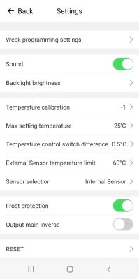

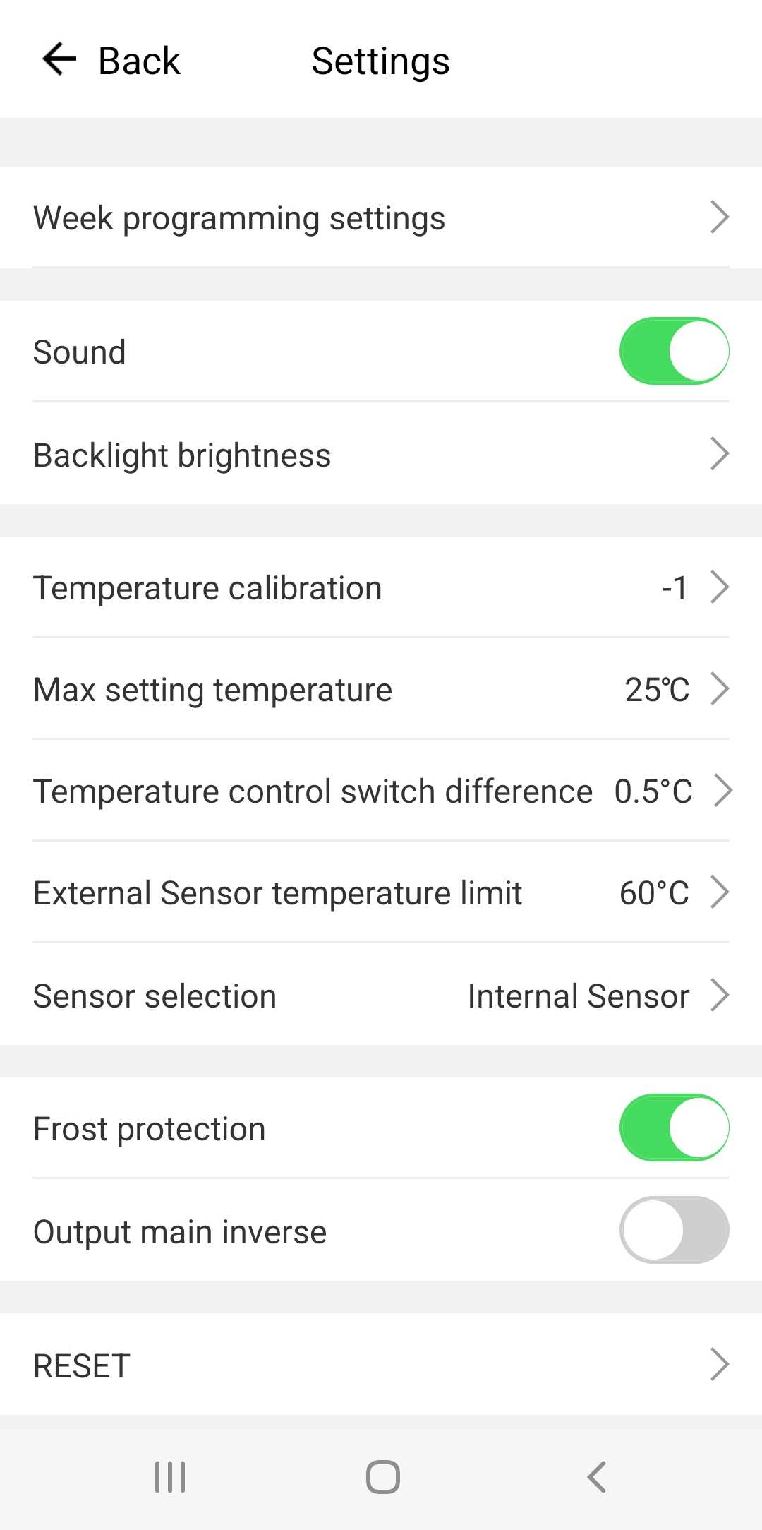

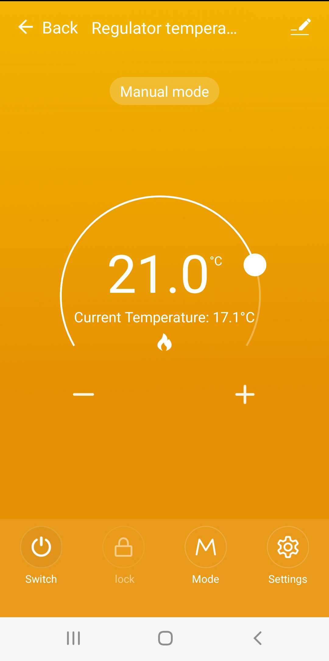

    Yes, for basic operation internet access is not necessary, the controller can operate autonomously. At least the model I purchased for just over PLN100 on Aliexpress. Temperature, schedules, timer, as well as other options available in the menu (e.g. hysteresis, relay operation or even calibration) can be set via buttons on the device panel. Of course, over wifi (internet) and the app it is easier and more convenient, the clock synchronisation is automatic, reading/setting the temperature and any options can be done from outside the house, and so on. In addition, in the app you can do automations basically limited by our imagination. For example, I've made myself switch the heating on for 0.5 and 1h (simply temp in the controller at 22st, I don't heat higher anyway) and notifications when a relay is switched on/off. The latter is basically just for now as a test, I just wanted to see how the controller "works" at a set temperature, e.g. 21 degrees.

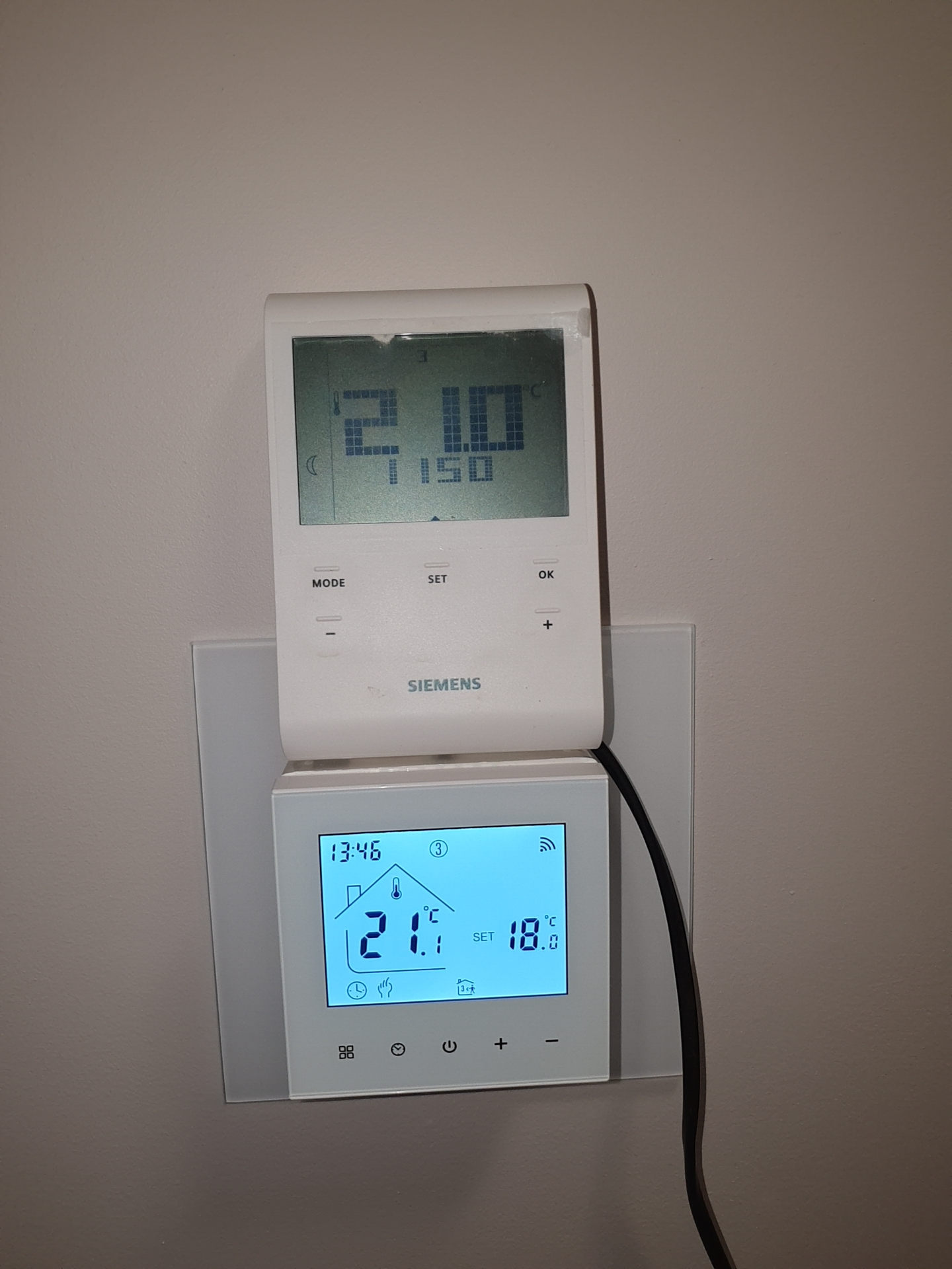

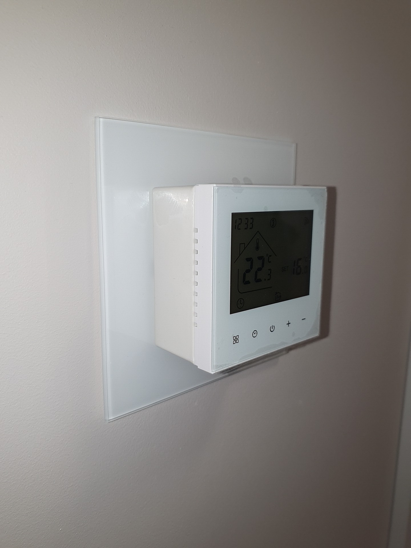

    Likewise at the moment - I'm just out and about and can see and control what's happening to the temperature in the property. I'll be able to turn it on and warm it up to optimum in good time before I return. This is just one example . the "convenience surcharge" amounted to just over 100PLN. Plus about 1.5 hours for the replacement, and even that was only so much time because it took a bit of "fiddling" with the mounting, as the predecessor was surface-mounted. Unfortunately I was unable to find a similarly mounted model with wifi. I also didn't want to forge a hole in the wall, the renovation was recent, and unfortunately I didn't think about replacing the controller at the time. In the end, the controller was mounted in a surface box, also purchased from a slant-eyed shop for a few zlotys. The aesthetics turned out so-so, but not too bad either, I've already got used to it ;-) Aaaa, and also in order to mask the marks on the wall from the previous one (slightly different dimensions), I put a glass so-called 'dirt plate' under the box, which is mounted under the light switches. The cost of this tile was probably around 25PLN. So the total cost of the replacement is, let's say, about 150 PLN. I can manage somehow, maybe even without visiting Stork ;-)

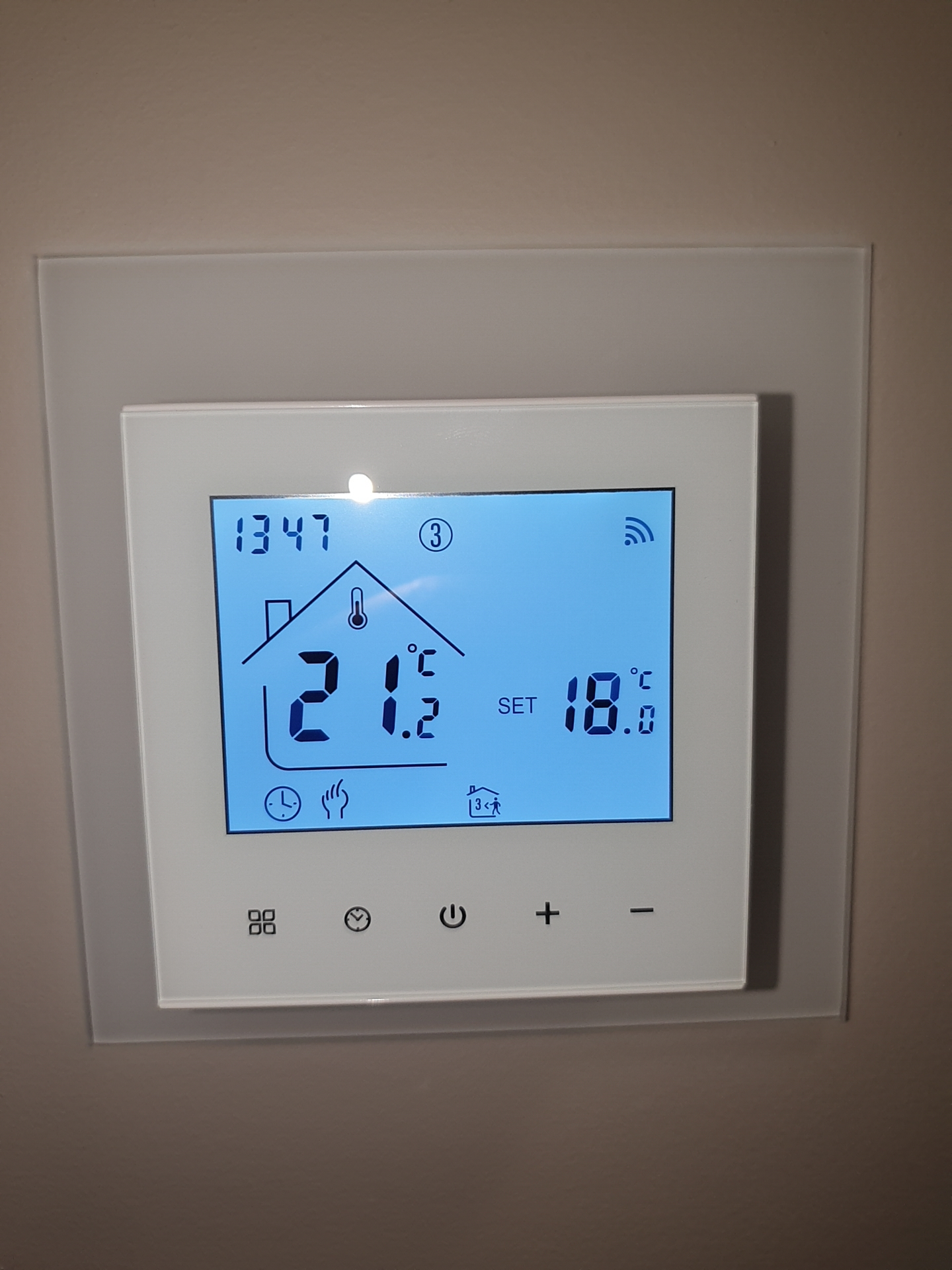

    What have I gained compared to the "original"? Apart from the aforementioned remote control basically from anywhere, the automatic clock synchronisation, the ease of configuration via the app, the possibility of creating additional automations? The new controller shows both temperatures at the same time: the current temperature and the setpoint. The original displayed one, either-or. I'm more comfortable with the current solution, you can immediately see what and how. Also the backlighting of the screen has been added, which was apparently spared in the predecessor. Oh, originally fitted by the builders of the building: Siemens RDE100.

    Below are photos of the installed unit and screenshots from the app. Unfortunately, there is no photo of the Siemens when it was still attached to the wall, but there is a comparison with the new one. If there is interest I will add photos of the assembly of the "guts".
