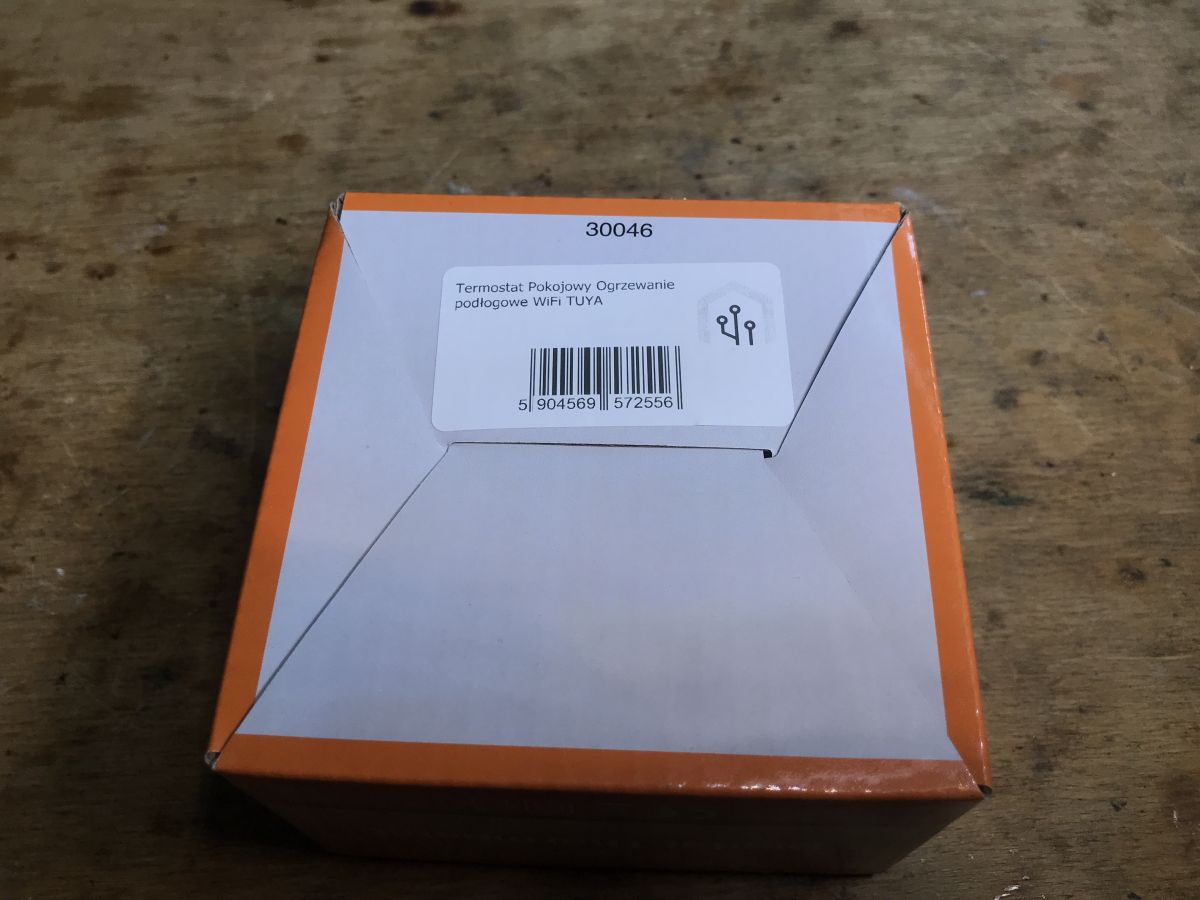

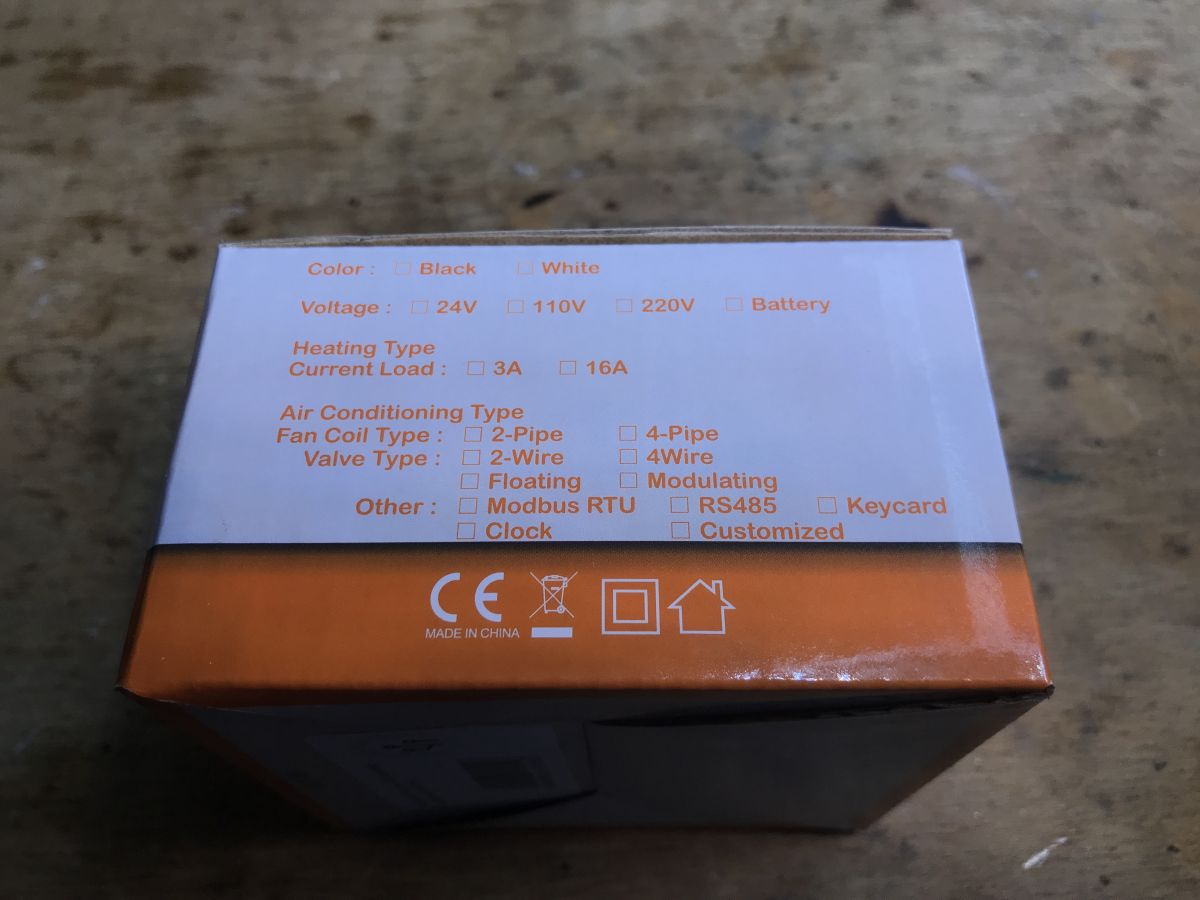

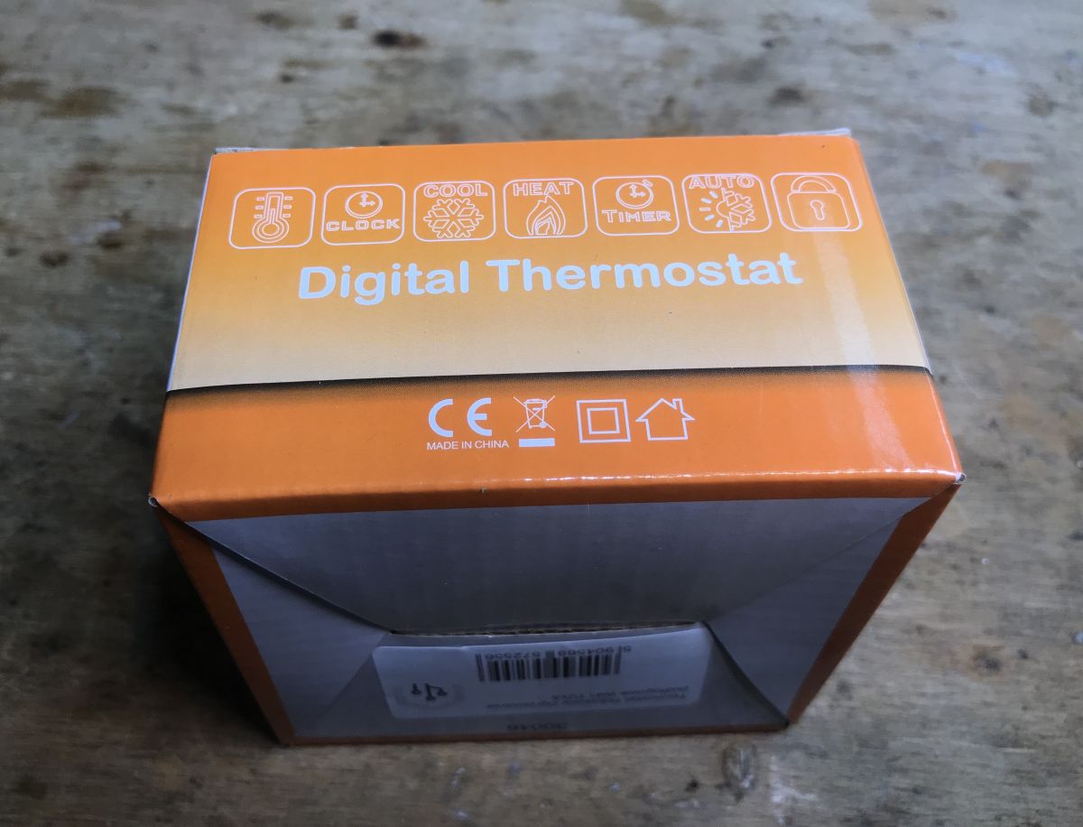

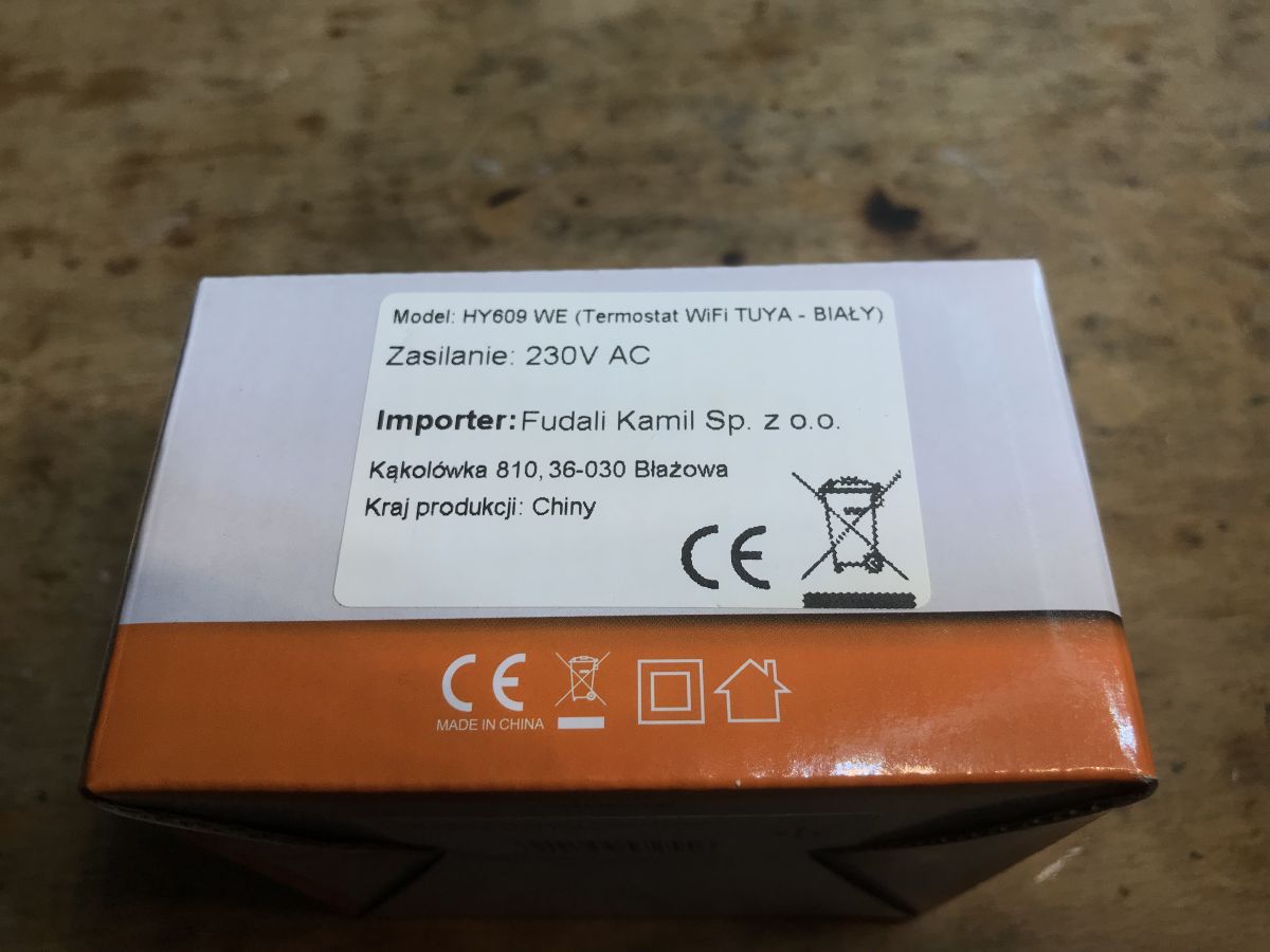

    That's a lot of theory, now let's see how it looks in practice. Markings on the packaging:
    Orange box of the digital thermostat KHY609 with listed features on the front. Box of KHY609 thermostat with function icons and certifications. Packaging of a WiFi Tuya room thermostat.. Photo of HY609 WE thermostat package with label. HY609-WE thermostat packaging with technical information

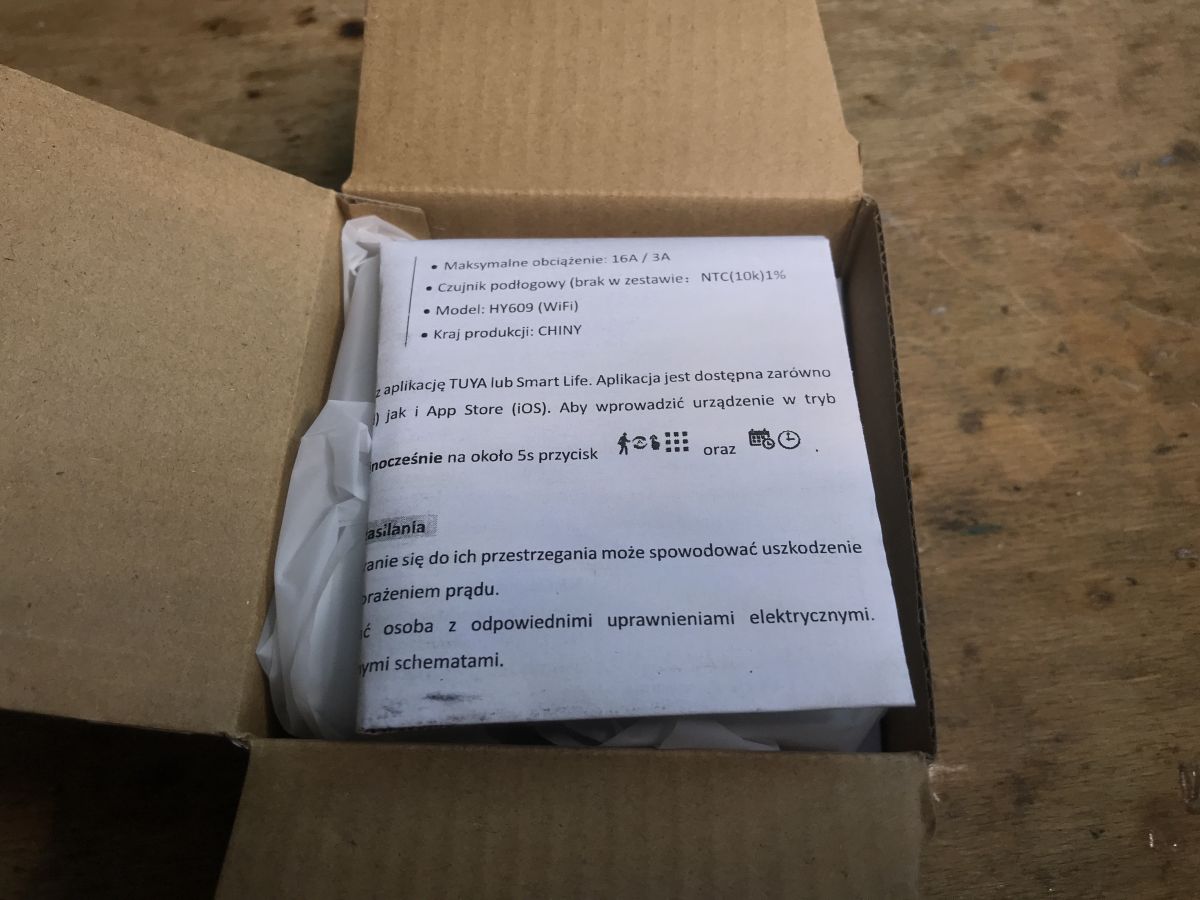

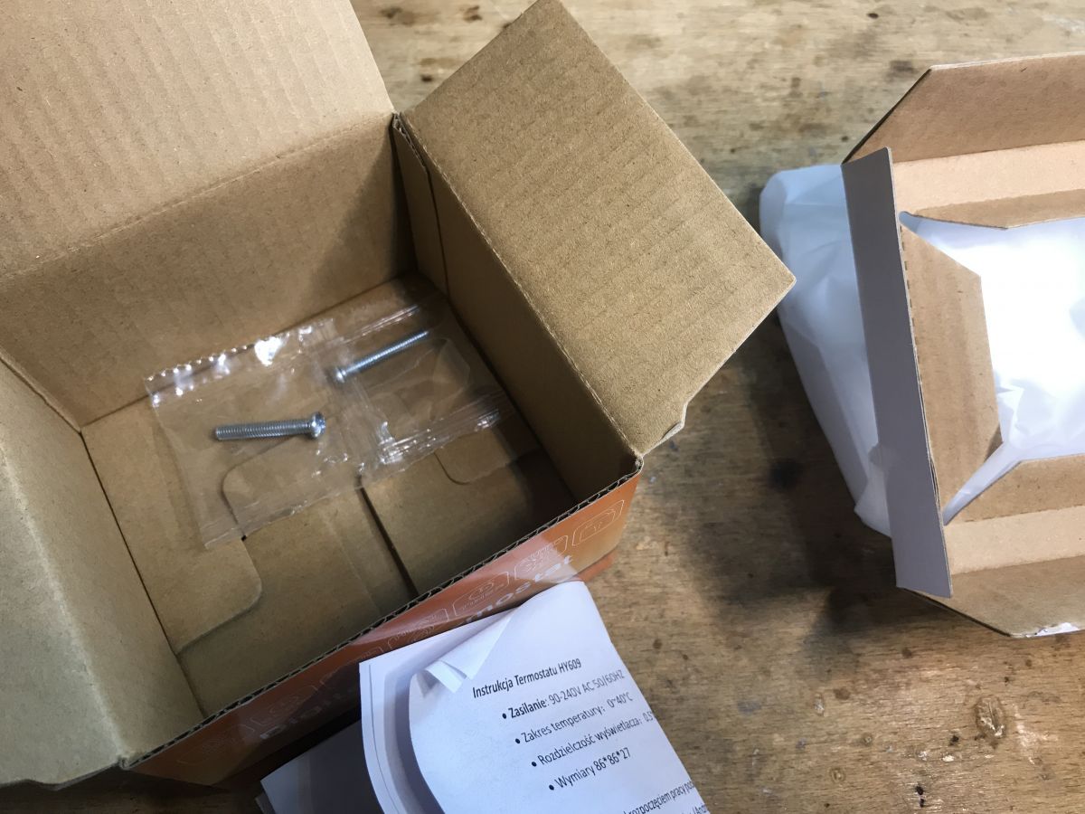

    Contents (thermostat, mounting screws, instructions):
    Contents of the HY609-WE thermostat box Open box of the HY609-WE thermostat with visible mounting screws and instructions.

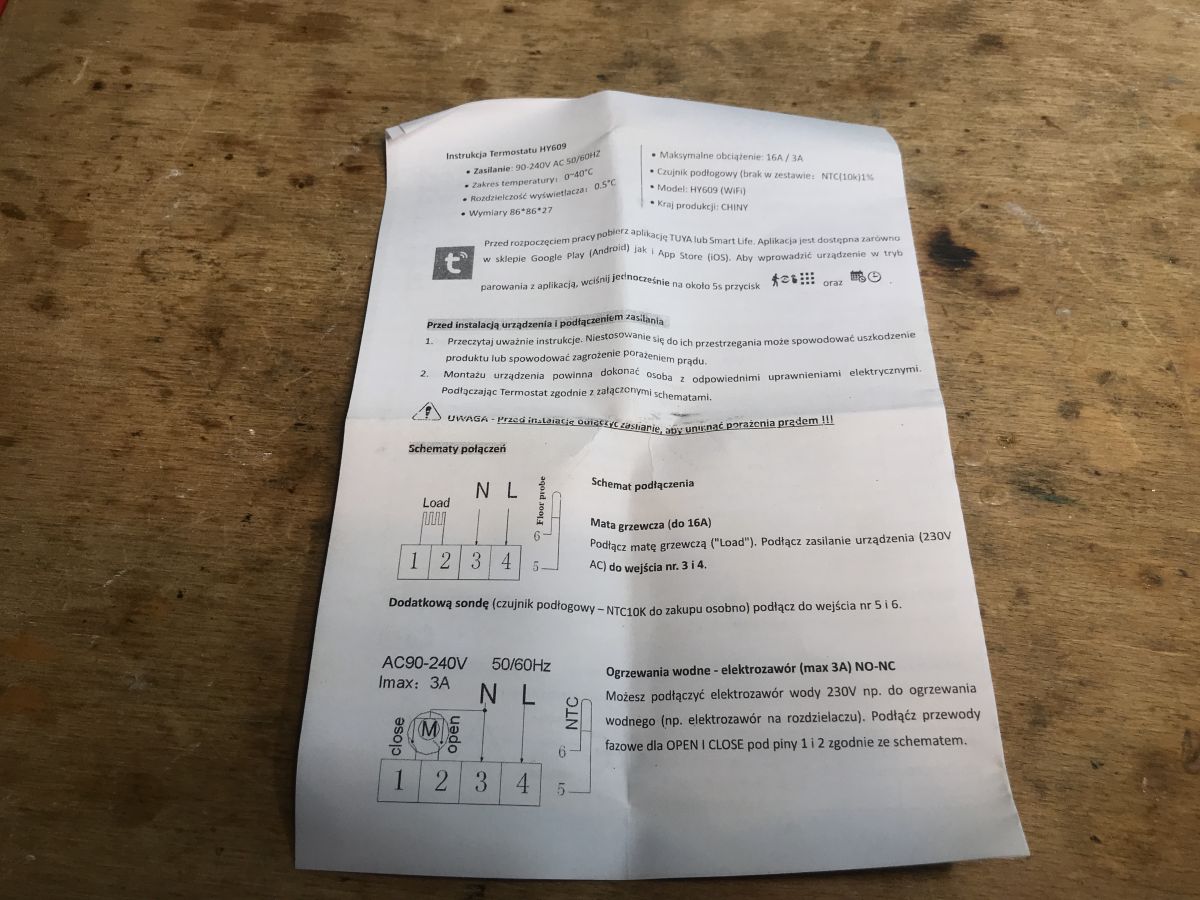

    Instructions (I won't rewrite it to the subject, please enlarge the photo if you need to):
    User manual for a room thermostat with touch buttons and LED display. Installation and connection manual for the HY609 thermostat on a wooden table. User manual for the HY609-WE room thermostat with programming and protection features.

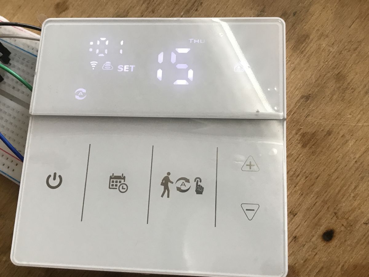

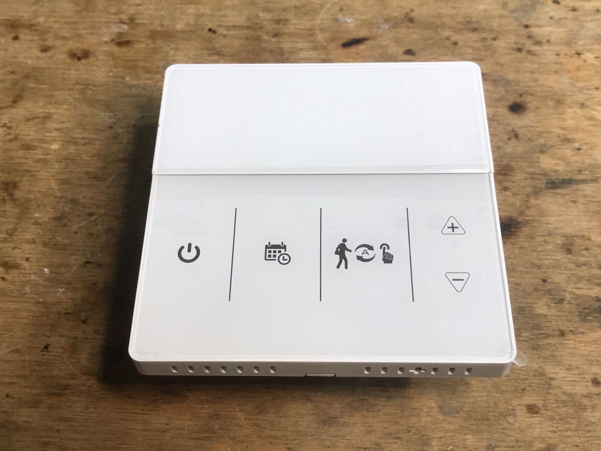

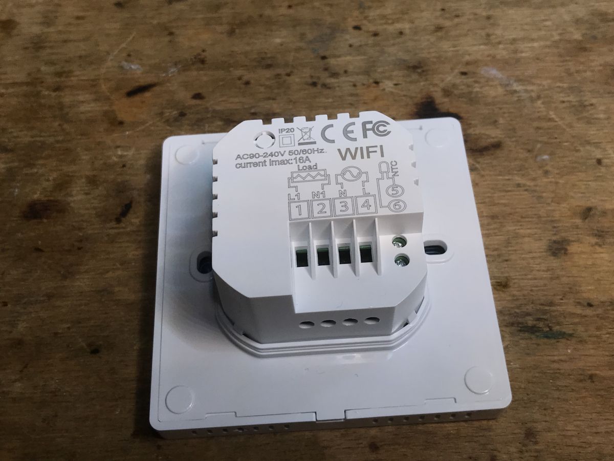

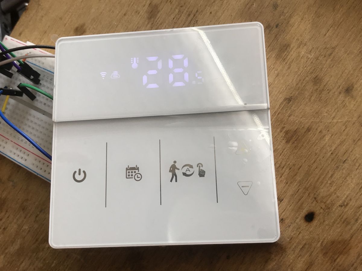

    Well, and the thermostat itself:
    Back of a room thermostat with several labels and wire connectors. White room thermostat with touch buttons on a wooden background.

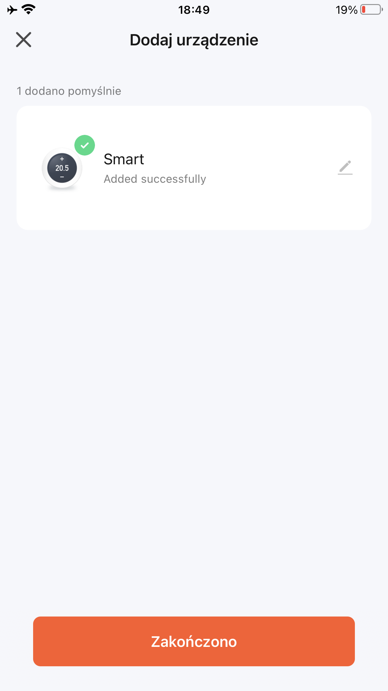

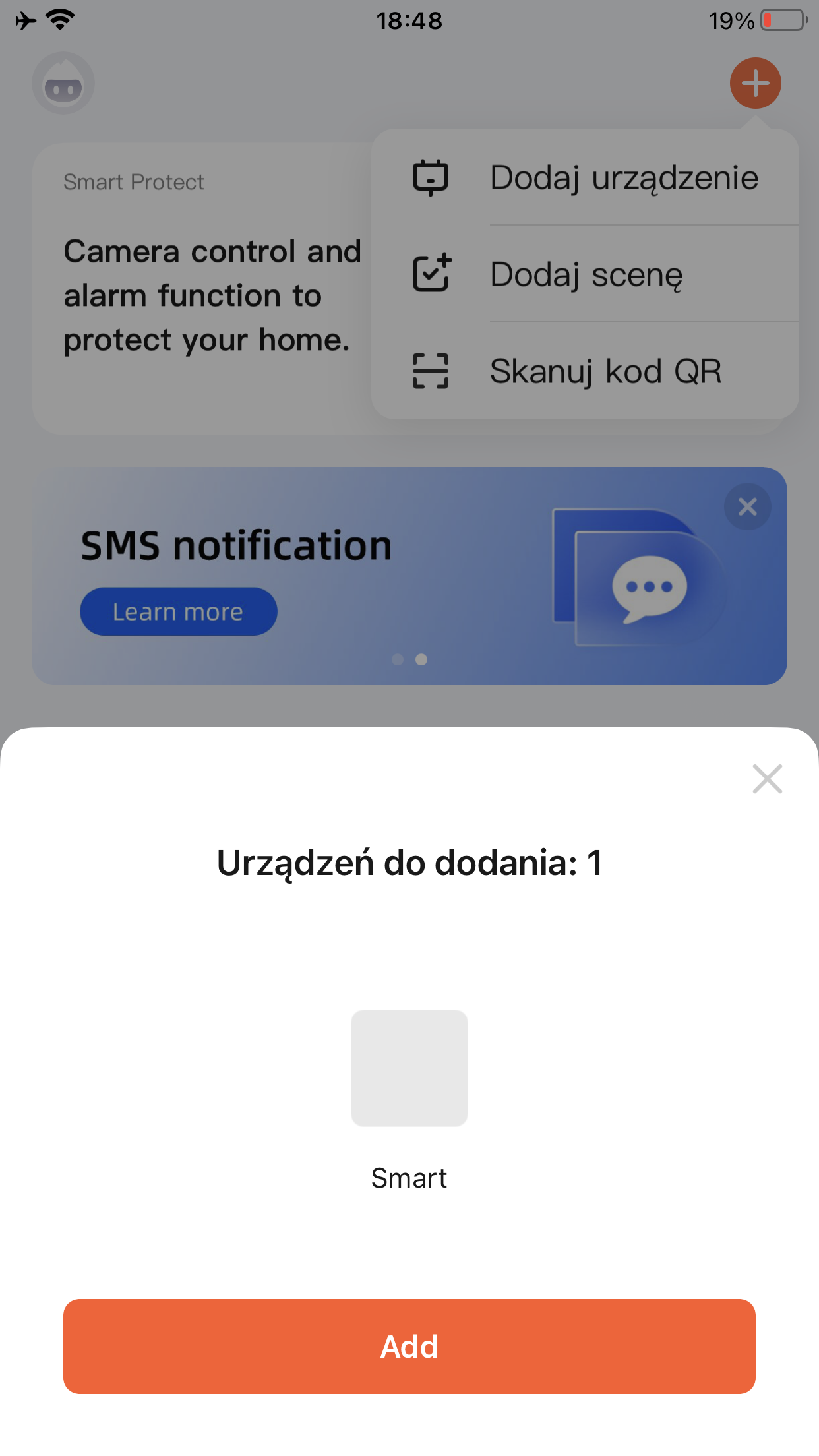

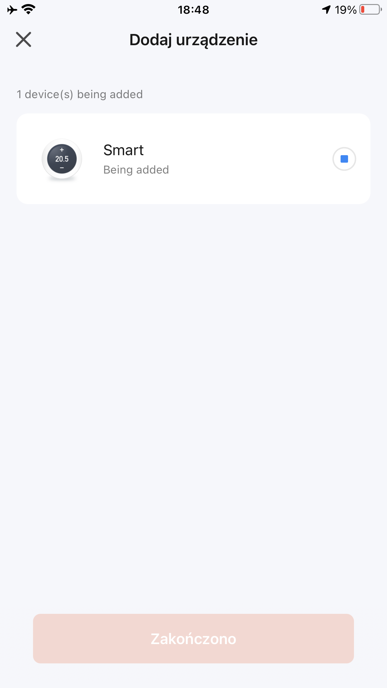

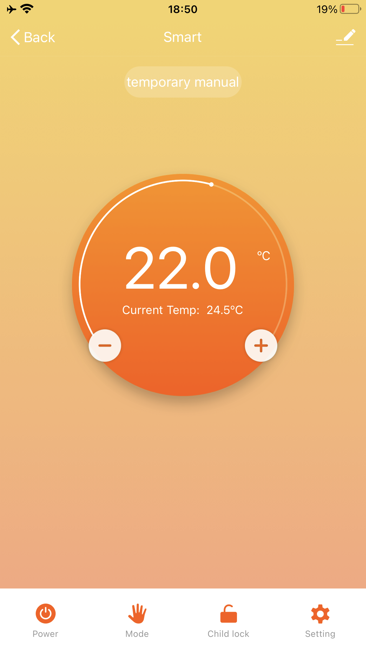

    Tuya app As a rule, I don't describe the Tuya app anymore, because I'm going to cut these devices off from the cloud and change their firmware anyway, but here the device was unusual enough, but I decided to do a short test with what the manufacturer offered us.
    We put the device into a pairing state and gave the location of our WiFi, all without problems, details in the instructions:
    Screen of an app for adding devices with smart control options App screen adding a thermostat named Smart App screen showing successful addition of a Smart device.

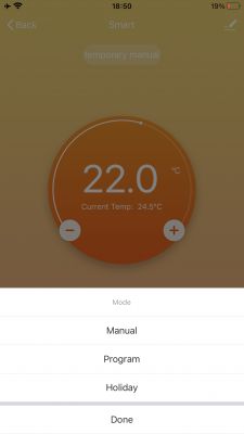

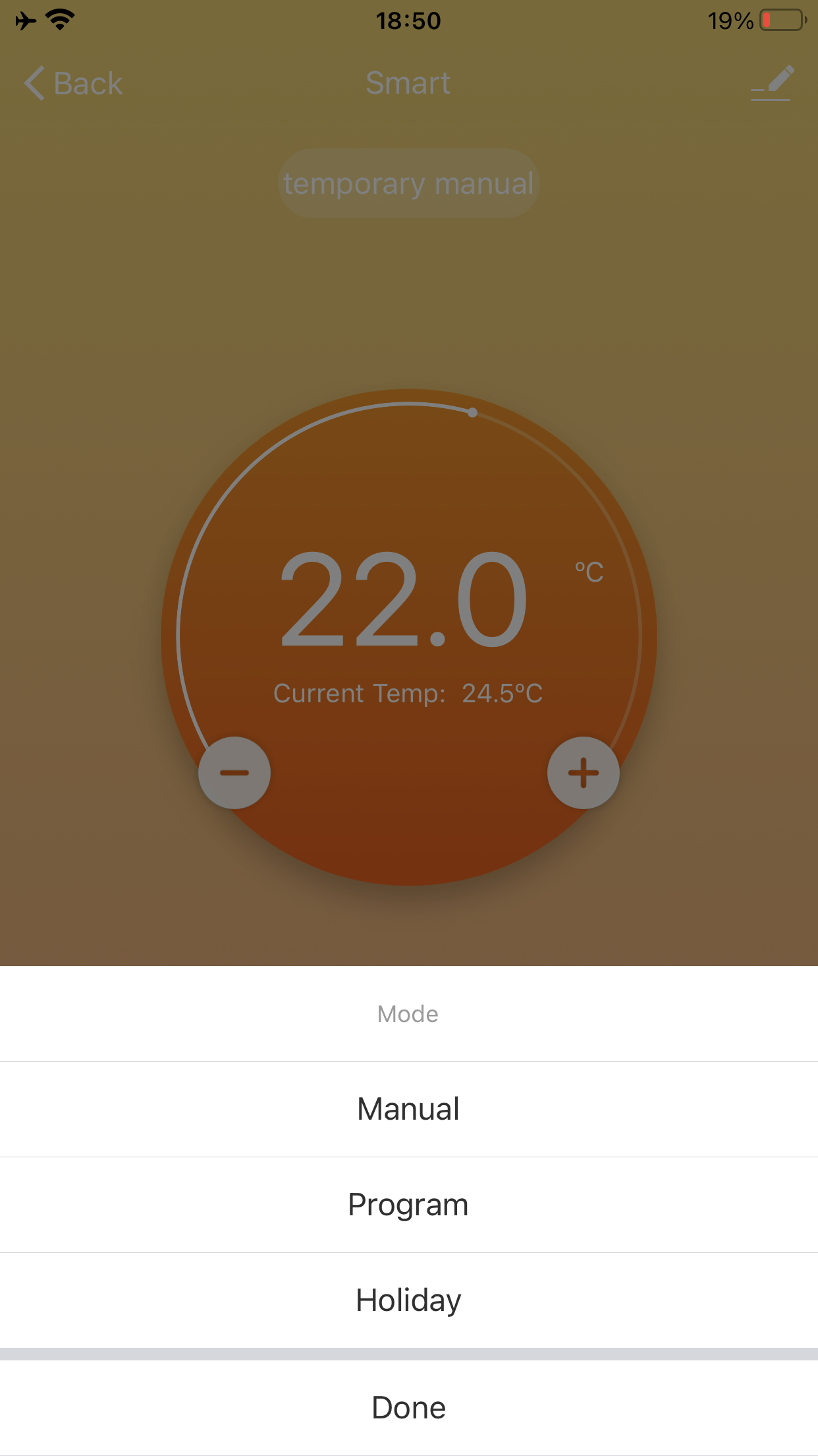

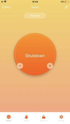

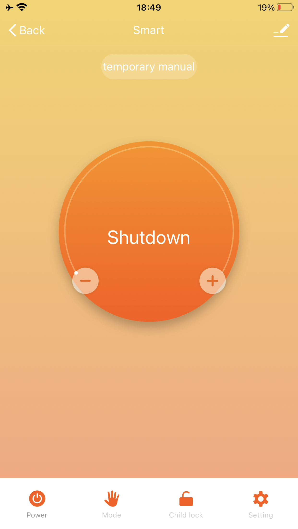

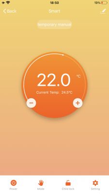

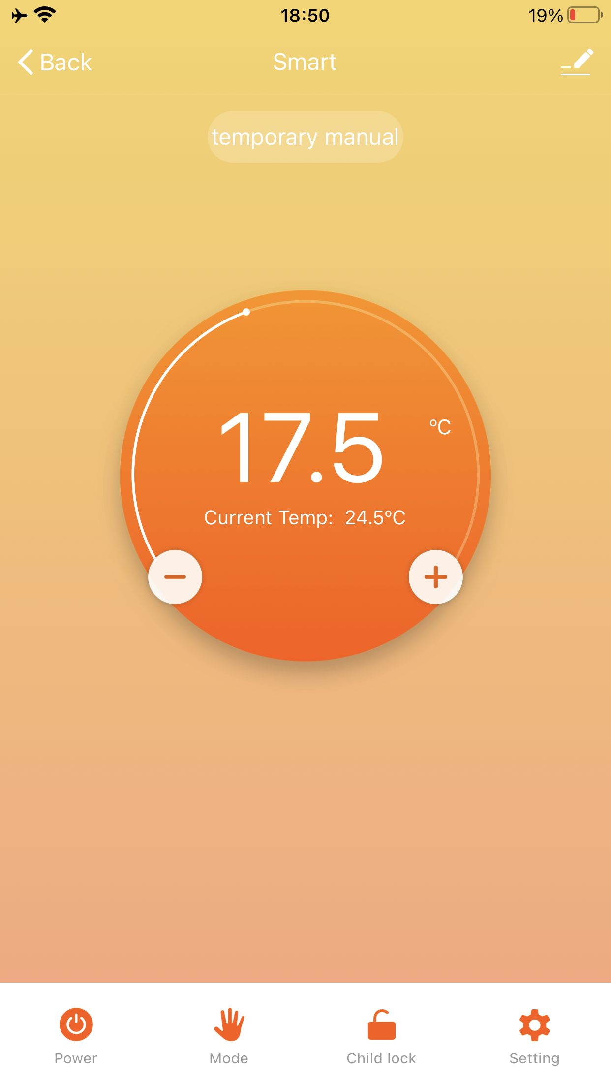

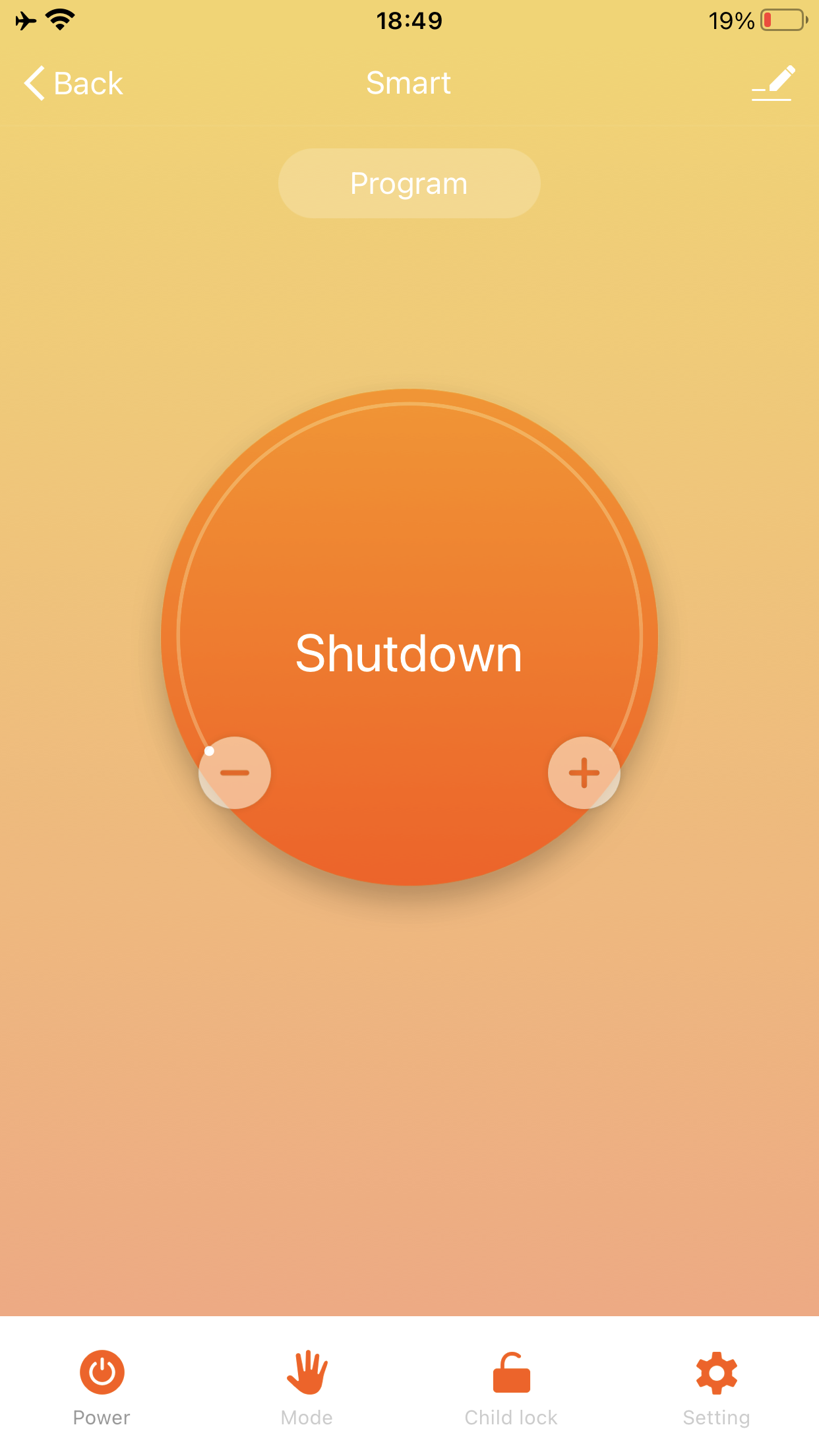

    The main panel of the device allows us to view the current temperature (here from the built-in sensor), the one set, and its operating status:
    Thermostat app screen showing energy management features. HY609-WE thermostat app interface in manual mode Smartphone app screen showing thermostat settings. Mobile app interface of a room thermostat displaying current temperature and settings. You can select one of three operating modes, it was already mentioned in the manual:
    - automatic (according to the schedules we set)
    - manual
    - holiday (holiday, thermostat completely off)
    Screen of a room thermostat app with temperature set to 22.0°C and current temperature at 24.5°C.

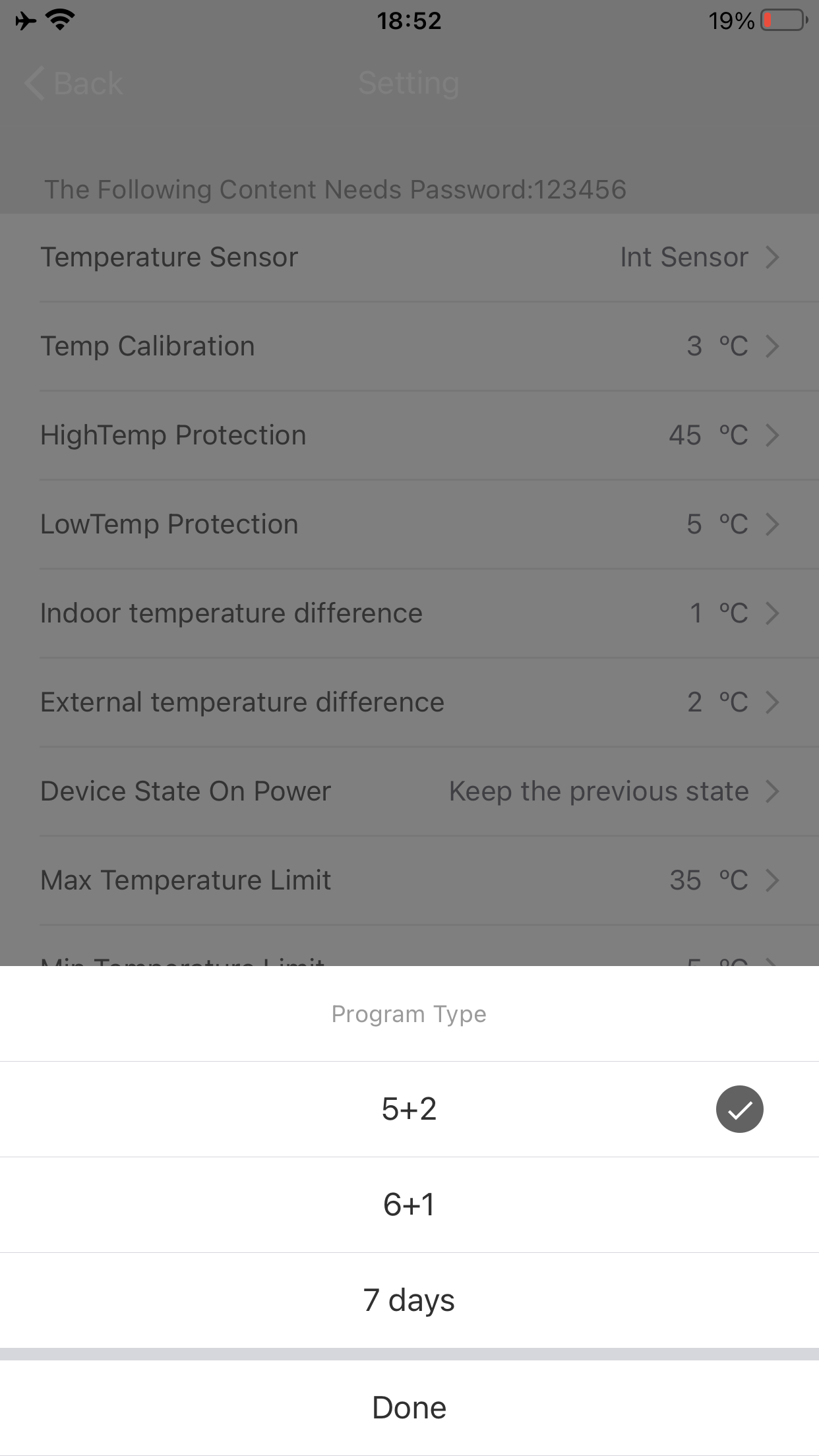

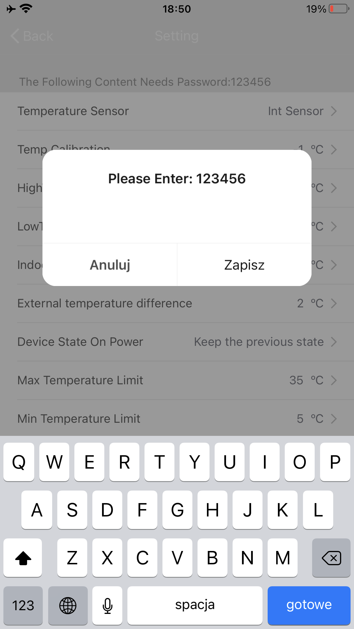

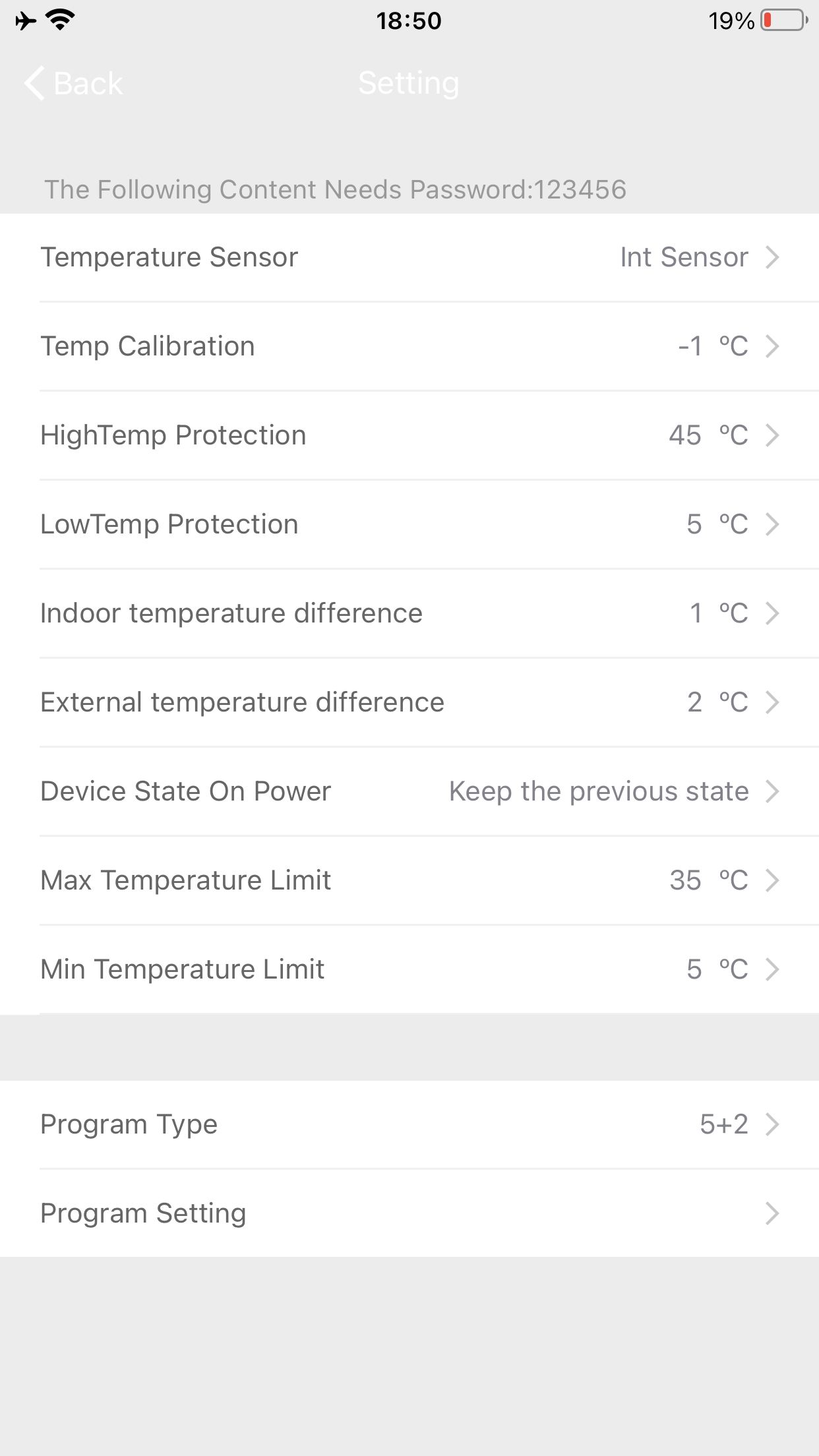

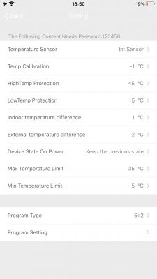

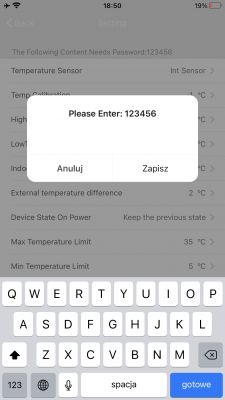

    It is in the settings that it gets more complicated:
    Screenshot of room thermostat KHY609 settings.

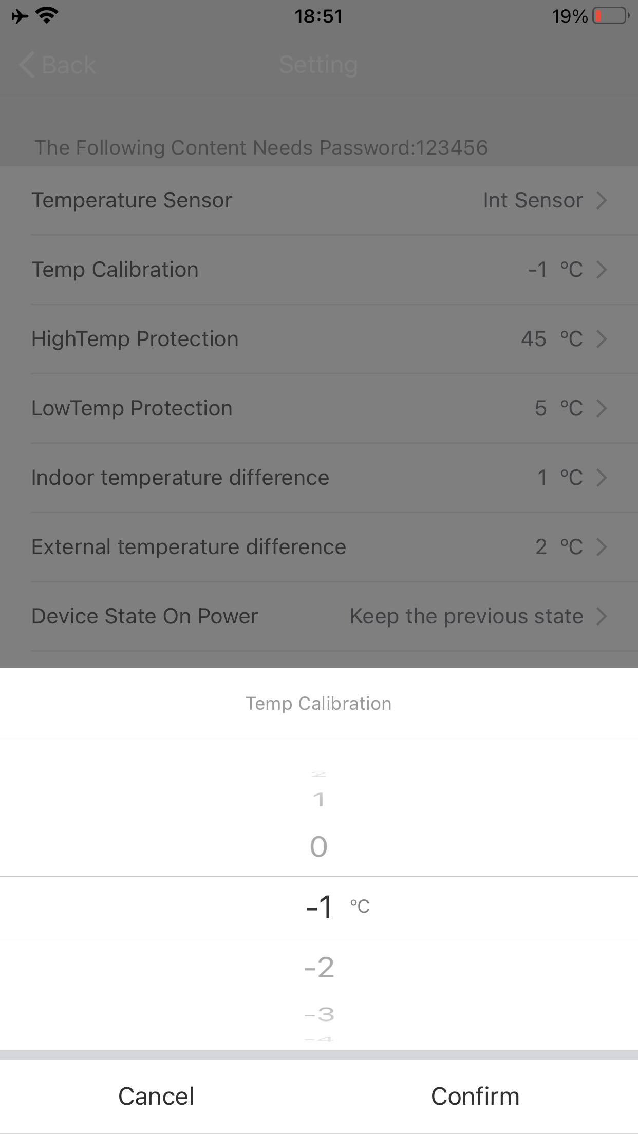

    There operations must be approved with this password, which was also given by the seller. With each change you have to enter the password. It's very inconvenient...
    Device screen prompting for password entry
    This is, for example, the temperature calibration:
    Thermostat settings screen with temperature calibration.

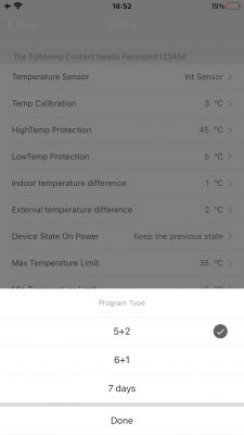

    Yes the program selection (these 5+2, 6+1, 7 days, etc. refers to the days of the week, as someone works, for example. on weekdays, then you can program the thermostat differently for them):
    HY609-WE thermostat app settings screen with program type options.

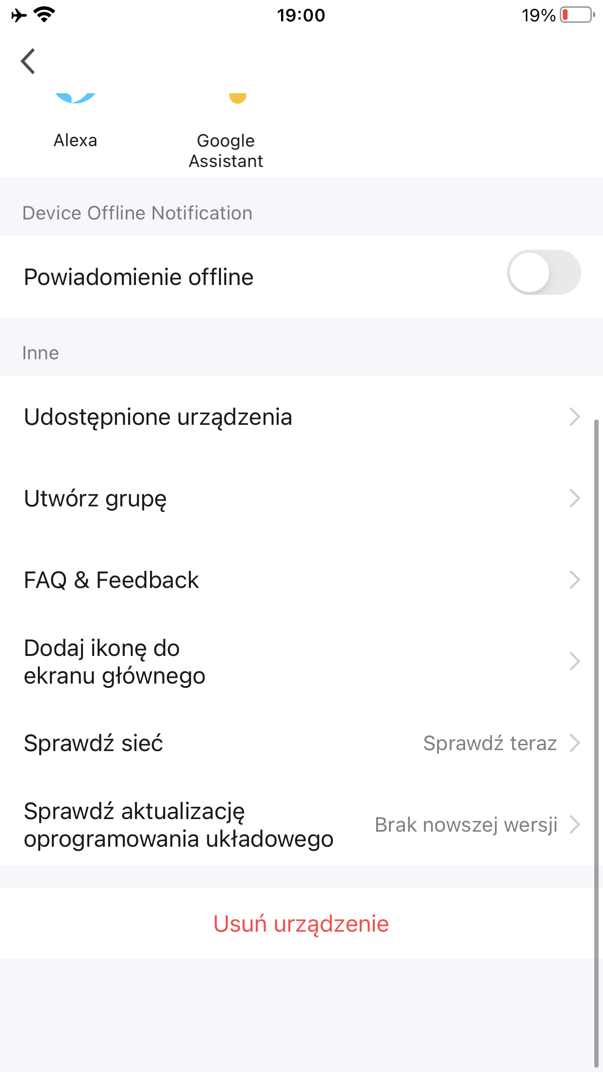

    Further settings - there are even notifications that the device becomes offline:
    Screenshot from the Tuya app for managing the HY609-WE thermostat

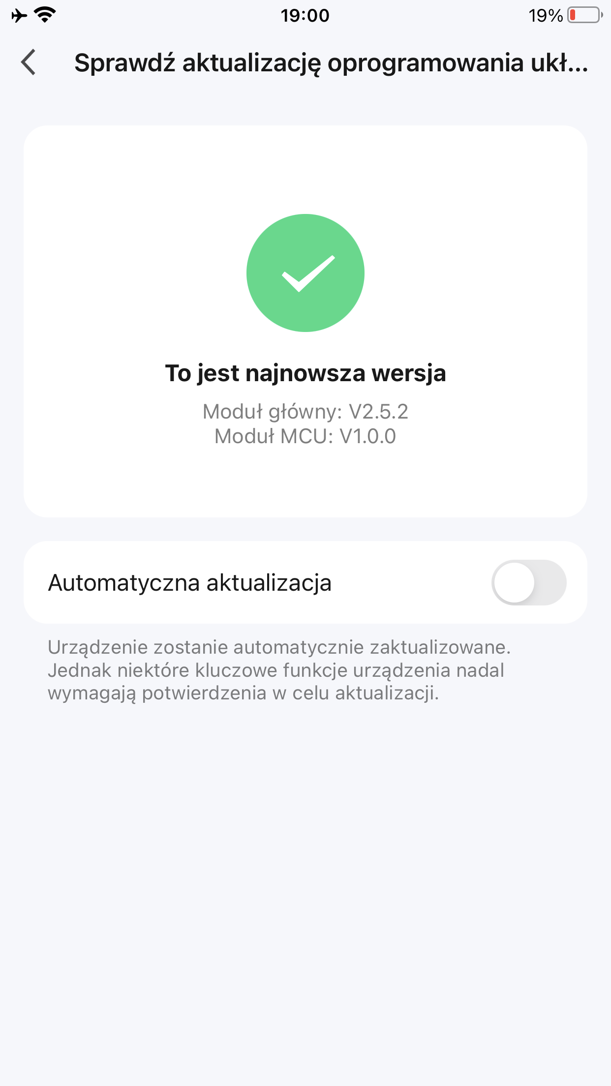

    Firmware versions, which reveal the fact that there is a WiFi module and TuyaMCU inside separately:
    App screen showing thermostat firmware update status.

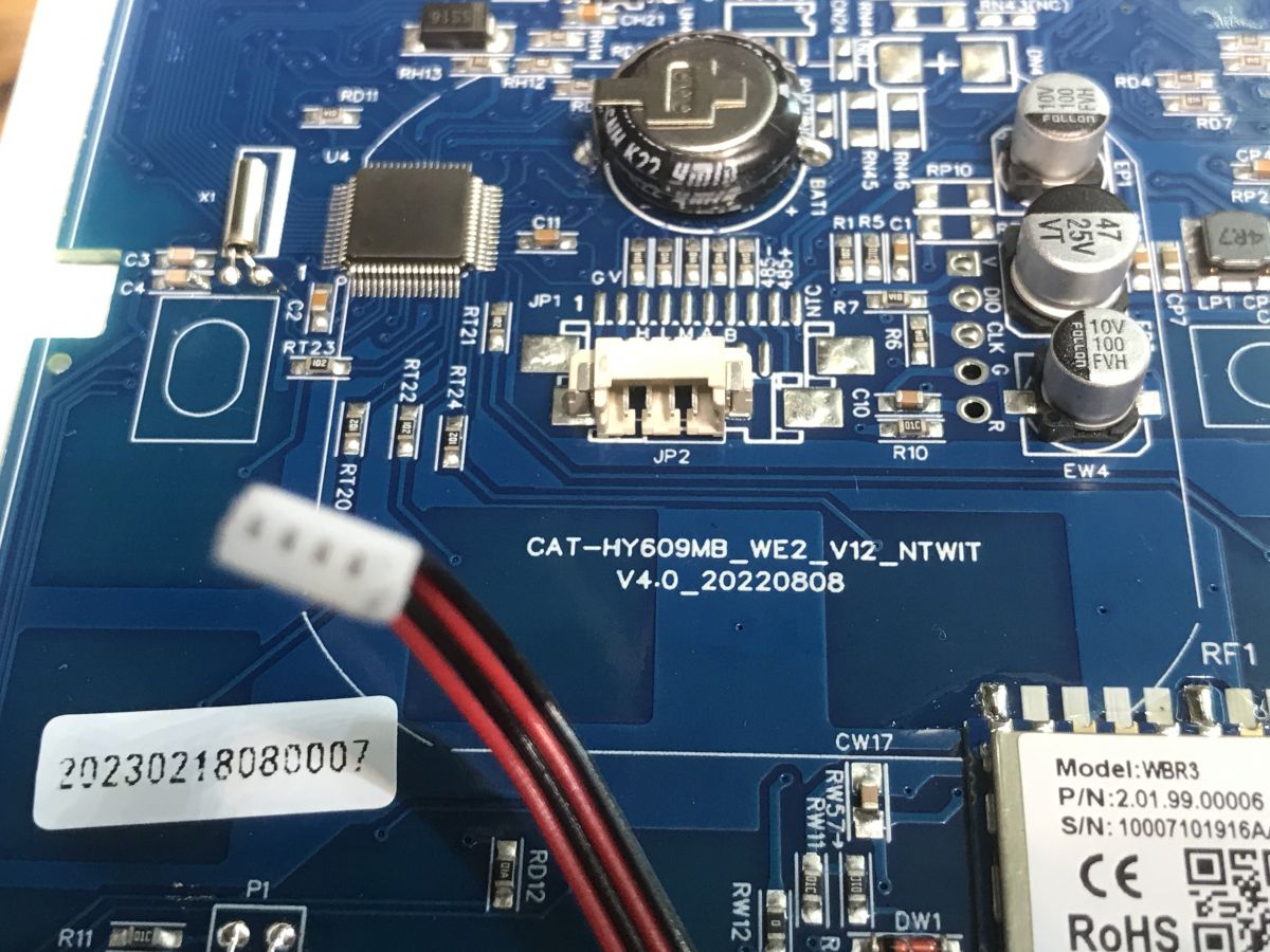

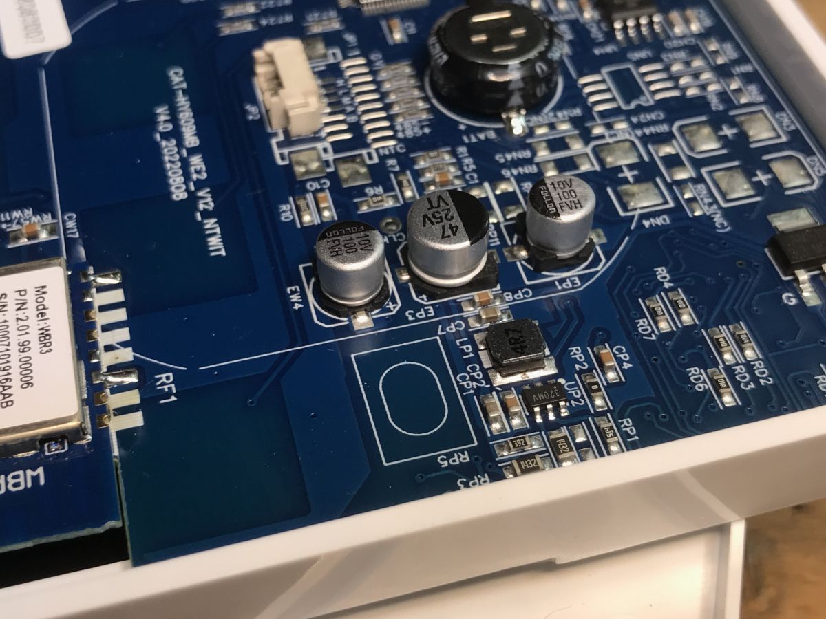

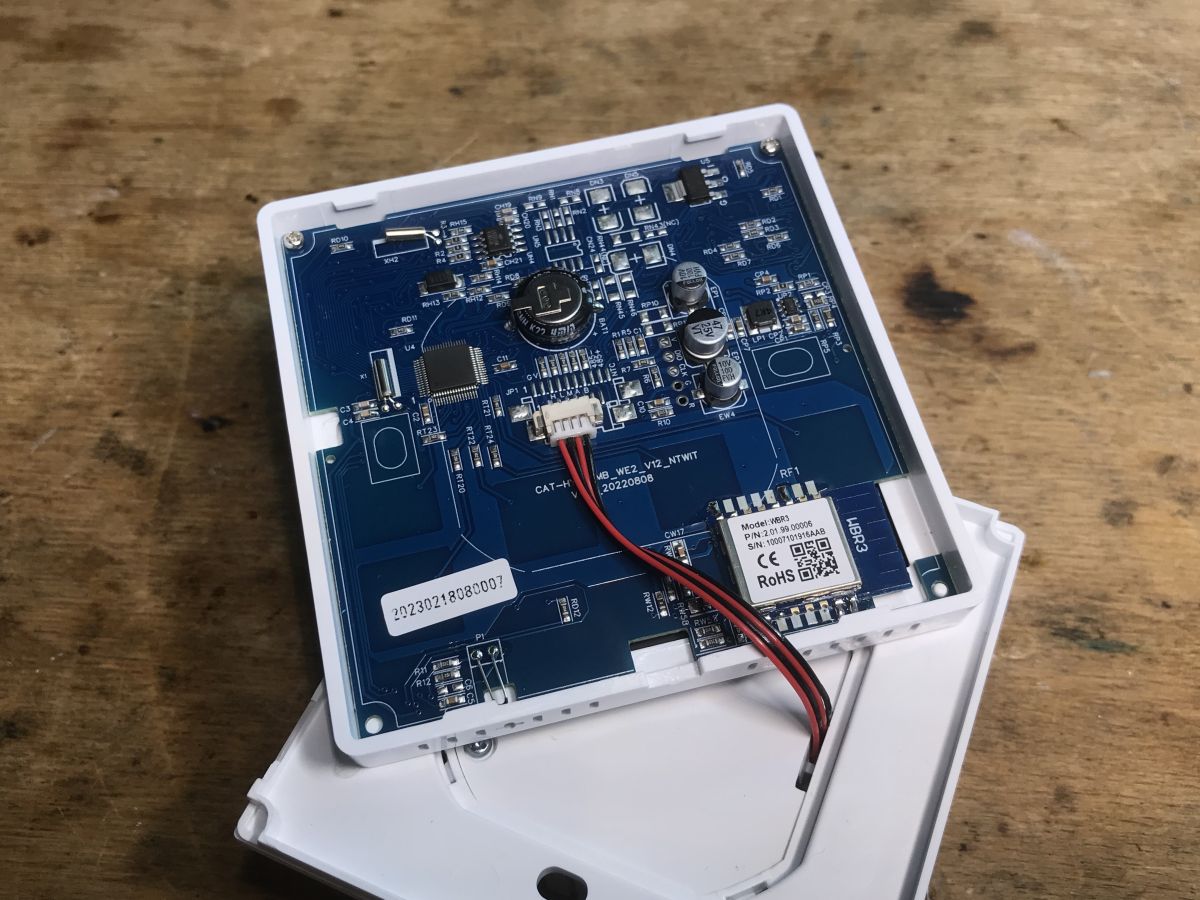

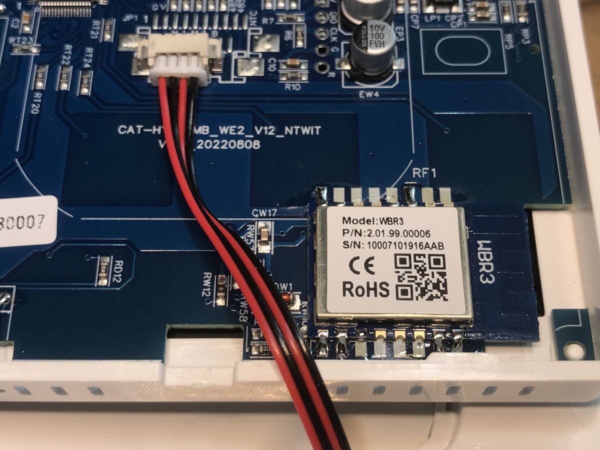

    Internal of the thermostat
    Let's remove the front cover to see how the thermostat is built.
    Interior of HY609-WE room thermostat with WiFi module.

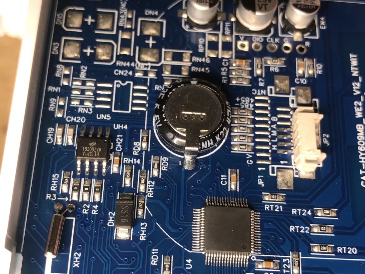

    Inside is the WBR3 module, my OpenBeken doesn't officially support it yet, but work is underway.
    WBR3 module with main board of HY609-WE thermostat

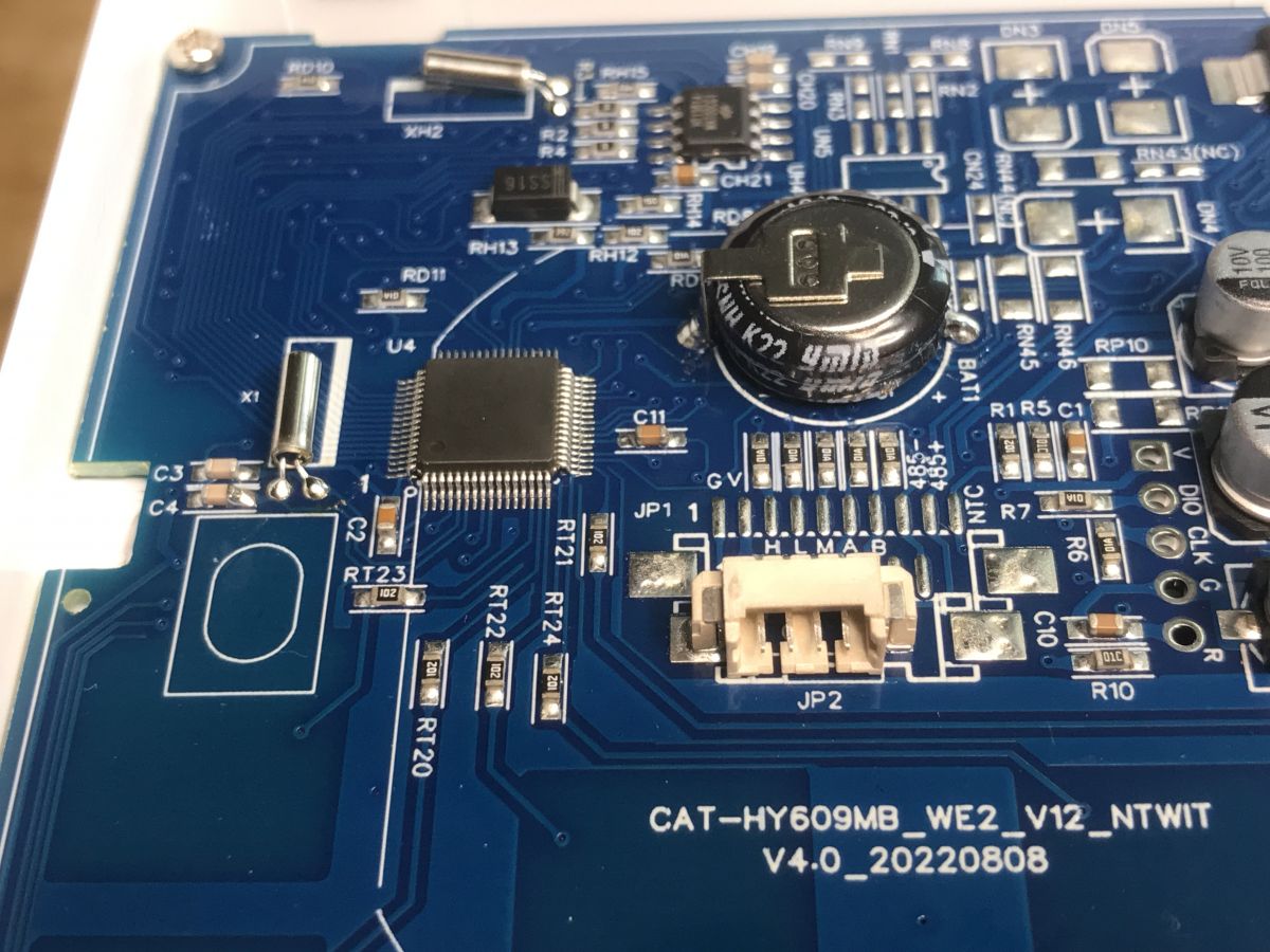

    PCB designation: CAT-HY609MB_WE2_V12_NTWIT V4.0_20220808
    2022 08 08 is the design date, I think, and production is (according to the sticker next to it) 2023 02 18:

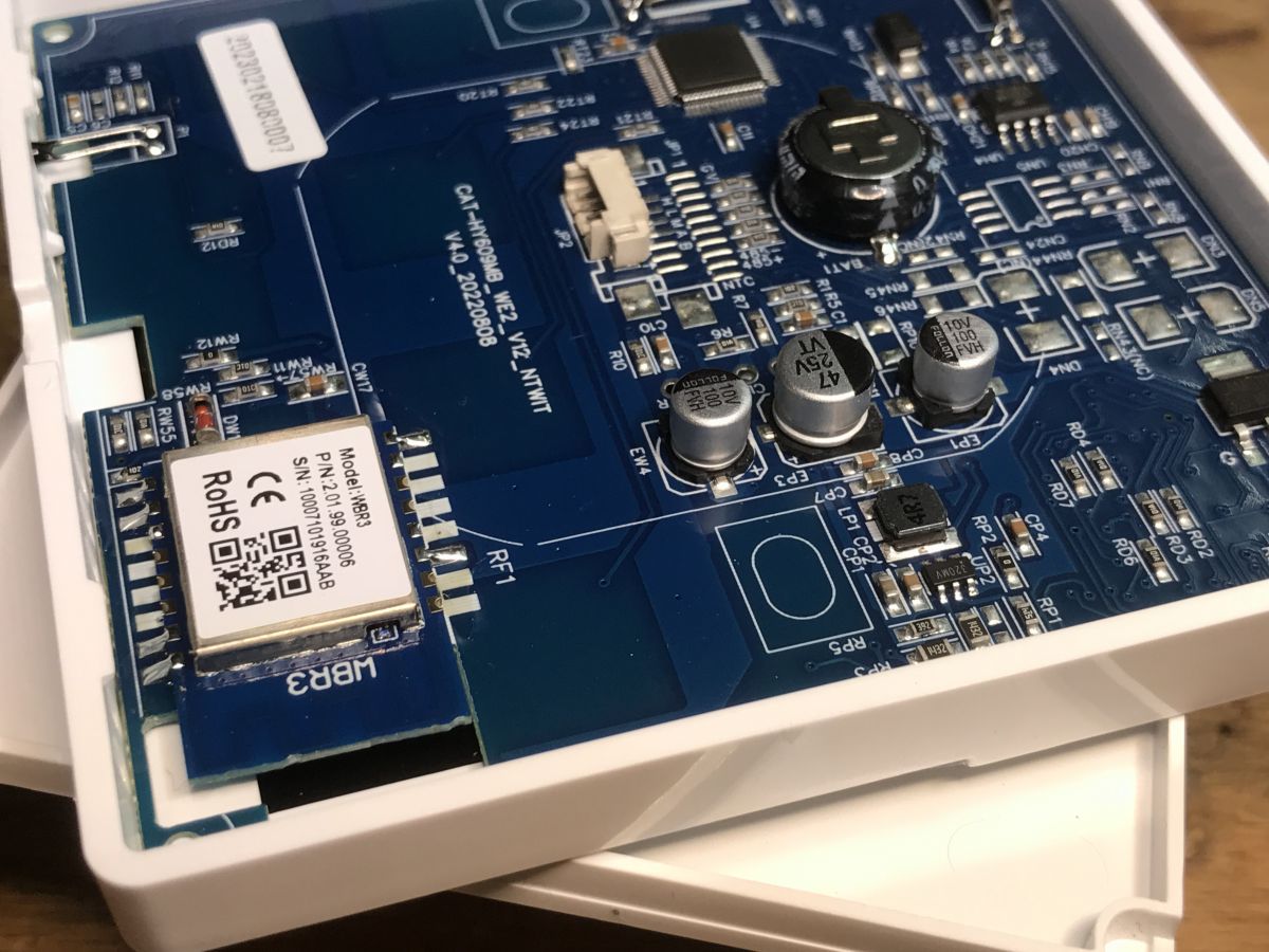

    PCB of the HY609-WE thermostat with visible components.

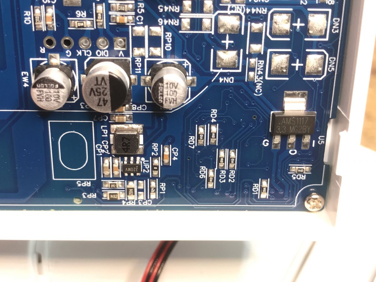

    In the 3.3V power block for the WiFi module and MCU, I see that there is both a step-down inverter and an AMS1117-3.3V:
    Interior of HY609-WE thermostat with WBR3 module. Close-up of the KHY609/HY609-WE thermostat PCB with visible electronic components. View of the PCB inside the model KHY609 thermostat with visible electronic components. I also see something that looks to me like a supercapacitor for time keeping:
    Close-up of the internal circuit board of the HY609 thermostat showing electronic components.

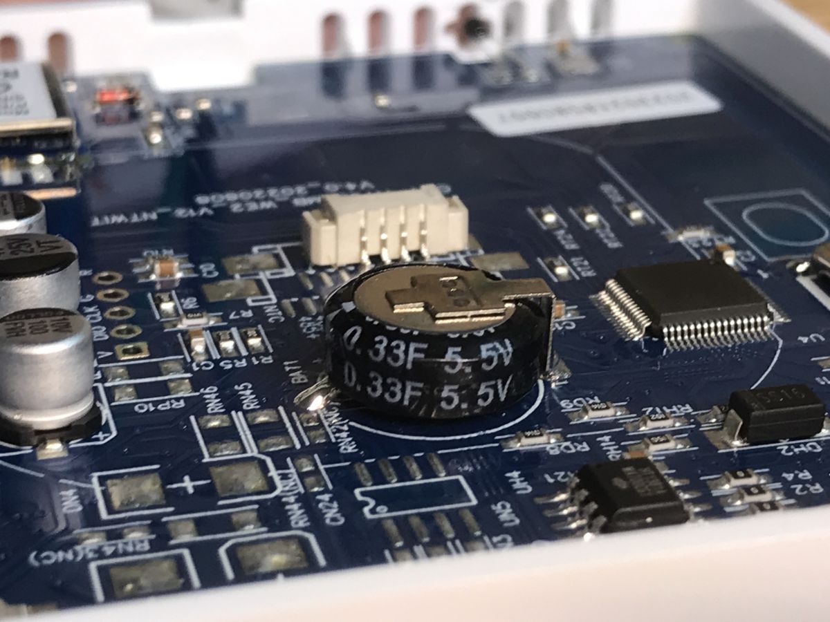

    Capacitance 0.33F, voltage 5.5V:
    Close-up of a circuit board with a 0.33F 5.5V supercapacitor.

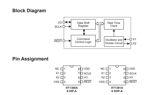

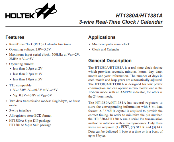

    Also visible HT1381A is the RTC clock:
    Screenshot of the technical specification for the Holtek HT1380A/HT1381A real-time clock chip.
    Block diagram and pin assignment for HT1380A/HT1381A chip. Block diagram and pin assignment for HT1380A/HT1381A chip.

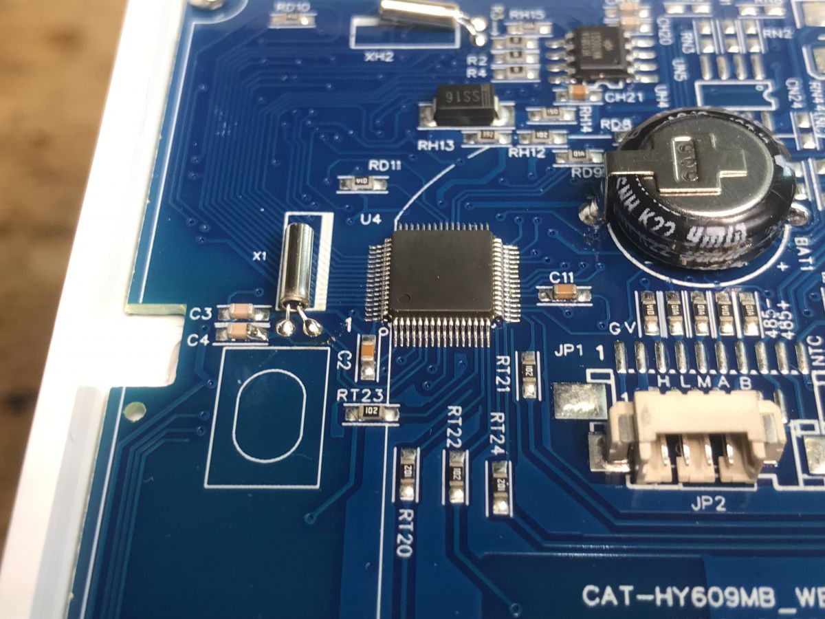

    Main MCU, second clock oscillator:
    Internal module of the HY609 room thermostat with electronic components Close-up of the PCB board of the HY609 thermostat model.

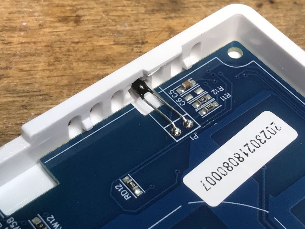

    Temperature sensor (the built-in one):
    Close-up of thermostat interior with electronic components on a PCB.

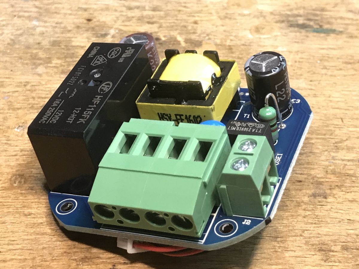

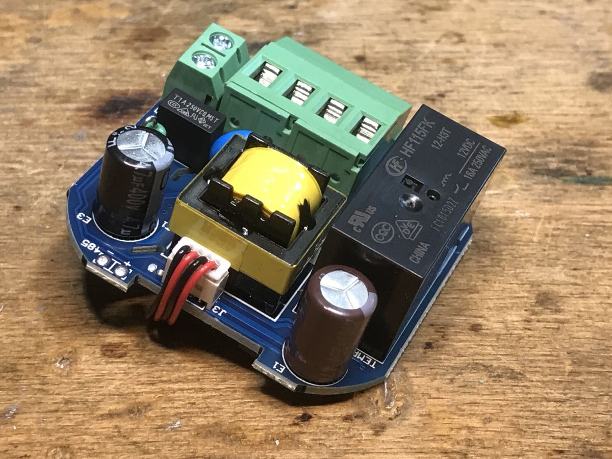

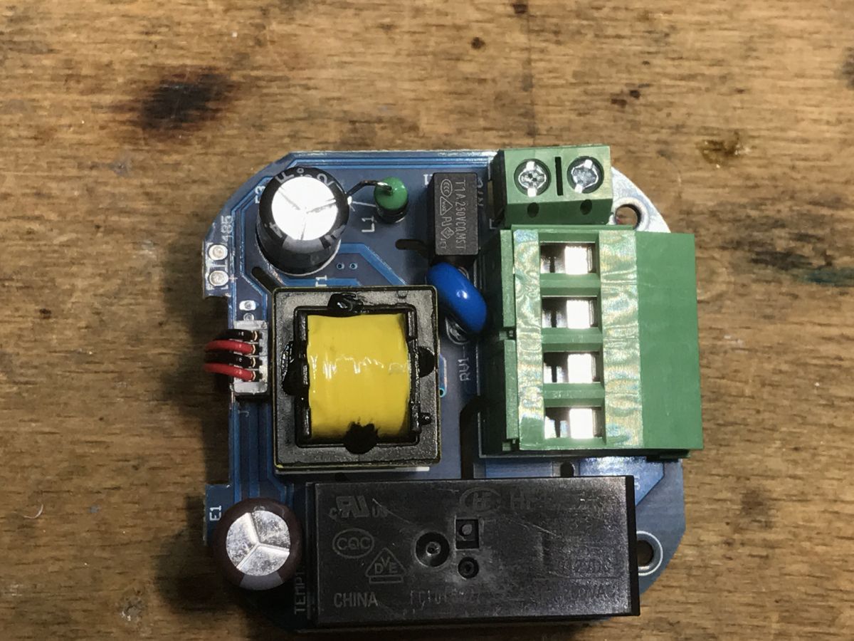

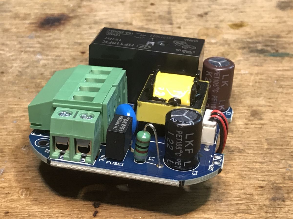

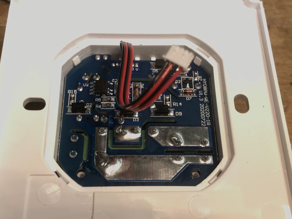

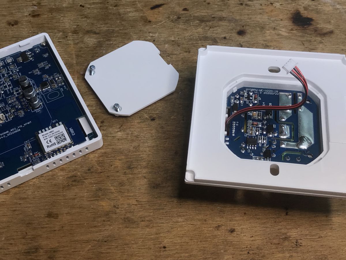

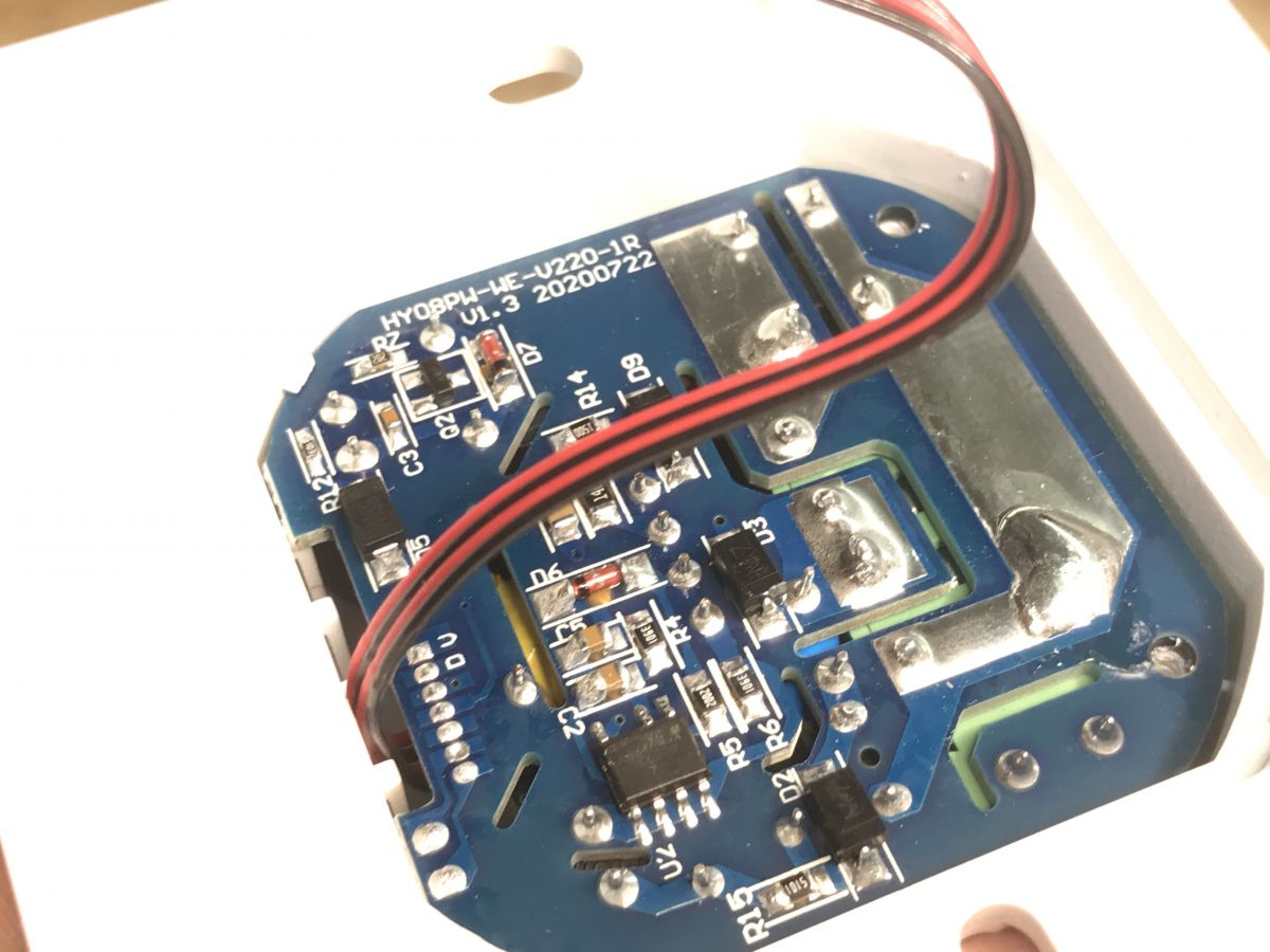

    In terms of firmware changes it's less important, but let's also look at the board from the power supply:
    Disassembled room thermostat with visible electronic components on a table.

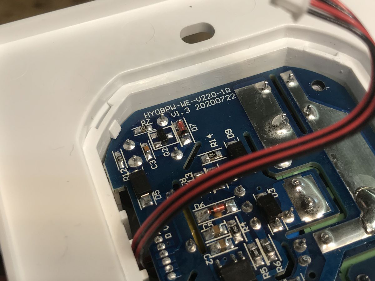

    Power supply PCB designation: HY08PW-WE-V220-1R 20200722 V1.3
    Interior of the HY609-WE thermostat with visible PCB and electronic components. Interior of the HY608-WE thermostat circuit board Close-up of the PCB model HY08PW-WE-V220-1R from the HY609 thermostat. This is rather standard. There is a visible fuse and varistor. I don't see any additional filters.
    Power board with electronic components on a wooden background Close-up of the internal mechanism of the KHY609 thermostat. Close-up of a circuit board module with electronic components. Internal component of the HY609-WE thermostat with electronic elements.

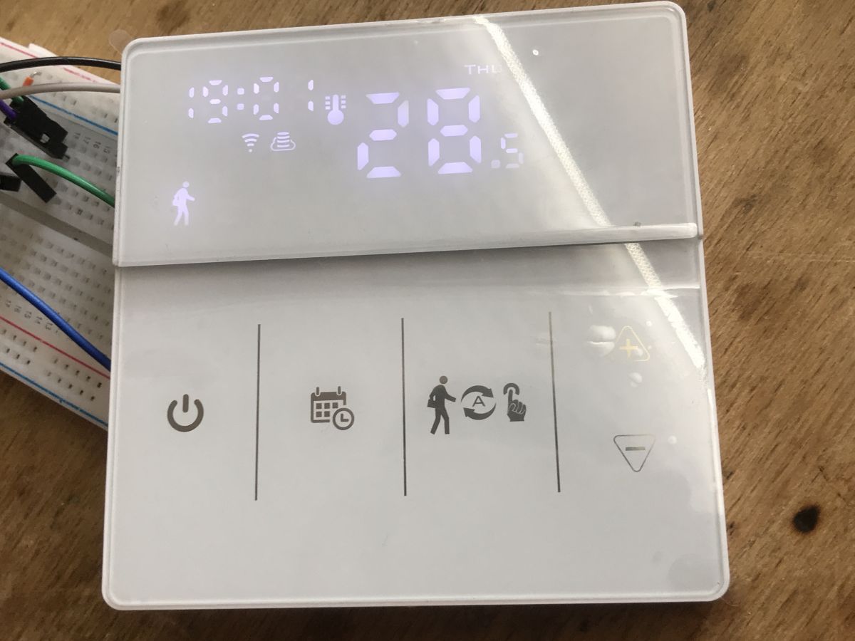

    Display readability The display is slightly more readable, than it might appear but there is still some room left for improvement here. Below are pics from me from the table, maybe it looks better on the wall:
    Room thermostat with LED screen and touch buttons. HY609-WE room thermostat with LED display. Room thermostat with LED screen and touch buttons.

    On the main menu - setting 30.5 temp:
    Received packet:
    55 AA	03	07		00 08	02 02 00 04 00000131 		4B
    HEADER	VER=03	State		LEN	fnId=2 Val V=305	CHK
    Received packet:
    55 AA	03	07		00 05	04 04 00 01 03 		1A
    HEADER	VER=03	State		LEN	fnId=4 Enum V=3	CHK
    After a while, the fire icon appears - the heating is turned on:
    Received packet:
    55 AA	03	07		00 05	66 01 00 01 01 		77
    HEADER	VER=03	State		LEN	fnId=102 Bool V=1	CHK
    Changes power on application (on off):
    Received packet:
    55 AA	03	07		00 05	01 01 00 01 00 		11
    HEADER	VER=03	State		LEN	fnId=1 Bool V=0	CHK
    Received packet:
    55 AA	03	07		00 05	01 01 00 01 01 		12
    HEADER	VER=03	State		LEN	fnId=1 Bool V=1	CHK
    Received packet:
    Received packet:
    Changing HighTem Protection to 44:
    Received packet:
    55 AA	03	07		00 08	70 02 00 04 0000002C 		B3
    HEADER	VER=03	State		LEN	fnId=112 Val V=44	CHK
    Changing LowTemp protection to 6:
    55 AA	03	07		00 08	71 02 00 04 00000006 		8E
    HEADER	VER=03	State		LEN	fnId=113 Val V=6	CHK
    Change device power on state to Keep previous state:
    55 AA	03	07		00 05	75 04 00 01 00 		88
    HEADER	VER=03	State		LEN	fnId=117 Enum V=0	CHK
    Change program type to 6+1:
    Received packet:
    55 AA	03	07		00 08	02 02 00 04 00000032 		4B
    HEADER	VER=03	State		LEN	fnId=2 Val V=50	CHK
    Received packet:
    55 AA	03	07		00 05	76 04 00 01 01 		8A
    HEADER	VER=03	State		LEN	fnId=118 Enum V=1	CHK
    Changing program type to. 5+2
    Received packet:
    Received packet:
    55 AA	03	07		00 05	76 04 00 01 00 		89
    HEADER	VER=03	State		LEN	fnId=118 Enum V=0	CHK
    Changing program type to 7:
    Received packet:
    Received packet:
    55 AA	03	07		00 05	76 04 00 01 02 		8B
    HEADER	VER=03	State		LEN	fnId=118 Enum V=2	CHK
    Changing indoor temperature difference to 1.5:
    Received packet:
    55 AA	03	07		00 08	6E 02 00 04 0000000F 		94
    HEADER	VER=03	State		LEN	fnId=110 Val V=15	CHK
    Changing mode to manual:
    55 AA	03	07		00 08	02 02 00 04 000000FA 		13
    HEADER	VER=03	State		LEN	fnId=2 Val V=250	CHK
    Received packet:
    55 AA	03	07		00 05	04 04 00 01 00 		17
    HEADER	VER=03	State		LEN	fnId=4 Enum V=0	CHK
    Changing mode to Program:
    Received packet:
    55 AA	03	07		00 08	02 02 00 04 00000096 		AF
    HEADER	VER=03	State		LEN	fnId=2 Val V=150	CHK
    Received packet:
    55 AA	03	07		00 05	04 04 00 01 01 		18
    HEADER	VER=03	State		LEN	fnId=4 Enum V=1	CHK
    Changing mode to Holiday:
    Received packet:
    Received packet:
    55 AA	03	07		00 05	04 04 00 01 02 		19
    HEADER	VER=03	State		LEN	fnId=4 Enum V=2	CHK
    Based on this, you can determine what dpID any variable has and what format it is stored in (e.g. temperature is stored as an integer which has to be multiplied by 0.1 to get the result, i.e. for example 255 is 25.5°C.

    A very interesting product, although I didn't like a few things. Those typing the password with each configuration change is not convenient. The display could be more readable, a little lack of contrast for me, I think the color green or red would fit more. Well, and this device in such a form is connected to the cloud, only then will we deal with the potential change of the batch, although the ground for this I have already prepared by capturing TuyaMCU packages.
    Although, the manufacturer can be praised here for several things. The 0.55F 5.5V supercapacitor inside is certainly a plus, because in case of a power outage, the hour certainly won't get lost. It will also be interesting to see if this thermostat will remember its program when there is temporarily no internet access. Another plus could be the ability to connect an external sensor, which is also quite optional, as the built-in temperature sensor is also available. I also liked the fact that there are actually a bit of these options. Although this manual calibration is a nice addition.

  • The board uses a WBR3 WiFi module, an HT1381A RTC clock, and a 5.5 V, 0.33 F supercapacitor that helps preserve time during short power loss. [#20783020]
  • The main PCB marking is CAT-HY609MB_WE2_V12_NTWIT V4.0_20220808, and a nearby sticker suggests production on 2023-02-18. [#20783020]
  • The power section appears to include a step-down converter plus an AMS1117-3.3V regulator for the WiFi module and MCU. [#20783020]
