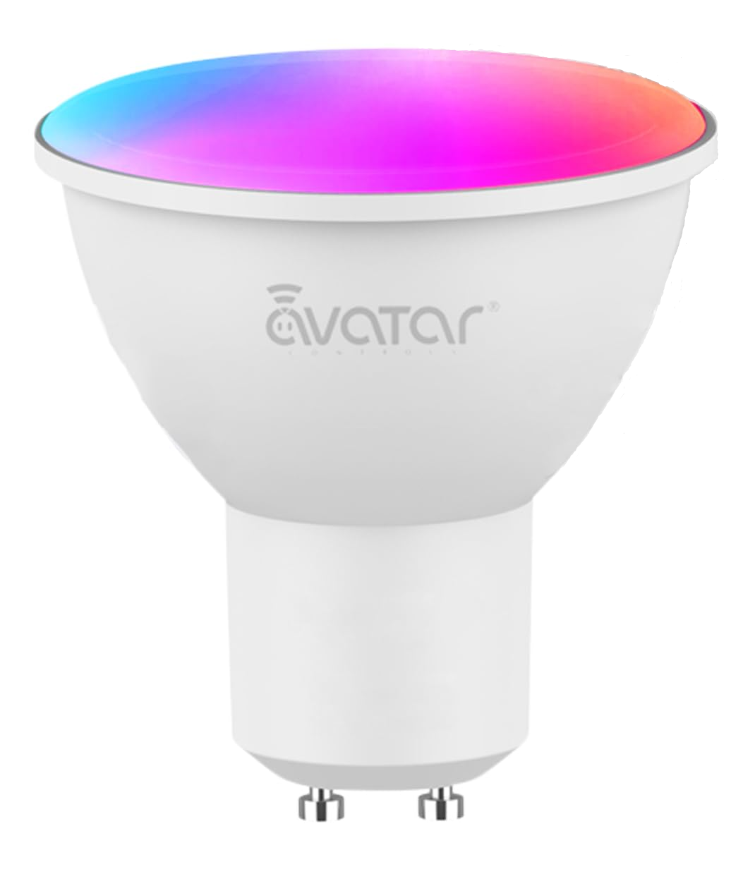

    The Smart Bulb GU10 5W (?) by ? has been available under the Avatar Controls brand name since around November 2020, for example at Amazon.com, Amazon.co.uk and Amazon.de. It is usually integrated into the smart home using the Avatar Controls app.
    White GU10 smart bulb with colored gradient top and Avatar Controls logo
    Manufacturer?
    Model nameSmart Bulb GU10 5W

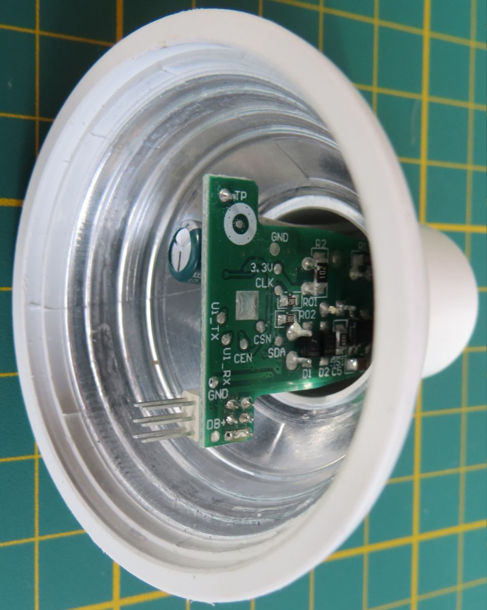

    A microcontroller BK7231N by Beken is used directly on the circuit board, which connects to the Tuya cloud via Wi-Fi and controlling five multicolored as well as each of six cool white and warm white LEDs. The dimmable RGBCW lamp (SM2235) can be operated through an app.
    Firmware flashing
    It is not possible to disconnect from the Tuya cloud using CloudCutter, as the pre-installed firmware version 1.5.32 with class oem_bk7231n_light_ty has already been patched against the known vulnerability.
    Therefore, OpenBeken must be flashed via the serial interface (GND, 3.3V, U1_TX, U1_RX).

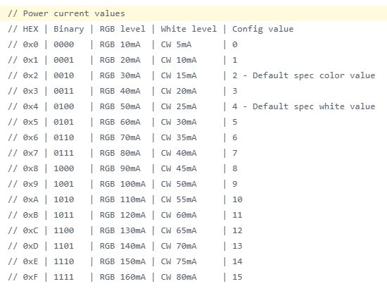

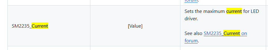

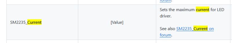

    I wonder if it's crashing now because of a heat issue? I doubt it's ultimate accuracy but have you noted what temperatures the GUI reports the chip to get up to?
    are you using powersave 1 command in startup or autoexec?
    you could also limit the SM2235 current because OBK default may be too high compared to factory
    https://github.com/openshwprojects/OpenBK7231T_App/blob/main/docs/commands-extended.md
    Table section with entry SM2235_Current and highlighted word “current”
    I don't see any/many examples of users limiting SM2235 current though and it seems the command only accepts one value

    I fixed SM2235_Current, default values are SM2235_Current 2 4, try lower maybe? SM2235_Current RGB CW.
    Give it a go and let me know if it works.

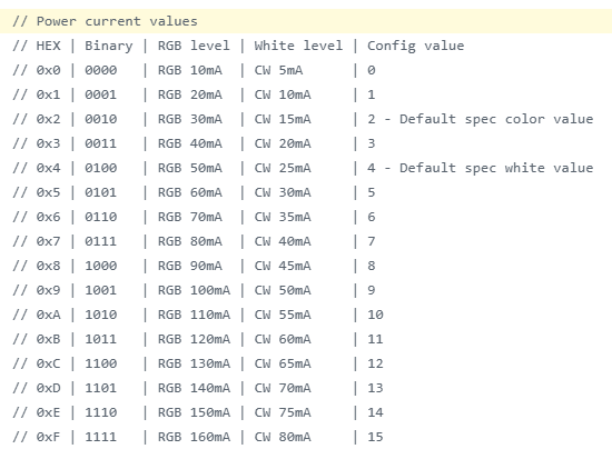

    I'm still a little unsure. I can find the values for SM2235_Current in this table, right?
    The original current was extracted at 1 mA for RGB and 2 mA for CW, which is significantly below the smallest possible adjustable values.
    I have tested the following so far:
    1. SM2235_Current 2 4 (default values: RGB 30 mA, CW 25 mA) → Average temperature 109 °C
    2. SM2235_Current 0 0 (lowest values: RGB 10 mA, CW 5 mA) → Average temperature 85 °C
    3. SM2235_Current 0 3; led_dimmerScale 0.1 (original values: RGB 0.1 * 10 mA, CW 0.1 * 20 mA) → Average temperature 68 °C
    I am aware that in the last attempt, only the average current is limited to the original values, not the maximum current, but I don't know how else to set them. Apart from that, the lamp is much too dark with this setting and crashes still occur in all three tests.

    The values are there:
    OpenBeken for Smart Bulb GU10 5W (?) by ? with BK7231N and SM2235
    SM2235_Current 2 4 is default one, as adnotated on table.
    Good point on extractor, probably those were supposed to be market not as current, but as raw indexes for SM2235_Current .
    Are you sure about led_dimmerScale 0.1 ? Isn't it already very dark? Maybe try led_dimmerScale 0.5

What bulb is this and what’s inside?
It’s an Avatar Controls GU10 5W smart bulb (ALS23L) using a BK7231N MCU and an SM2235 RGBCW LED driver. The board is marked 26X32SEG21172. It’s typically paired with the Avatar Controls app when stock. These identifiers help match templates and pin mappings in OpenBeken. [Elektroda, emarck, post #21755069]
Can I use CloudCutter on this GU10 to ditch Tuya?
No. The preinstalled Tuya firmware oem_bk7231n_light_ty v1.5.32 is patched, so CloudCutter will not work. Flash OpenBeken by UART instead using GND, 3.3V, U1_TX, and U1_RX pads on the PCB. This is the reliable route for unlocking local control. [Elektroda, emarck, post #21755069]
How do I map SM2235 channels correctly on this bulb?
Data and clock are on P24 (SM2235DAT) and P26 (SM2235CLK). Some extractions showed SM2235_Map 1 0 2 4 3, but warm/cool were swapped in practice. The user corrected mapping to SM2235_Map 1 0 2 3 4 to align CW/WW. Verify colors after setting. [Elektroda, emarck, post #21758706]

What SM2235 current values does OpenBeken use by default?
OpenBeken sets SM2235_Current 2 4 by default (order: RGB then CW). You can try lower values to reduce LED power and heat. Start conservatively and test stability and brightness before deploying outdoors. Report results so others can benefit from safe ranges. [Elektroda, p.kaczmarek2, post #21762083]

What happened when current and dimmer scaling were tested?
Three trials: SM2235_Current 2 4 → ~109 °C average; SM2235_Current 0 0 → ~85 °C average; SM2235_Current 0 3 with led_dimmerScale 0.1 → ~68 °C average. Brightness dropped at low scale, and crashes still appeared, so combine tuning with scripting changes and cooling. [Elektroda, emarck, post #21762652]

Does SM2235 current accept one or two parameters?
OpenBeken now supports two parameters in SM2235_Current: first for RGB, second for CW. Defaults are 2 4. Update to a release with this change and verify brightness and heat after adjustments. “Give it a go and let me know if it works.” [Elektroda, p.kaczmarek2, post #21762083]
