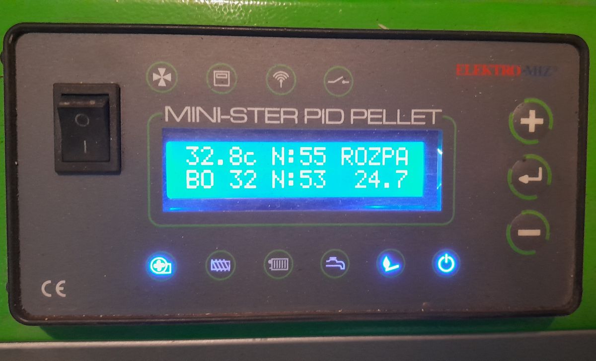

    Hello, I have a pellet cooker, with the Mini-ster PID Pellet controller.
    I have a question for my colleagues, is it possible to reprogram this controller so that it starts up after a power outage?
    I live in a place where there are frequent power outages and every 3 or even every 2 nights I am in a cold house, because a power outage of even 10 seconds causes that the cooker no longer starts up by itself and I have to go and do it manually.
    This is a hopeless idea and very inconvenient for me.
    Please advise.
    Mini-ster PID Pellet controller for a pellet stove with an LCD display.

    And isn't it simpler to put in a UPS to power this controller? Even the whole cooker, including feeder etc. doesn't draw much power.

    I was considering installing a UPS, but the heater draws 360 watts, the price of one with a battery is PLN800, I thought maybe something could be done with this controller.
    I guess you have to buy this UPS after all.
