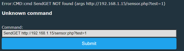

    Hi, I'm trying to define myself a GET that will be executed every 60 seconds with the following command:
    addRepeatingEvent 60 -1 SendGet http://192.168.1.15/sensor.php?test=1
    It has added itself correctly, but each call, gives an error in the logs.
    When I try to execute the GET itself I get:
    Error CMD: cmd SendGET not found with argument 192.168.1.15/sensor.php?test1.
    What am I doing wrong?

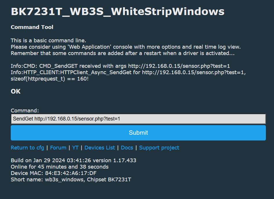

    Let's check. With me on OBK it works:
    Screenshot of the BK7231T_WB3S_WhiteStripWindows command tool interface.

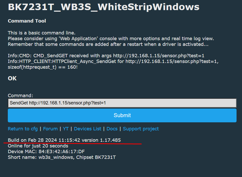

    Let's check in the latest version:
    User interface of Command Tool for BK7231T
    Unless you are trying to do it on another platform, for example on OpenBL602. From what I remember it was with BL602 that there was a serious problem with OTAs, as there simply wasn't enough space for them and some of the functions are not enabled there. They would have to be enabled first. The implementation is already available (because all platforms have LWIP), but you would have to include it in make and add #define

    Unless you are trying to do this on another platform, for example OpenBL602
    In point, BL602 :) one of the first sockets I purchased.
    It would need to be switched on first. The implementation is already available (as all platforms have LWIP), but it would need to be included in make and #define added
    Is this something I can do myself, or is it left waiting for a release?
