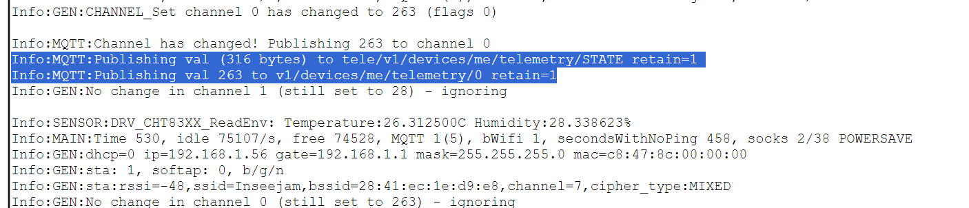

    hello,
    i want to connect openbeken device with thingsboard,
    i entered mqtt configuration and shown in thingsboard is the device is online but it didn't receive any data from openbeken device,
    anyone can help me?

    >>21243950 when I enter topic [ v1/devices/me/telemetry] in openbeken mqtt configuration the topic automatically changed to [v1/devices/me/telemetry/[Channel]/get] ,,
    the data can't reach thingsboard ,, is there any command that remove [/get] from automatic adding ?

    Ah, I see how this can be a problem! We didn't have a flag for that, but I've just created one for you. I didn't have time to test it yet, so maybe you can give it a try and tell me if it's working for you? Just wait for next release to build and do OTA. Then, you need to enable "never add get sufix" in flags.

    i still have problem that thingsboard didn't receive data ,, the only data i received is STATE ,, i don't know what is the problem ,, i tried to write esp32 code with arduino code to test if the thingsboard works ,, and it works with arduino code ,, Screenshot of MQTT logs showing data publishing.

    >>21244440 i think the problem is in how the openbeken publishing individual values and in the use of the topic v1/devices/me/telemetry. For ThingsBoard, all telemetry data should be sent as a JSON object to the single topic v1/devices/me/telemetry rather than individual topics for each value.
    To fix this, i think :
    - Publish all the values together as one JSON payload to the correct telemetry topic (v1/devices/me/telemetry).
    - Avoid appending additional parts like /voltage or /battery to the telemetry topic. Everything should be sent as a single message.
    can u help me with that ?

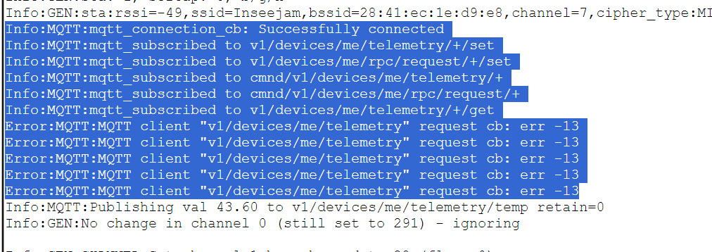

    Added after 3 [hours] 57 [minutes]:
    >>21244440 Screenshot of MQTT logs showing errors when publishing telemetry data. there are some error i don't know how to fix it
