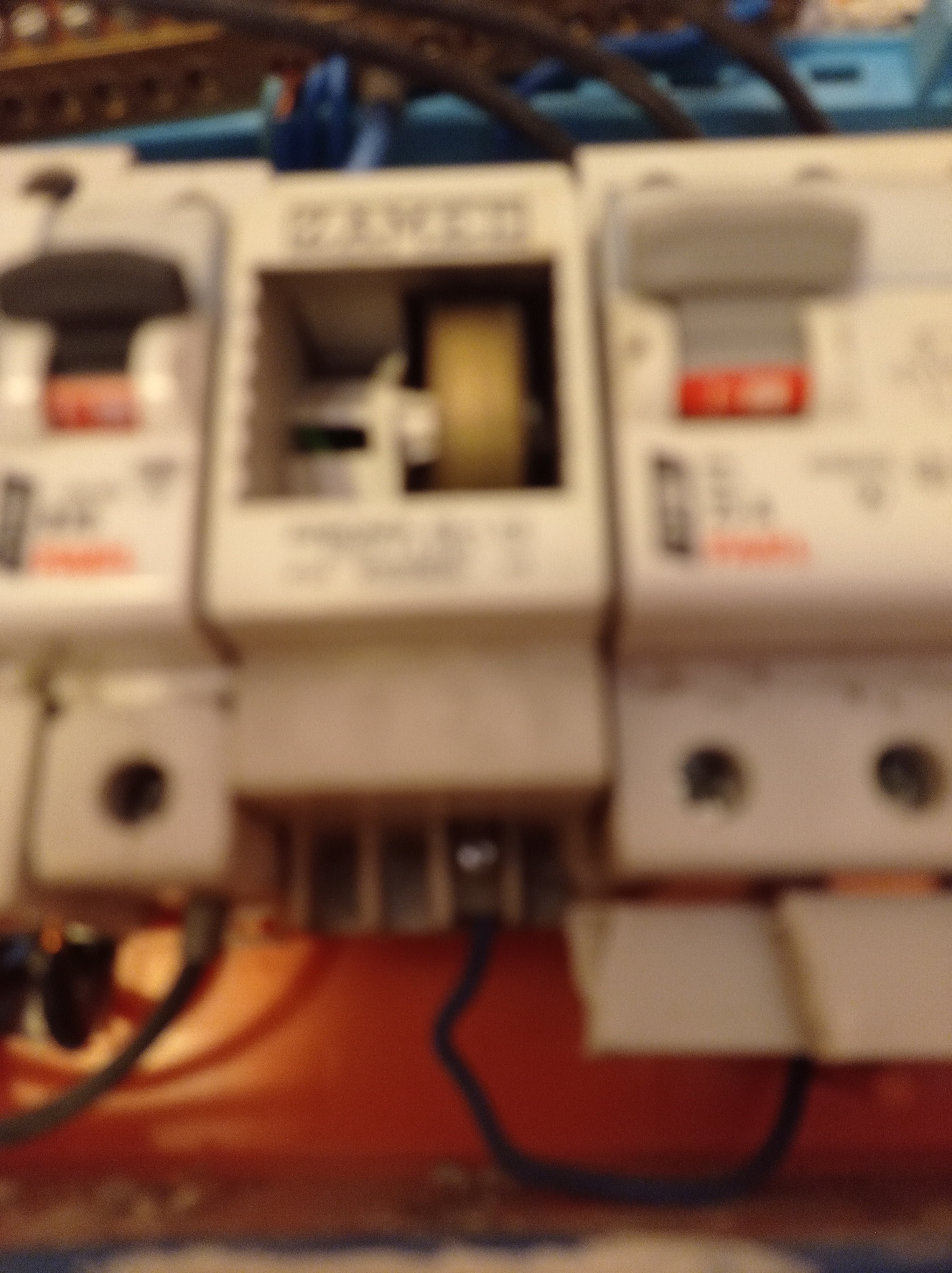

    The problem seems trivial but not really, namely how to dismantle the ZAMEL ED-1 call bell from the DIN rail?
    I have not been able to locate the release mechanism on it, such as in traditional fuses. Can anyone tell me how to go about it?
    The bell looks like the one on the attached picture.

    My bell is different (20 years old) - the wires come in from the bottom and top, and it has no visible catch release.
    In new ones, the wires enter from the top, and the catch locks are generally a different colour and clearly visible.
    Greetings

    Sometimes some units don't have retractable catches, just a sort of elastic rubber inside. Try pressing from the top while pulling the bottom forward. Alternatively, the other way round, i.e. pressing from the bottom upwards and pulling the top towards you.

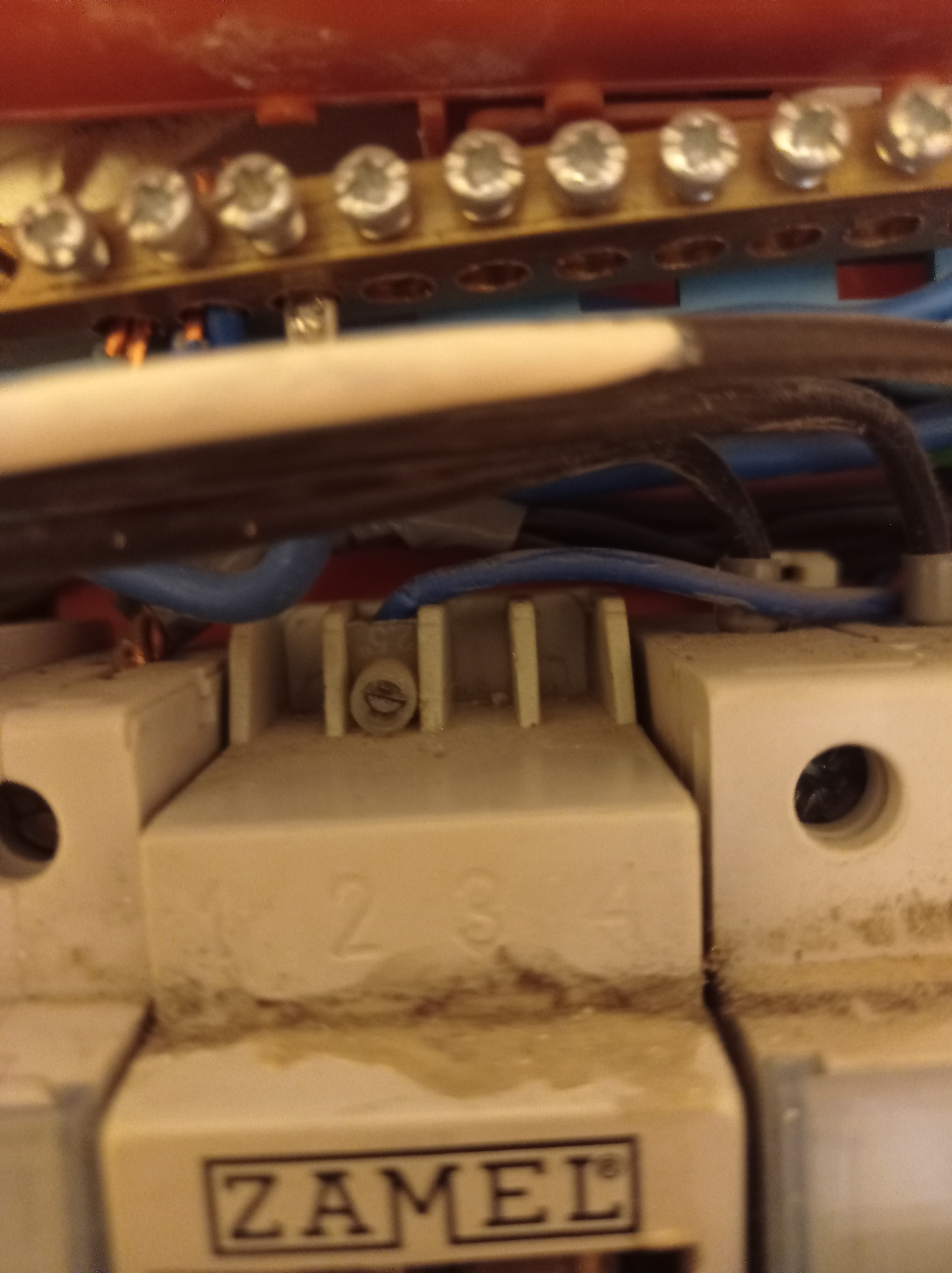

    Excuse me for the quality, but the top and bottom are identical.
    • How to remove the ZAMEL ED-1 bell from the DIN rail? IMG_20240314_135042.jpg (1.37 MB) You must be logged in to download this attachment.
    • How to remove the ZAMEL ED-1 bell from the DIN rail? IMG_20240314_135030.jpg (1.94 MB) You must be logged in to download this attachment.
