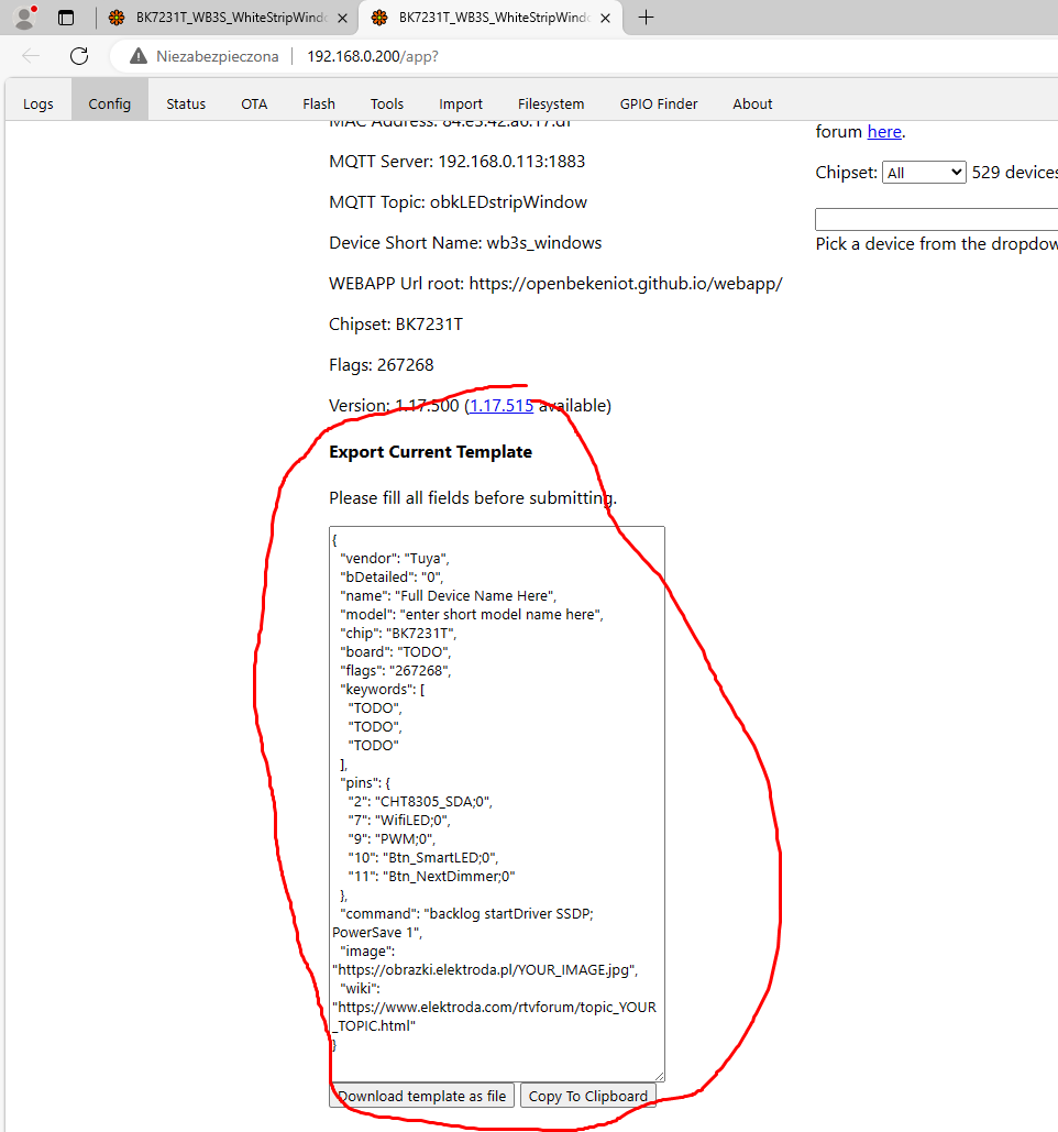

    1. Backup config - text format (for sharing with users) - just open Web App and copy template:
    Screenshot of a web application displaying the current configuration template.
    You can restore it in Import tab.

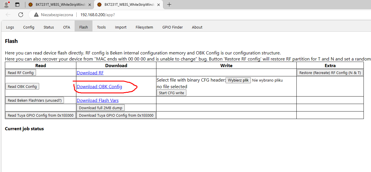

    2. Backup whole config partition - WARNING - this includes SSID and Password, be careful!
    Web page with options to download OBK configuration and other device flash settings.

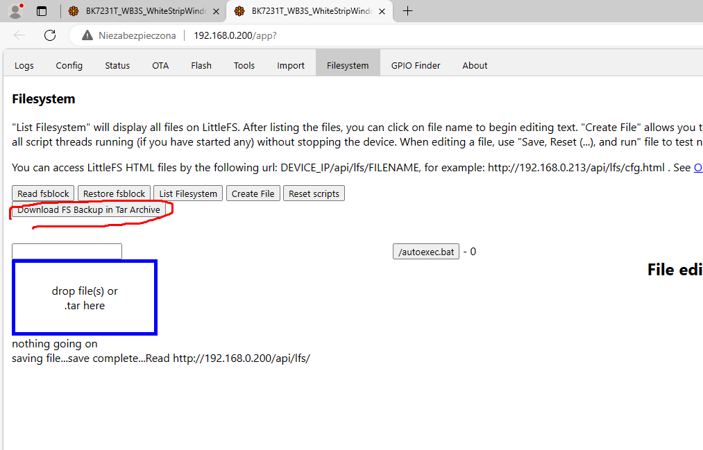

    3. Backup autoexec.bat - in LittleFS tab, either copy file or download archive of whole LittleFS
    Screenshot of the LittleFS web application with an option to download a backup in tar archive.

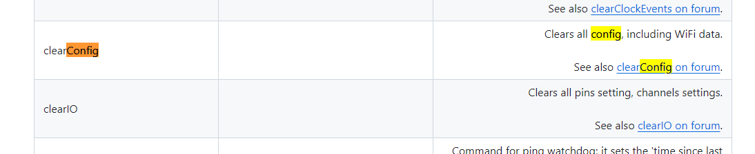

    4. Factory default procedure - just use the command, as said here:
    A snippet of a screenshot showing a command table, highlighting the clearConfig entry.
