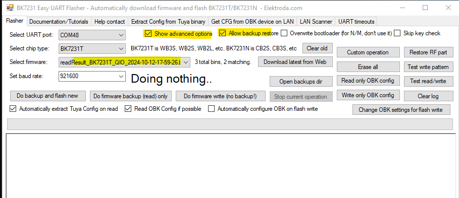

    I made a backup of firmware with BK7231Flasher before flashing with OpenBeken. Is it possible to restore the backup back to the device? I have checked the software but I do not find any way to do it.
    I need to do some serial sniffing on the original firmware to be able to get OpenBeken working on the device.
    /Daniel

    yes.
    select these options and provided your binary is in the backups folder and the file name starts "readResult_BK7231T_QIO..." still it should show in the drop-down
    Screenshot of the BK7231 Easy UART Flasher program with firmware selection menu.

    Ah, Great! Thank you!

    I tested and it work great!
