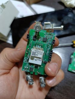

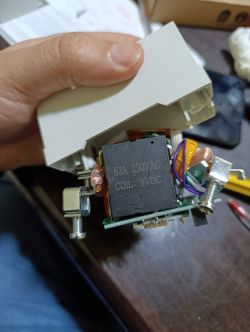

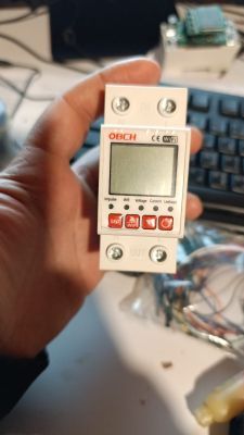

    i have this tuya device with bk7231n CBU
    already flash open beken frimware but ican set pin out and if i set channel from import after reboot i cant control untell set import script again !!

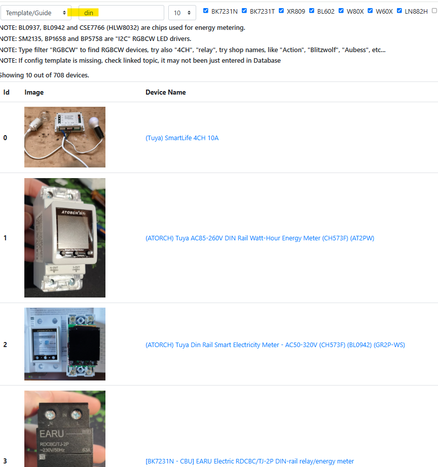

    you could probably find similar devices in the device list to see how they've been setup then just adapt for your specific device
    List of energy measurement devices with names and images, including energy meters and relays.
    eg https://www.elektroda.com/rtvforum/topic3959907.html
    autoexec examples https://github.com/openshwprojects/OpenBK7231T_App/blob/main/docs/autoexecExamples.md
