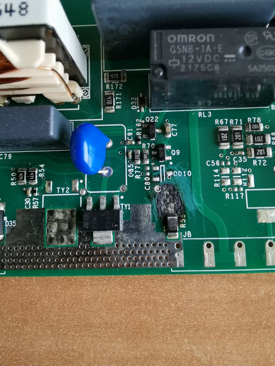

    Hi,
    My machine, a Zanussi ZDT21001FA, does all the washing process without heating the water.
    This is all the information from the machine:
    Typ: GHE623DA2
    PNC: 911 539 136 03
    PCB
    COMPUTIME CODE: ELED171
    ELECETRLOUX CODE: A00621404 A
    FW: P300R102
    BACK: ED17160703989

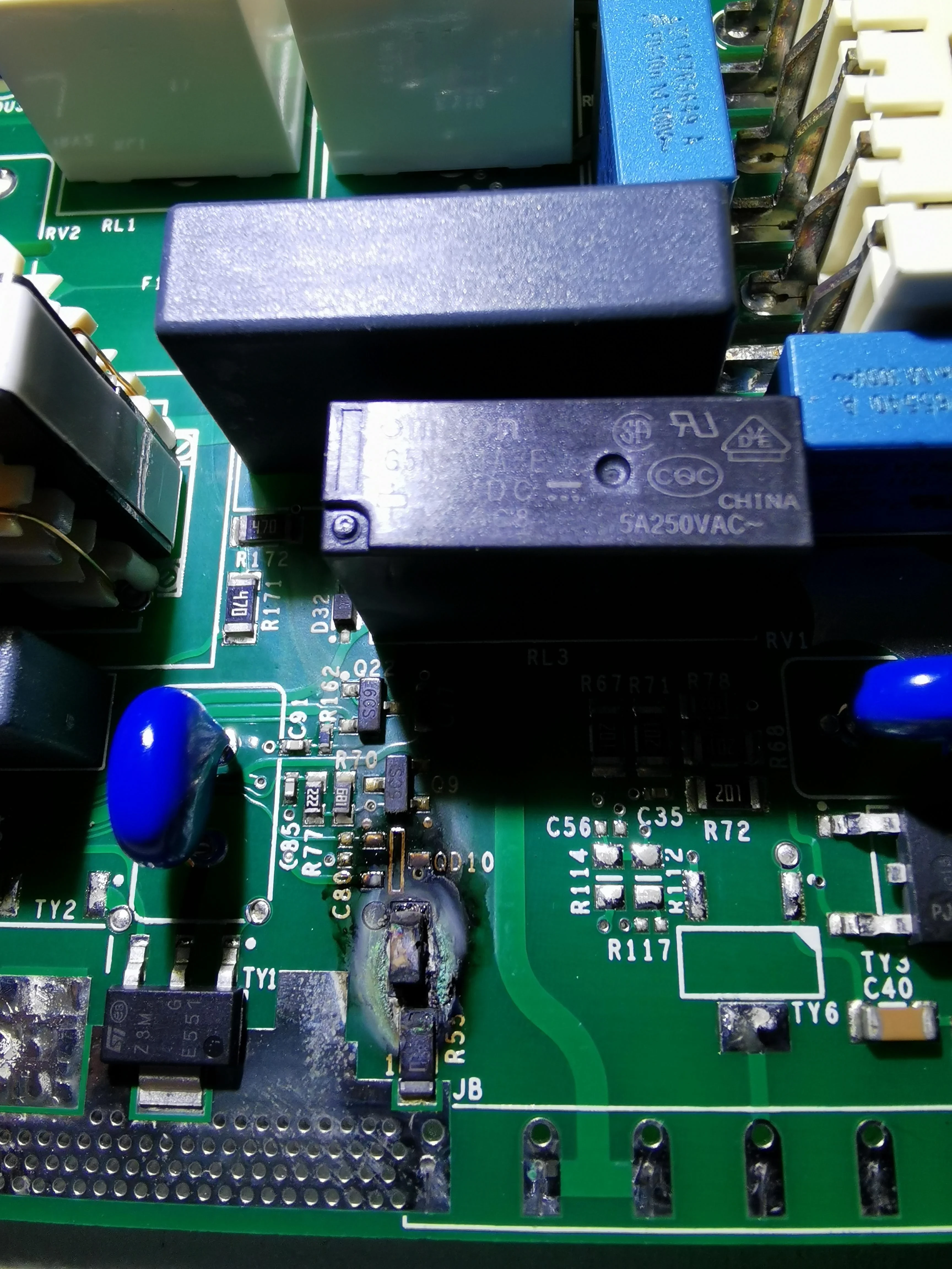

    I open the machine and looking into the PCB saw a capacitor burned. Close-up of a damaged circuit board with a burned capacitor visible. Zanussi ZDT21001FA Dishwasher Not Heating - Burned Capacitor on PCB Identified
    I saw some people on the internet with the same problem and one guy that solved this changing the capacitor and the triac: https://www.youtube.com/watch?v=_nOP1OChspo however my triac, after checking with multimeter looks good.

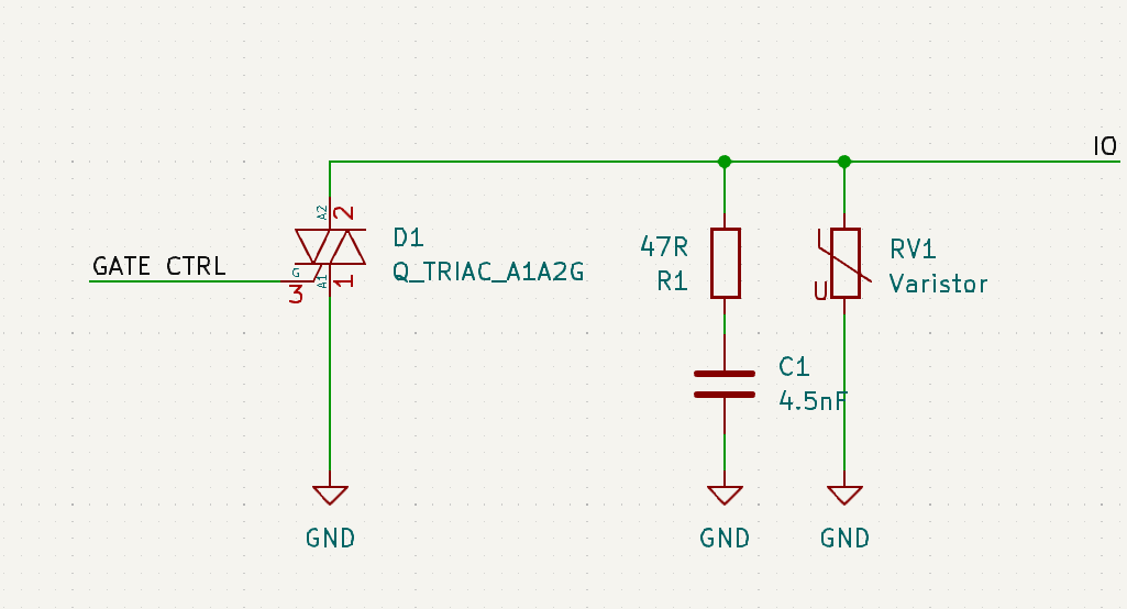

    So if my triac is ok, only the C from the RC Snubber burned: Circuit diagram featuring a triac and RC Snubber components. and I can't understand why it won't work without the RC Snubber. I can solder a new capacitor and check if it solves the problem, do you think it will?
    Should I check other elements on the machine? If yes, which ones?

  • #2 21015413
    mariukonie
    Posts: 1295
    Help: 197
    Rate: 379
    It may work without the RC snubber, but prepare your popcorn because there will be fireworks ;)
