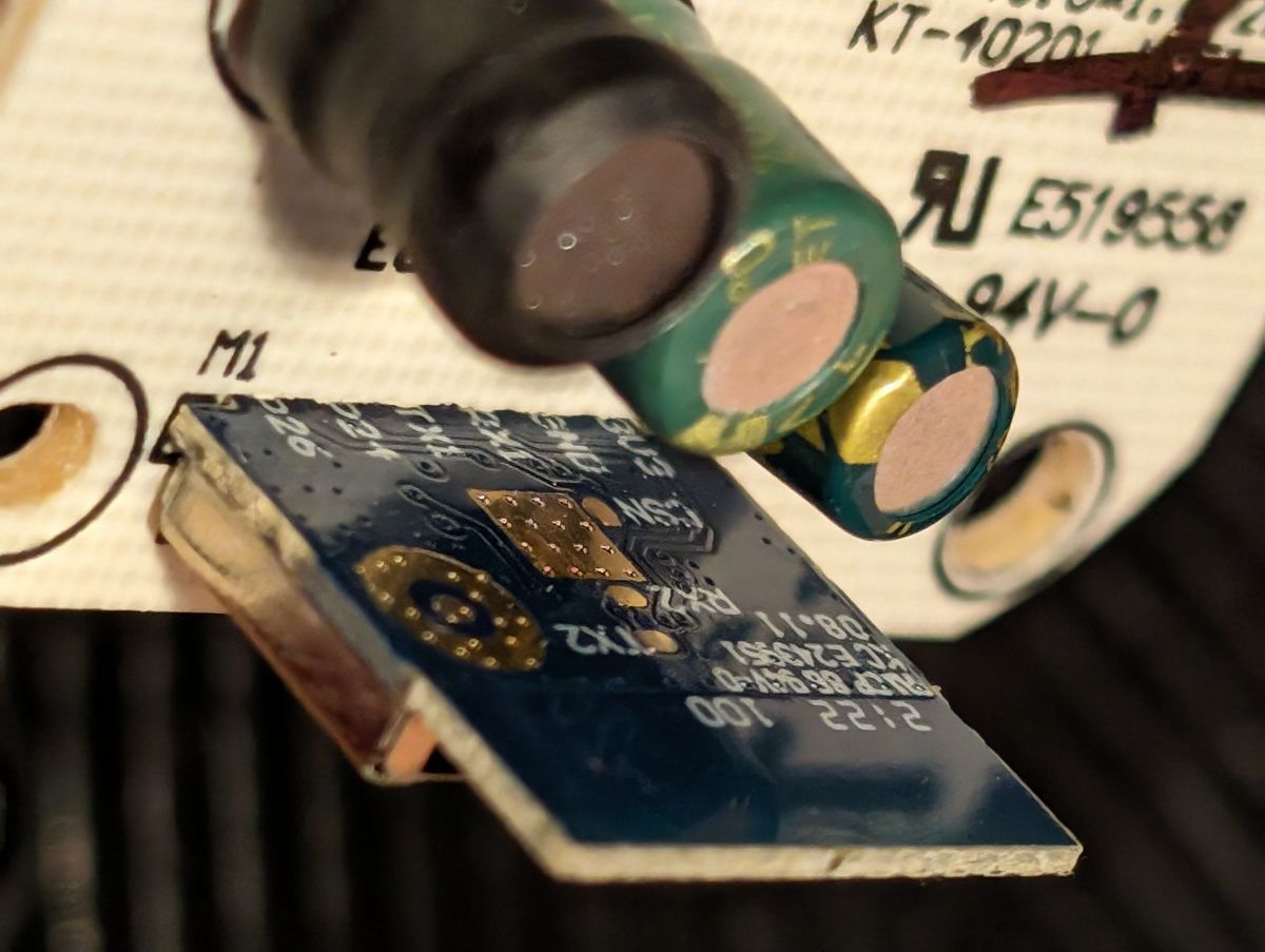

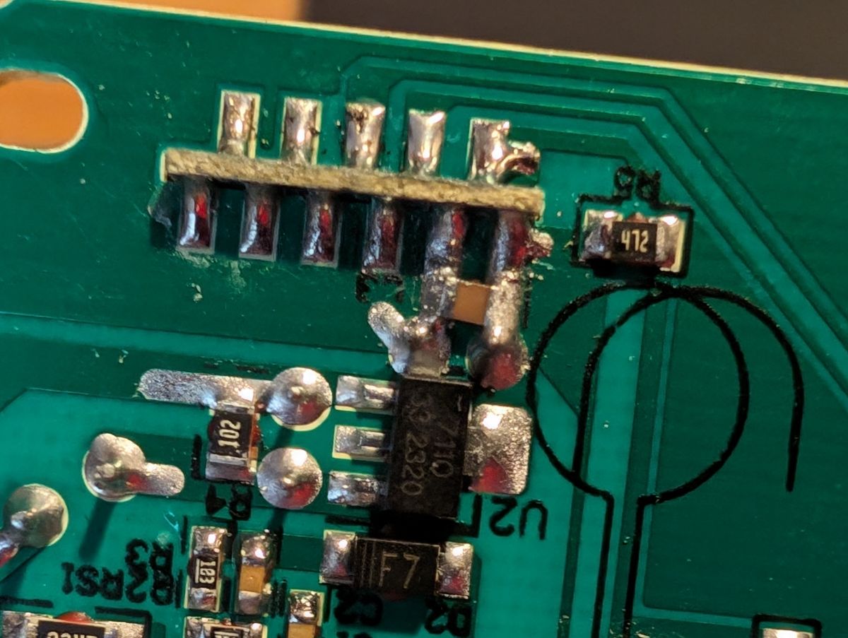

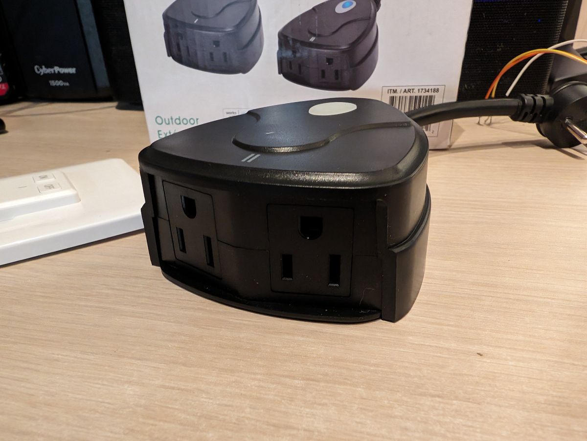

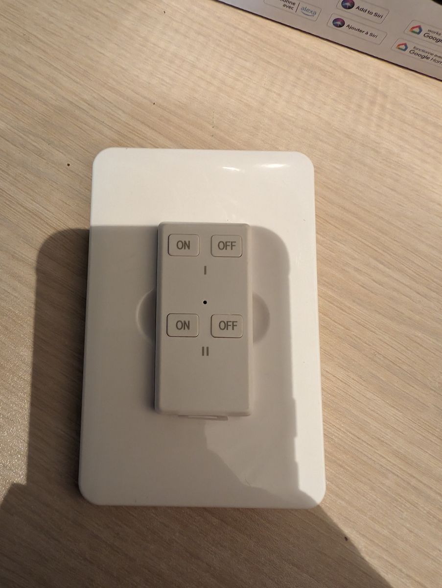

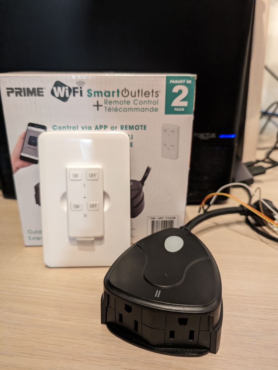

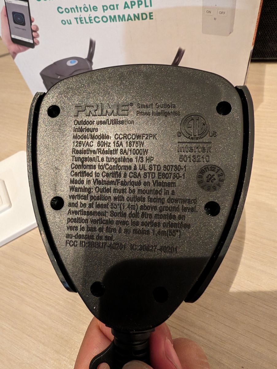

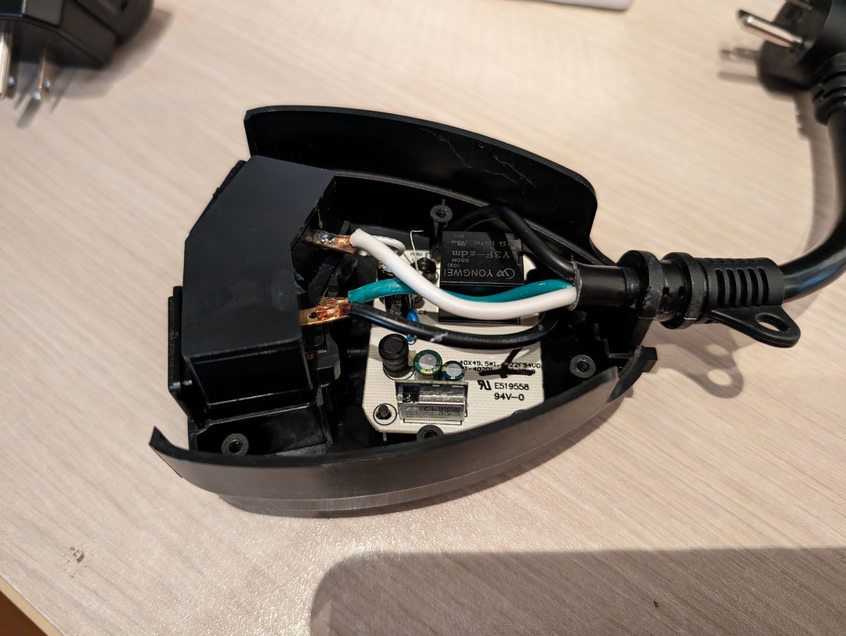

    Got this one from Costco Canada, kinda like CCWFIO232PK but comes with a remote, also need a different template.
    All pins are clearly marked, soldering is needed.
        "vendor": "Prime",
        "bDetailed": "1",
        "name": "CCRCOWF2PK Prime WiFi Smart Outdoor Outlets + Remote control from Costco",
        "model": "CCRCOWF2PK",
        "chip": "BK7231N",
        "board": "on PCB",
        "flags": "1024",
        "keywords": [
          "Outdoor",
          "Plug",
          "Prime",
          "One Button",
          "Costco"
        "pins": {
          "6": "Btn;1",
          "7": "LED_n;1",
          "8": "Rel;1"
        "command": "",
    Prime WiFi Smart Outdoor Outlets packaging with remote control.
    Black Prime WiFi Smart Outdoor Outlets adapter with remote control against product box. Black smart outlet with two plugs on a wooden desk, with a printed package graphic of the device in the background. Back of a Prime smart outlet with logo and specifications. White remote with four buttons: two ON and two OFF, placed on a white stand on a wooden table. Close-up of a PCB with electronic components and visible wiring. Close-up of a PCB of an electronic device showing components and circuitry.
  • #3 21031760
    gokeeper
    Level 4  
    Posts: 9

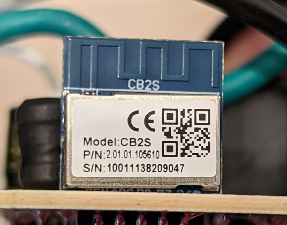

    Yes, the chip is CB2S.
    Interior of an electric device with visible wiring and a chip. Image of a CB2S module with a label showing the model, part number, and serial number.
