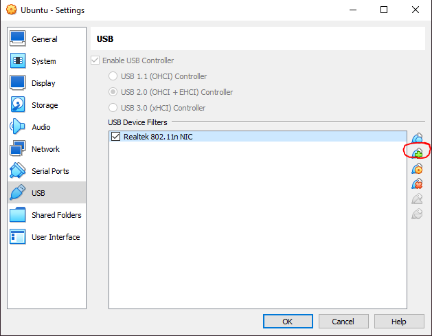

    Get the current firmware from the OpenBK7231T_App Releases Page. Make sure you use the correct BK7231T Platform and CCtr Flash version (with _UG_ in the filename).
    > Note: You will need a linux device to do this. A Raspberry Pi works great. But a VirtualBox VM running Ubuntu and a USB WiFi dongle works too. Just assign the USB WiFi dongle to the VM in machine settings.
