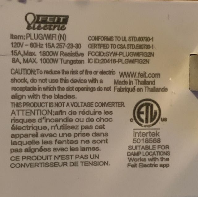

    I ran across another version of this plug purchased from Amazon on 1/31/2024. . It has FCCID: SYW-PLUGWIFIG2N. The model is PLUG/WIFI (N). It uses the Tuya CBU WiFi module that has Beken 7231n chip on it.
    Tuya Cloudcutter was able to flash it with OpenBeken 7231n firmware. I used the Cloudcutter profile "SYW PLUGWIFIG2P Smart Plug" to flash. The config I am using is below.To get it into AP mode one has to hold the button for about 5 seconds and the LED will dim. Release the button and the LED will flash fast. Hold the button again for about 5 seconds until the LED dims. Release the button and the LED will flash slow.
    Feit Electric PLUG/WIFI (N) device label with technical information and warnings.
