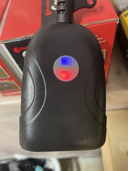

    To answer your question, yes one relay, two sockets. Both sockets are on or off. It occurred to me that perhaps the buttons or LEDs are different on mine, so I took a picture of the front side for future reference.

    Ah thx, so this is indeed a slightly different device.

    I purchased a similar device from Costco today. It seems almost exactly identical to the photos above, except mine is labeled "PLUG/WIFI/WP/2", not "BBPLUG/WIFI/WP/2". The FCC ID is the same, SYW-PLUGWFWP, and it also contains a BK7231N.
    Flashing was straightforward (uartprogram with "--unprotect" and "--startaddr 0x0" options) and the pin configuration from above worked for me. There are two LEDs; the red one is on P24, and the blue one is on P17, which I configured as WifiLED_n. So the full configuration is:
    P15: Rel
    P17: WifiLED_n
    P24: Led_n
    P26: Btn
