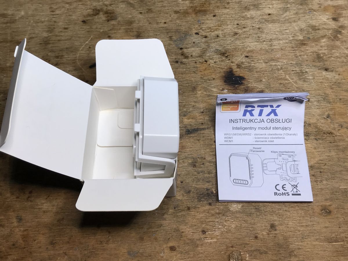

    Today we release from the cloud another product that is easy to buy in our country - a double RTX relay compatible with the Tuya application. As a standard, I will show its interior, describe the process of changing the firmware (where to solder the wires, etc.) and then I will give its configuration OpenBeken (which GPIO is the button, which is the LED, etc).
    Product purchase
    One of my readers bought the product on a Polish auction site, and I got it just to upload it to him OpenBeken
    and then give back to the reader. Thank you! This is always a good opportunity to do a review and analysis.
    The relay was quite expensive, all PLN 75, but such prices are often as we buy in our country:
    [CBU/BK7231N] RTX QS-WIFI-S04-2C WRS2 Dual WiFi Repeater

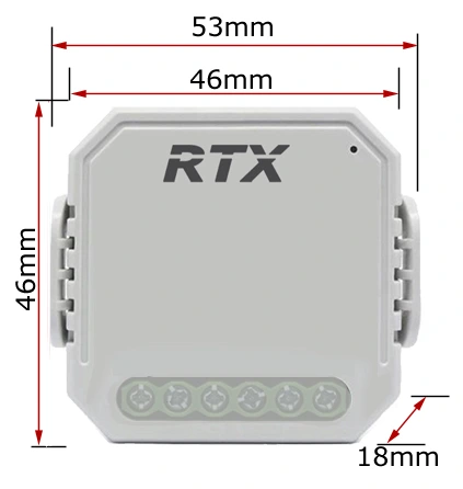

    Dimensions:

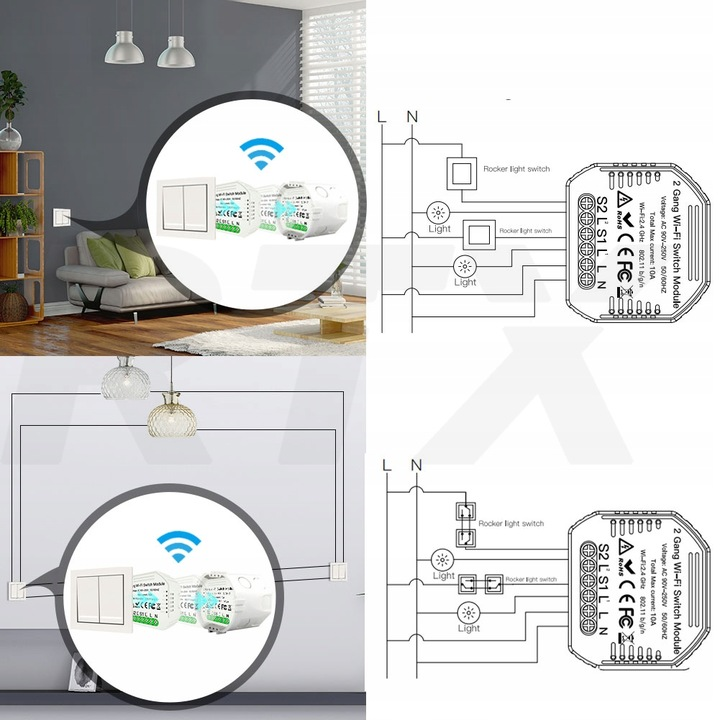

    assembly diagram:

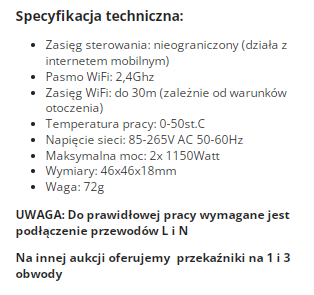

    Specification:
    And here I must already pay attention - unlimited range? No, it's just marketing. This device connects to our WiFi network and then the Tuya cloud actually allows you to control it from around the world, but it's different.
    The annotation "works with mobile internet" is also interesting. Apparently, it is possible to pair this product with a hotspot and any WiFi, also mobile, ... but it does not change the fact that a WiFi router at home is needed to connect this type of Tuya products to the cloud.

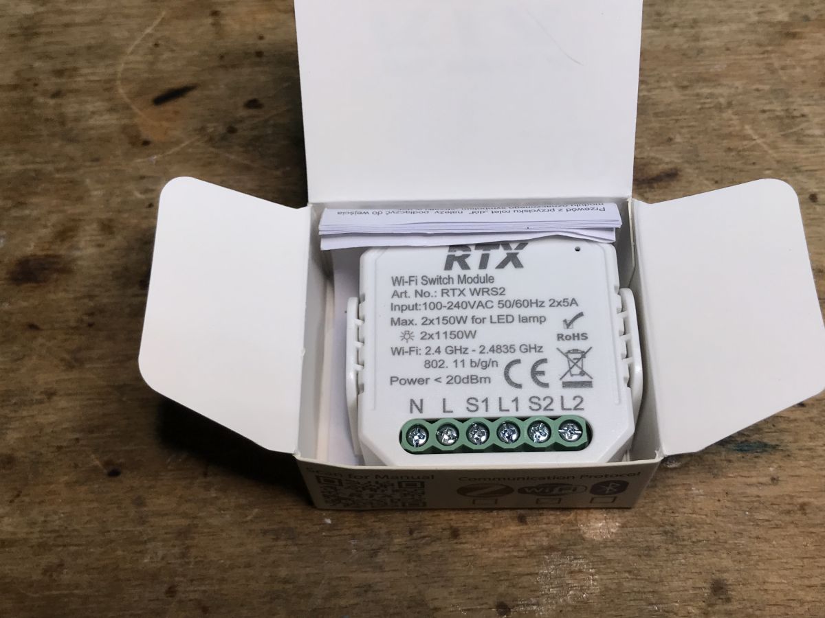

    Kit contents
    Let's see what we get for these PLN 75.
    [CBU/BK7231N] RTX QS-WIFI-S04-2C WRS2 Dual WiFi Repeater [CBU/BK7231N] RTX QS-WIFI-S04-2C WRS2 Dual WiFi Repeater [CBU/BK7231N] RTX QS-WIFI-S04-2C WRS2 Dual WiFi Repeater [CBU/BK7231N] RTX QS-WIFI-S04-2C WRS2 Dual WiFi Repeater [CBU/BK7231N] RTX QS-WIFI-S04-2C WRS2 Dual WiFi Repeater

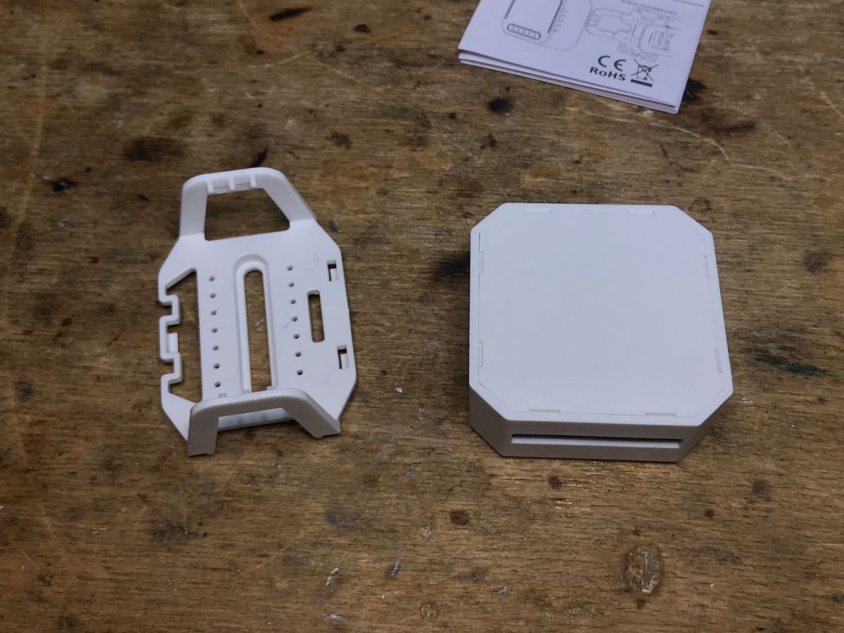

    This time it's poor... not even screws. The product also does not have "wings" for attaching, although there is this plastic hook.
    Interior and firmware change

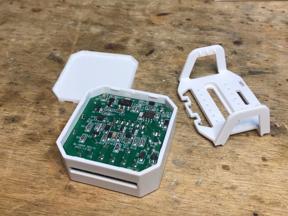

    The white flap is on the hooks, just pry it with a screwdriver.

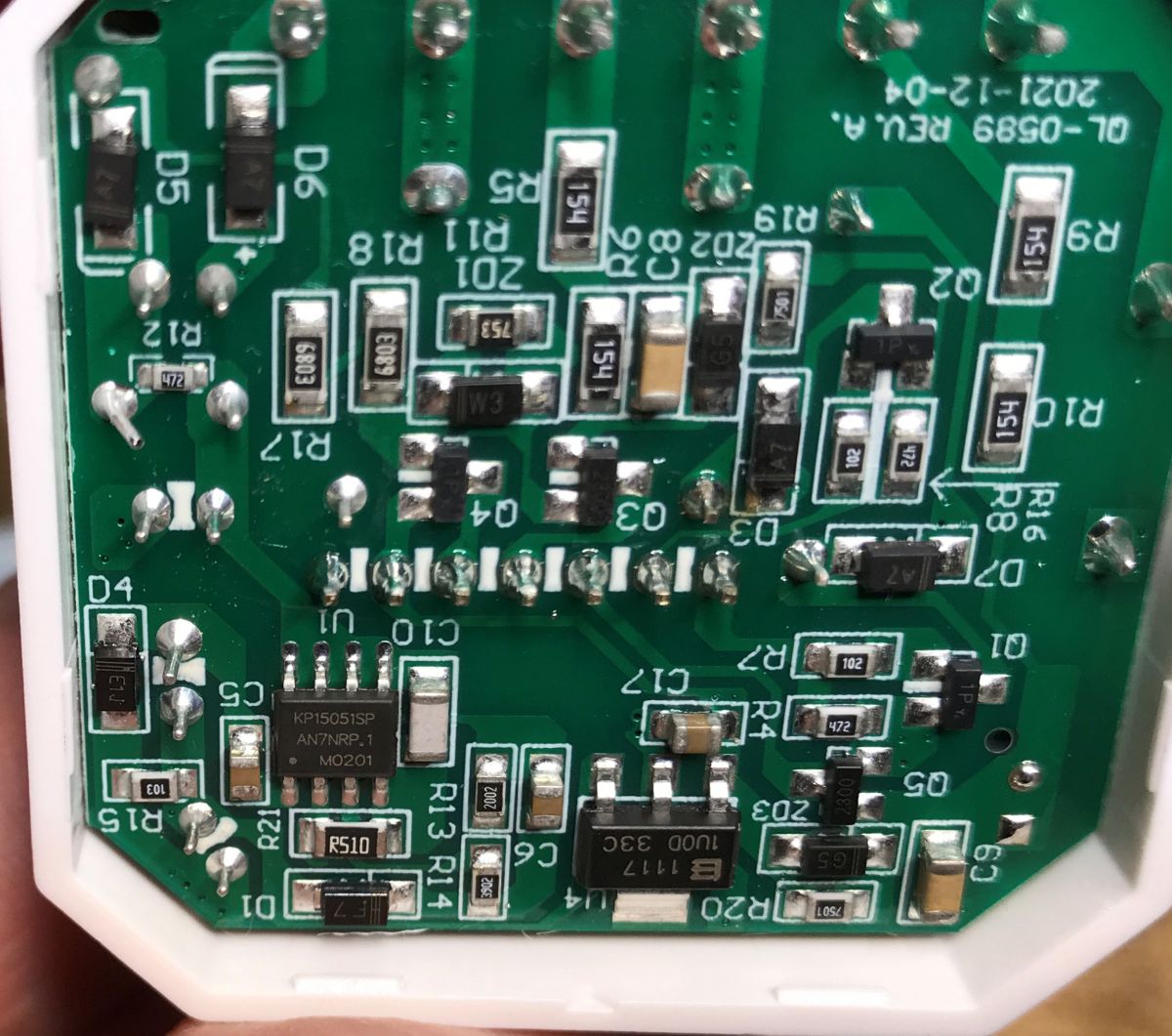

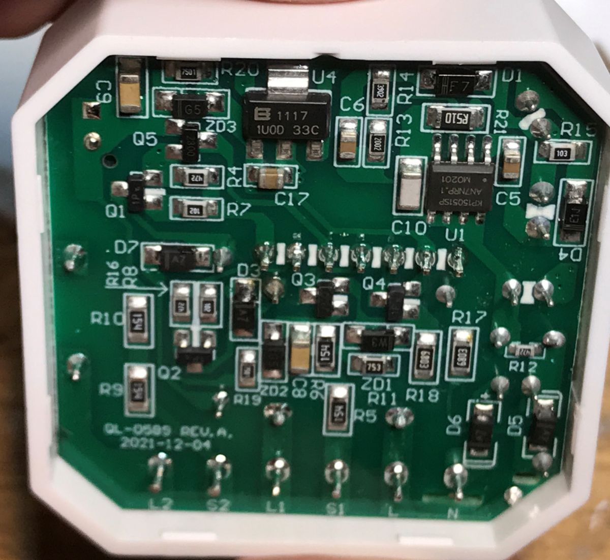

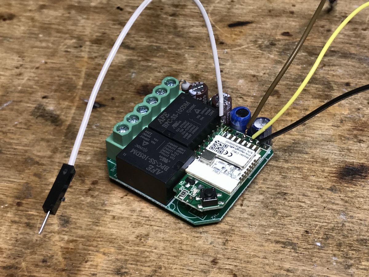

    The system powers the KP15051SP, next to it you can see the AMS1117-3.3V LDO regulator.

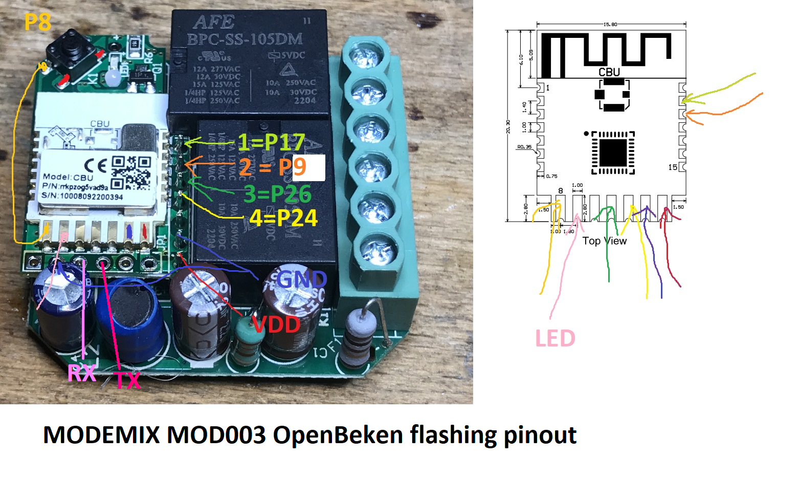

    The top of the PCB, in turn ... I have already described in the case of MOD003. It's identical here. Here is the analysis:

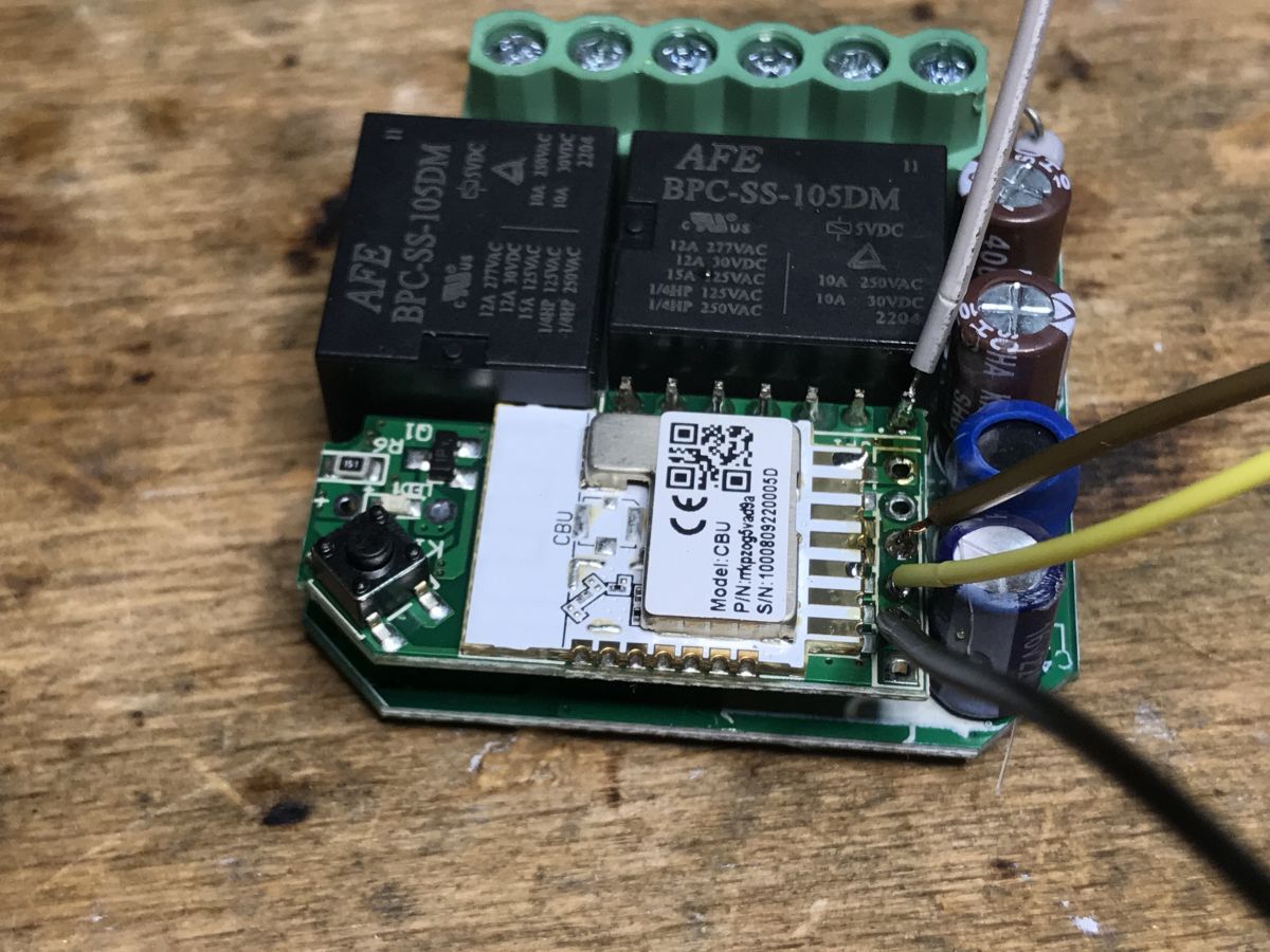

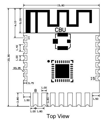

    There is a module inside CBU, który znajduje się na dodatkowej płytce, na której też jest już jego przycisk (od parowania) oraz dioda LED od stanu WiFi.
    Oto jego wyprowadzenia:
    Spoiler:
    Pin number Symbol I/O type Function
    1 P14 I/O Common GPIO, which can be reused as SPI_SCK (Correspond to Pin 11 of the IC)
    2 P16 I/O Common GPIO, which can be reused as SPI_MOSI (Correspond to Pin 12 of the IC)
    3 P20 I/O Common GPIO (Correspond to Pin 20 of the IC)
    4 P22 I/O Common GPIO (Correspond to Pin 18 of the IC)
    5 ADC I/O ADC, which corresponds to P23 on the internal IC (Correspond to Pin 17 of the IC)
    6 RX2 I/O UART_RX2, which corresponds to P1 on the internal IC. (Correspond to Pin 28 of the IC)
    7 TX2 I/O UART_TX2, which is used for outputting logs and corresponds to P0 of the internal IC (Correspond to Pin 29 of the IC)
    8 P8 I/O Support hardware PWM (Correspond to Pin 24 of the IC)
    9 P7 I/O Support hardware PWM (Correspond to Pin 23 of the IC)
    10 P6 I/O Support hardware PWM (Correspond to Pin 22 of the IC)
    11 P26 I/O Support hardware PWM (Correspond to Pin 15 of the IC)
    12 P24 I/O Support hardware PWM (Correspond to Pin 16 of the IC)
    13 GND P Power supply reference ground
    14 3V3 P Power supply 3V3
    15 TX1 I/O UART_TX1, which is used for transmitting user data and corresponds to Pin 27 of the IC. For the MCU solution, please refer to CBx Module.
    16 RX1 I/O UART_RX1, which is used for receiving user data and corresponds to Pin 26 of the IC. For the MCU solution, please refer to CBx Module.
    17 P28 I/O Common GPIO (Correspond to Pin 10 of the IC)
    18 CEN I/O Reset pin, low active (internally pulled high), compatible with other modules (Correspond to Pin 21 of the IC)
    19 P9 I/O Common GPIO (Correspond to Pin 25 of the IC)
    20 P17 I/O Common GPIO, which can be reused as SPI_MISO (Correspond to Pin 14 of the IC)
    21 P15 I/O Common GPIO, which can be reused as SPI_CS (Correspond to Pin 13 of the IC)
    Test point CSN I/O mode selection pin. If it is connected to the ground before being powered on, enter the firmware test mode. If it is not connected or connected to VCC before being powered on, enter the firmware application mode. Correspond to Pin 19 on the internal IC.
    Just solder the wires to:
    - RX
    - TX
    - 3.3V
    - GND

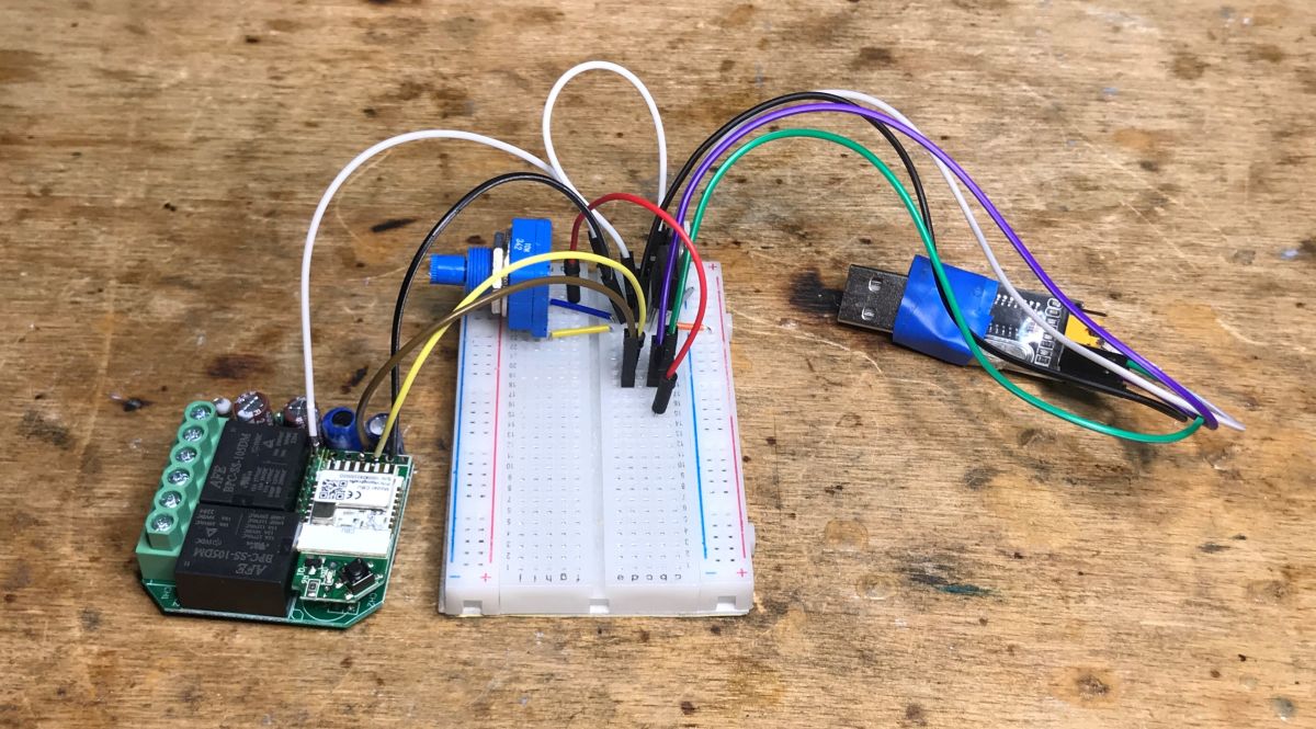

    Then you need to use Flasher:
    As a rule, a photo from programming:
    Note - performing a reboot by cutting off the power supply works only when we disconnect the whole thing from the computer with the USB to TTL programmer, and disconnect the 3.3V from the WiFi module. Then connect the USB to the computer, then start the programming/reading procedure in BK Flasher, and then connect the 3.3V pin. It will not work in any other order, nor will it catch if we just disconnect and connect 3.3V with the USB connected all the time. That is my observation.
    You can also use the CEN reset method instead of power cycle, but I didn't want to solder another wire.
    And configuration OpenBeken :
    - P7 - WiFiLED_n
    - P24 - TglChannelOnToggle - Channel 1
    - P26 - TglChannelOnToggle - Channel 2
    - P9 - Relay - Channel 1
    - P17 - Relay - Channel 2
    - P8 - Button - Channel 1 and Channel 2 (set two channels to control one by click and the other by double click)
