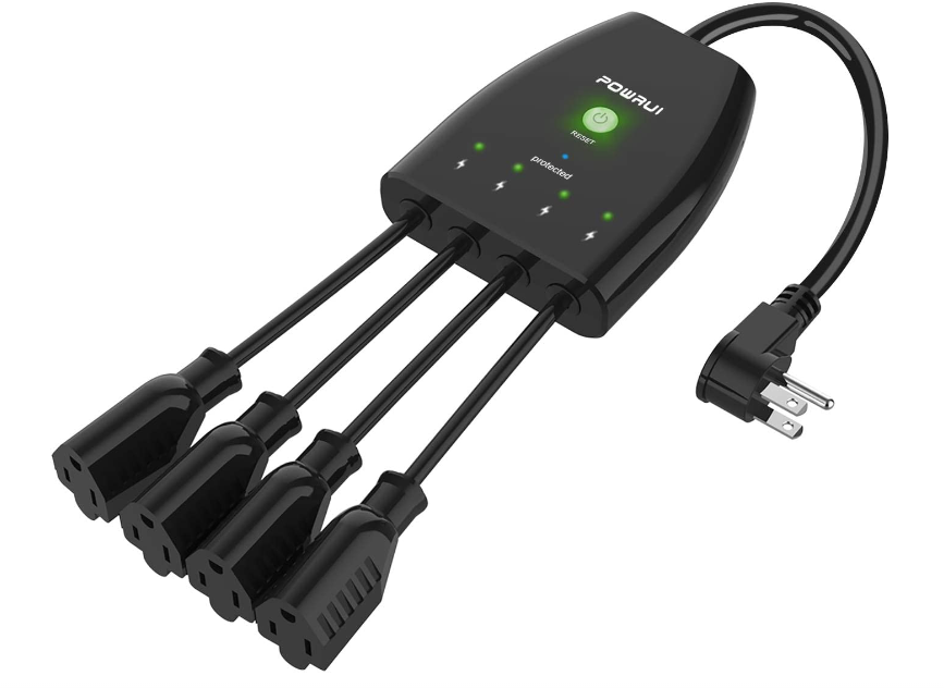

    Btw, for the sake of preserving information (you never know when Amazon deletes an auction info), I will repost here screenshots of the device from the outside (we have our own reliable hosting on Elektroda, so images here are safe):
