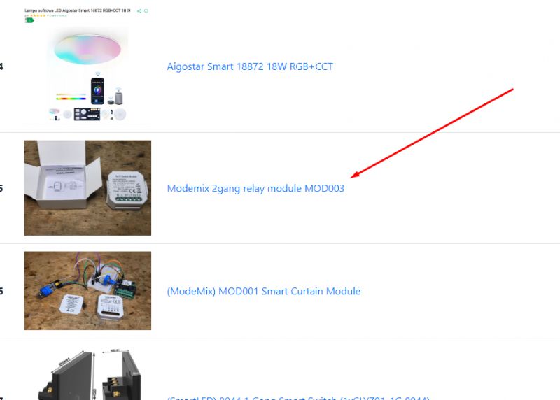

    #4 21066142
    Posts: 14760
    Rate: 12886

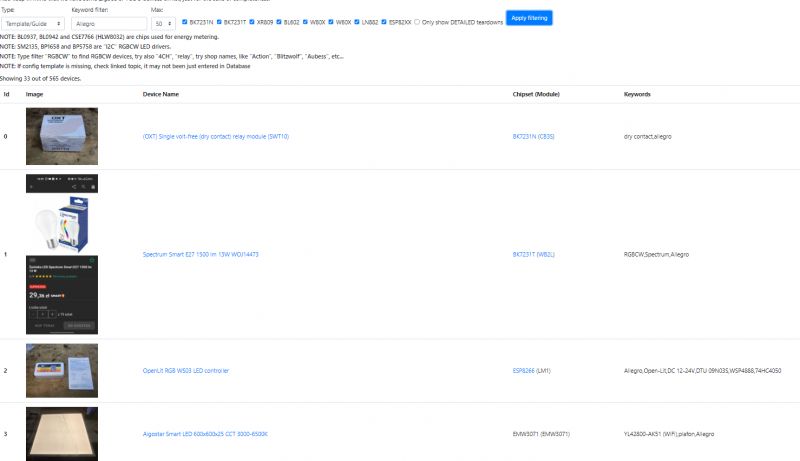

    The modules linked by @gulson may work well. If @AoT_Hunter_PL you don't want to upload Tasmota yourself then I can do it, in that case write PW.
    If you want to search more, you can use the Electrode list:
    You select which platforms you are interested in (e.g. ESP8266) and enter a keyword.
    Store names also work, e.g. Allegro. Allegro.
    Below is an example of the result:
    Screenshot of an IoT device list with selected details.
    Then you click on the device name you are interested in:
    Screenshot of an IoT device list with the Modemix 2gang relay module MOD003 highlighted.
    And it returns you to the topic of Electrodes.

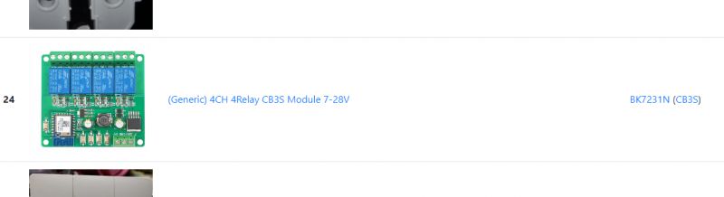

    Here some four-channel:
    Screenshot of a device list highlighting the 4-channel 4Relay CB3S module. .

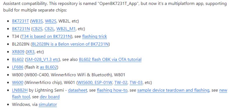

  • #6 21066145
    Posts: 14760
    Rate: 12886
    AoT_Hunter_PL wrote:
    Sonoff 4CH R3 Mini , so look for this module to be on ESP >?
    Most reliably on ESP, but on BK7231 also can be converted, on all platforms from the list below potentially can be flashed:
    List of compatible chips for OpenBK7231T_App on GitHub.

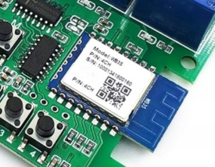

    #8 21066327
    Posts: 14760
    Rate: 12886
    Double-check what you're buying, as there are also versions with WB3S (but these can also be programmed and controlled without the cloud):
    Sonoff relay board with electronic components in an online store background. Close-up of a circuit board with WB3S module and buttons. .
