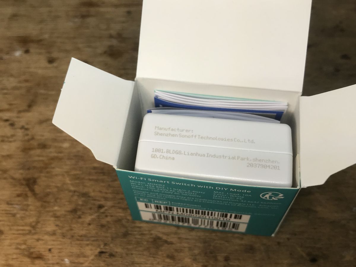

    Let's see what we get in the set:
    Sonoff Mini R2 box on a wooden table. Sonoff Mini R2 box with information on the back. Sonoff Mini R2 module packaging on a wooden surface. Sonoff Mini R2 packaging on wooden background
    Box contents:
    Open box with a Sonoff Mini R2 module and manual inside. Image of the Sonoff Mini R2 module on a wooden background.
    This time they did not provide mounting screws. Unfortunately.

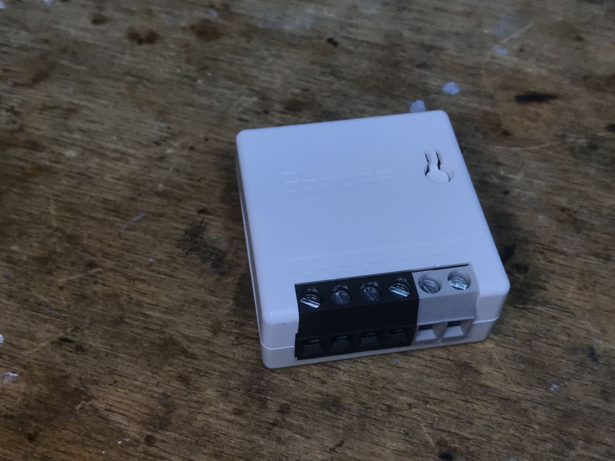

    Sonoff Mini R2 interior
    We pry the cover and uncover the plate:
    Interior of the Sonoff Mini R2 module with the PCB exposed.

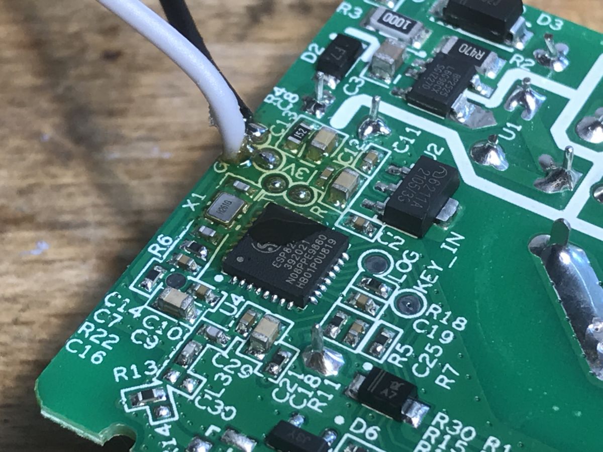

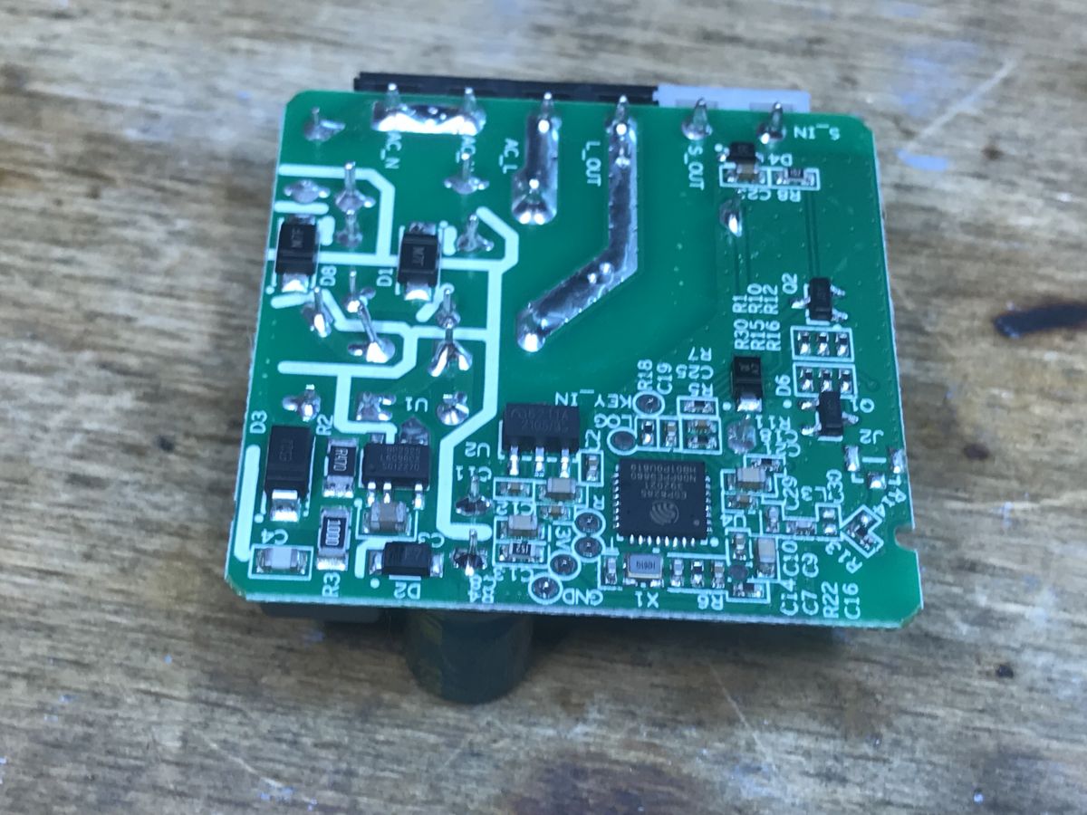

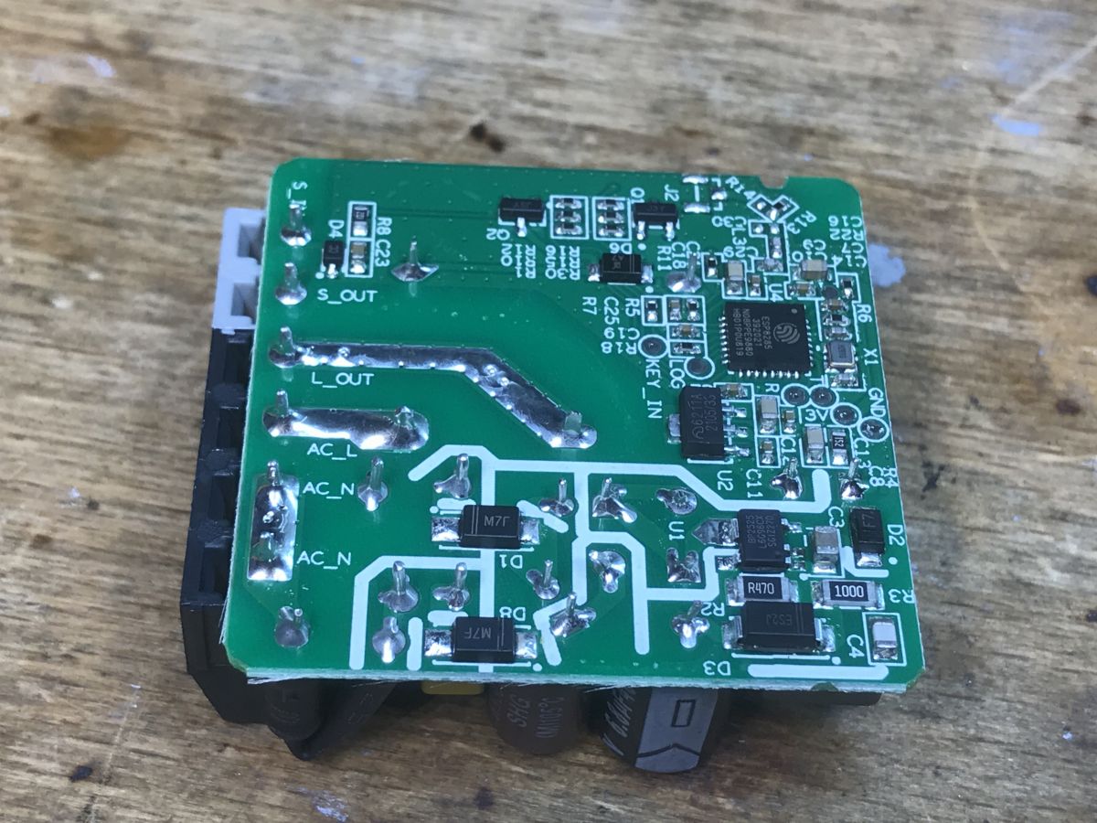

    The module is based on ESP8285:
    Close-up of the circuit board from the Sonoff Mini R2 module. Sonoff Mini R2 circuit board with electronic components. View of the interior of the Sonoff Mini R2 module with visible PCB. Sonoff Mini R2 module's electronic board with ESP8285 chip on a wooden background.

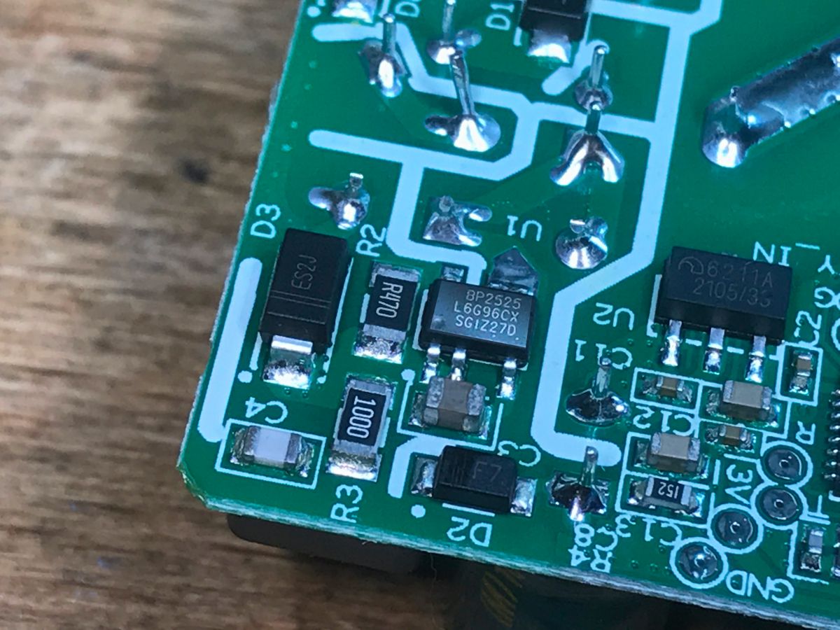

    The BP2525 step down converter serves as the power supply, it powers the relay, while the ESP also has an AMS1117-3.3V power supply line on the way:
    Close-up of a circuit board section with electronic components of a Sonoff Mini R2.
    On the top we only have a button, a relay and power supply components (there is even a fuse, varistor and capacitor at the input):
    Interior of the Sonoff Mini R2 module with visible capacitors, relay, and other electronic components. Close-up of the Sonoff Mini R2 circuit board with visible electronic components. Interior of the Sonoff Mini R2 module with visible electronic components.

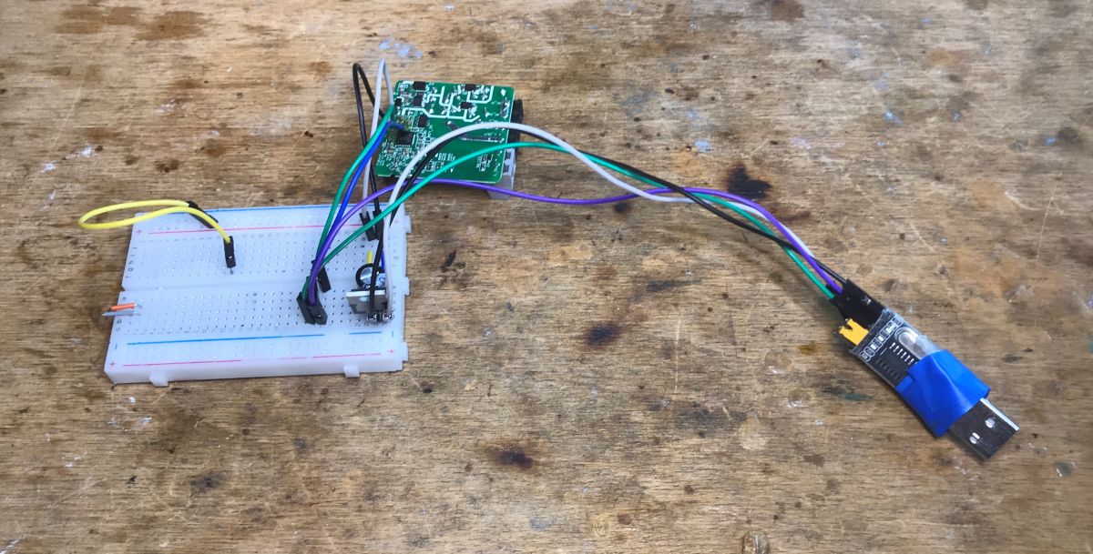

    Firmware change
    The device is based on ESP8285, so you can load Tasmota via esptool.py . I have discussed this many times, including: here:
    SmartLife switch - test, interior and programming of a WiFi light switch
    However, in the case of this device, the situation is slightly simplified. because GPIO0 is located on the button .
    So we solder the power supply (3.3V):
    Sonoff Mini R2 circuit board with visible traces and components.
    Close-up of a circuit board with an ESP8285 chip.
    Then RX and TX:
    Close-up of the Sonoff Mini R2 circuit board with soldered colored wires.
    As in previous topics, I have prepared a USB to UART converter, but this time when connecting it to USB, you need to hold the button on the housing so that GPIO0 is shorted to ground while booting ESP. The button can then be released. You can then start programming via esptool.
    Sonoff Mini R2 module connected to a breadboard and USB to UART converter.
