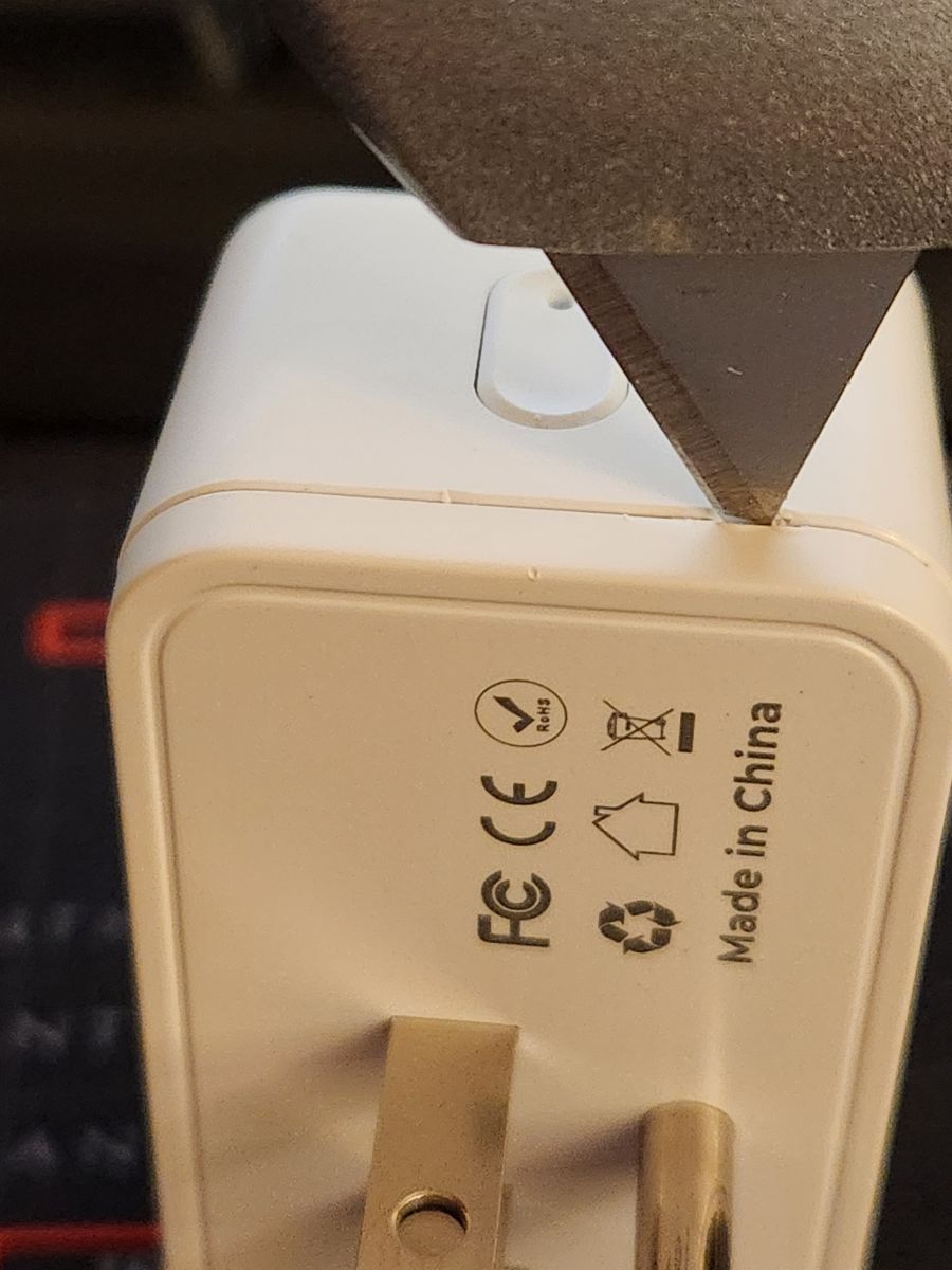

    The plug is sonically welded so it's a bit hard to open. I used a utility knife around the seam and I was able to lift one side and open it.
    Tuya US electrical plug with a utility knife placed along the seam of the casing.

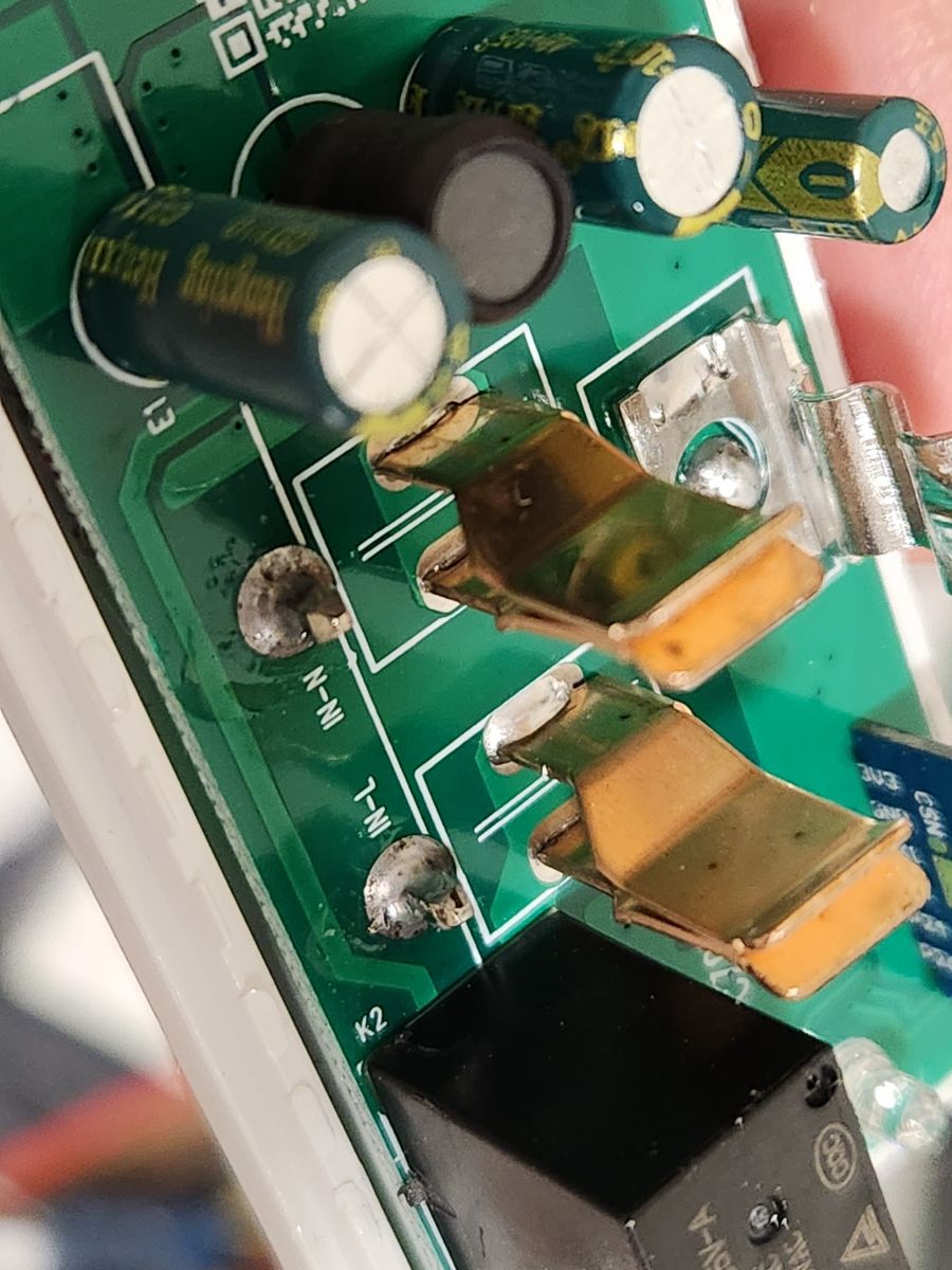

    It has CB2S inside, the flashing should be easy but the live/neutral prongs are soldered to the back of the plug.
    De-soldering the prongs will be very difficult and the case may melt from the heat.
    Close-up of the inner components of a Tuya US plug with CB2S chip and other elements on a PCB.

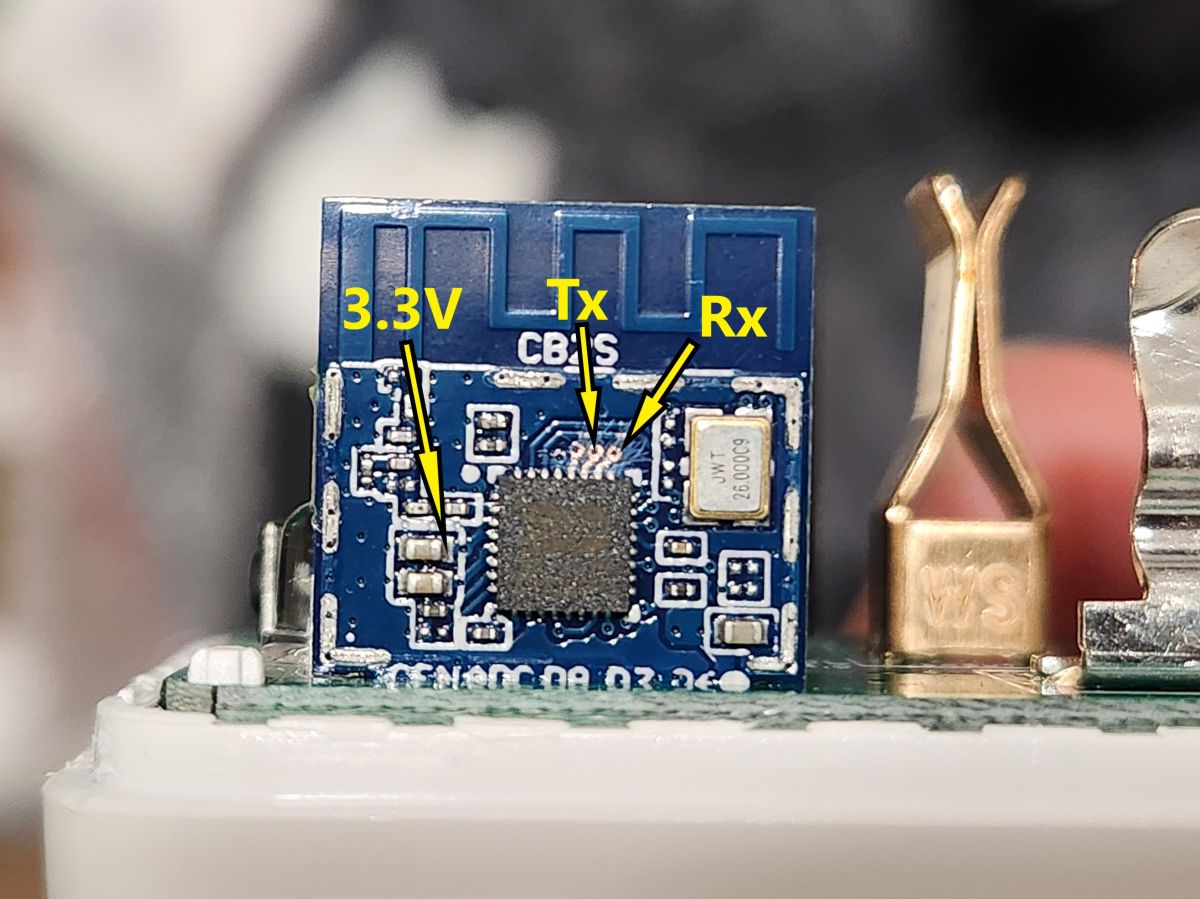

    Instead, I removed the metal shield of the CB2S and tried to find another access to the Rx/Tx pins.
    I scraped some of the PCB masking to gain access to the via holes for the Rx/Tx and used one side of a capacitor for the 3.3V and ground is easily accessible.
    Close-up of a CB2S board with labels 3.3V, Tx, and Rx.

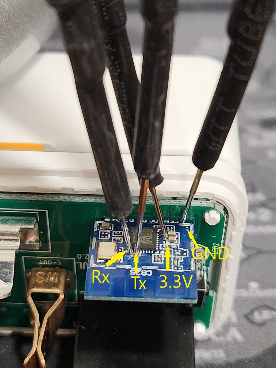

    Using BDM Frame made the job much easier. https://www.aliexpress.com/w/wholesale-BDM-Frame.html?spm=a2g0o.detail.search.0
    CB2S module with test probes connected to Rx, Tx, 3.3V, and GND points.
    For the configuration
    - BL0937 SEL on P26
    - Button (channel 1) on P24
    - BL0937 VI on P7
    - WiFi LED on P23
    - BL0937 ELE on P6
    - Relay (channel 1) on P8

    Thank you, added:
    https://github.com/OpenBekenIOT/webapp/commit/9430386435cc84f714b6f7e3995f875b45dbc31f
