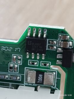

  • A no-name AliExpress smart plug sold as a 20A energy-monitoring outlet was torn down, revealing a CB2S module and BL0937 metering.
  • The enclosure can be opened with a clamp in 2–3 minutes, then the CB2S can be desoldered and flashed with OpenBeken using BK7231 GUI Flash Tool.
  • The relay inside is only 16A, and the plug cost $2.99 in the promotion.
  • Pin mapping included P6 BL0937CF1, P7 BL0937CF, P8 blue LED, P10 button, P24 BL0937SEL, and P26 relay.
  • Calibration with a 60W bulb that measured 62W at 229V gave accurate readings, and flag 38 fixed the strange OFF measurement.

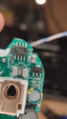

    Inside there is a surprise: a 16A relay, the thickness of the solder and the PE cable is not great.
    I opened a dispute on ali and they gave back half the price without resistance.
    There we find the CB2S chip and the energy measurement using BL0937

    I desoldered the CB2S for programming, the braid is necessary.
    Soft uploaded using BK7231 GUI Flash Tool - here I had a small problem at the beginning because WIN10 lost the drivers for CP2102 after the next update, but after realizing the situation it went without major problems.
    Configuration with the help of other topics from the electrode:
    P6 BL0937CF1
    P7 BL0937CF
    P8 LED (blue)
    P10 Btn
    P24 BL0937SEL
    P26 Rel (probably also a second red diode here)
    After calibrating with a 60W bulb that is actually 62W at 229V and a Fluke multimeter it seems to measure approx.
    Only with the OFF position there is a strange measurement instead of 0.

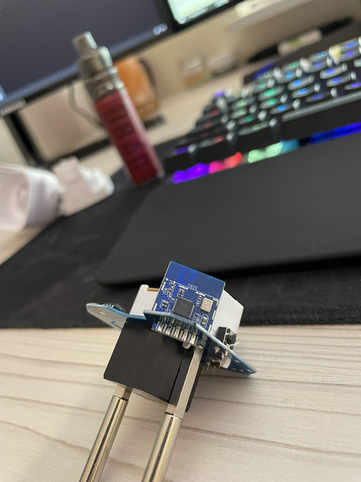

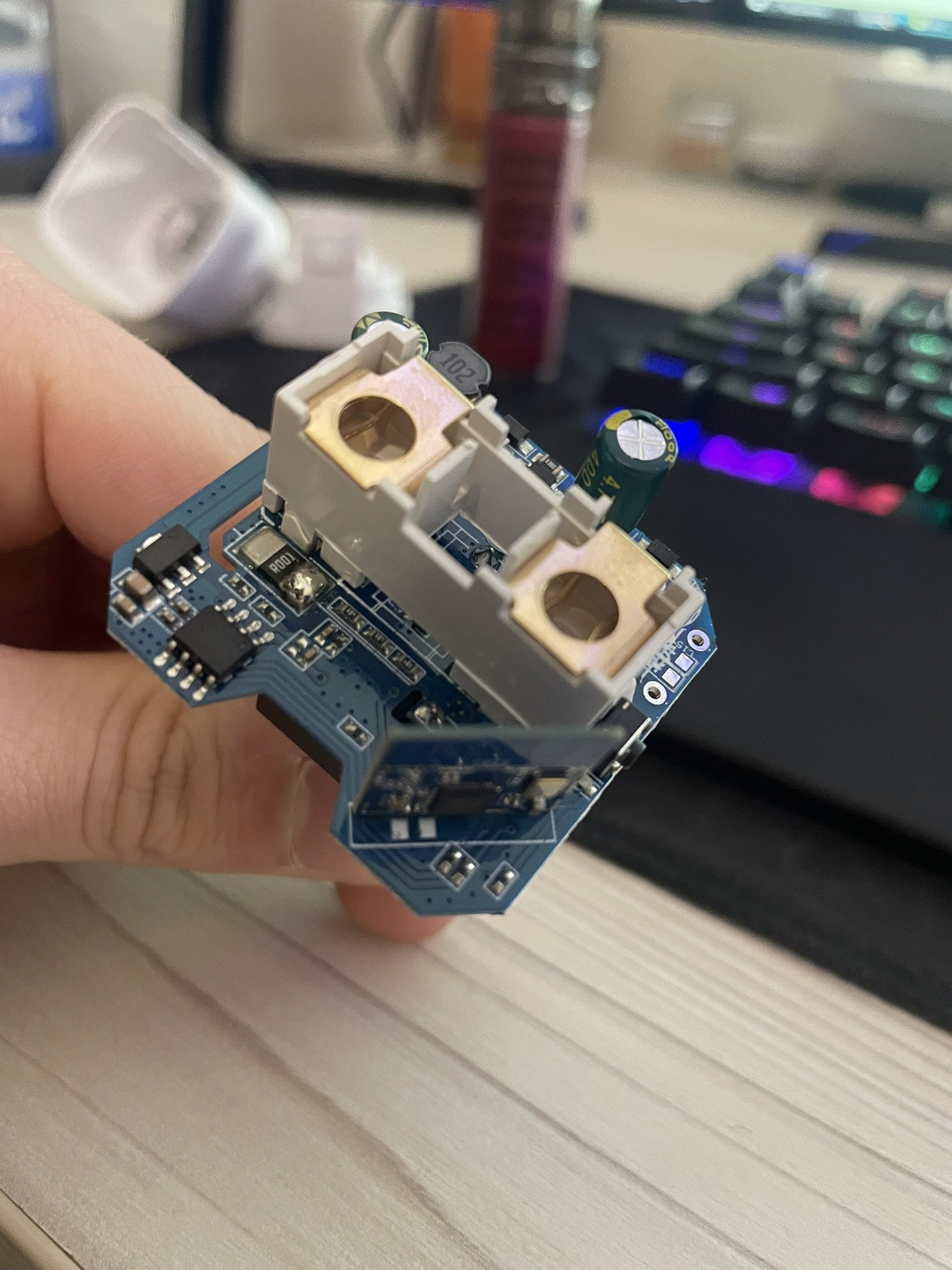

    Hi, I have the same no name plug from Polish allegro.
    My question is as follows. Do I have to solder the CB2S board out of the module (e.g. because of other connections on it that may interfere with programming)?
    Will it be enough to solder into it?
    Attached are pictures of the inside of my board.

    @Jacekmiel1 first post indicates that P10 (RX1) is used as a button, only now I don't know if there is also a debouncing capacitor there? If so, it needs to be soldered out. If not, it will be possible to upload flash without it. Situation similar to here:
    https://www.youtube.com/watch?v=PKkiqDNFIx8
    Generally, I always suggest to solder, it's very simple. Check out our channel on YT, see the playlist of flashing guides:
    https://www.youtube.com/@electrodacom
    Watch this video, desoldering CB2S is very easy, just important to use flux and braid:
