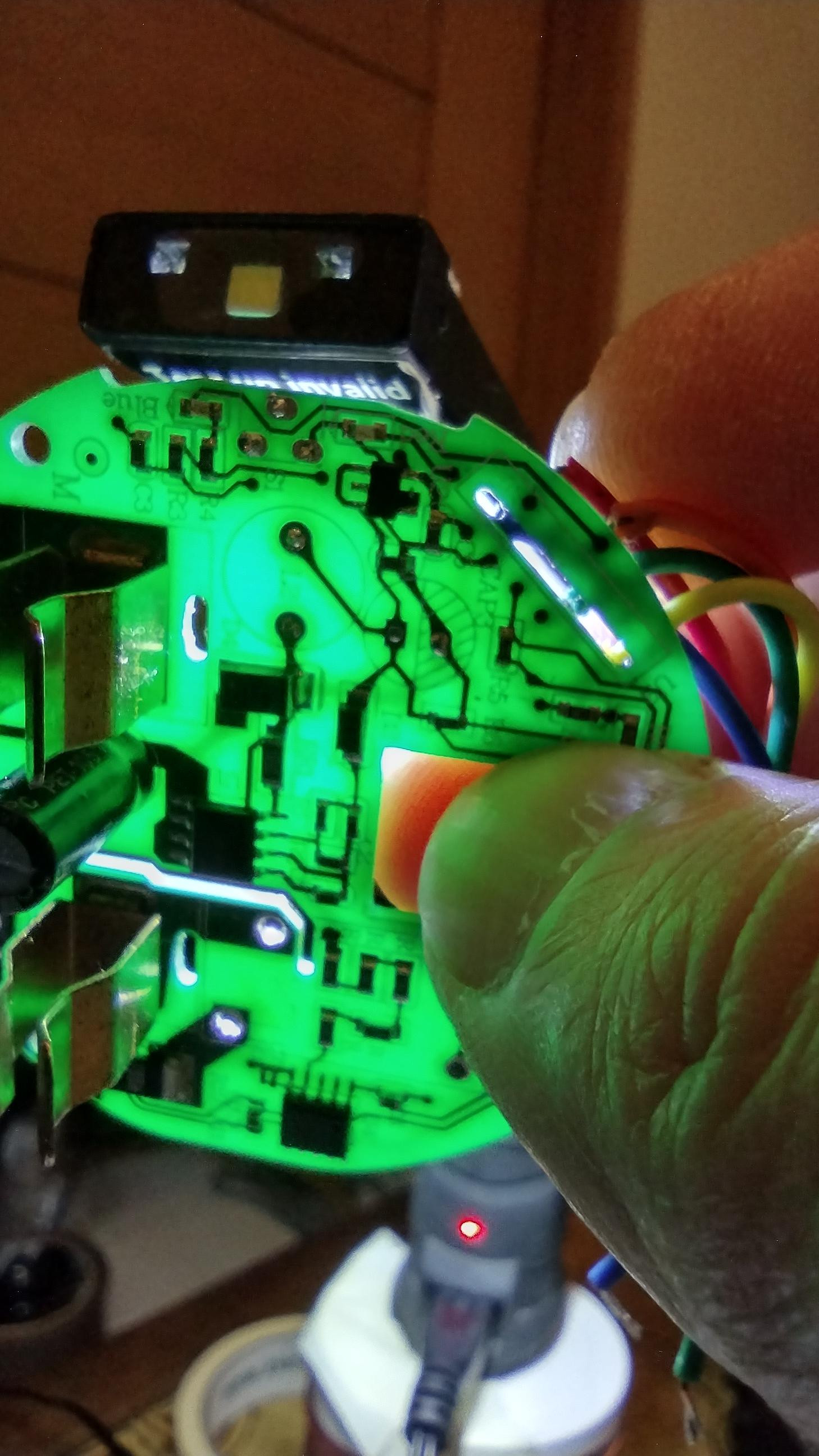

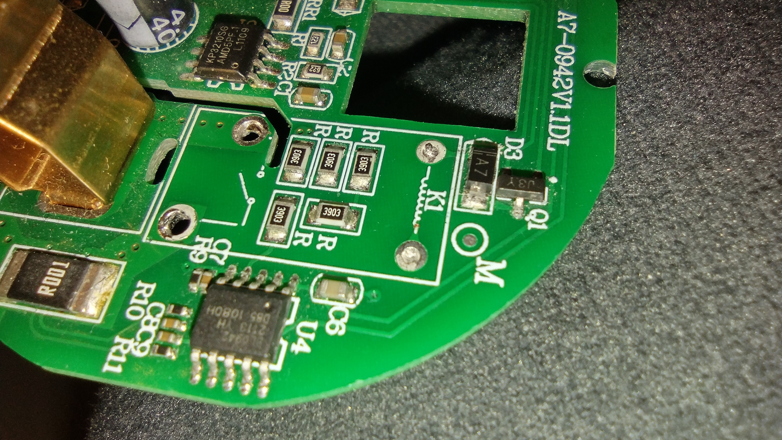

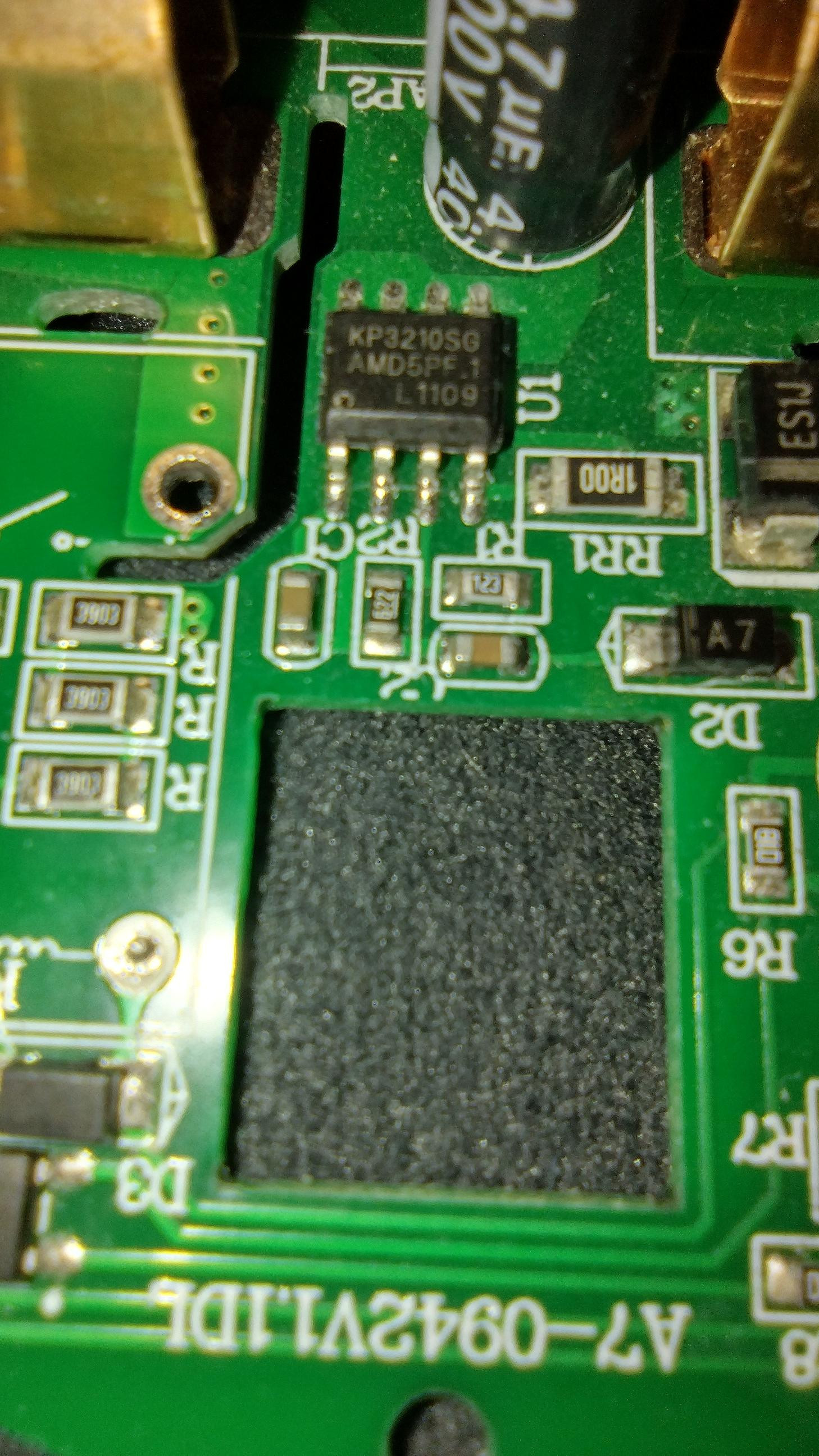

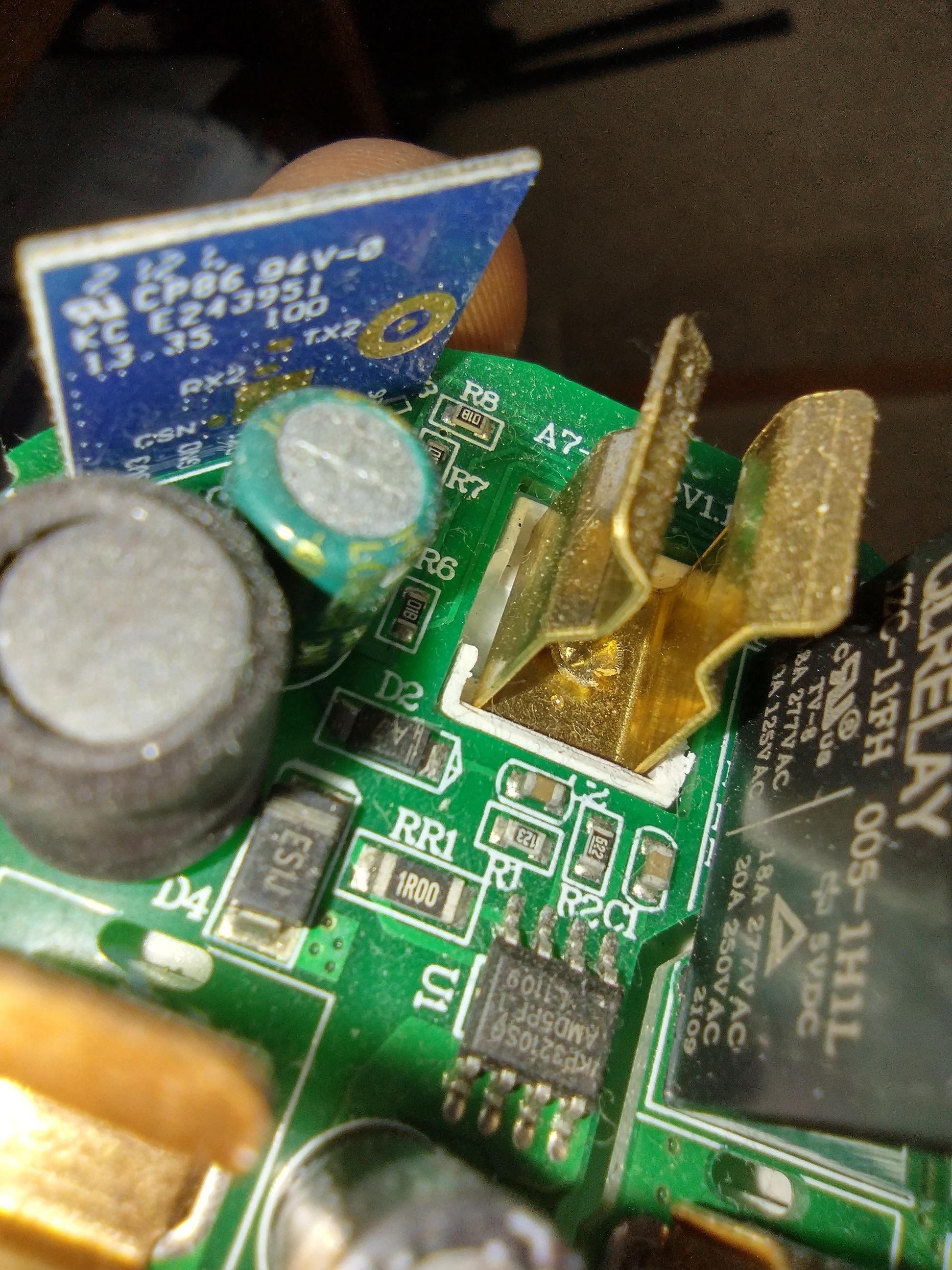

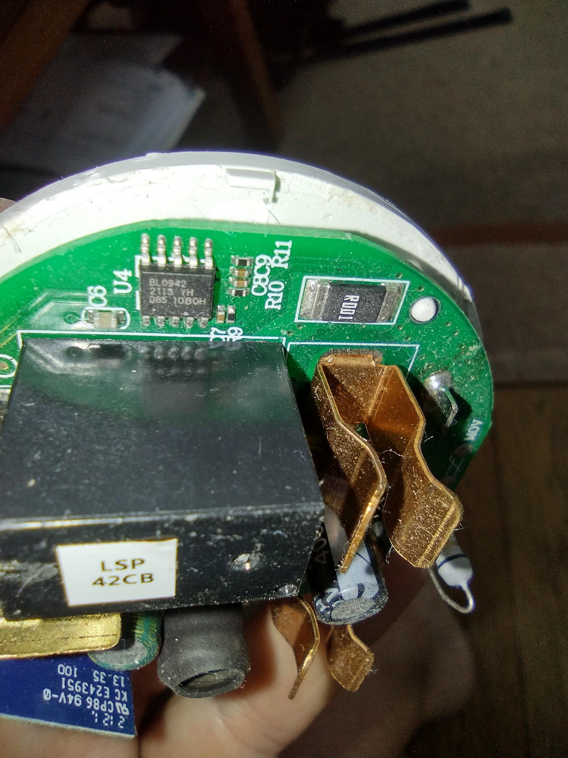

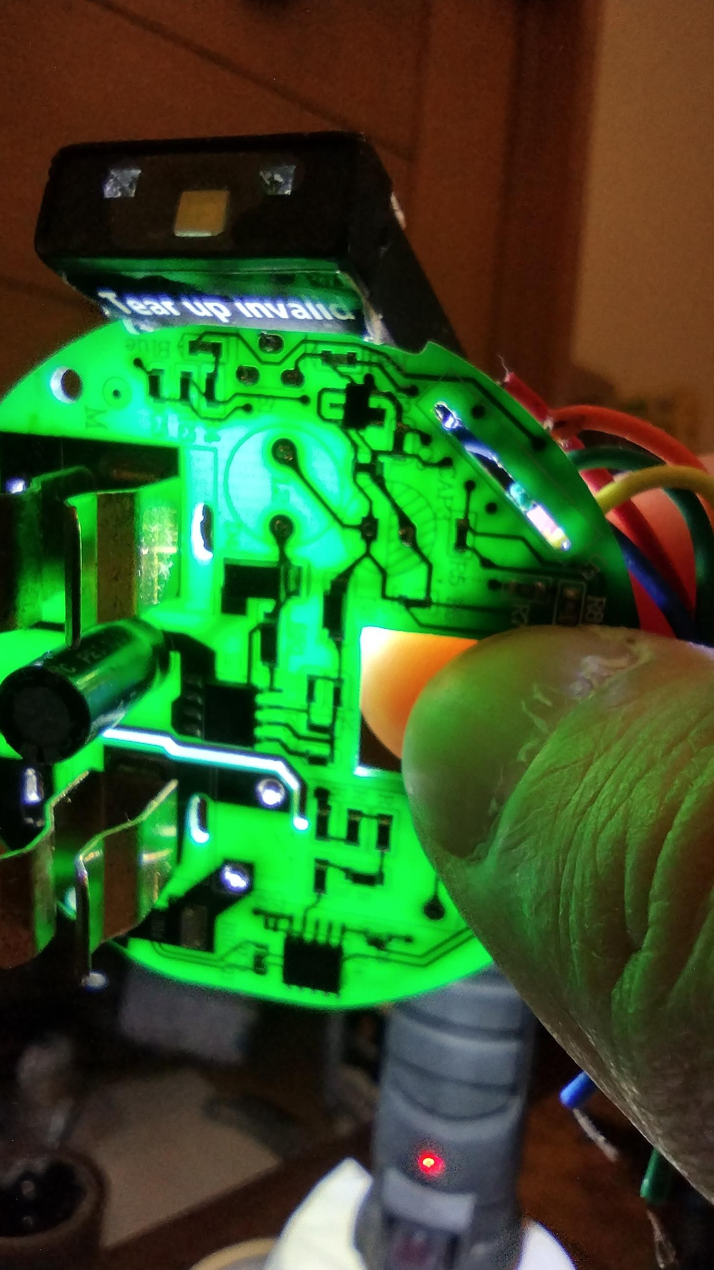

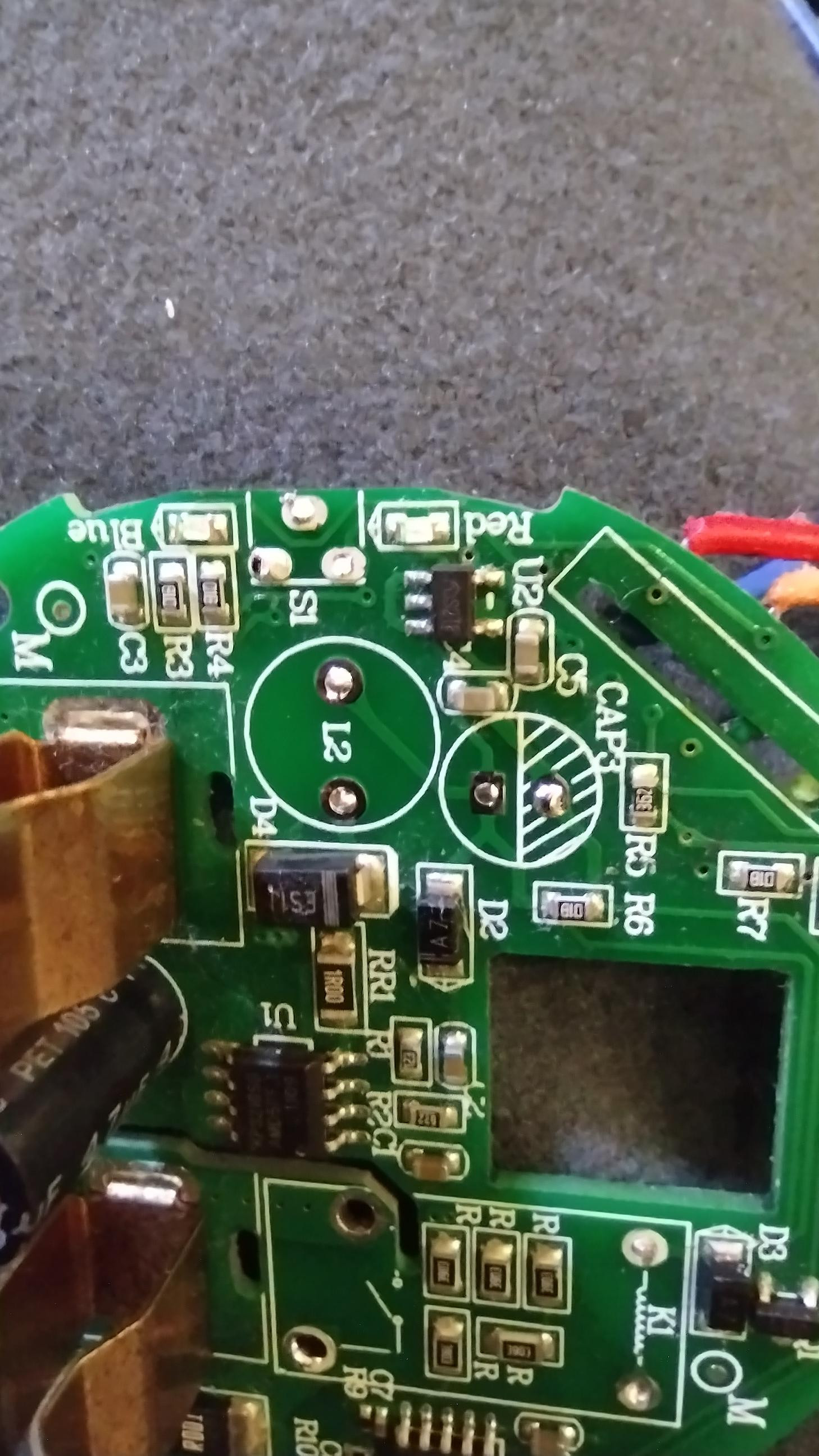

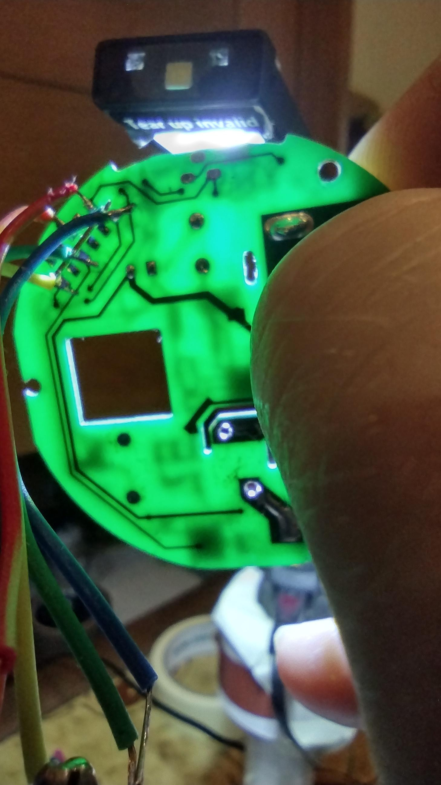

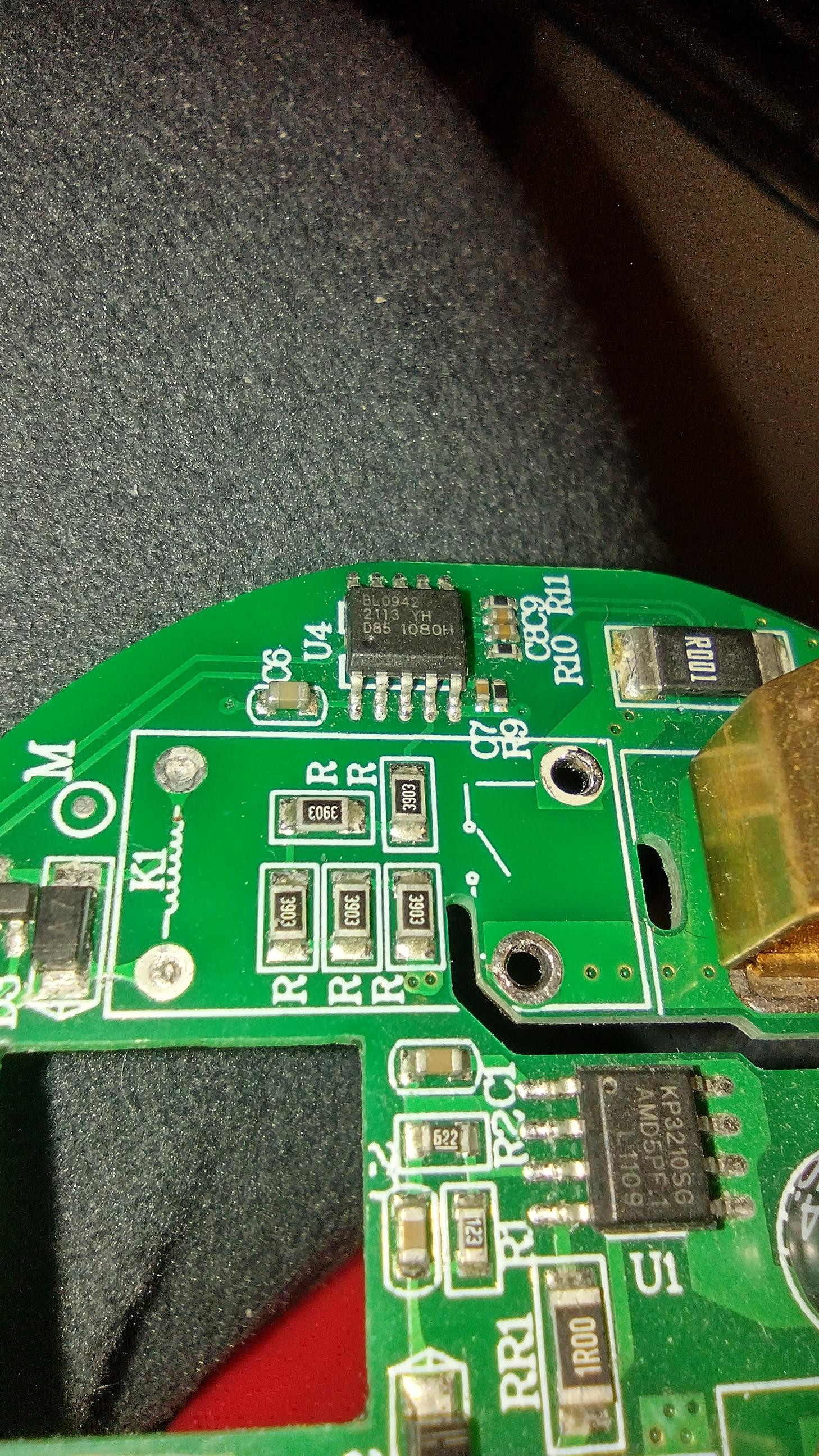

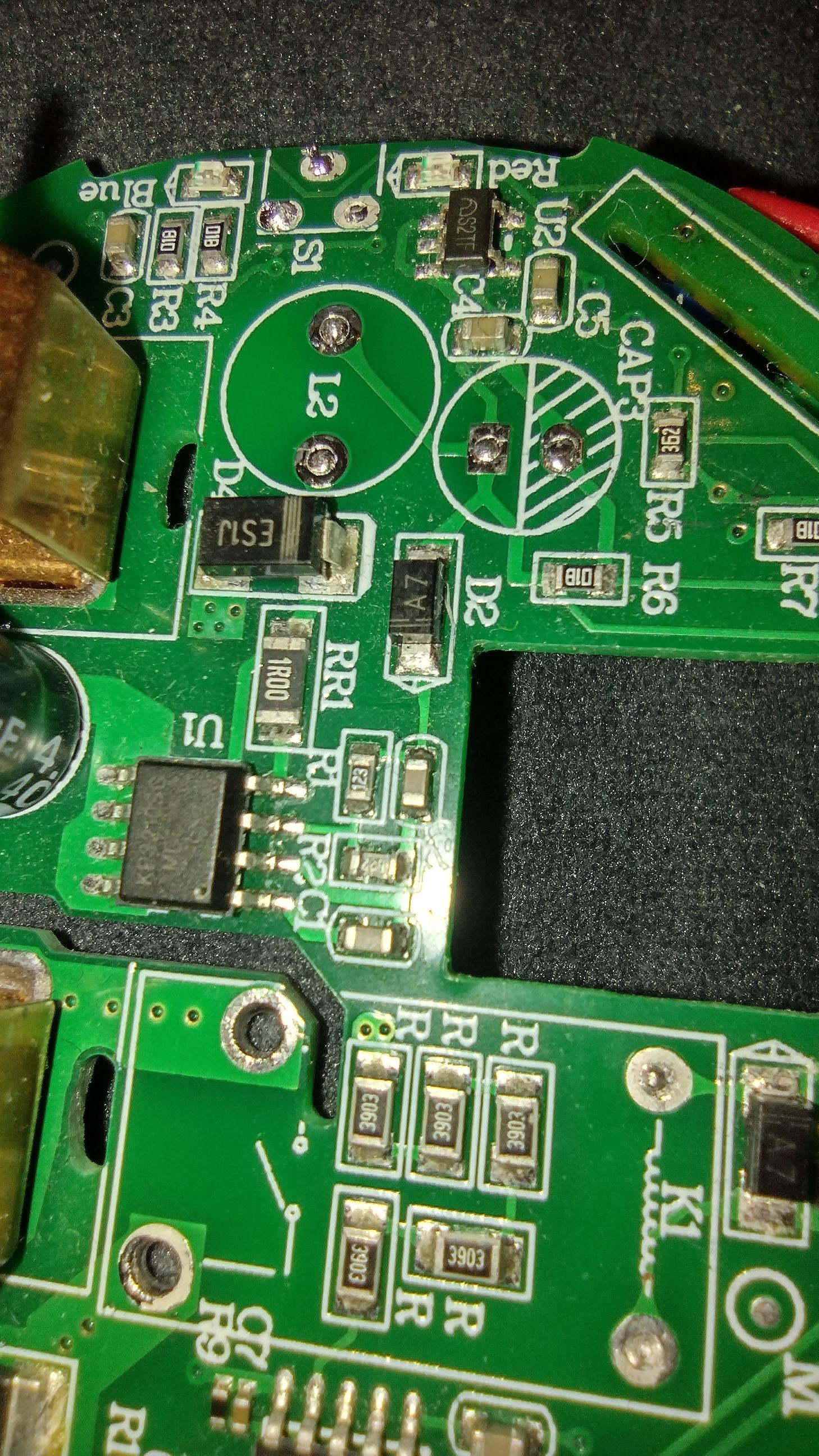

  • Tare down of LSPA7 tuya smart plug.
    I purchased 2 of these things, they both lasted about a year before the stopped working. so before knowing about this site i started taking things apart and unfortunately broke a pad off the CB2S (BN7231N) module.
    i've gathered all the info i can see the images of various steps along the way.

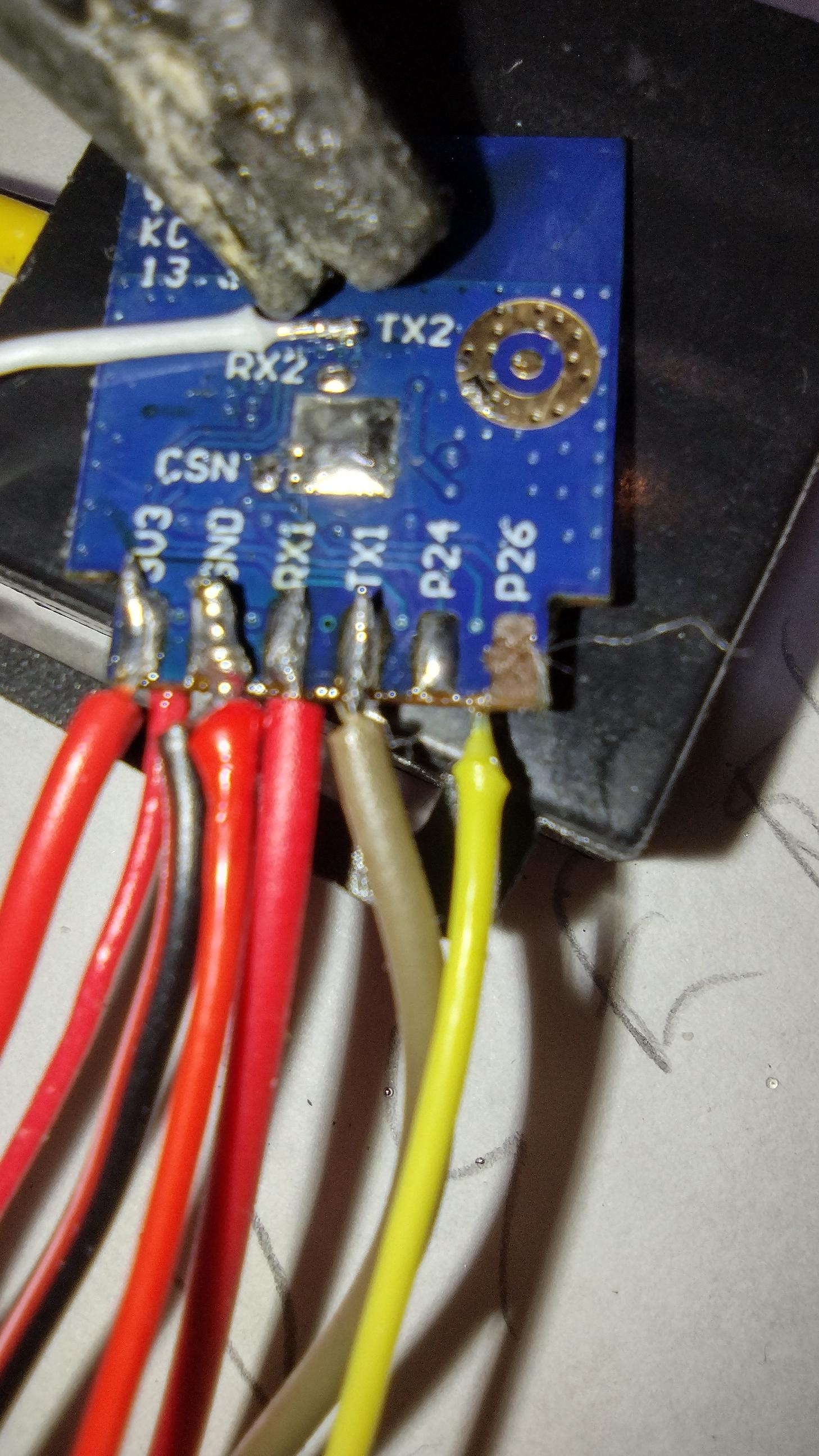

    I have included a few of the programer i used the 'USB to UART Convert and USB to TTL RS485 RS232 3.3v 5v Output 3 Multifunctional Functions USB Serial Adapter Module CP2102' its able to provide enough power for the CB2S through the entire flashing process.
    I used BK7231 GUI Flash Tool very easy to use i just spun up a vm of windows to flash the CB2S.
    The LSPA7 smart plugs reports current use via the (BL0942) and also had a relay. The only other chip on the board is KP3210SG chip as I think the power supply. maybe 10vdc.

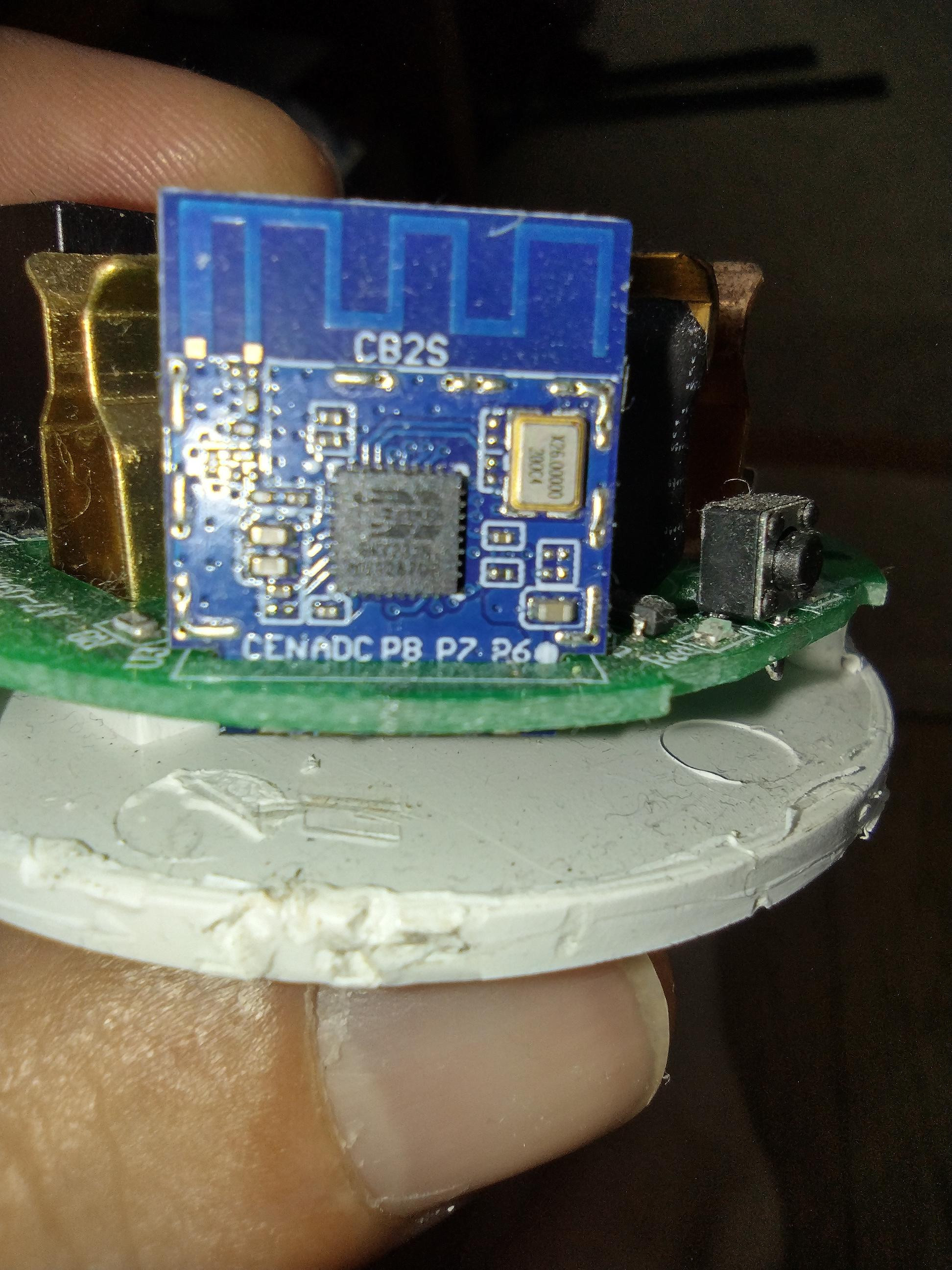

    - Button (channel 1) on P6
    - WiFi LED on P8
    - Relay (channel 1) on P26
    Device seems to be using CB2S module, which is using BK7231N.

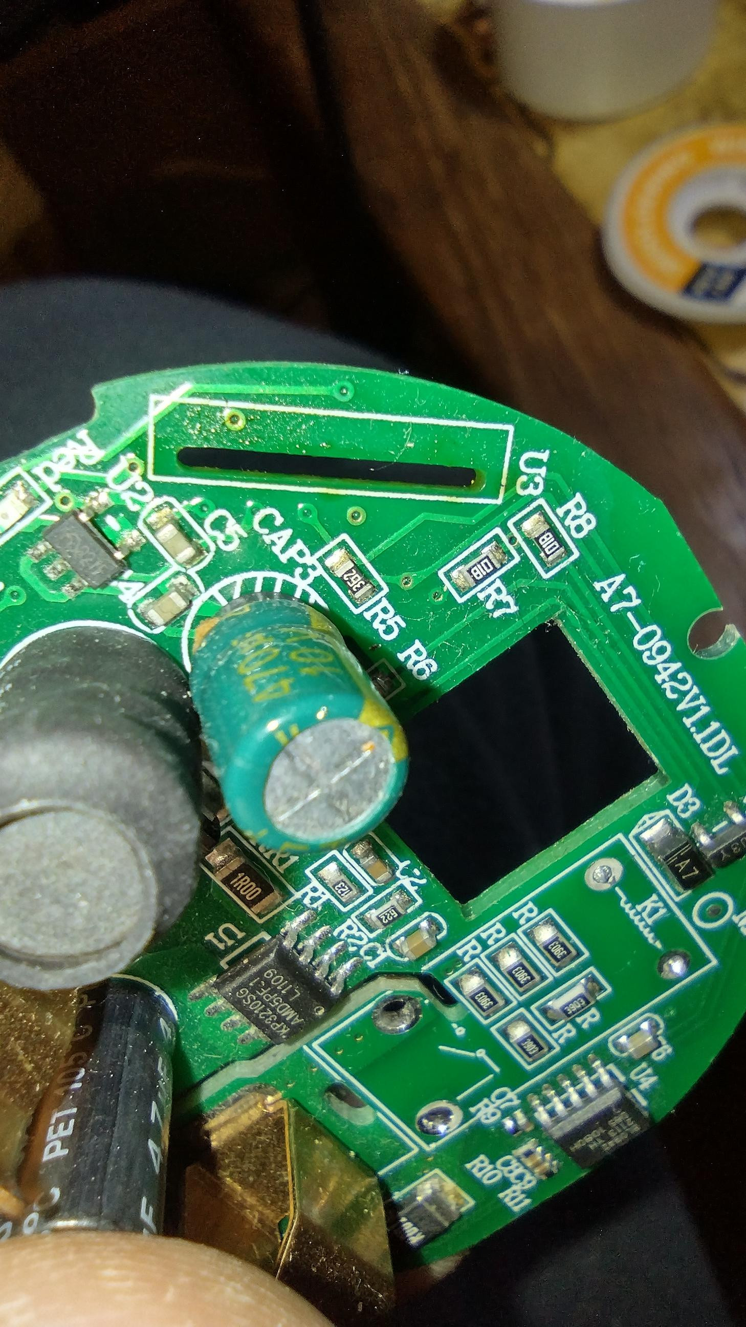

    Which pad of CB2S is broken, maybe we can fix it?
    Judging by the voltage of the relay, I would guess it's using 5V power supply, then it uses LDO to get 3.3V for WiFi module
    Here is OBK template:
  • #3 20935758
    electrikphone
    Posts: 8
    I broke p26 pad off :-( the one for the relay.
    The OBK template is missing the details for the BL0942, isn't it?
    I did think I could just move the relay in software to p7 as it doesn't look like it gets used, then put it back with a link wire.
  • #4 20936155
    Posts: 14583
    Help: 654
    Rate: 12607
    All required BL0942 details are in the template. BL0942 is always on UART1, so there is no need to select GPIO for that. You just need to start the driver.
    Yes, you can route relay to P7, it's a good solution.
  • #5 20936819
    electrikphone
    Posts: 8
    I used P7 for my relay pin assignment and it worked just fine.

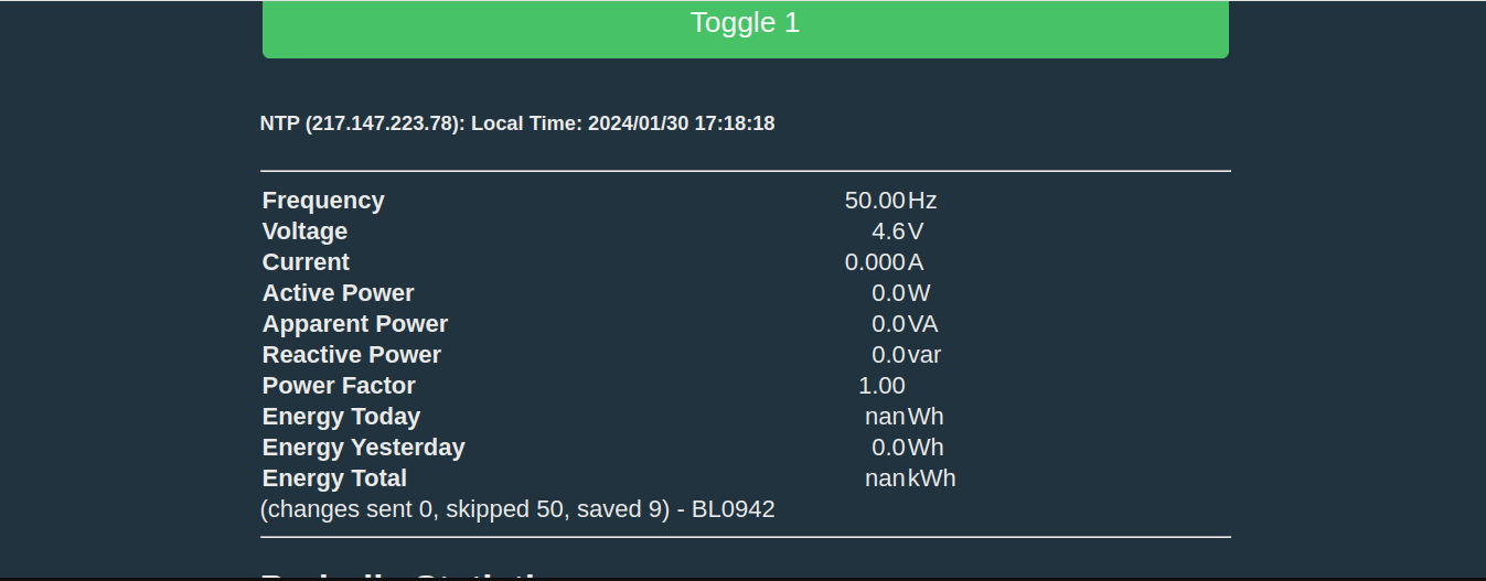

    What are the minimum values the BL chip can read?
    I am currently running the whole thing from a 5vdc source and I see the 5v on the index page. However, how do I get it to display the current usage?
    The load is a 5v water pump running at 0.300 Amps.
    What command do I issue as this didn't work?
    VoltageSet 0.1, CurrentSet 0.1, PowerSet 0.01
