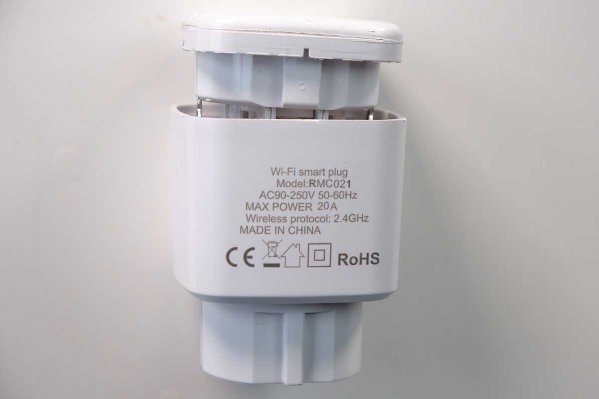

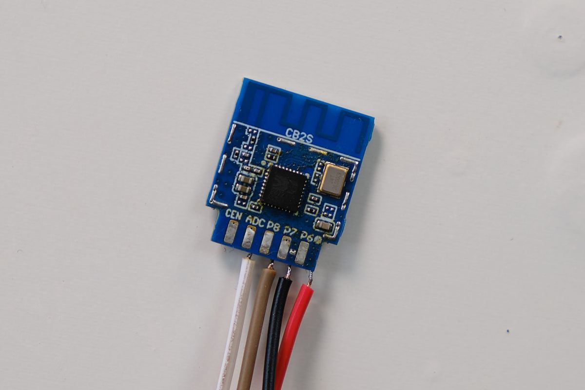

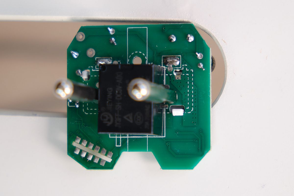

    I bought this smart plug for very cheap in a big chinese online warehouse.
    Close-up of the back of a Wi-Fi smart plug with technical details and certifications.
    I disassembled it and figures out it has a BK7231N / CB2S chip. And a BL0937 for energy measurement.

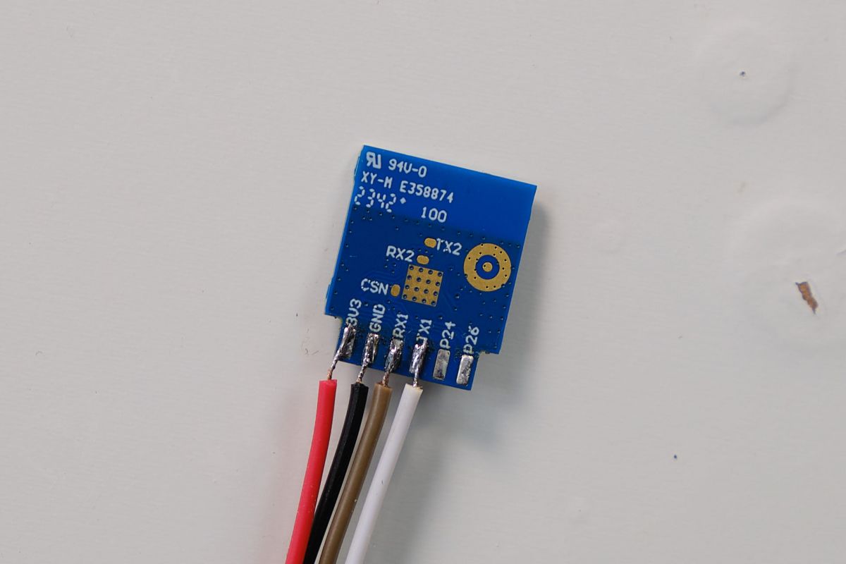

    I tried to commuincate with the CB2S still in place. But it turned out that the switch and some stuff interfered with the RX path. I didn't want to cut any path so i desoldered the whole CB2S. Flashed it seperately. And but everything back together.
    I flashed the version 1.17.493 with Easy UART Flasher.
    CB2S module with connected wires Close-up of a blue electronic module with attached wires. View of a smart plug circuit board with electronic components. Close-up of the internal components of a smart plug with a visible integrated circuit.
    I also dumped the orignial firmware. readResult...-39-15.zip (1.06 MB)You must be logged in to download this attachment.

    Device seems to be using CB2S module, which is using BK7231N.
    I already setup OpenBeken to connect to my local wifi network and i was able to load the driver for the BL0937. Calibration for Voltage was no problem. I am not sure how to calibrate current and power without electrocuting myself ;) But so far my 60W heating bulb shows 60W and my 7.5W LED bulb shows 7.5W. So i guess it is accurate enough :)

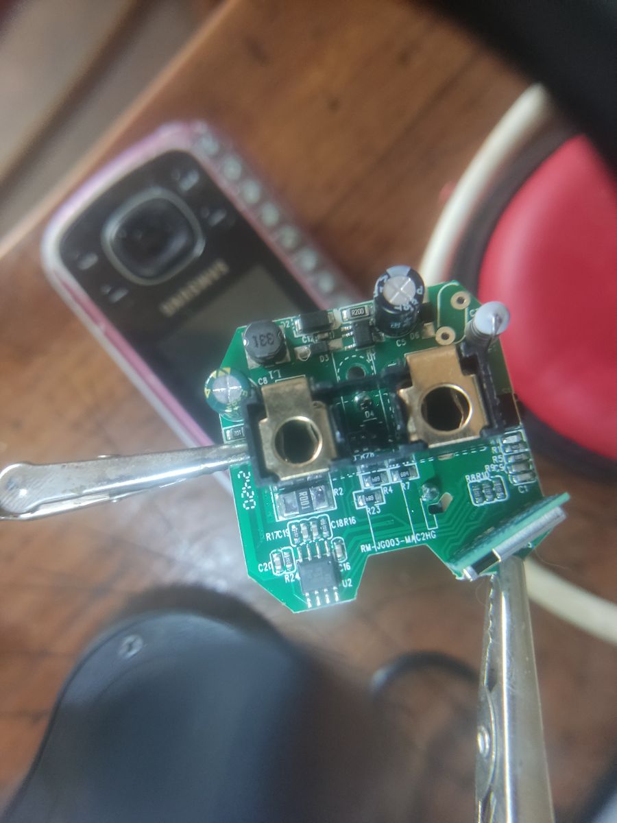

  • #6 21068306

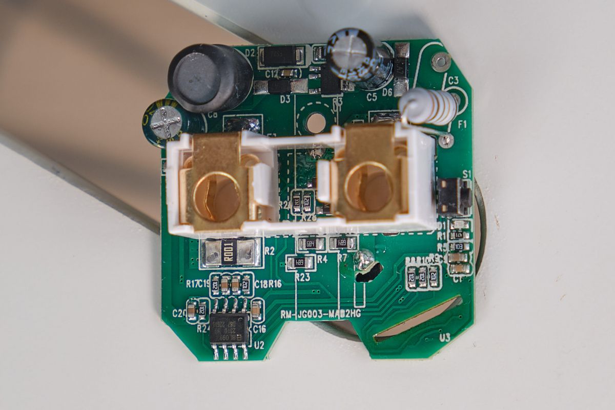

    150219v8
    Posts: 46
    Here you can see an easy way to open this kind of device.
  • #7 21068364
    Posts: 14782
    Rate: 12920
    Opening LSPA9 plug with a door, that's a very unexpected but yet also interesting thing to see

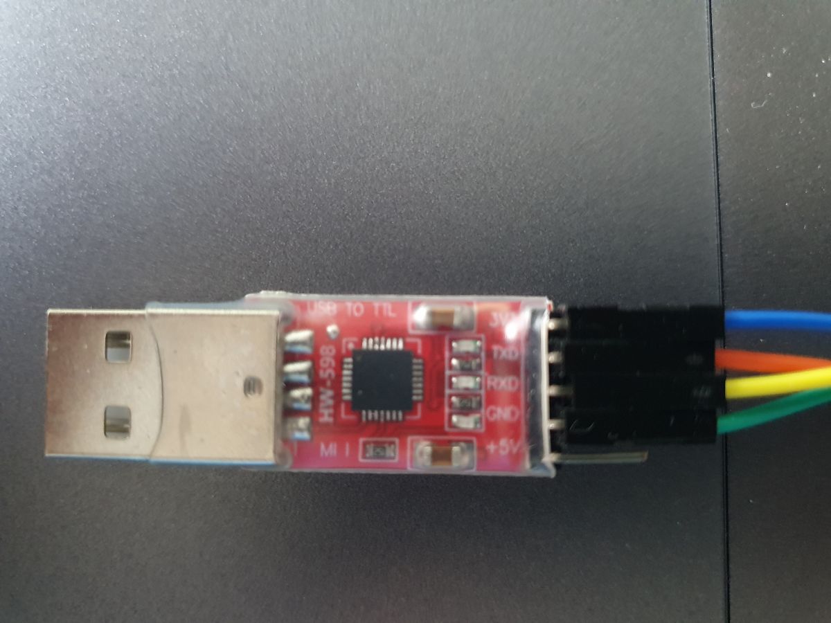

    tun0
    Posts: 12
    Out of curiosity: how did you manage to desolder the CB2S module? I tried to do so on 2 out of the 5 I ordered, and managed to lift at least one pad before getting any movement in the CB2S module. Tried adding flux, adding solder, solder sucker, solder wick and now running out of ideas. Even though these are darn cheap, ruining them still seems like a waste.
  • #15 21109289
    Posts: 14782

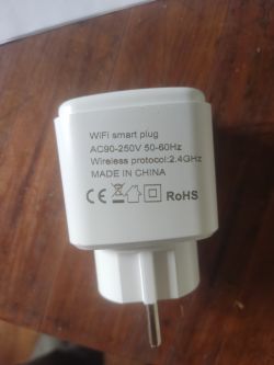

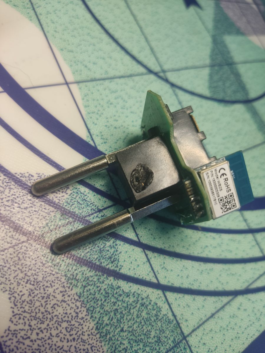

    gregmarfaing
    Posts: 16
    I got a variant with a wb2s inside from aliexpress
    Electronic module of a smart plug from AliExpress on a wooden background. White smart plug with technical markings, lying on a wooden surface. Close-up of an electronic module with a JIEYING integrated circuit mounted on a green PCB, held by a metal tool. Close-up of a PCB with electronic components.
    It's a RMC-001 according to the manual
    and here is the template

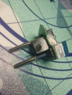

    #21 21144039
    gregmarfaing
    Posts: 16
    >>21140313
    thanks, I just have a problem with one of the 3 plugs i bought: the power output doesn't work, i mean i can clearly hear the relay being triggered on/off but no power output at all. other than this it's working perfectly so i'd just like to know if there is a way to fix or if it's too bothersome
    just forgot to add that i damaged it a little while soldering with my little brother: Damaged electronic plug with visible soldering mark.
    would this be enough to break it?
  • #22 21144189
    Posts: 14782
    Rate: 12920
    It seems that your relay is damaged. You can consider replacing it.

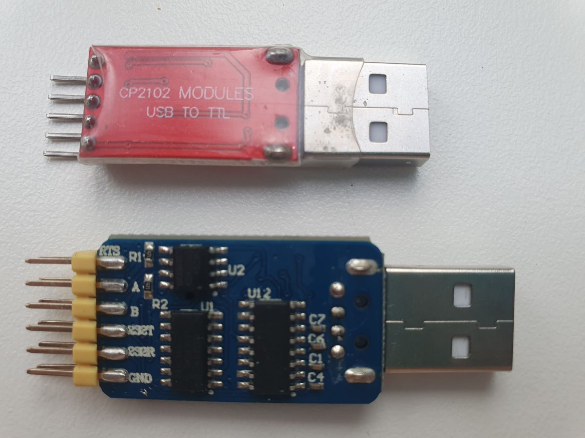

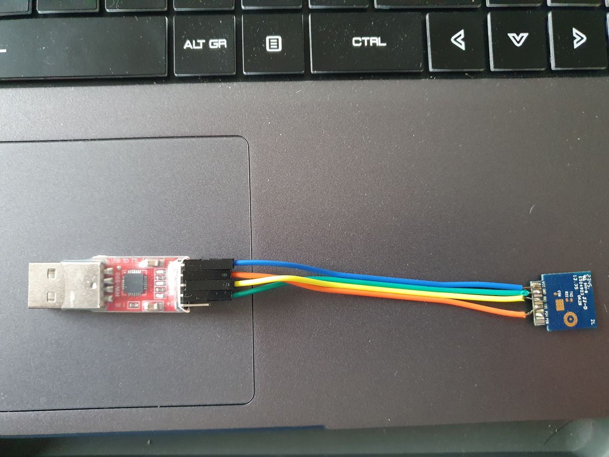

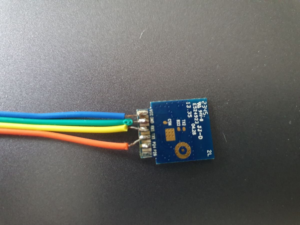

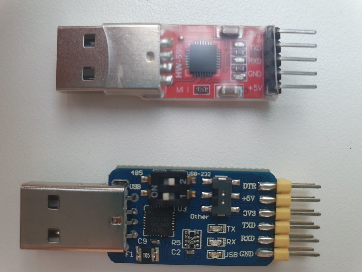

    Posts: 12
    Today I gave it another try with a fresh cp2102. However, I'm getting the same results: not being able to "get bus".
    USB to TTL adapter with wires connected to a module on a laptop keyboard. USB adapter with black, red, orange, yellow, green, and blue wires. Electronic circuit with attached wires in blue, green, yellow, and orange colors.
    Guess there's not much left other than trying to see if the cb2s still functions as part of the socket. Or, do yet another attempt at desoldering using another socket.

    it looks like your RX on module goes to RX on USB-TTL. It needs to be RX->TX, TX->RX, swap them at usb end.
  • #26 21147726
    Posts: 14782
    Rate: 12920
    What kind of LDO is used on this device? I don't think it can provide enough current. How do you reboot device? By disconnecting VDD?
  • Recommend a USB-UART adapter and VDD reboot method
    #27 21147776
    tun0
    Posts: 12
    I tried with both RX-TX/TX-RX and RX-TX/TX-RX. Do see a slight difference in behavior of the LEDs, but not really obvious enough to tell which one's correct. One of the earlier posts did mention RX-TX/TX-RX though.
    Good question, no idea really. Do you have a recommendation for a suitable USB to UART device?
    And yes, disconnecting VDD.
  • #28 21147801
    Posts: 14782
    Rate: 12920
    Ok first, can you show us the second side of your USB to UART covnverter? Is there any LDO at all?
  • #29 21148187
    tun0
    Posts: 12
    The one I tried yesterday (red) appears to be very simple with nothing on the bottom. The one I tried before (blue) is quite a bit more complex:
    Two USB adapters on a white background. The top adapter is red, the bottom one is blue. Two USB-TTL converter modules, one red and one blue, on a white background.
  • #30 21148728
    Posts: 14782
    Rate: 12920
    None of those look promising. Still, what are those 3 soic chips at the bottom of the blue one?
