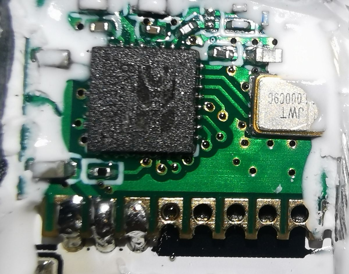

    Stage 0 - hardware interview

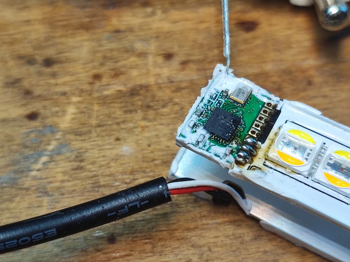

    The reader initially already reported that the SM15155 is used in the lamp with the BK7231N module. Additionally, he noted that it is connected to P16 of the BK7231N, this pin is known to be the data output of the hardware SPI port:
    Close-up of an integrated circuit on a printed circuit board. .

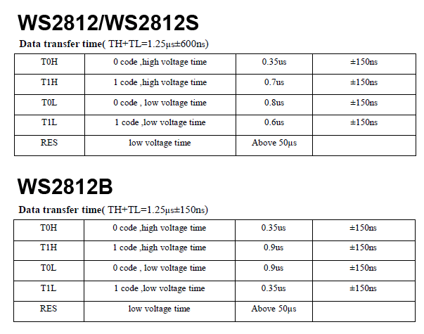

    The other two pins in the picture are ground and power.
    This has already lit the green light for me - this is probably a WS2812B style controller. The WS2812B also uses P16, as it too is controlled by a single signal that requires very precise timing. It's hard to get such timings in software, so a clever use of the SPI port is often made - choosing the bits of the bytes sent so that they form the signal expected by the WS2812B:
    Comparison table of communication protocols WS2812/WS2812S and WS2812B. .
    At some point, I will also address this topic separately.

    The reader then shared with us just the batch from the WiFi module from inside. There was a BK7231N in there. We simply uploaded this batch to one of our modules with P16 out:
    How to access the hardware SPI port on the CB2S? We solder P16 (MOSI) to the QFN .

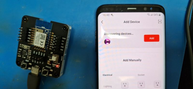

    We used our BK7231 development board for this:
    [Youtube] How to make a BK7231 development board - NodeMCU ESP8266 conversion

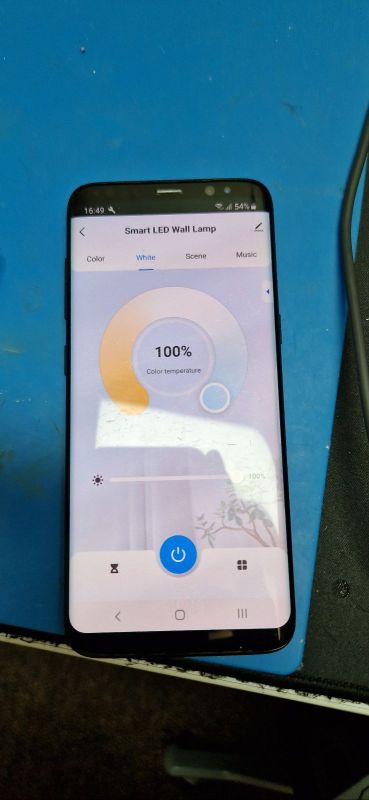

    We managed to pair this with Tuya:
    CB3S module connected to a computer and a smartphone with a device-adding app .
    Smartphone displaying an app for controlling a smart LED lamp, showing color temperature settings. .
    We started to control the 'lamp' via the Tuya app, setting different colours and at the same time capturing data on P16 with our Sigrok analyser:

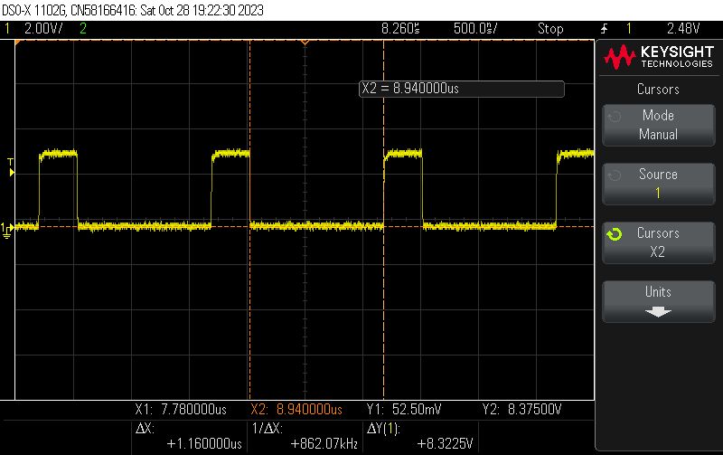

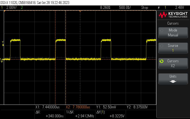

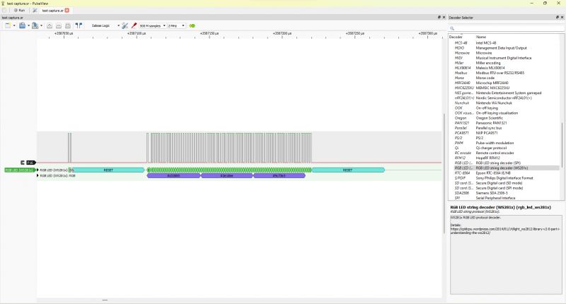

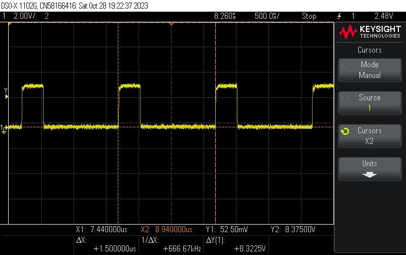

    A glance with an oscilloscope already shows the timings:
    Screenshot of a digital oscilloscope showing a square wave signal. Oscilloscope displaying a square wave signal with time and voltage parameters. Screenshot of a digital oscilloscope displaying a square wave signal. .
    High state 340ns, low 1.16us, this is reminiscent of the WS2812B. Not ideal, but maybe...
    The PulseView analyser, on the other hand, showed that although the timings resemble the WS2812B, the number of bytes seems to be different. Also, the meaning of the bytes themselves seems to disagree.
    Screenshot from PulseView software showing an analysis of an RGB LED (WS281x) signal using a decoder. .

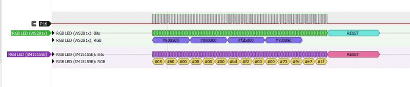

    Step 2 - first impressions of the protocol .
    Due to the suspicion that this is essentially the same way of communicating as the WS2812B (similar timing) but a different meaning of bytes, I modified the WS2812B PulseView decoder script so that it decodes separate bytes:
    Code: C / C++
    Immediately better:
    LED signal graph with color coding for WS281x and SM1515E LEDs. .
    You can see that the frame is 14 bytes long.
    Now you can collect some data....

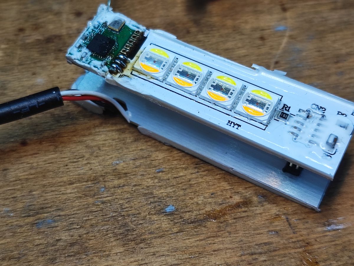

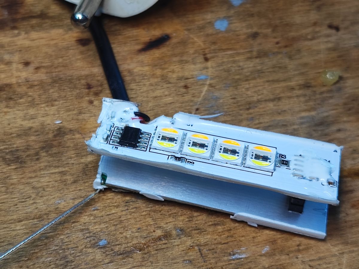

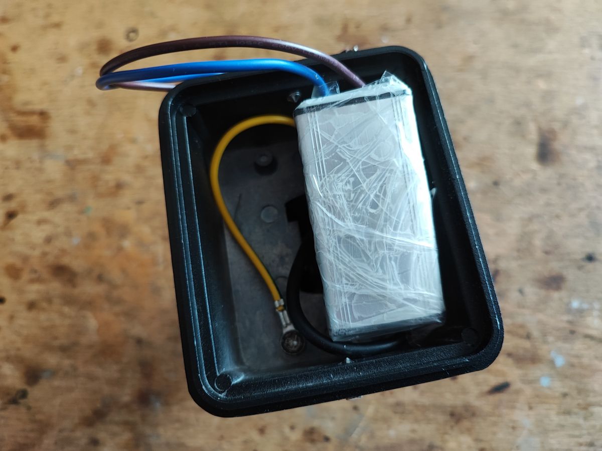

    Step 4 - lamp in practice, WiFi module

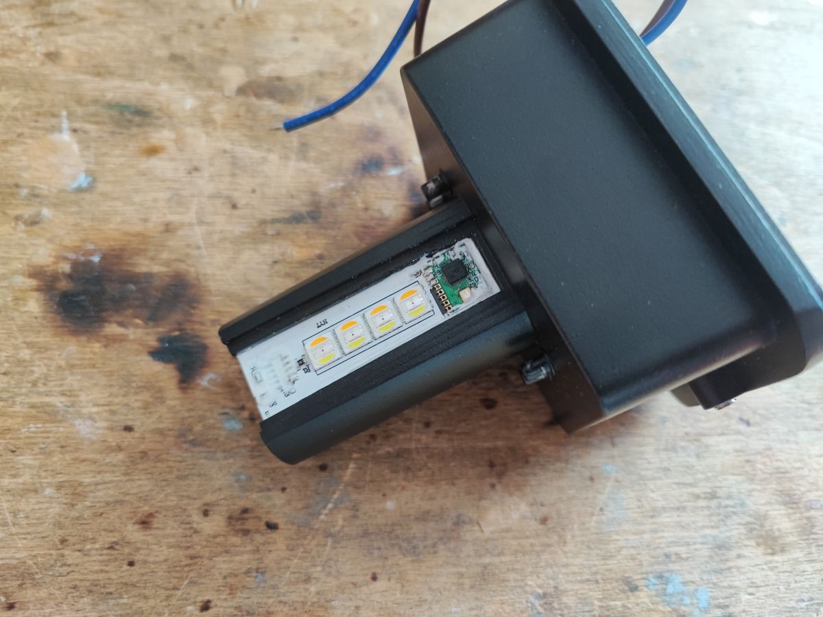

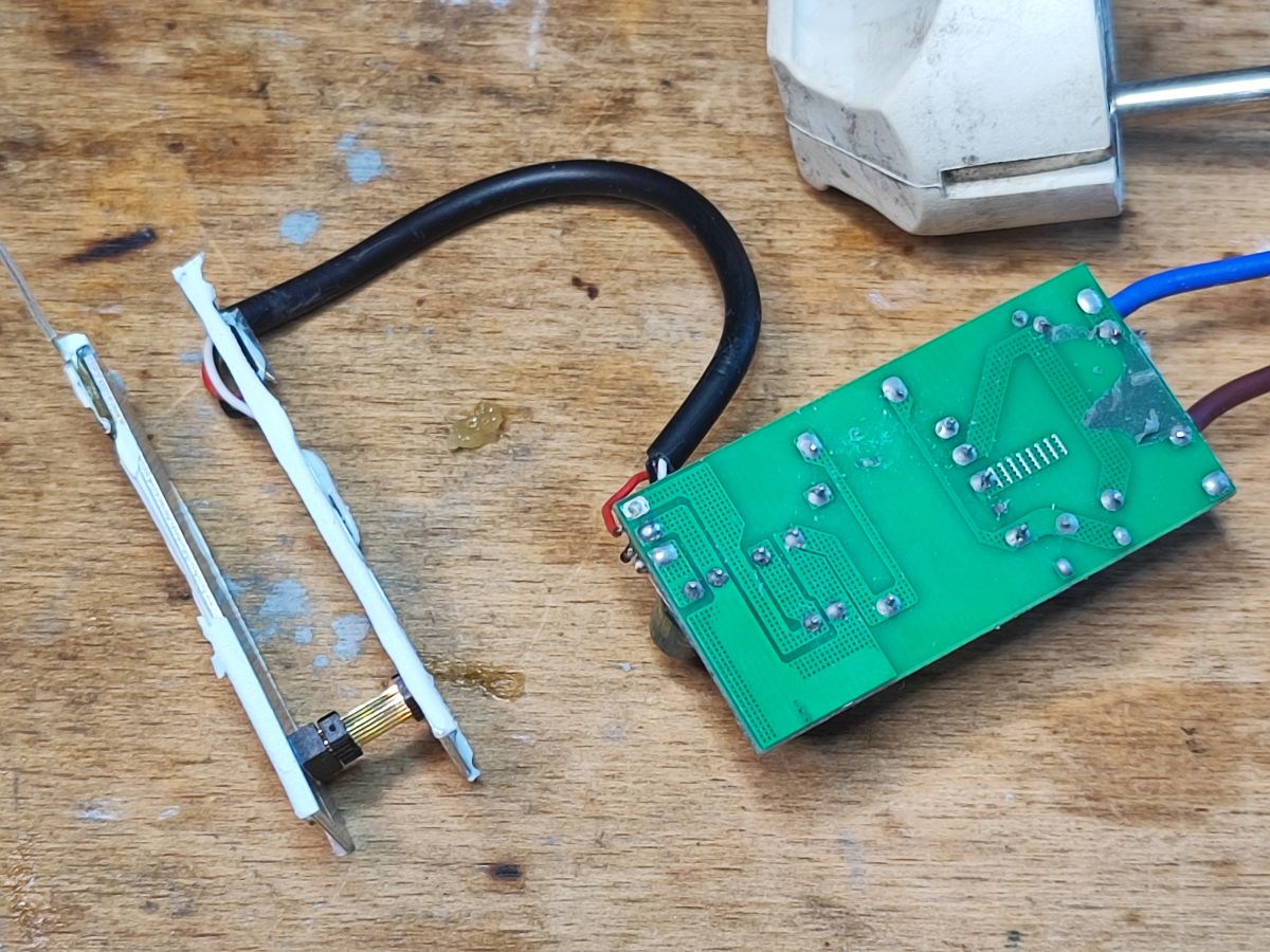

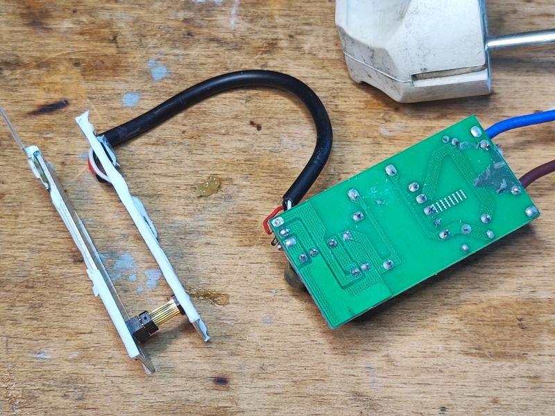

    At this stage it would be useful to have this lamp physically at home. Remotely it is difficult to test it. Fortunately, there was an option here too - just a reader sent me this lamp. Due to transport costs, I received the base alone, without the lampshade:

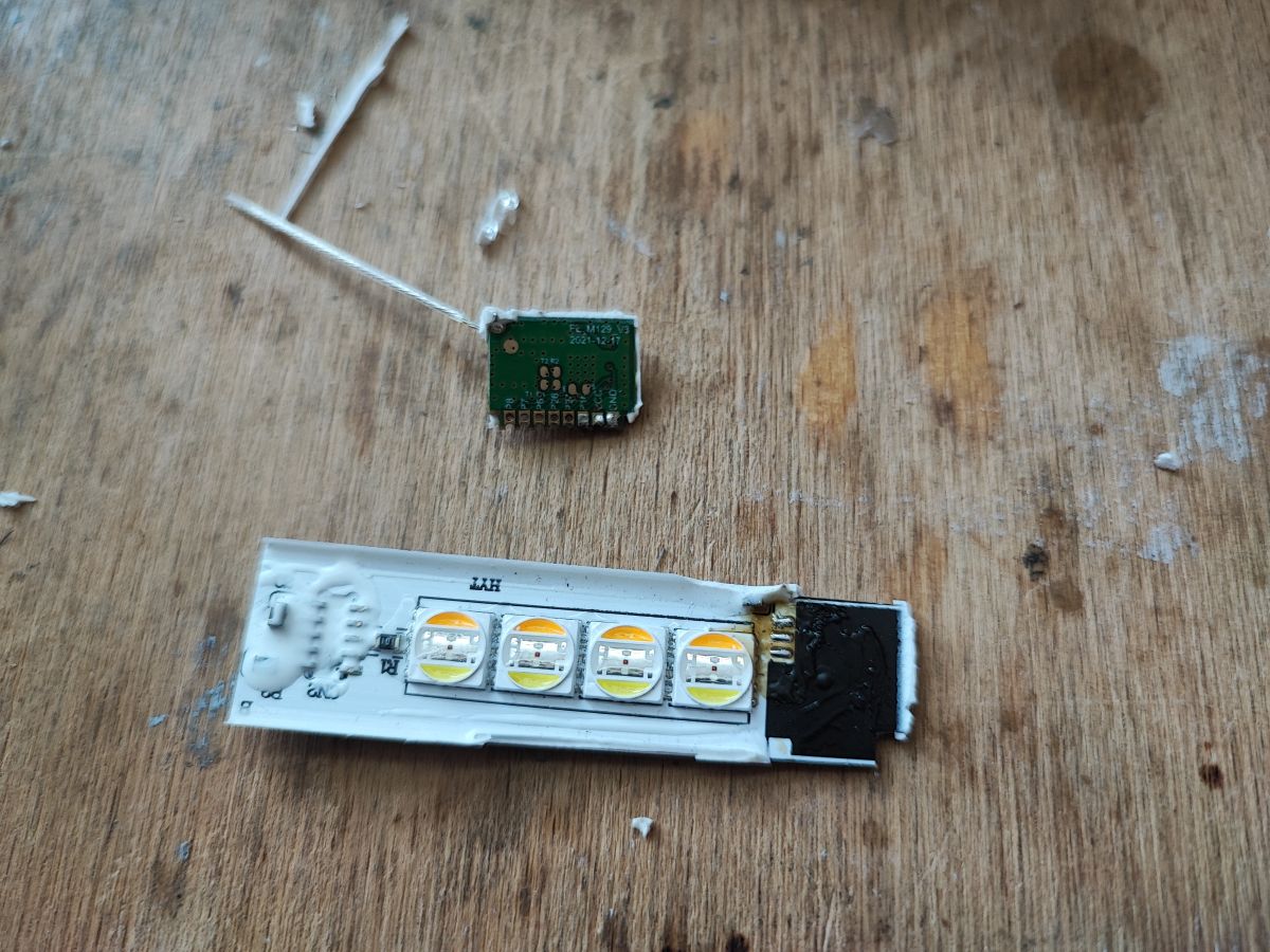

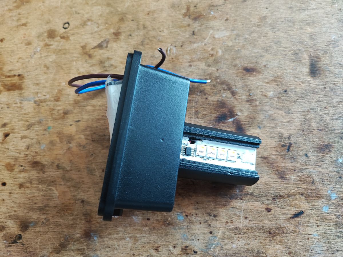

    Electrical enclosure with installed LEDs on a wooden table. View of module interior with wiring and wrapped component. Interior of a black smart lamp with visible LED diodes on a circuit board. .

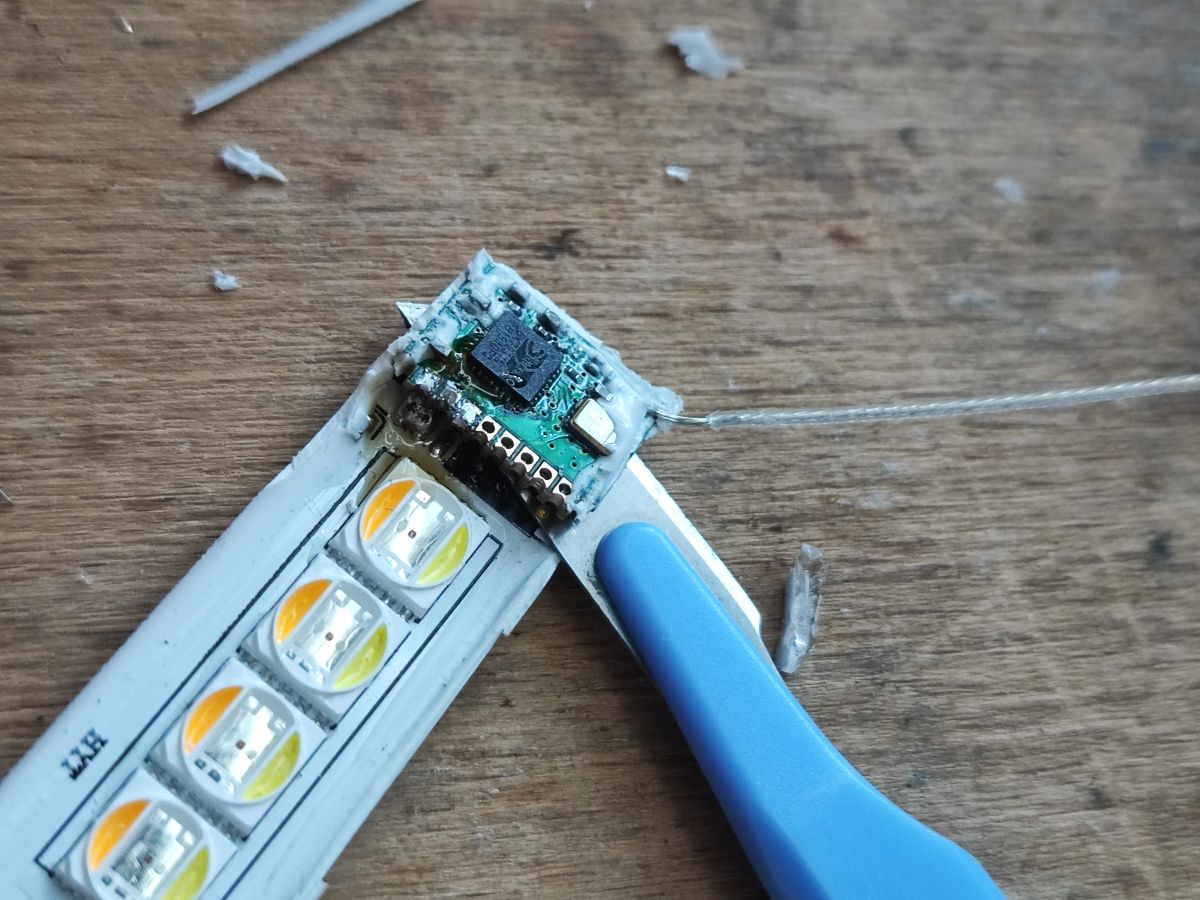

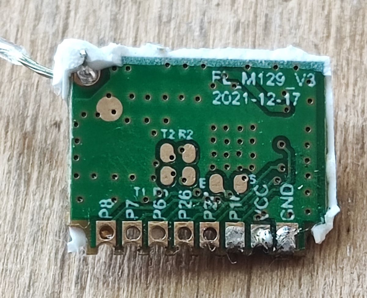

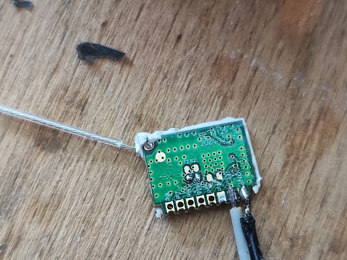

    I quickly took to disassembling the whole thing, also to check what kind of WiFi module was sitting there. Neither of the two LED boards were firmly glued to the rest of the lamp, and the module was easily soldered off too:
    WiFi module and LED board on a wooden surface. LED board with connected electronic module and tool on wooden surface. .

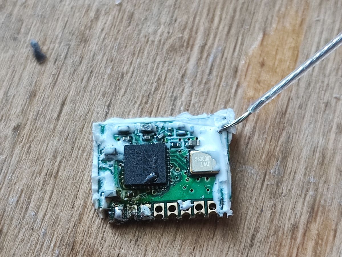

    The WiFi module is FL_M129_V3 (BK7231N), dated 2021-12-17, and was worth soldering as it has signed leads on the underside:
    Back of WiFi module with pin designations WiFi module on a wooden surface. .

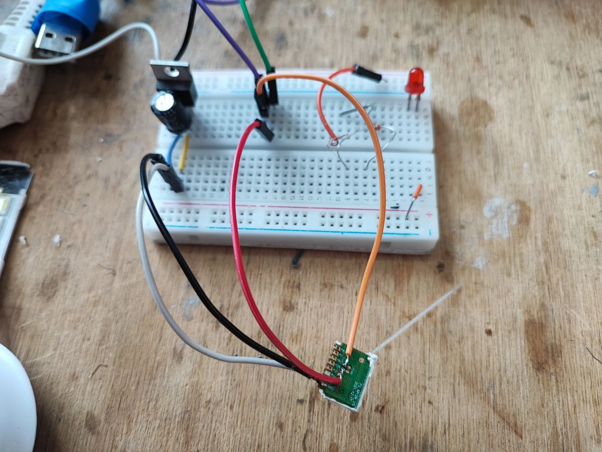

    I started by changing the batch. I uploaded my OpenBeken in there:
    According to the flasher instructions:
    Close-up of a circuit board with visible connections and soldering .
    In the photo above you can see where the power (3.3V), ground, RX and TX are.
    Flashing:
    Breadboard with an electronic circuit connected to several wires. .
    Circuit assembled for test, without cooling (you have to be careful with this to avoid overheating the LEDs):
    Disassembled power supply unit and LED module on a wooden table. Close-up of a lamp's electronic module with LEDs. LED module mounted on a white base. 1fcb1fc29f Electronic board with LEDs and an integrated circuit on a wooden surface.

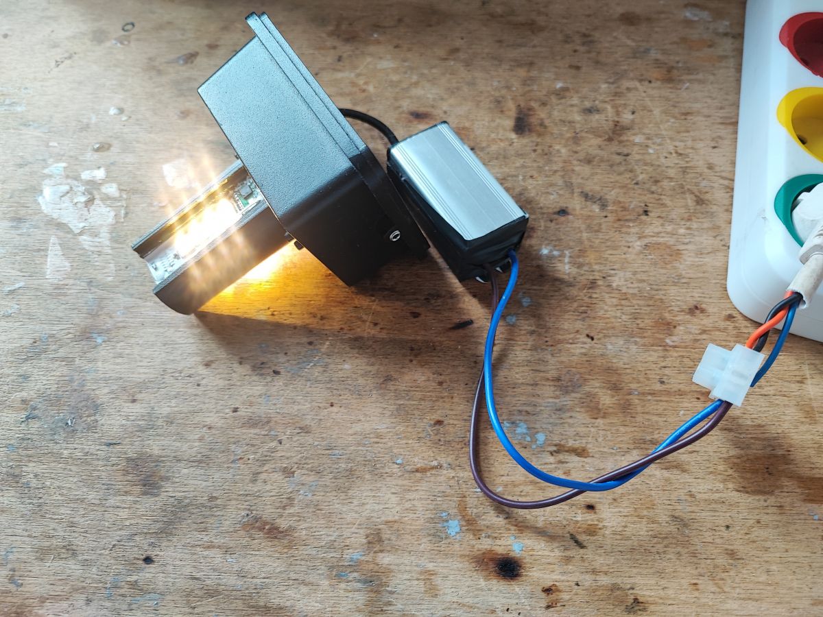

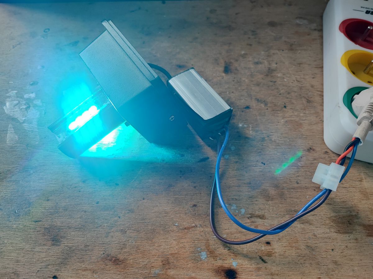

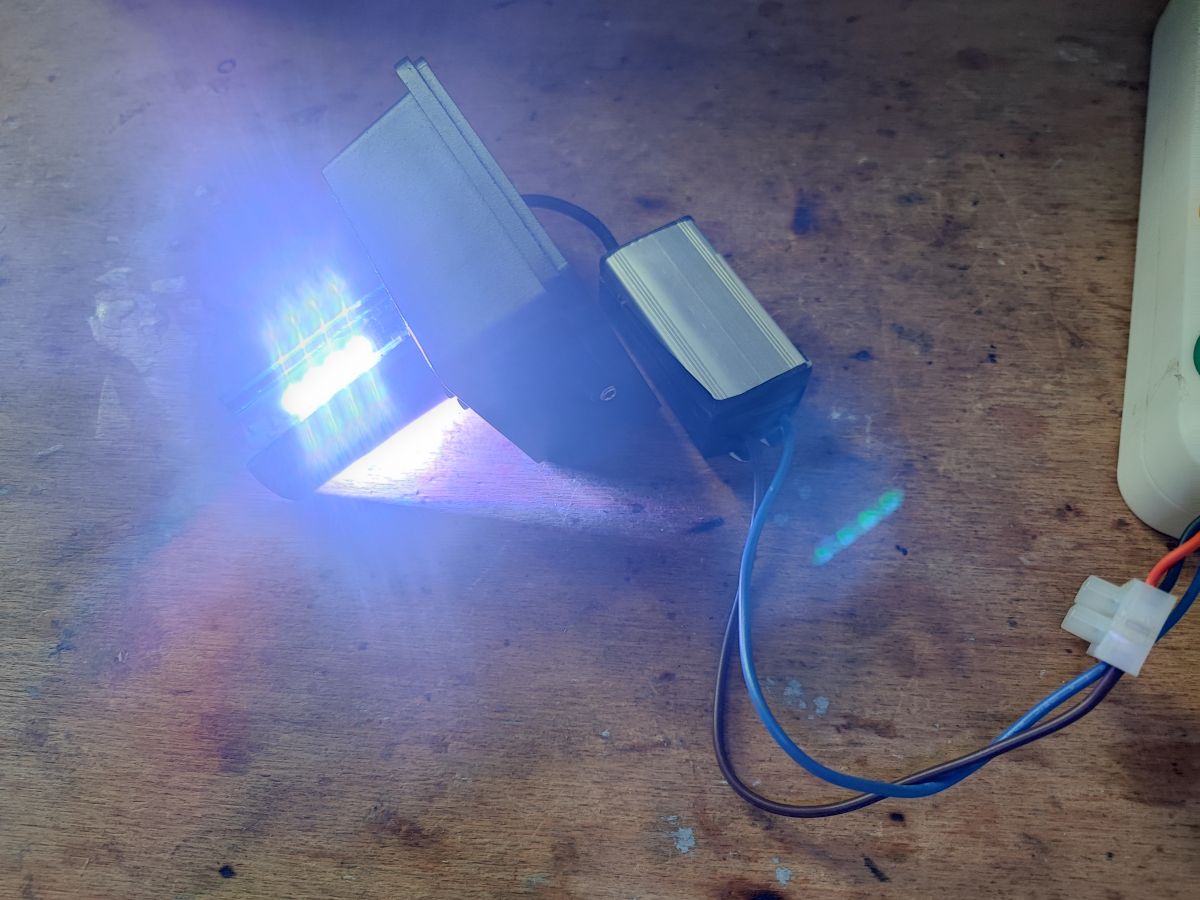

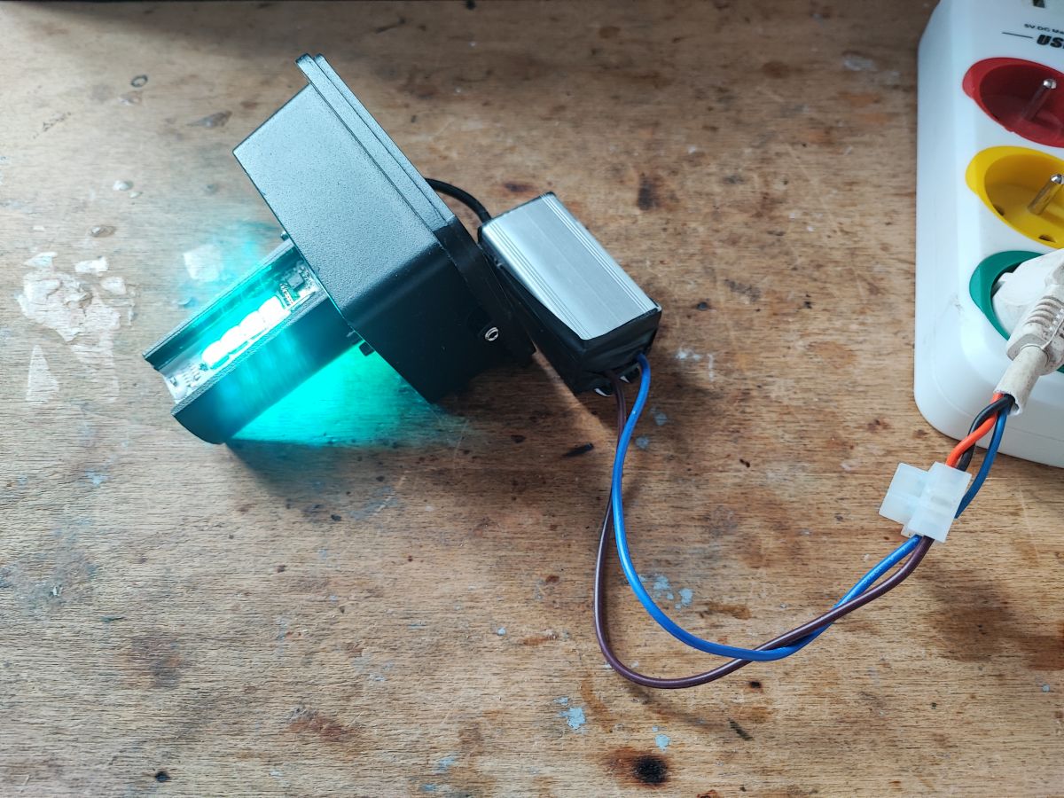

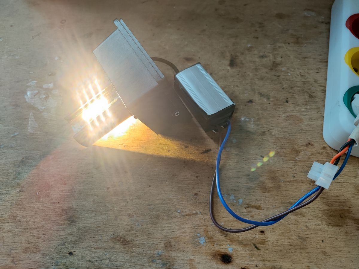

    Step 7 - final test .

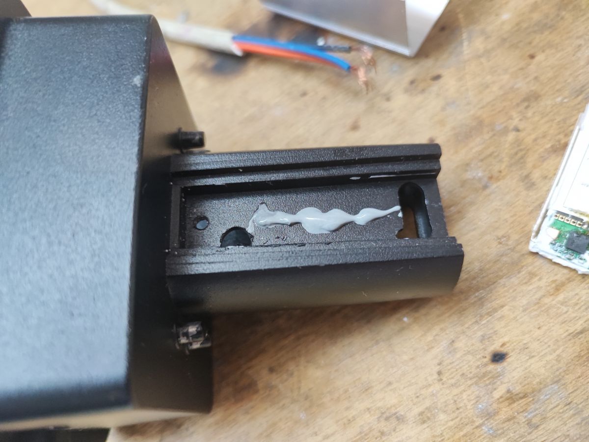

    Since the base works, the lamp can be put together. I took the opportunity to add paste between the LED plates and the metal housing:
    Black lamp housing with a layer of thermal paste on a metal base. .
    A short test and everything works:
    LED lamp illuminating a wooden surface. Wall lamp with open casing, connected by cable, emitting bright light. Lamp with connected wires on a workshop table. Preview module with green light on a desk Smart LED lamp emitting blue light on a wooden workbench. .
    The lamp now correctly displays the control panel on the OBK home page and can be paired with Home Assistant.

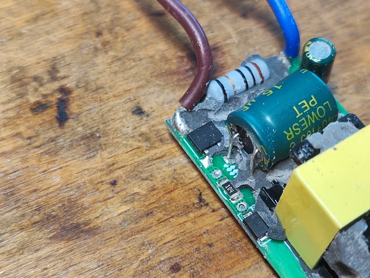

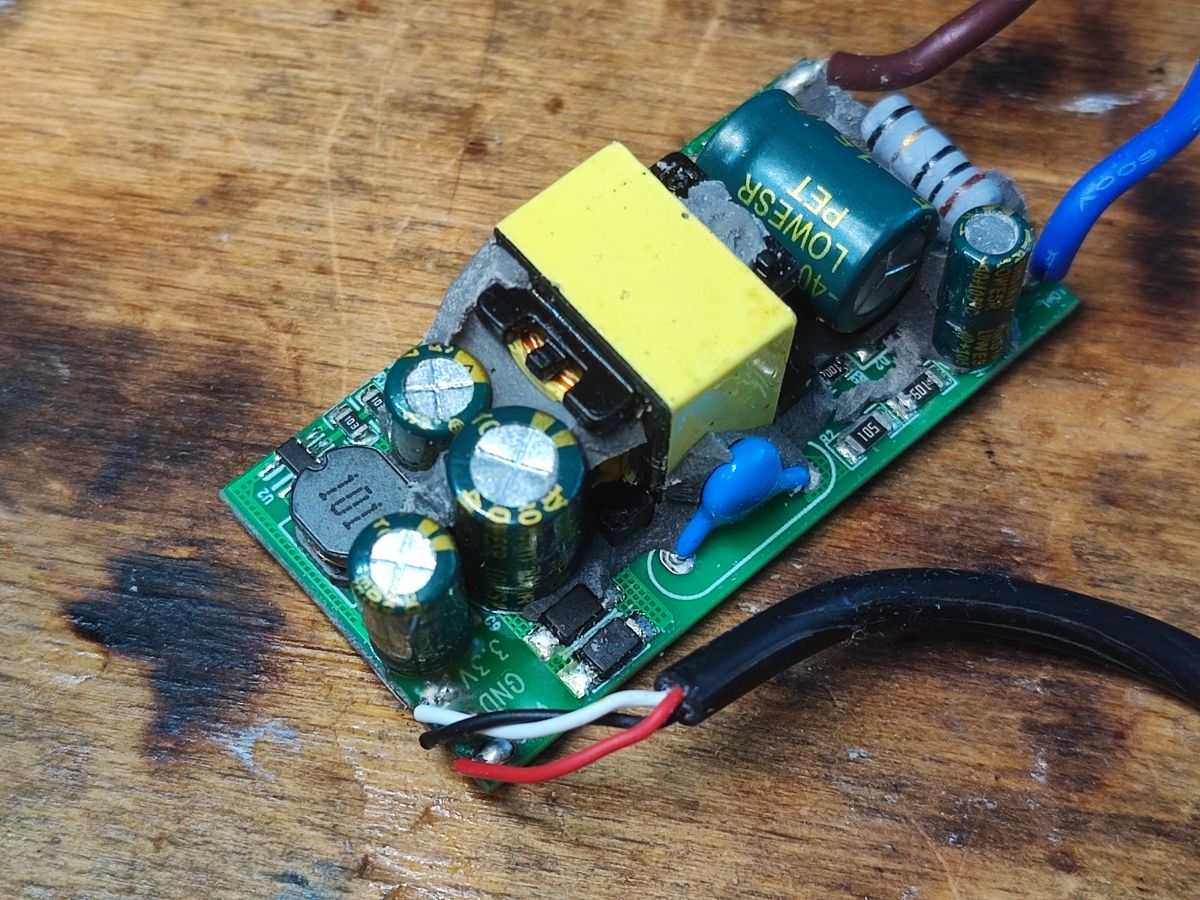

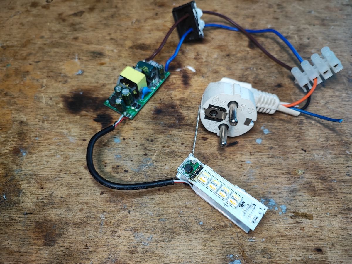

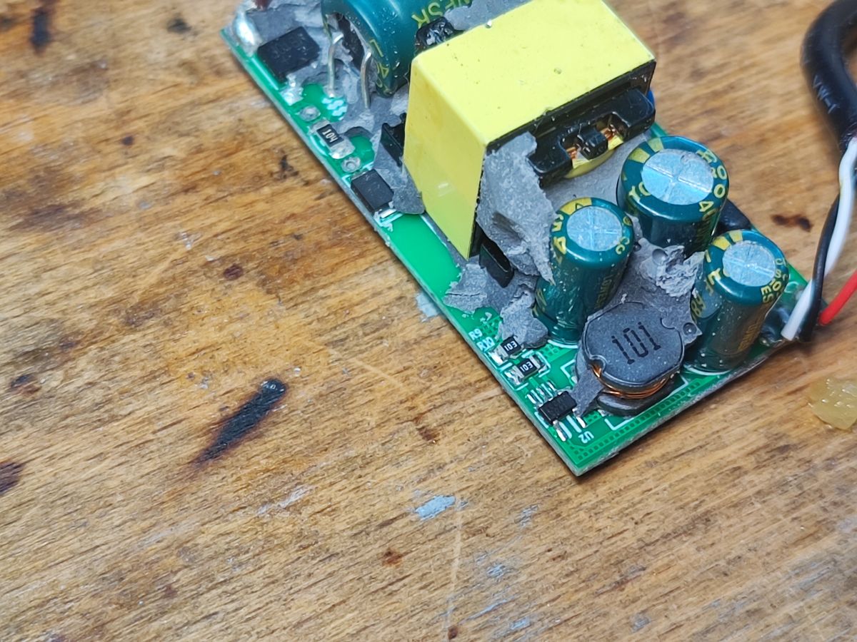

    Additional - power supply
    I took the opportunity to take an interest in the power supply module:
    Close-up of a power supply module with visible capacitors on a circuit board. Close-up of a power supply module on a wooden surface Power supply module with components on a circuit board Power supply module and LED circuit boards on a wooden table. .
    The power supply first creates the voltage for the LEDs, and then has a separate step down inverter on the secondary side generating 3.3V for the WiFi module. What exactly the flyback inverter controller is in there, I don't know.

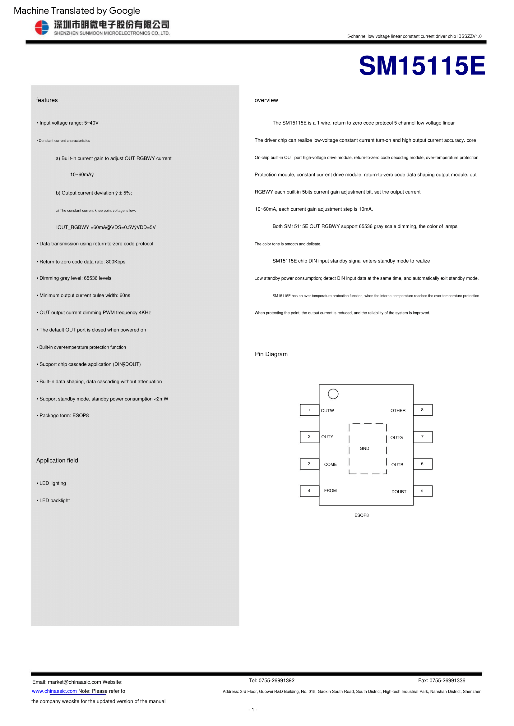

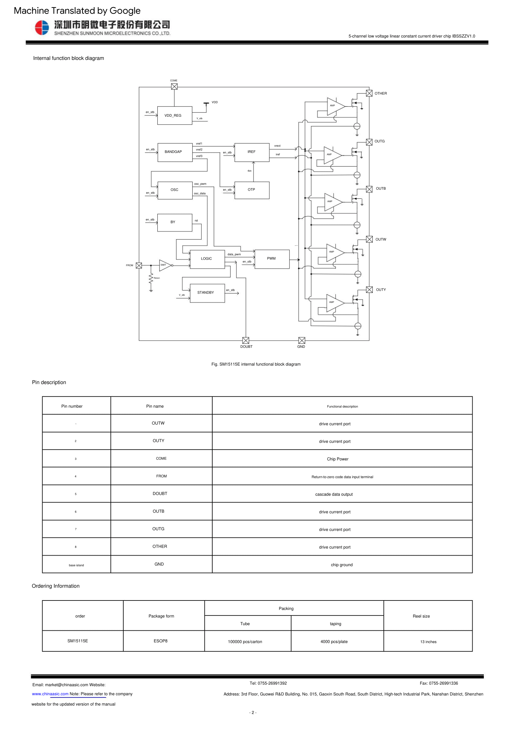

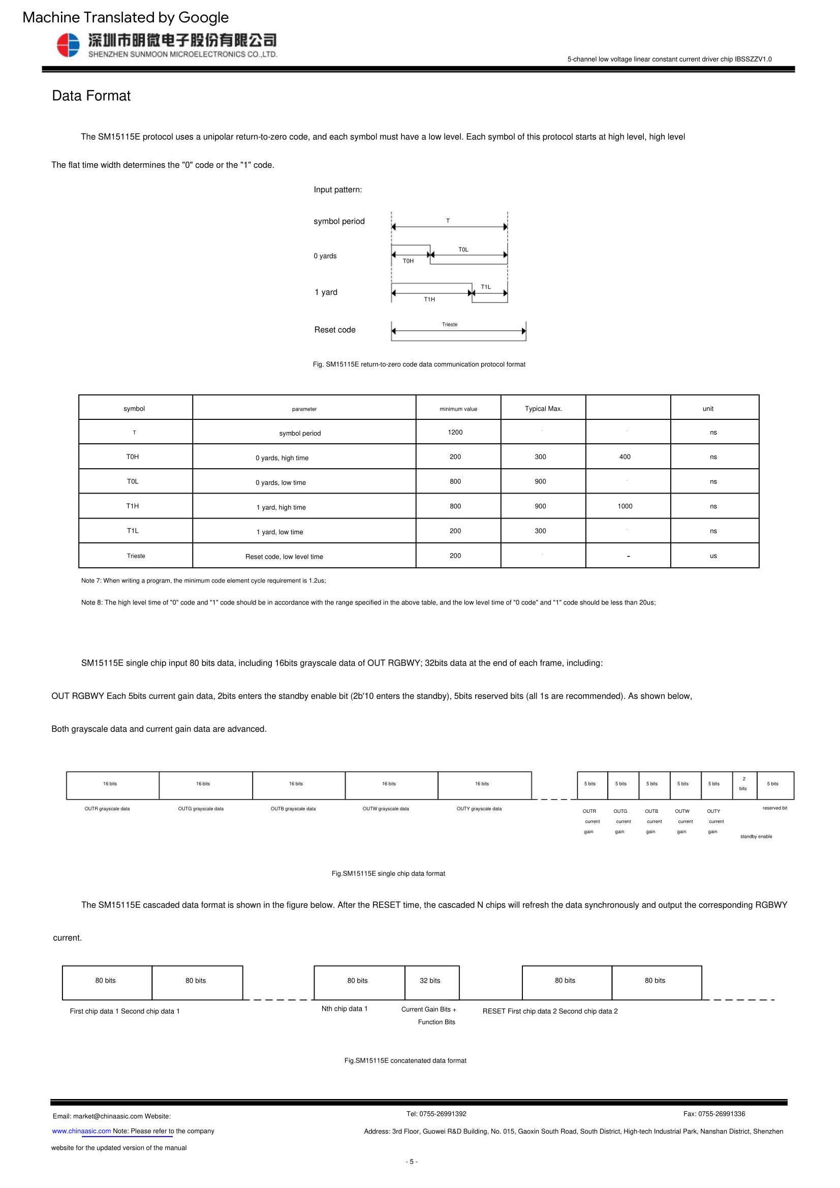

    Additional - catalogue note .
    There was no this catalogue note available online when my colleague @DeDaMrAz and I searched for it, but then someone at our forum specifically registered to share it with us. This might clarify for us the meaning of the last bytes.
    First page - general information. This protocol is called "1-wire, return-to-zero", I didn't even know. Operating on voltages from 5 to 40V. 16 bits of colour resolution (that's weird, I thought it was 8 though, I'll check it):
    Technical datasheet page for the SM15115E chip by Shenzhen Sunmoon Microelectronics. .
    And yet the SM15155 can be cascaded.
    Internal construction:
    Detailed internal function block diagram of the SM15155E chip. .
    There are five constant-current LED drivers inside.

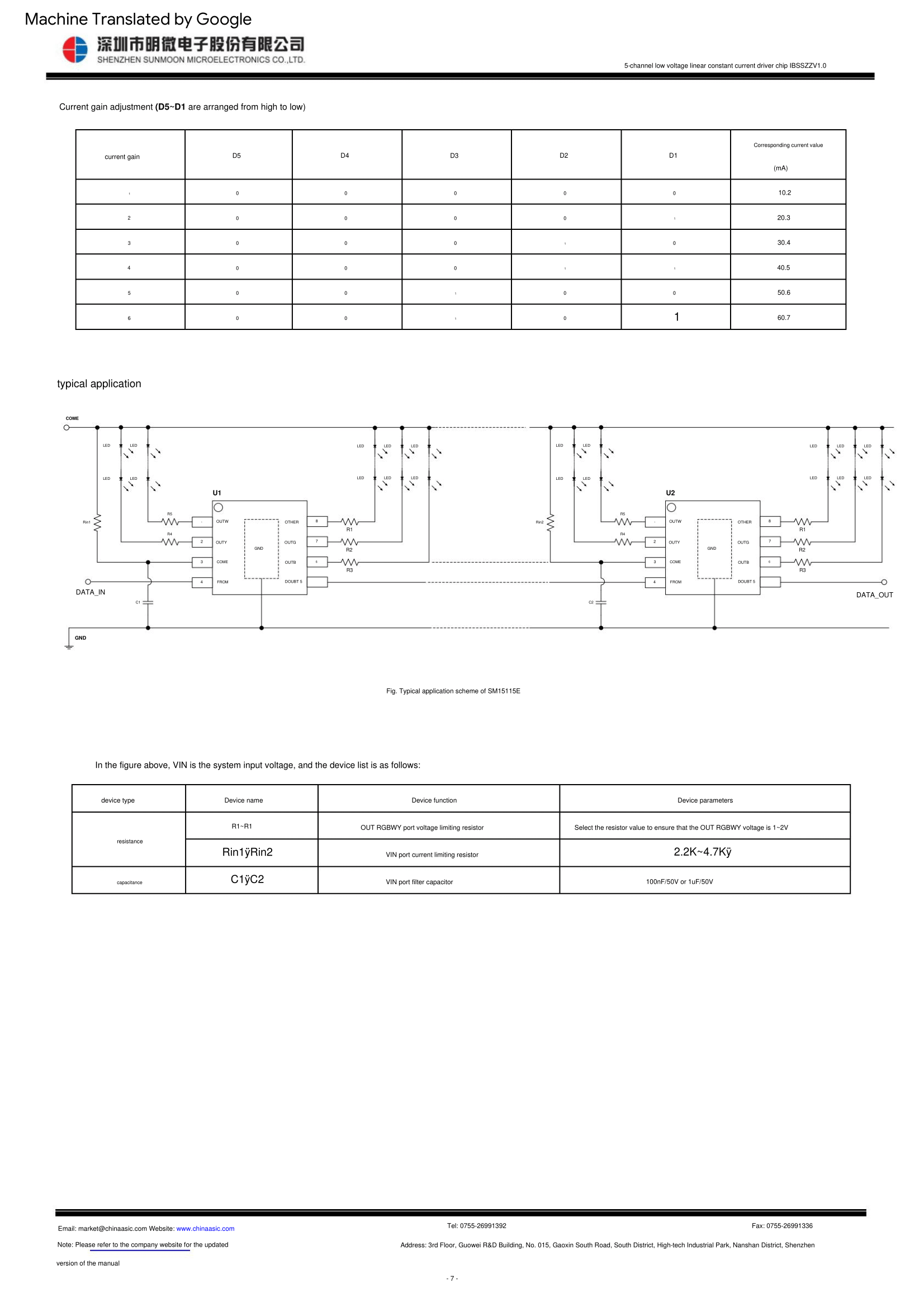

    Timings, communication protocol - fairly compatible with WS2812B:
    Communication protocol schematic for SM15155E with data description. .
    That is, however, there are 16 bits per channel, 5 channels and then five times 5 bits each (current settings), 2 standby enable bits and 5 unused bits.

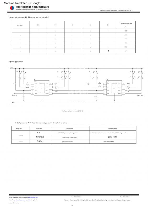

    This is what the cascading of the SM15155 looks like:
    Application schematic of SM15155E with current adjustment settings. .
