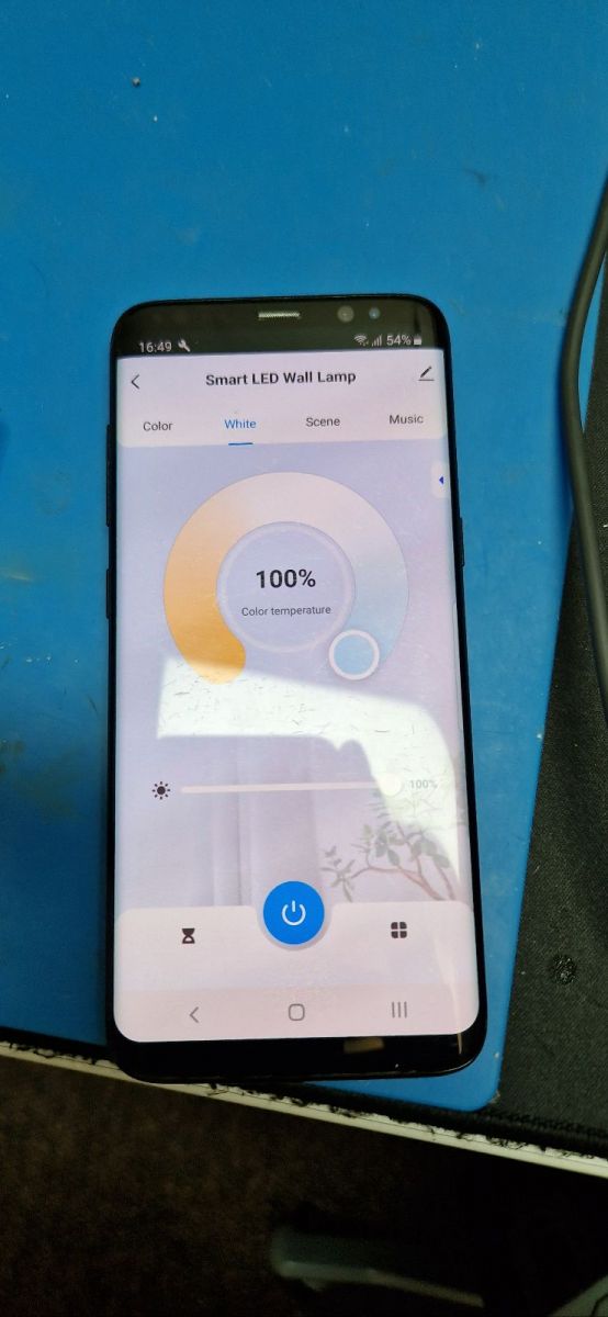

    Tuya_App Informatik:
    Main&MCU v1.1.8
    After flashing with OpenBeken, no function.
    Profile: Tuya Generic - Smart Wall Light v1. 1.8

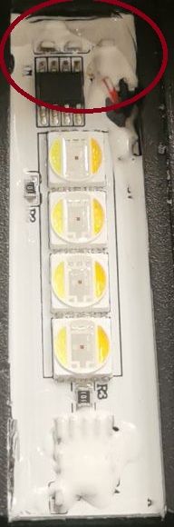

    I disassembled a lot of the Lamp.
    View of a disassembled smart lamp with visible LED diodes and electronic components.

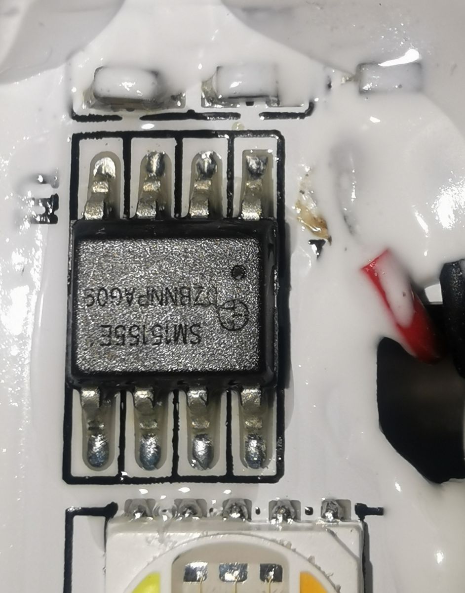

    I found a
    1x BK7231N
    8x 5in1 CH RGB+CCT (all parallel connected)
    1x SM15155E

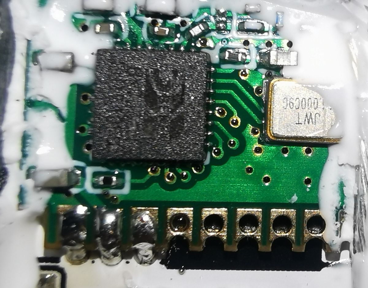

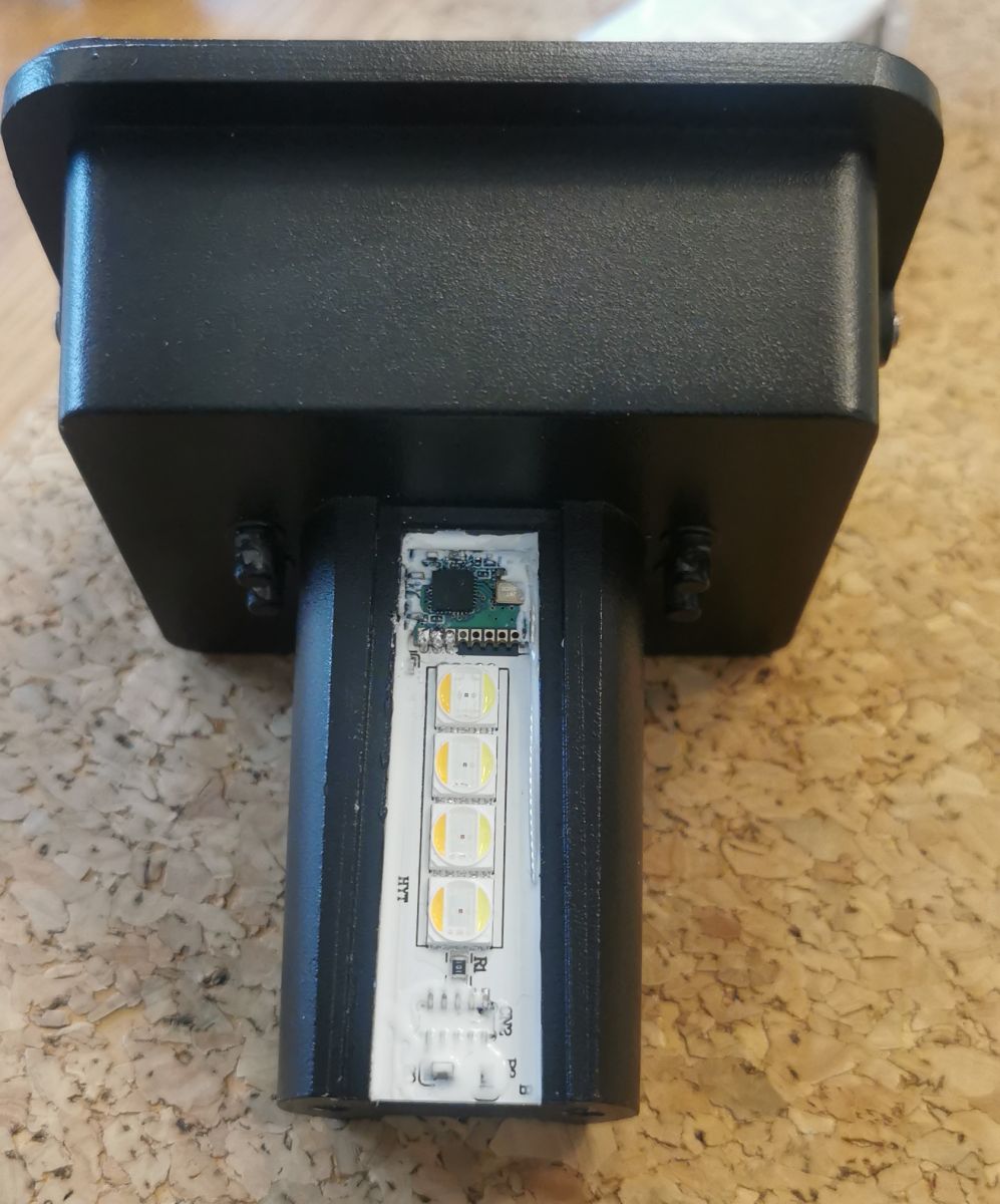

    BK7231N direct by the LED on very small PCB
    Image of the interior of a PCB with the BK7231N chip.
    Close-up of electronic component SM15155E on a PCB.
    BK7231N Pinout on the golden Pins:
    From left to right:
    1: Ground
    2: 3.3V
    3: PIN16 on BK7231N
    4:
    5:
    6:
    7:
    8:
    With OpenBeken Driver "SM16073_DIN" first "connection" to the SM15155E.
    But only one shot and only green light.
    Reboot required after one shot.
    I am happy to assist and help to make this device working together.
    Tuya 2MB dump_flash available.

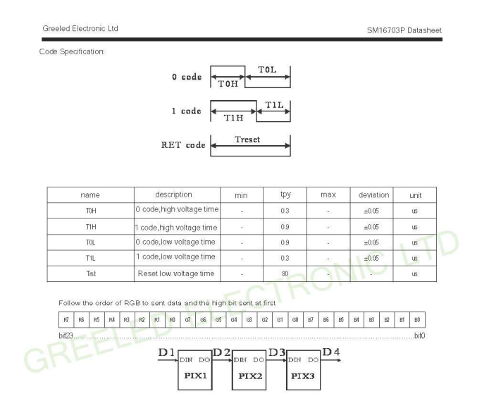

    Welcome to Elektroda @HalliHallo , thank you for submitting teardown.
    From a brief glance, it seems that it is another individually addressable LEDs controller like SM16073, but with different timing, but I am not sure.
    How did this device work before flashing? Were leds individually addressable?
    The usage of P16 for LEDs may not be a coincidence, it's a hardware SPI pin, they are using hardware SPI to push out the pixel data with correct timings.

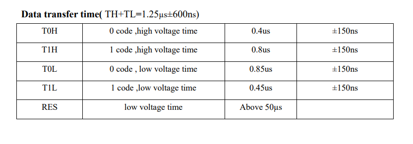

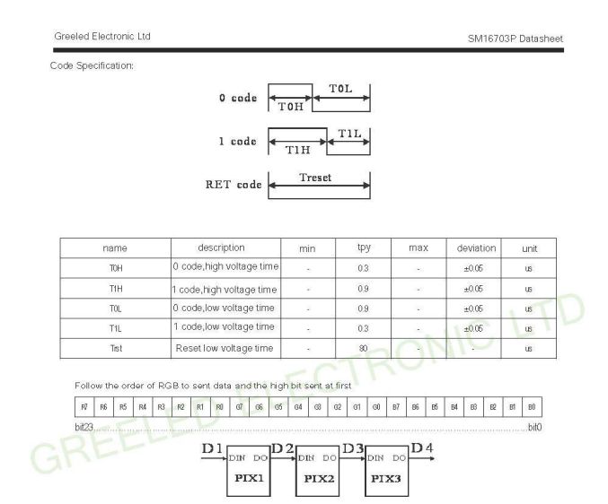

    It looks like you're saying that only one pixel is working, this may be caused by a timing mismatch.
    We need to know the specific timings of this device.
    Please see this section of SM16703 datasheet:
    SM16703P datasheet showing timing code specifications for LED control.
    The linked datasheet of SM15155E does not provide enough information at the current time. It also seems to specify that's a 5 channels driver, so it may not be a SM16703 clone after all.
    Are you sure that only P16 is used for communication?
    If our initial assumption is correct, and it's using a protocol like SM16703 , then we need to either find a datasheet with timing specs or do a capture of data with oscilloscope.

    Original Tuya control:
    On, off, cold white, warm white, RGB color. I think that's the standard.

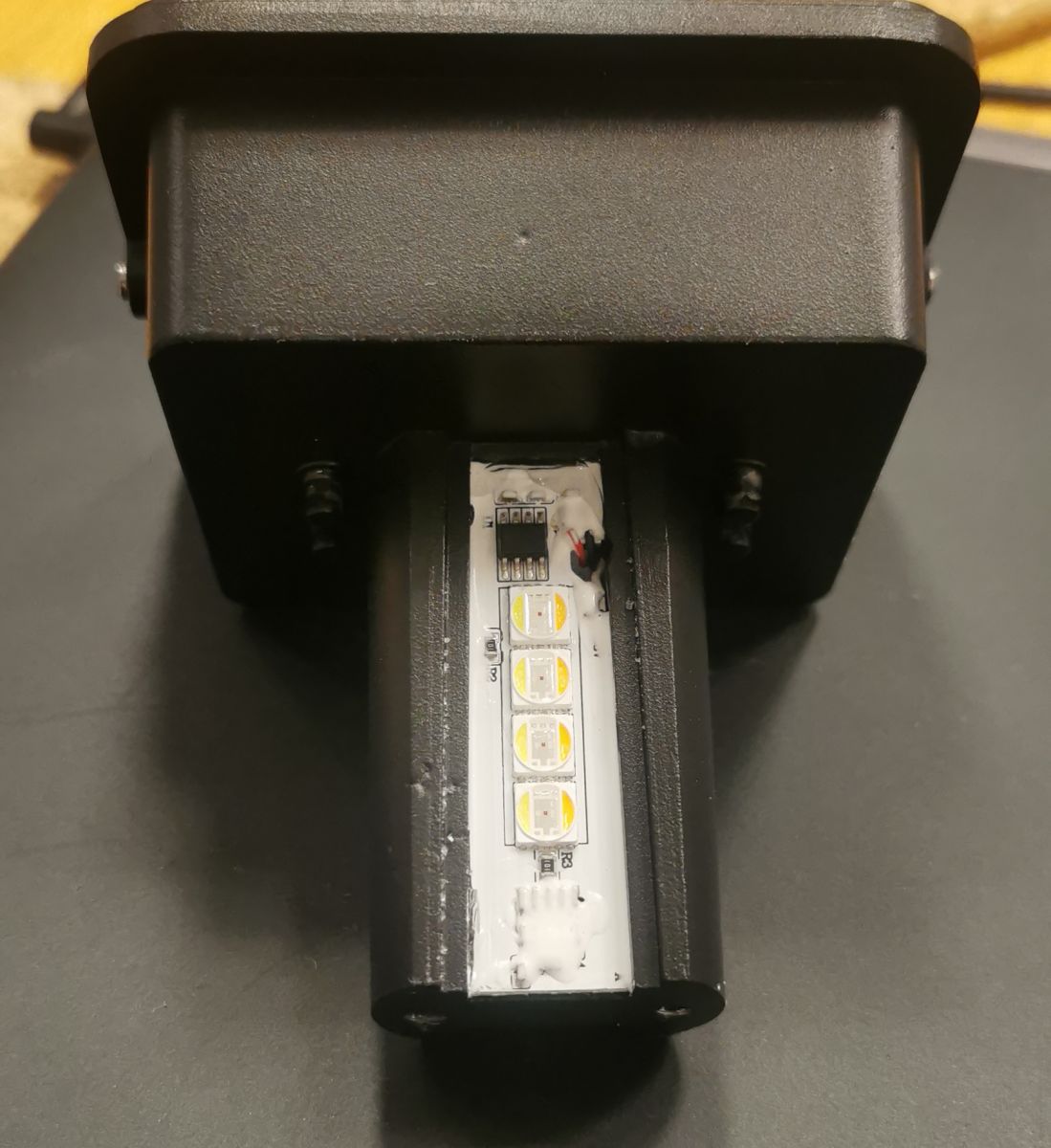

    EDIT:

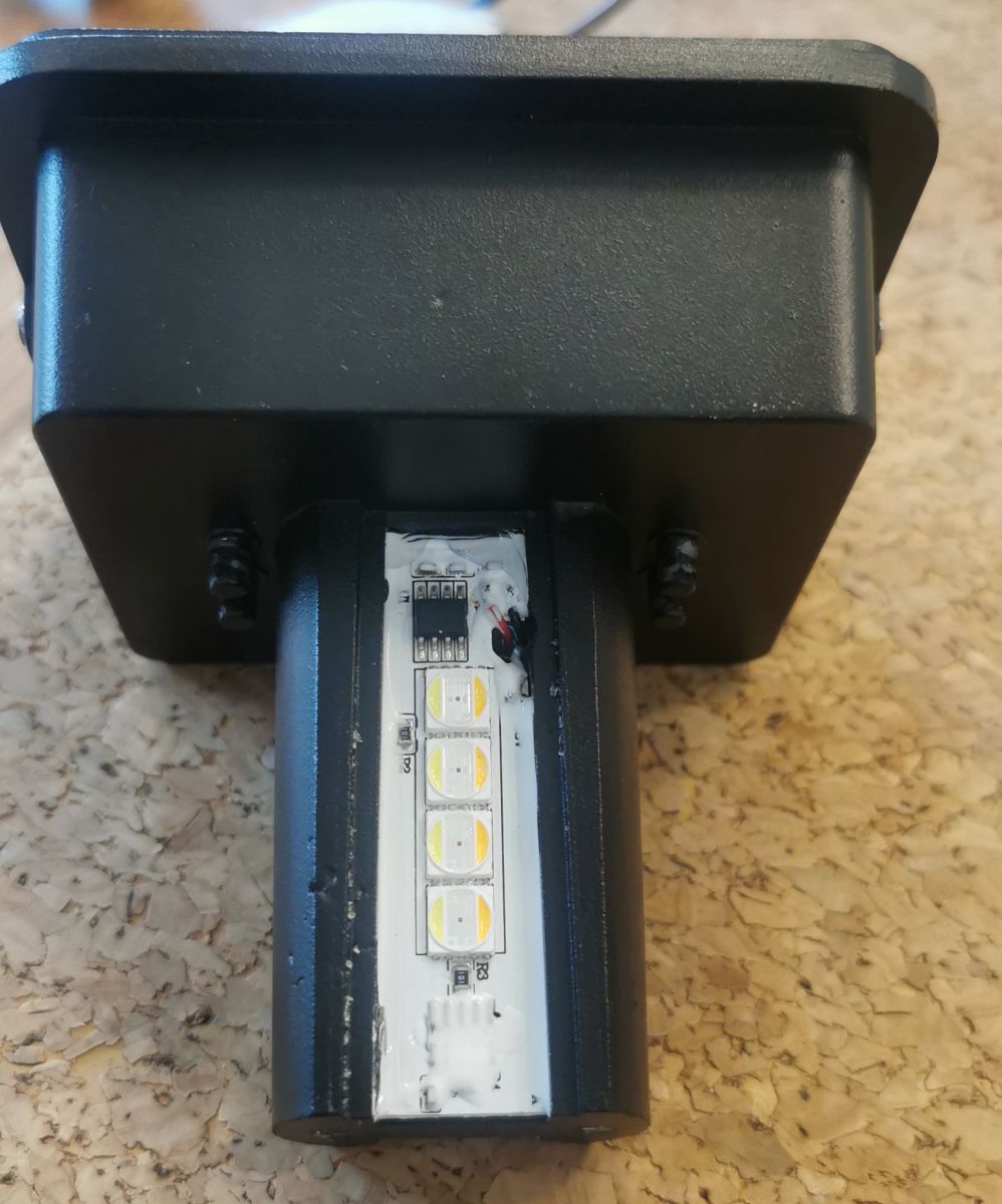

    The lamp has two "sides", up and down.
    On one side:
    LEDs and electronic component on a PCB.
    4 LEDs and the SM15155E
    On the other side:
    LED module with four diodes and an integrated circuit
    4 LEDs and the BK7231N

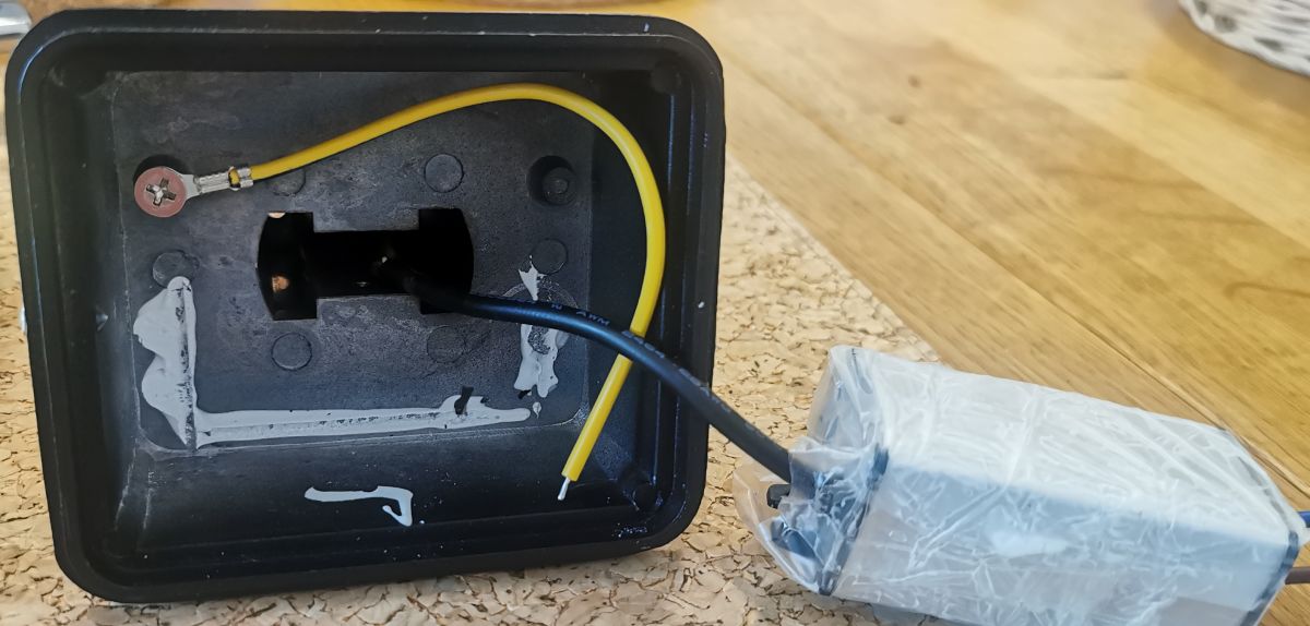

    And "under" the two PCBs is no space for chips or other things. There are clouds directly on the housing, I think for cooling...
    In the big housing, there is only a power supply (ground, 3.3V, and LED power), connection to 230V Power...
    No more chips or other peripherals...
    I disassembled everything to measure with a simple voltmeter.
    Image of the interior of a lamp housing with wires and mounting elements.

    Ah wait, I think I understood what's going on here!
    Look:
    Integrated circuit with marking SM15155E with eight pins.
    This chip has 8 pins. So if it has 5 channels, then we have 3 pins left. we also need GND and VDD. So it has only one pin left for control. That's why they used that kind of protocol.
    Ok, now, can you attach 2MB dump?

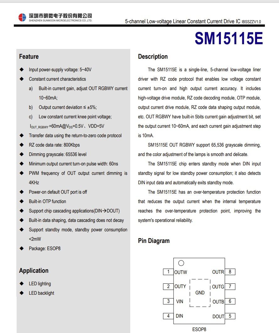

    Found with Google translate:
    SIC protocol intelligent driver chip
    Dimming gray scale: 65536 levels;
    Minimum output current turn-on pulse width: 160nS ;
    OUT PWM output, good color reproduction, PWM frequency 4KHz ;
    Built-in over-temperature protection function;
    Built-in data shaping, data cascade ( DIN→DOUT ) does not attenuate;
    Built-in automatic energy-saving mode, standby power consumption <2mW ;
    Built-in current gain, adjusts OUT RGBWY current 10~300mA ;
    Constant current output, changes in lamp bead voltage difference will not cause changes in lamp bead brightness;
    Supports WIFI , Bluetooth, Zigbee , 2.4G and other control modules.
    App types Three-way five roads chip
    SM15153E
    SM15155E
    Hinzugefügt nach 24 [Minuten]:
    LED Driver Chips That Support all The Mainstream Serial Data interfaces on The
    Marke
    Such as MBI6020、MBI6021、MBI6024、MBI6023、MBI6120、MBI6027、MBI6034、MBI6033、MBI6030、LPD6803、LPD8806、LPD1886、LPD1882、TM1803、TM1804、TM1829、TM1812、TM1914、TM1925、TM1926、TM1905、TM1905、TLS3001、TLS3008、TLSGY01、MY9221、MY9231、MY9291、MY9234、WS2801、WS2811、WS2812B、 WS2818A、WS2816、CX808、P9813、P9823、P9883、AP102、AP104、GS8206、GS8208、SM16716、BS0815、BS0901、BS0902、UCS1903、UCS1904、UCS1909、UCS1912、UCS2903、UCS2904、UCS2912、UCS8903、UCS8904、UCS9812、UCS3903、UCS5603、UCS2603、UCS8603、TI5971、TI5973、TI59731、GW6201、GW6205、GW6230、GW6236、GW6212、GW6209、GW6206、GW6209、GW6212、GW6230A、GW6211、GW6803、GW6606、SM16711、SM16716、SM16703P、SM16704P、SM16736、SM16803P、SM16804P、SM16813P、SM16814P、SM16823E、SM16824E、SM16825E、SM15155E、ICND2110、HX5011、ZQ1111、 LX1603、LX1203、HBS1916、HBS1910、HBS1510、HB200B、KW1203A、CX808、DM412、DM413、DM621、MC2002、MC2.0、PM1.0、MT1809、MT1815S、MT16703 etc。
    Screenshot Datasheet
    Return to zero protocol?
    RZ protocol?
    Technical documentation for the SM15115E constant current driver chip.
    • DDWDZ123_1679037801000.zh-CN.en.pdf (392.66 KB) You must be logged in to download this attachment.
    • DDWDZ123_1679037801000.pdf (346.55 KB) You must be logged in to download this attachment.

    The attached datasheet reads:
    Data transmission using return-to-zero code protocol
    Return-to-zero code data rate:800Kbps
    It indeed seems to provide some basic information, but I would like to see the details.

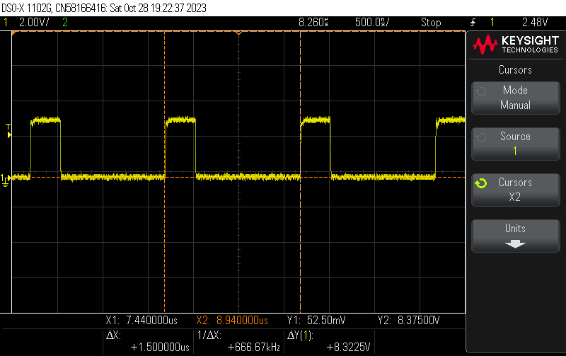

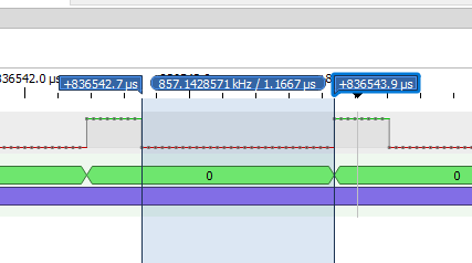

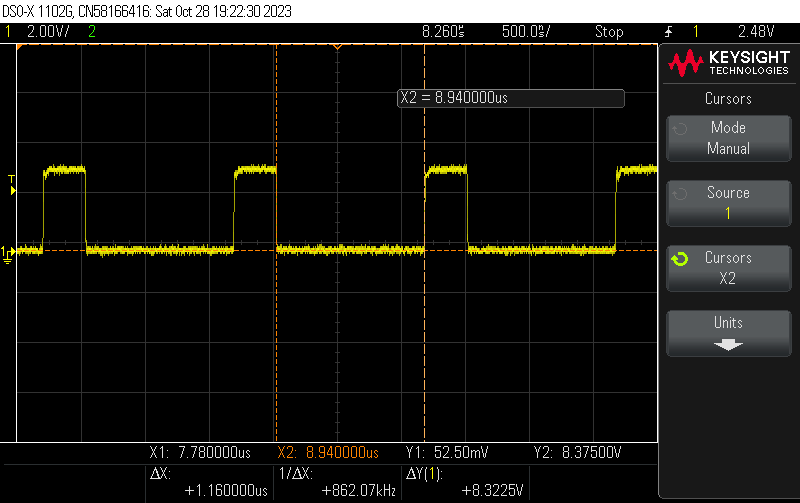

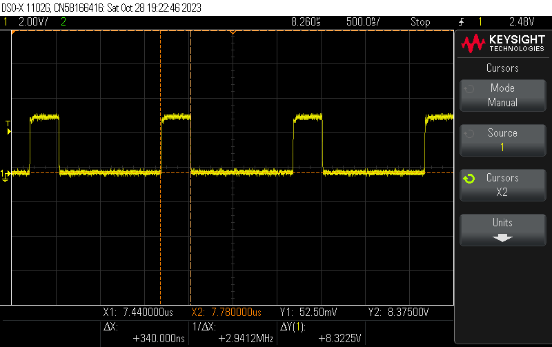

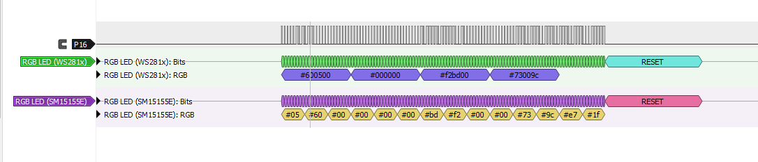

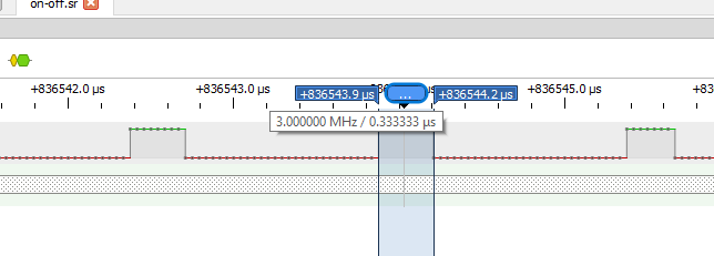

  • PulseView capture of flashed CB3S dump
    #14 20789046
    Posts: 14755
    Rate: 12878
    The following document seems to describe the SPI transmission, which is not used in case of your device. I know that we are internally using SPI MOSI pin to drive SM16703, but that's a different thing.
    Added after 3 [hours] 52 [minutes]:
    Ok @HalliHallo , we have flashed your 2MB dump on our CB3S with @DeDaMrAz and will try to scope some things:
    CB3S module connected to a computer and a smartphone with a device-adding app Smartphone displaying an app for controlling a smart LED lamp, showing color temperature settings.
    We will hopefully know more information soon. Now we need to get access to P16... like here:
    https://www.elektroda.com/rtvforum/topic4005865.html
    Added after 1 [hours] 3 [minutes]:
    Screenshot from PulseView software showing an analysis of an RGB LED (WS281x) signal using a decoder.
    Added after 39 [minutes]:
    first capture, open in PulseView
    • SM15155E-test-capture-first-20231028.zip (26.64 KB) You must be logged in to download this attachment.
  • #15 20789509
    Posts: 14755
    Rate: 12878
    Better resolution timings check:
    Signal graph with frequency control in MHz showing time in microseconds.
    Detailed graph showing time and frequency values.
  • #17 20789559
    Posts: 14755
    Rate: 12878
    340ns and 1160ns ... or rather 350ns and 1150ns I would say.
    Here are WS2812B specs:
    Table showing data transfer times for SM16703P.
    Kinda close...
    Here is SM16703P:
    Specification of coding and reset times for SM16703P.
    Hmm the timings does not match too well, I will have to adjust our drivers to generate a closer timings.
  • PulseView decoder ported to SM15155E
    #18 20791000
    Posts: 14755
    Rate: 12878
    PulseView decoder work....
    LED signal graph with color coding for WS281x and SM1515E LEDs.
    I have ported WS2812 one to SM15155E
    Code: Python
  • #19 20791019
    DeDaMrAz
    Posts: 620
    Help: 34
    Rate: 130
    Here are some of the captures taken at 8MHz.
    • data captures.rar (262.65 KB) You must be logged in to download this attachment.
  • #20 20795751
    HalliHallo
    Posts: 21
    Wow, so much informations.
    I will try to understand, but I am no eletrican...
    SM15155E = 5ch RGBCY (RGB +WW +CW)
    SM15153E = 3ch RGB
    I can try your code, I can only ota-update the light.
  • #21 20795923
    Posts: 14755
    Rate: 12878
    We're still working on it, we know the timings and we have a per-byte decoder, but we don't know the meaning of individual bytes yet.
  • #22 20811754
    HalliHallo
    Posts: 21
    Can I try with "try & error" the association?
  • #23 20813253
    steppyvanbeek
    Any update? Been waiting for this one for months
  • #24 20825432

    I'm thinking these are SMD 5050 led's so ws281X timing will not work.
    Have you tried running the strip with WLED? That might help work out what protocol you need to use.

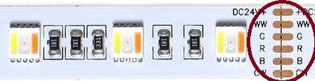

  • Check for hidden pads to identify LED type
    #29 20836516
    wolfieeewolf
    Posts: 93
    Help: 7
    Rate: 20
    HalliHallo wrote:
    Strip? I have this Smart Wall Lamp, see my first posts
    On your wall lamp, you will find this
    White glue covering a connector section on an LED board.
    Where the red circle is, you will need to carefully remove the white glue and see if there are any pads underneath. They will most likely look like this
    LED strip with red outline showing connectors.
    If your pads look like the ones above, then you have non-addressable RGB CCT LEDs and can follow this to see if you can get them working. But you do run the risk of overloading the LEDs if not done properly, so I would advise against it if you're new to this.
    If you find that there are data, clock, and voltage pads, then you have addressable LEDs and should follow this. That will get you started, but again, if you are new to this, you run the risk of overloading and killing your LEDs, so read everything carefully.
    If you can't find any pads at all and only the power and ground wires, then that is something WLED can't do. Two-wire controls are very tricky and most likely almost impossible to hack. It would require programming special code just to run the LEDs. Something like the way these LSC string lights are controlled.
    I really don't think that those LEDs are controlled like that, but if they are, then I have no idea what you could do to get them working. Without the original firmware dumped straight off the chip, you might never be able to get them working, and even then, it would be a shot in the dark.
    I highly doubt your LEDs are addressable and are most likely controlled via PWM.
  • #30 20836825
    Posts: 14755
    Rate: 12878
    His LEDs are controlled via single GPIO like the ones that are addressable, but I don't think ESP32 will help, because SM15155E protocol is not yet fully known. So there are no open source drivers for that yet. We've done first stage of reverse engineering, but there is more work to do.
